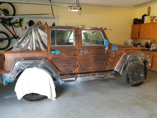

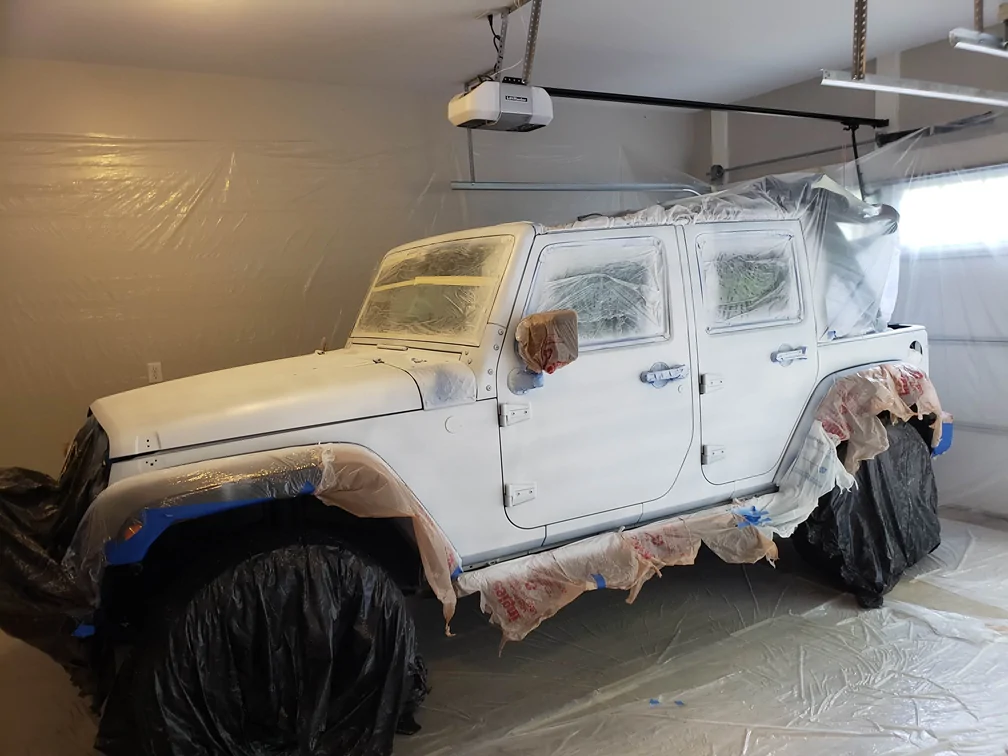

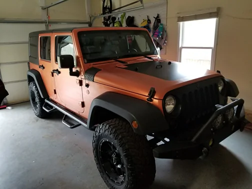

The whole truck. I've done it in the past when I had a Wrangler. Actually painted it four different times/colors. It was burnt orange, khaki, like a denim blue, and a pearl white. It takes either 2 gallons in a sprayer or about 15 rattles cans. Fun weekend project! haha

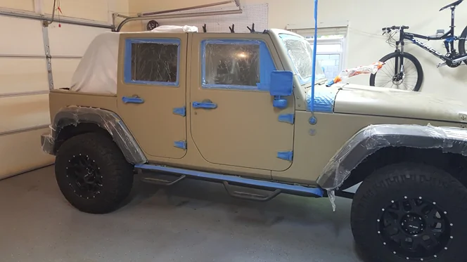

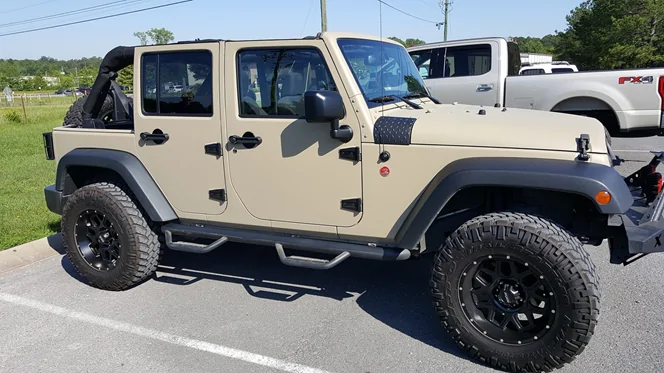

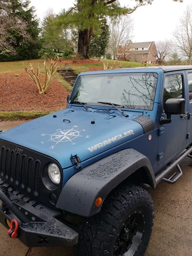

It's REAL color was "Rhino", a really dark grey/blue. The only real things to keep in mind is, always keep the rattle can or sprayer moving or it will drip. And PUT IT ON THICK. That makes it easier to peel later. I learned the hard way with the first one which was the Khaki. I didn't put it on thick enough then it would just tear into little bitty strips or pieces as I tried to remove it. I ended up literally using a pressure washer to get all the tiny little pieces off.
