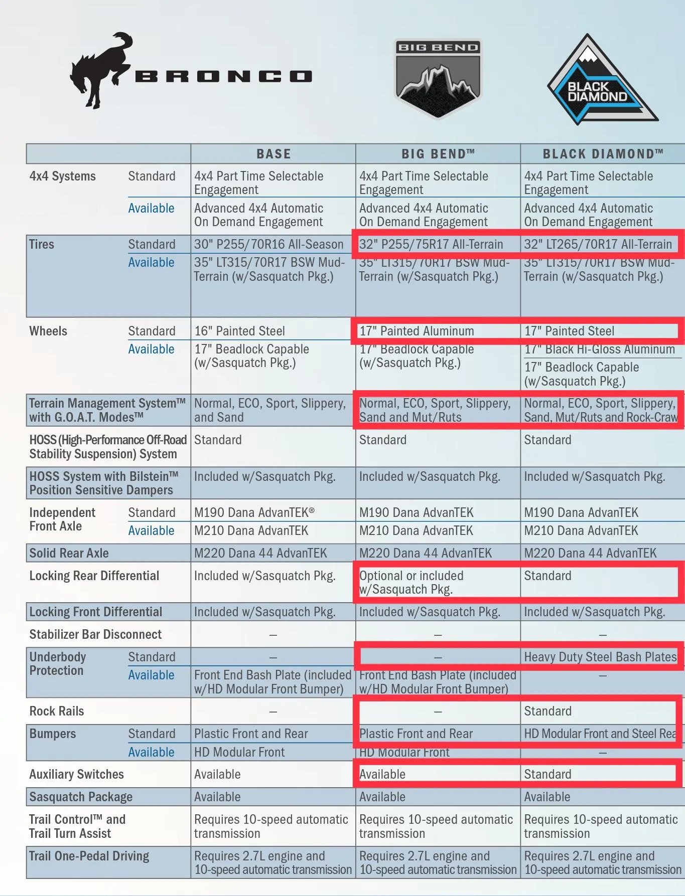

rear locker is standard in bd. also add rock crawl goat mode, not really mechanical.
bash plates, rock rails, mod bumper, and lt265 tires on bd. p255 tires no other options on bb.
Good summary. âś…
Here is a graphical comparison highlighting the differences…
Ford Bronco The Mechanical Difference (BB & BD)? 692AD878-0892-4ACC-B7F2-2937FFB29A60
