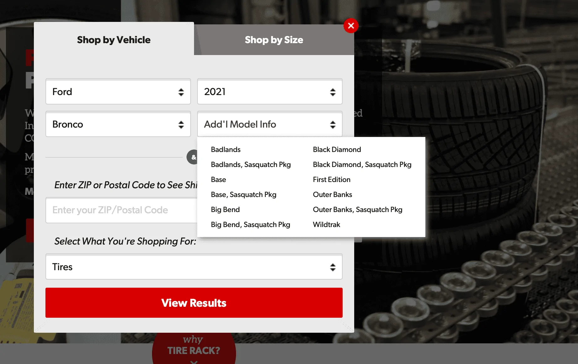

Ford Bronco Tire Rack lists 2021 Bronco tire options and sizes 1595501233833

If you're interested... The Tire Rack already has the different tires listed with Sasquatch package also listed.
Its about $200 a tire to replace the tires on an Outer Banks.
