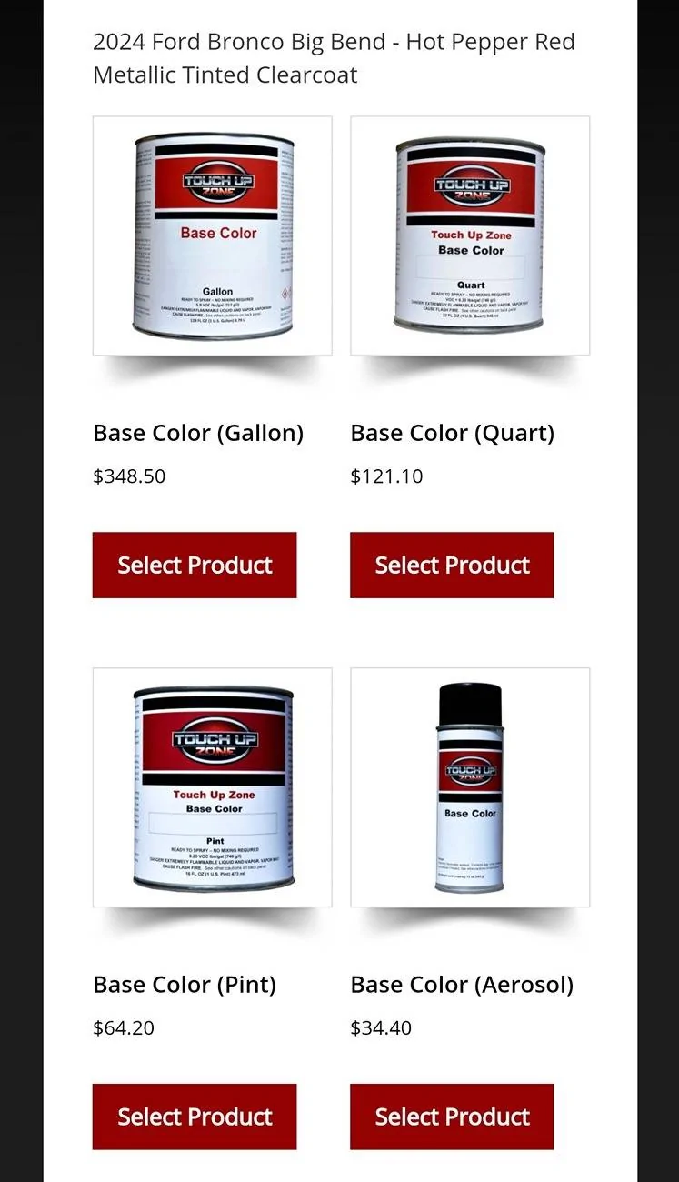

Hey guys, was looking for a spray can of my Bronco's color. Happened across this site touchupzone.com Has anyone used products from them? Are they legit? Got a couple adding pieces I'd like to spray paint the same color as my ride.
Ford Bronco Touch up paint recommendations? Screenshot_20240924_165217_Chrom

I get all of my touchup paint from here. Dead match to stock with all previous vehicles. I’ve had good luck with this company.
https://automotivetouchup.com/
