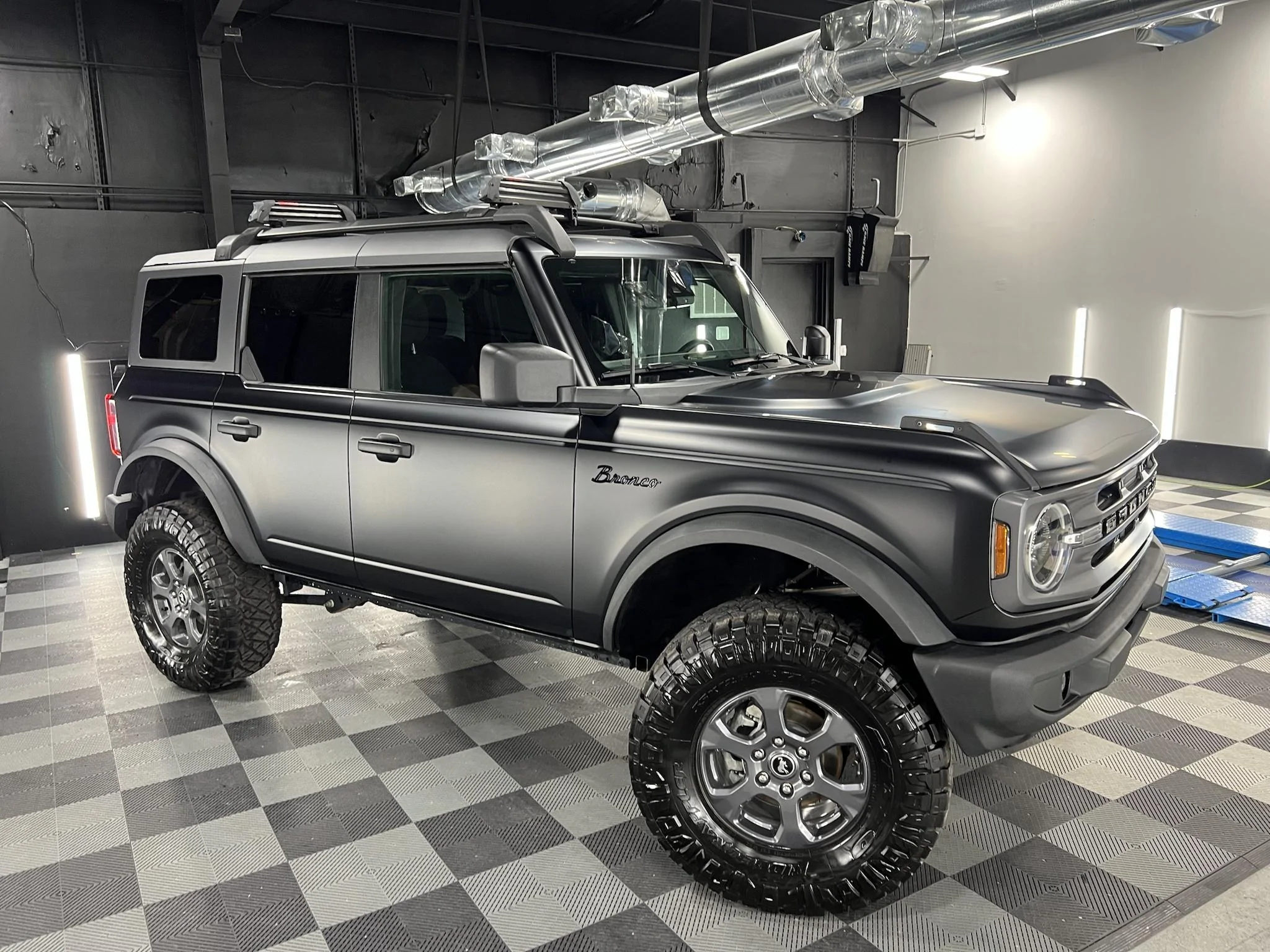

Pic of my ride for attention

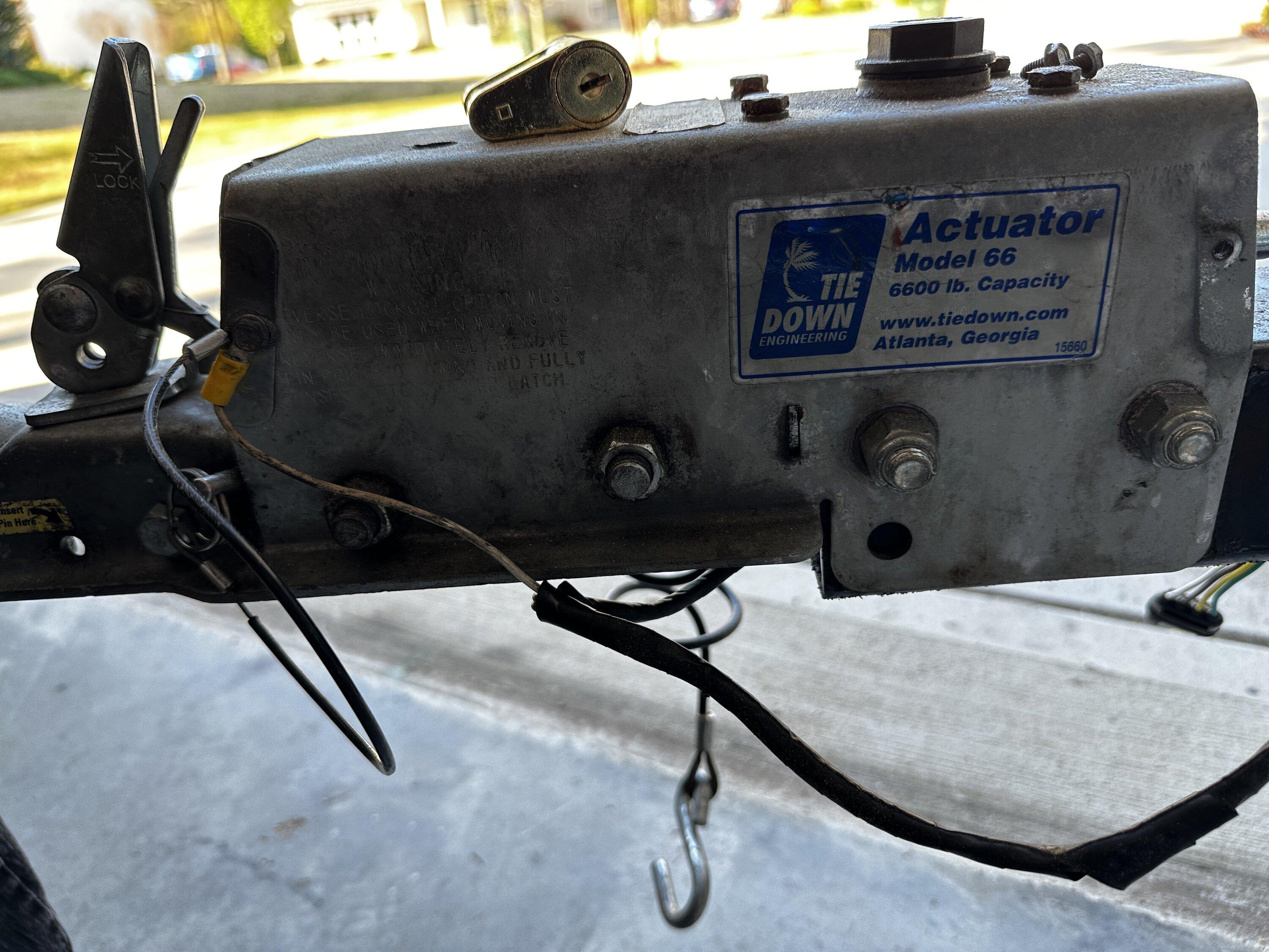

Not sure if the trailer has surge breaks, I doubt it.
Planning to pick the boat up today and take it to the lake one night this week, then pull it down to the beach (2 hour or so drive) and take it from Murrells Inlet down to Georgetown on Saturday
You'll have a bolt on coupler with a fill cap on top like this if you do.
Re: Murrells Inlet down to Georgetown: Nice! I flush my boat motor with salt-away (and trailer if it is steel - if aluminum, wash it with the boat). Took it out in the Chesapeake, and a few times from Morehead City to Cape Lookout.

Sorry to go off topic, but that garage looks pretty cool, especially with the color matched Bronco.
Haha it’s actually a buddies shop, he did the PPF Matte wrap for me

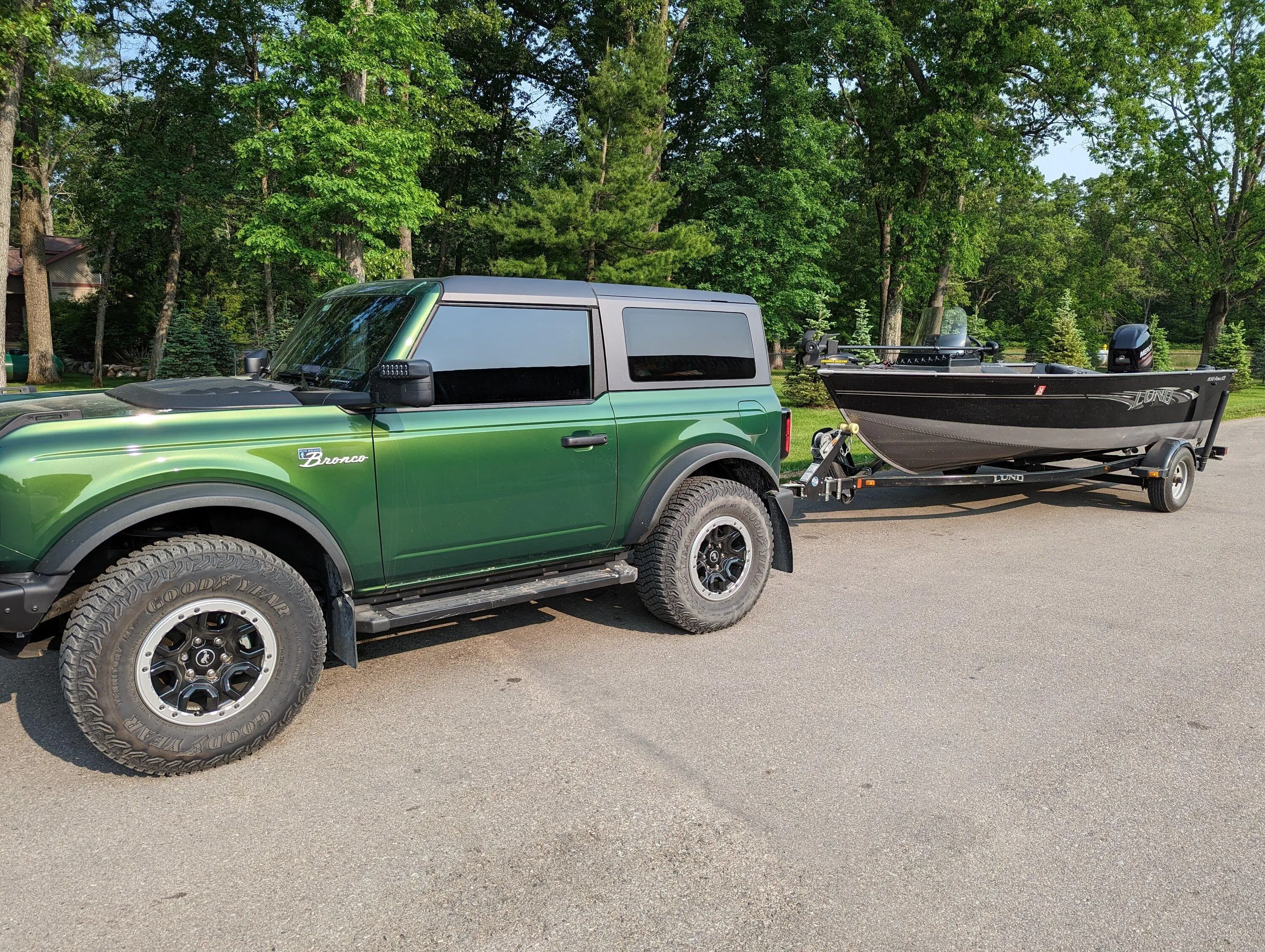

No problems towing with my 2.3
Ford Bronco Towing Question - Boat Boat (2)
