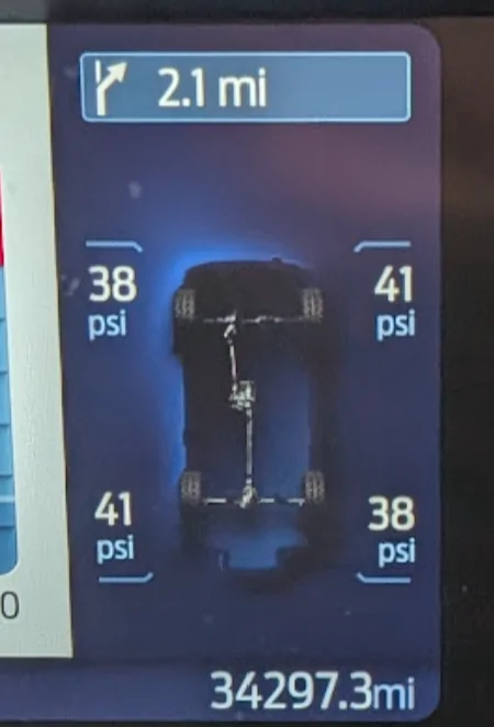

Upon starting the vehicle, the readout for each tire is just fine:

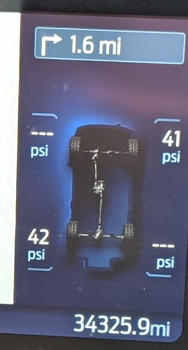

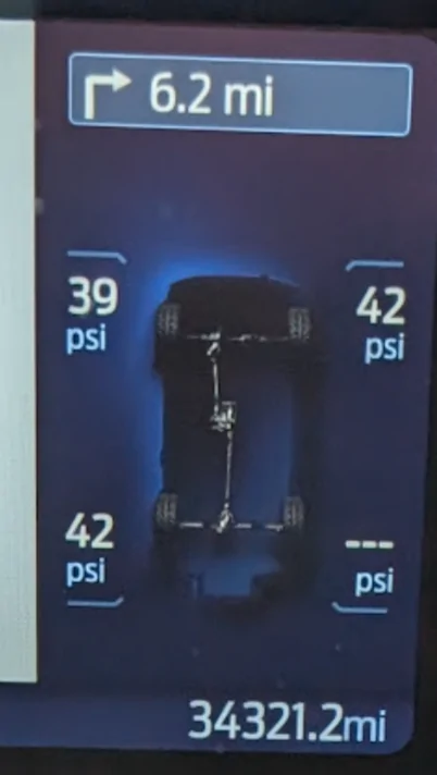

After driving for a bit the sensors will keep updating as the tires are warming up more from normal driving, but 2 of them will not update. Then the system will fault and those will go blank but not always:
Ford Bronco TPMS Interference 1773069703917-mv
Ford Bronco TPMS Interference 1773069757302-vm
I've done some troubleshooting already. This started with the passenger rear only. I then went and did a 5 tire rotation and moved that passenger rear to the passenger front. Was hoping it was just a bad sensor and the fault would follow that one, but it did not. So I know good sensors are at the locations of the current faults.
Form suggested switching back to the OEM housings to see if this goes away. I can do so for the rear lights and I will, but the headlights are already installed in my GF's bronco to replace the OEM Big Bend w/o signature.
Just wondered if anyone has seen this before? I know the module has a range of frequency that it utilizes for the TPMS sensors but not sure if maybe I can get different ones to make work at either the high or low end of frequency.
The wheels are Method 703s with new TPMS from Discount tire. Those TPMS have been running fine since this past June.
@Ducati1098 or anyone ever seen this?
Thanks everyone.

I would agree that swapping the lights back and verifying the problem still exists is a good place to start. But honestly I think that may just be a coincidence.
Very possible it’s just a TPMS system issue, but it would be really difficult for me to try and diagnose something like this without the bronco.
I have seen a few other Broncos with TPMS issues, usually either stemming from BCM or RTM problems.

Copy that. Yeah it's a weird one for sure. Especially with no issues at all before.

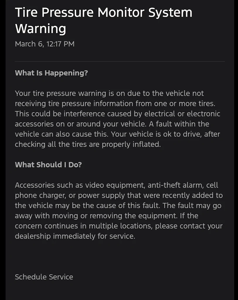

I don’t think it’s a coincidence at all- the first start after installing RC fog lights one of my sensors went dark and has been for a year. I did see a thread somewhere someone agreeing with you that there is interference from installing accessories (lights etc). Wish I knew how to fix minis disconnecting my lights
Yeah, that's exactly what the Ford pass app said as well. Did you ever remedy it, or just leave it how it has been?

I’ve just lived with it; probably a year now. I’ve got a 4-tire inflation hose and if and when I need to fill up, I let them set for a few minutes to equalize after filling and just “know” that 4th one is the same. Oh well
