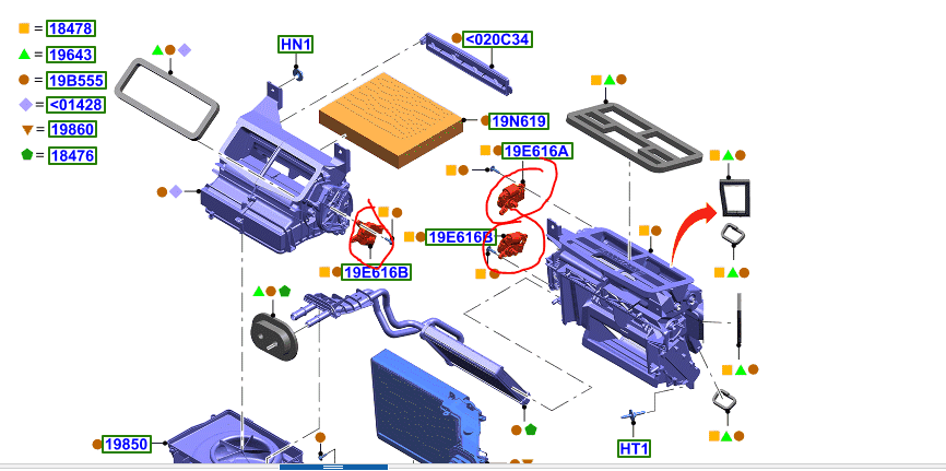

Blend/mode door actuators are moving and it's either them or the door, door pivots, or door seals making the noise. Plastic on plastic and seems to be worse, at least my experience, in the colder months. If you have auto HVAC you may hear the noise from time to time without any input from you as the vehicle is trying to maintain your set temp. and/or switch from recirc to outside air.
Lubing may help but they aren't easy to access and you'd need to know what part is actually causing the creaky-popping. Heavy white lithium or Krytox is what I'd try if it got to the point of overwhelming annoyance.
Thank you... to your point, I'm not sure how I'd get to the parts and definitely don't want to tear apart the dash (either does the service manager). Thank you for the schematic and suggestion.
