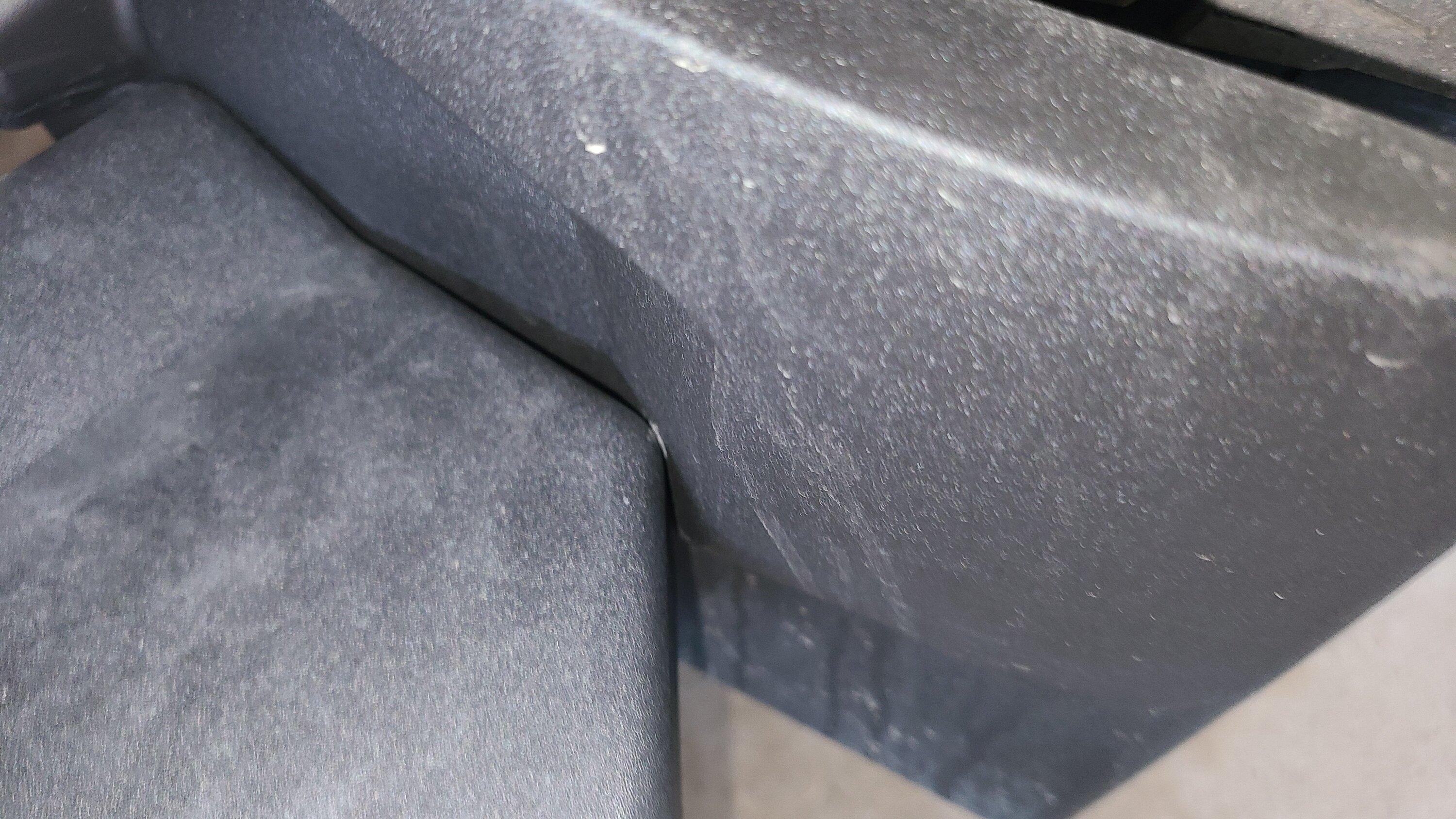

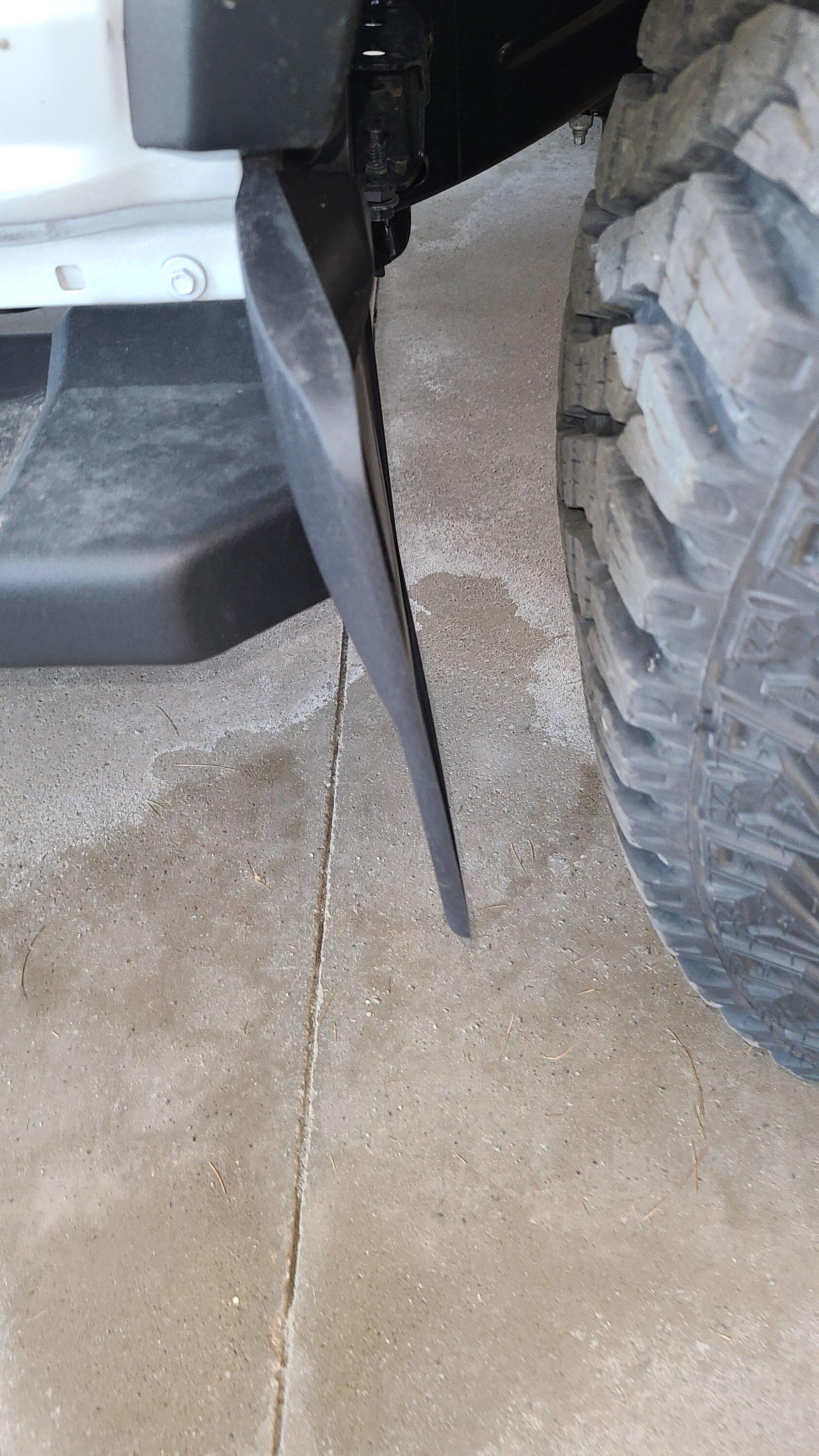

I will say I'm not crazy with how they don't line up with the steps very well. Might try cutting a hole in them to get them to lay flat on the step. Anyone else done that?
