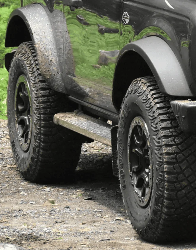

I just installed weathertech flaps this morning (front only) on sasquatch with factory sidesteps. I agree with others that they could have made them a better fit w/sidesteps - especially for a company that prides itself on custom-fit products. And the washed-out black & white pics on instruction sheet leave a lot to be desired.
Just a couple tidbits:
:: If you're right-handed, I would install the passenger side first. There's a bit of a learning-curve, and the 1st flap will take longer than the 2nd flap. And on the passenger side, you'll probably be using your right hand more for tool-holding than your left hand. Then the driver side should go faster and won't matter that you're using non-dominant hand for most of the work. If you're left-handed, the opposite advice would probably hold true.
:: For me, turning the steering all the way to the LEFT to install passenger side and all the way to the RIGHT to install driver side seemed to work best. But it's almost equally challenging either way with sasquatch. Someone else said they removed fender flares for install, and maybe that helps too.
:: One concern I have is the V-shaped gap between flare and flap. Makes me wonder if it'll allow some splash through there. I guess time will tell.
Pic from previous post from another member showing that gap:
Ford Bronco WeatherTech Mudflap Install 1672587101320
It is insignificant compared to what gets past the bottom of the mudflap. I still get mud at the bottom of my doors, but no longer clear up to the door handles.

Did my first 'lite' off-roading last weekend (nothing major). I've got Weathertechs on front only (Wildtrak). They did great keeping mud off the doors & windows. But that V-shaped gap between top of mudflap and bottom of flare seems to let just enough mud through to hit the front of the rear tire flare just right.
Ford Bronco WeatherTech Mudflap Install 1684798503709
Nah, that stuff flipped up UNDER the mudflap.
You can verify this by filling that gap with a bit of duct tape or something similar and you'll see the same amount of mud on the rear flare.
