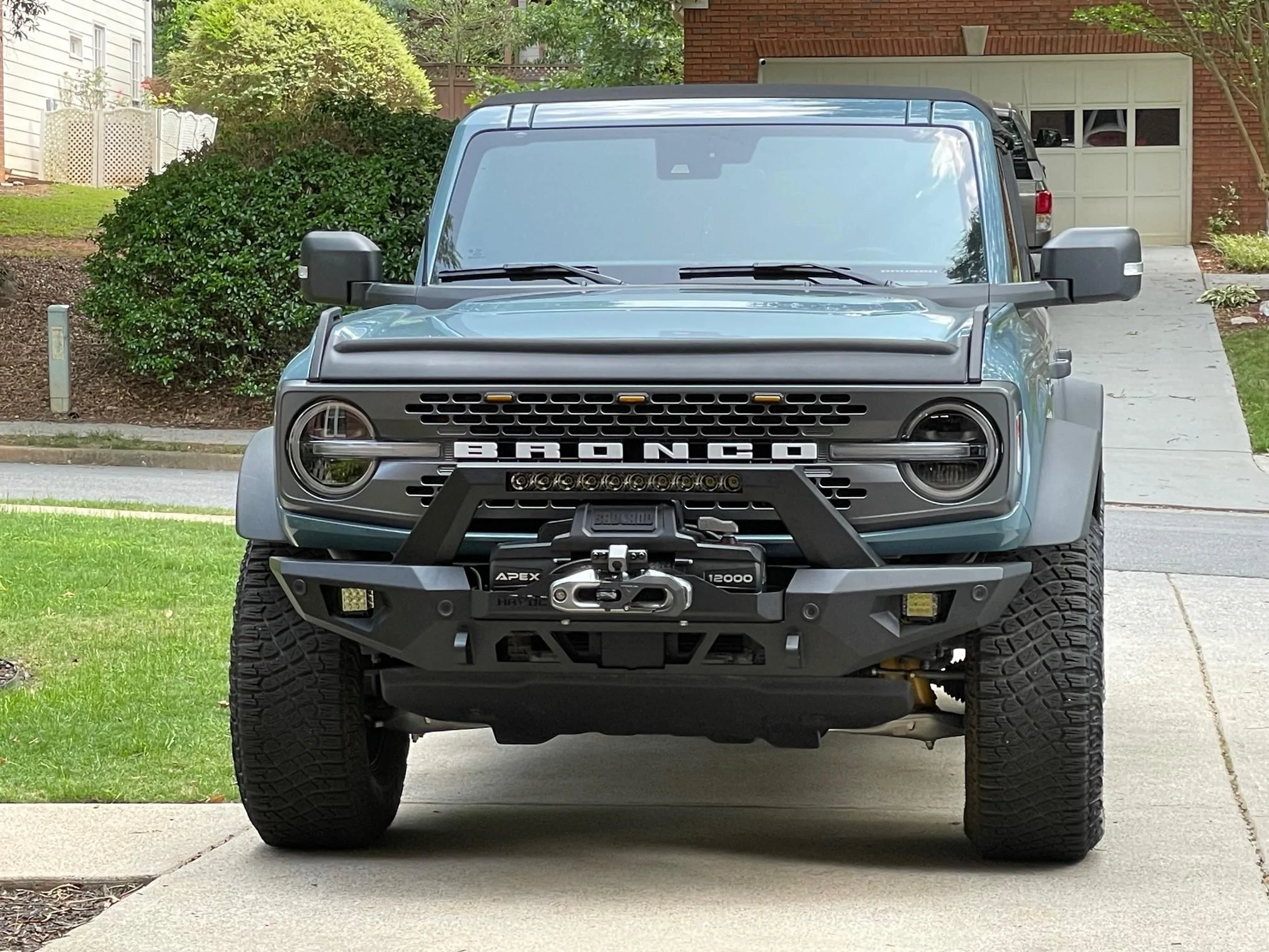

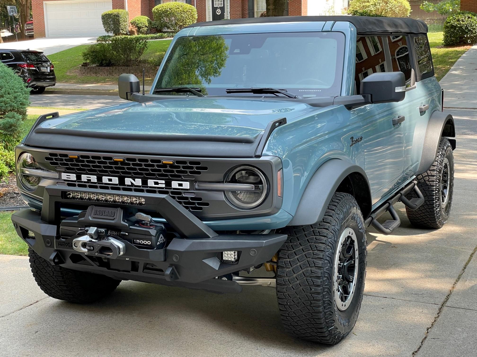

This past weekend I installed a new winch capable bumper, winch and lights. Project took about 8 hours, spending more time on electronics (I have LUX package), but it came out great. Need to test it on the trail.
These are the items I installed:
  1. HAVOC OFFROAD STEEL BENDER FRONT WINCH BUMPER - Note: Havoc, if you are reading this, your product is great, the instructions are not....take time to post an install video.
  2. HAVOC OFFROAD 20" SINGLE ROW LIGHT BAR WITH DRL. I am able to switch from clear to yellow with the same aux switch. Excellent functionality
  3. DV8 2021-2023 FORD BRONCO | FRONT CAMERA RELOCATION BRACKET - the kit comes with all items needed, with plenty of length on the hose and cable.
  4. Badland Apex 12k Winch - Cant beat the price....
Shoot me a message if you have an specific install question.

Omdiaz01 Excellent job and a great post Love what you have done! I also have a Lux Badlands, and while I ultimately want a winch, keeping the front camera, sensors and radar were essential considerations. Also important are keeping a good approach angle and of course, how it looks. Nothing I had found yet fulfilled my wish list until now. I think you nailed it!
I also love the integrated light bar and the fact that it toggles between amber and white lights. Wow!
One question. . .How does the front camera function in the relocated position? Specifically, does the 360' overhead view still function as well as the Rock Crawl mode forward view.

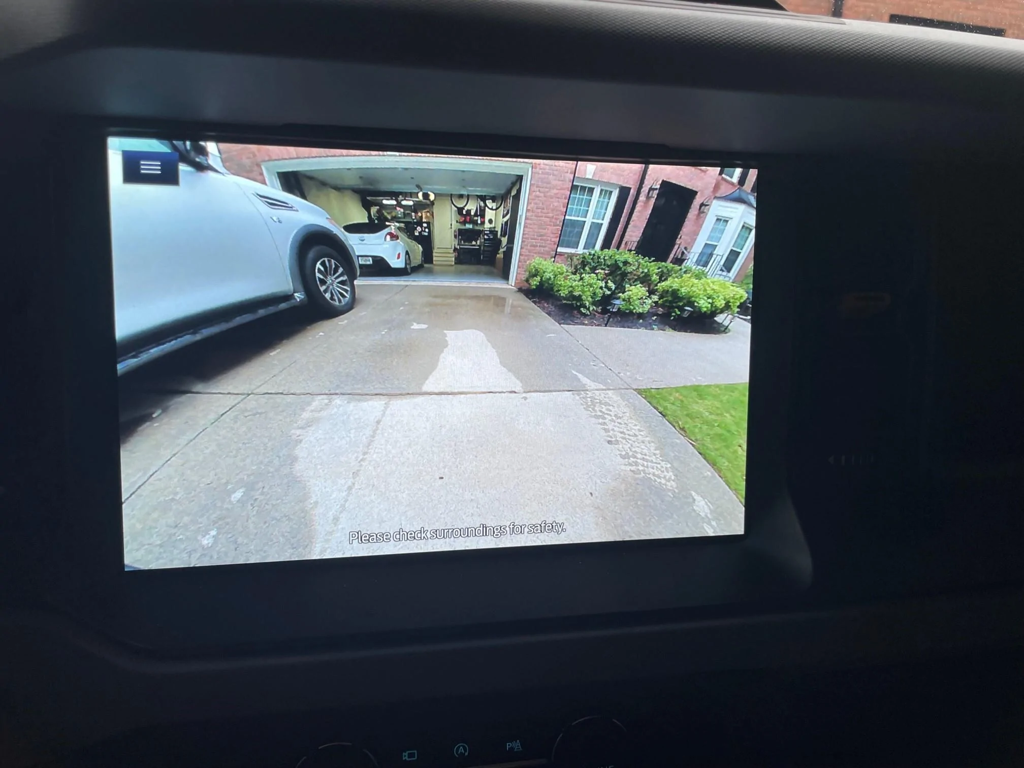

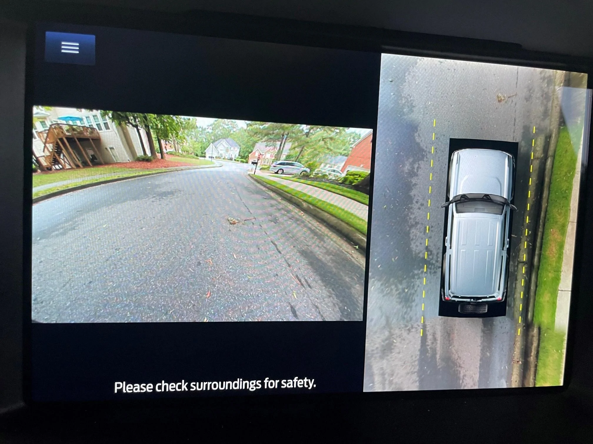

@Eastmort : Yes, the camera function in the relocated position maintained the full 360 overhead view. Later today/tomorrow, I will take a picture of screen showing the 360 overhead , 4L view, and will post to this thread.
@Eastmort The two pictures below are the normal 360 view and in Rock Crawl (4L) mode with the new DV8 camera relocation setup.
Ford Bronco Weekend Project : New Havoc Bumper, Badland Apex winch, lights etc.. BroncoCamera1
setup
Ford Bronco Weekend Project : New Havoc Bumper, Badland Apex winch, lights etc.. BroncoCamera2

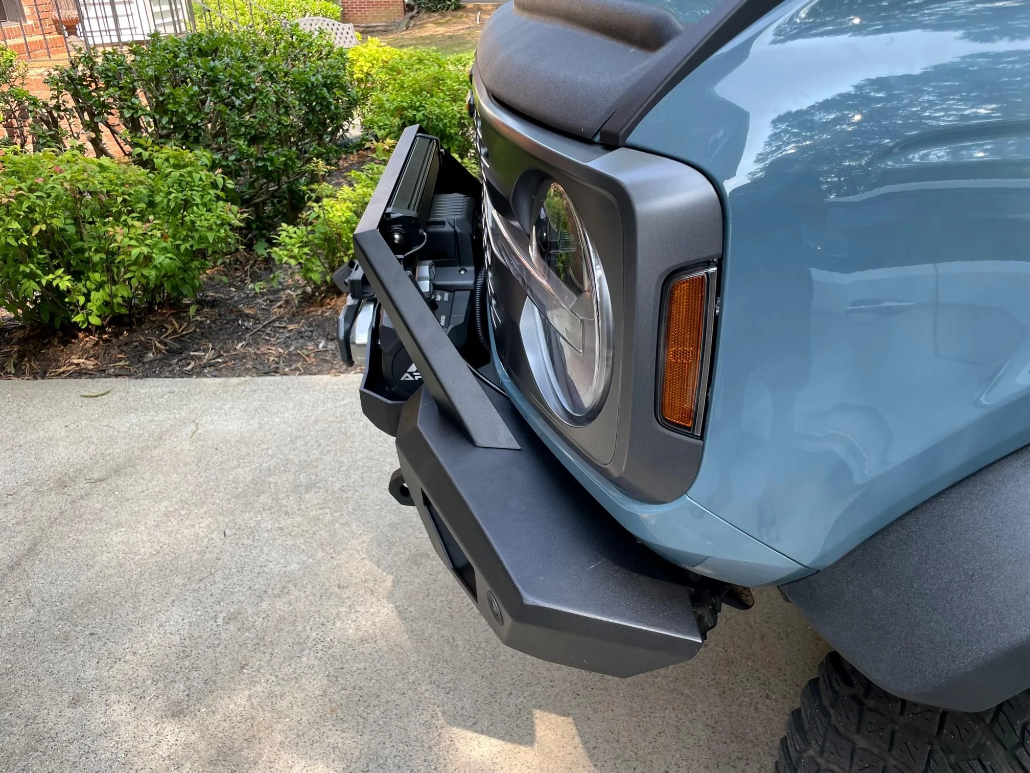

Great job, looks great! Very beefy. Can you relocate that camera anywhere? Right below the bull bar would be ideal I think.
Omdiaz01
Omdiaz01
Omar
Mar 14, 2023
62
Atlanta , Georgia
Bronco Badlands w/Sasquatch Package , BMW X5 M
@Dimitar I was just having that discussion with a friend today ...he is concerned about the camera location , particularly if a recovery requires the line to pull right over the camera. the DV8 kit came with various options to mount. I will try under the bull bar . Thank you
