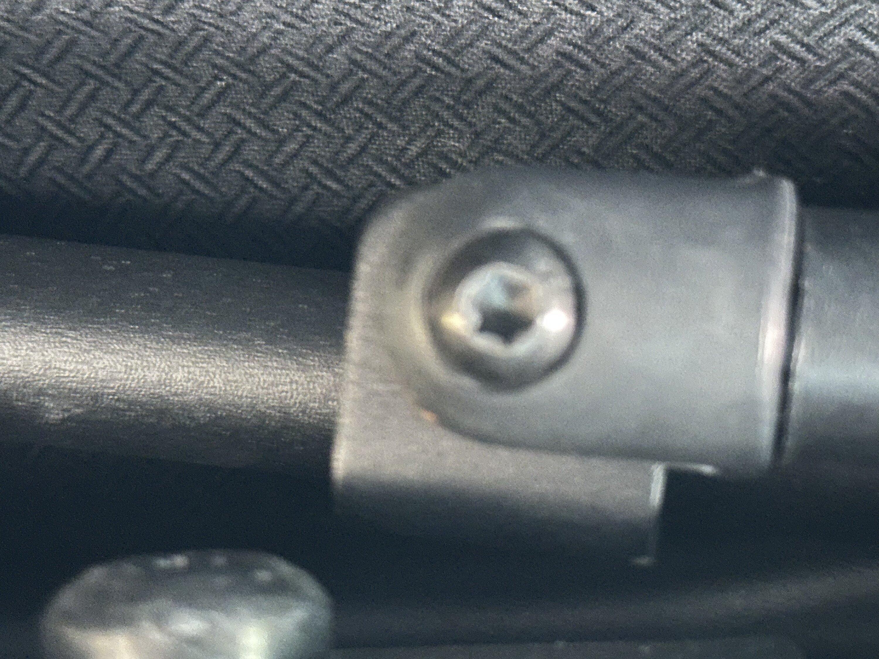

Quick question, one of the joints is missing a bolt on my soft top and I wanna replace it, bit I cant make out what size it is on my bestop soft top
Ill get what I need soon, just need to figure out what size I need to replace it

Pretty sure that’s a . . .
M6 X 1.0 X 15MM
Part #533.61 from Bestop
Uses a T-30 Torx bit
Just finished installing my Bestop Trektop and that’s what that one looks like for the control arm.
While we’re on the subject - would have been nice for Bestop to include some extra screws. Lost a screw and a washer somewhere behind B pillar and had to scramble for backups.

I’ve had two of those bolts back out and fall out. Luckily found them both. Applied loctite, reinstalled and no issues since.
