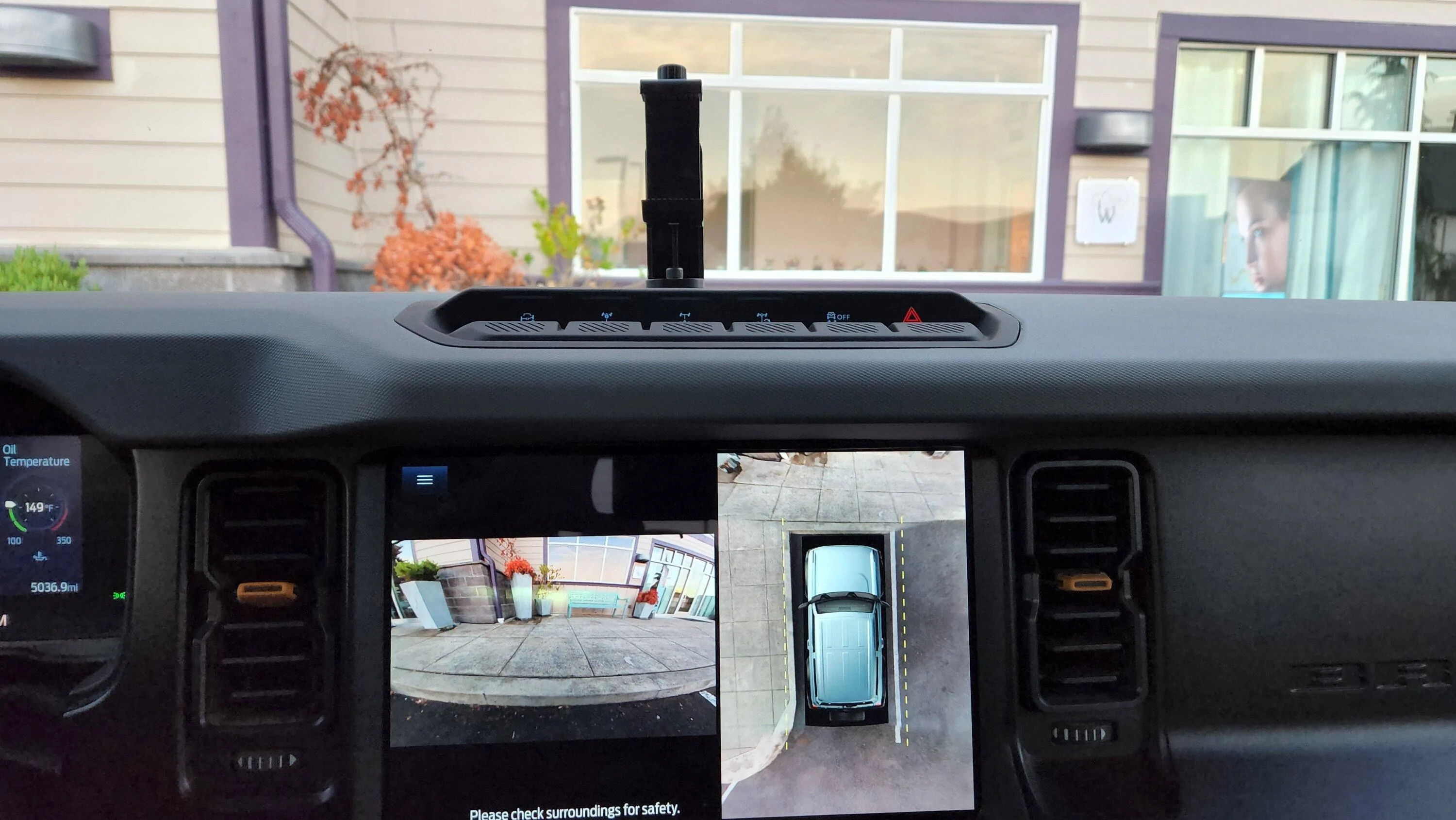

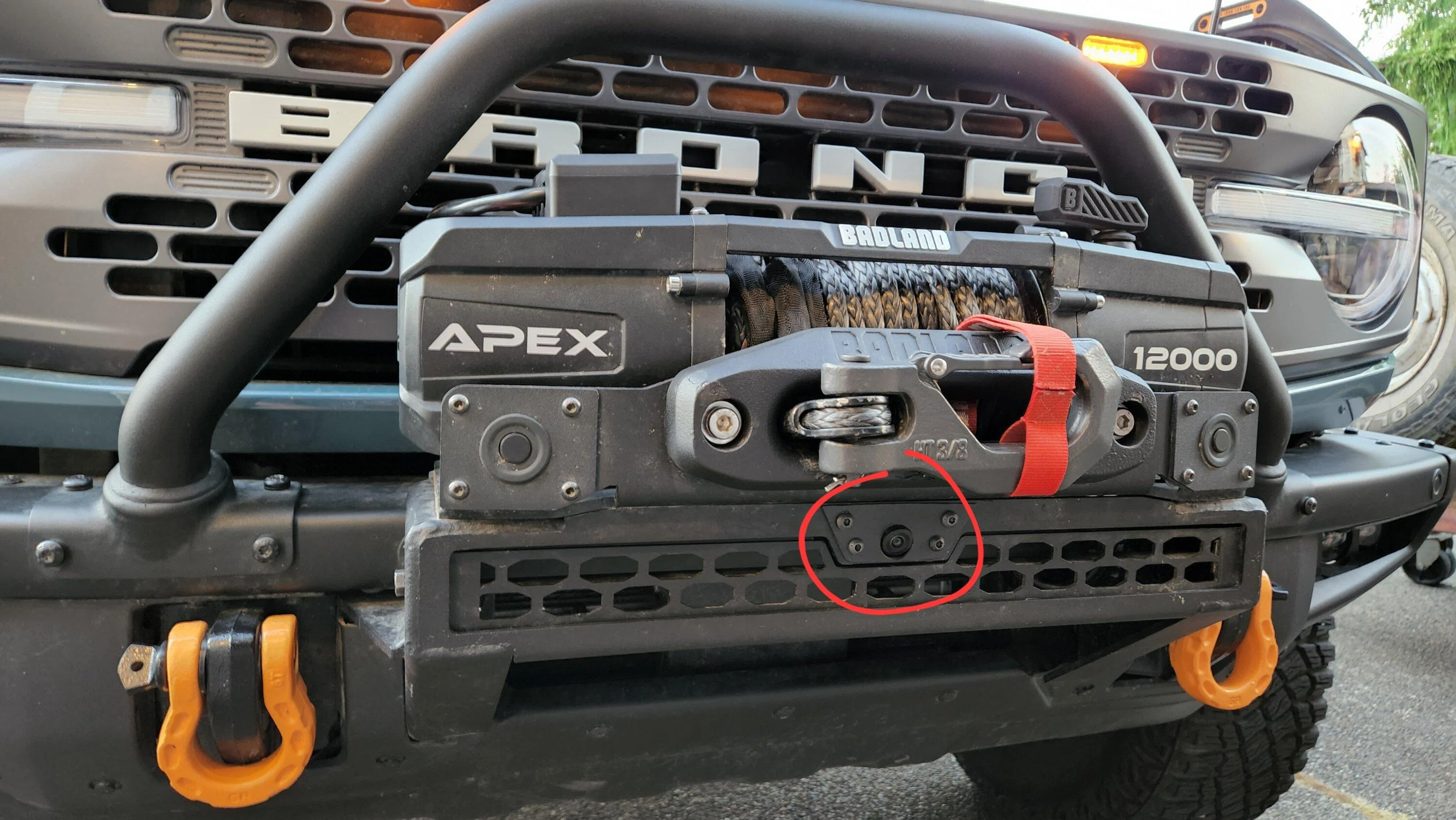

It should be ok. Haven't been able to use it in its final configuation yet... the camera extension cable I got thru Amazon didn't work. 🀬 New one comes in tomorrow. I'll take pics.
... but I did a test fitting with the original cable to get the angle right (30Β° aims at the same spot about 6' in front of the bumper as when it's grille-mounted). Even though it was about 8 in off center to the passenger side (because it was too short to get in the exact location)... I was surprised that it looked just fine even then.
Note: the original cable is about 3' and is female-to-female. You can order a 3' male-to female extension (like I did the first time)... or a 6' female-to-female to replace the whole thing (which I did with the reorder). I decided not to use the washer attachment... if I cut the hole any lower for it, I would have had to cut all the way through the bottom of the bracket. I just capped it off next to the camera connector at the top of the core support.

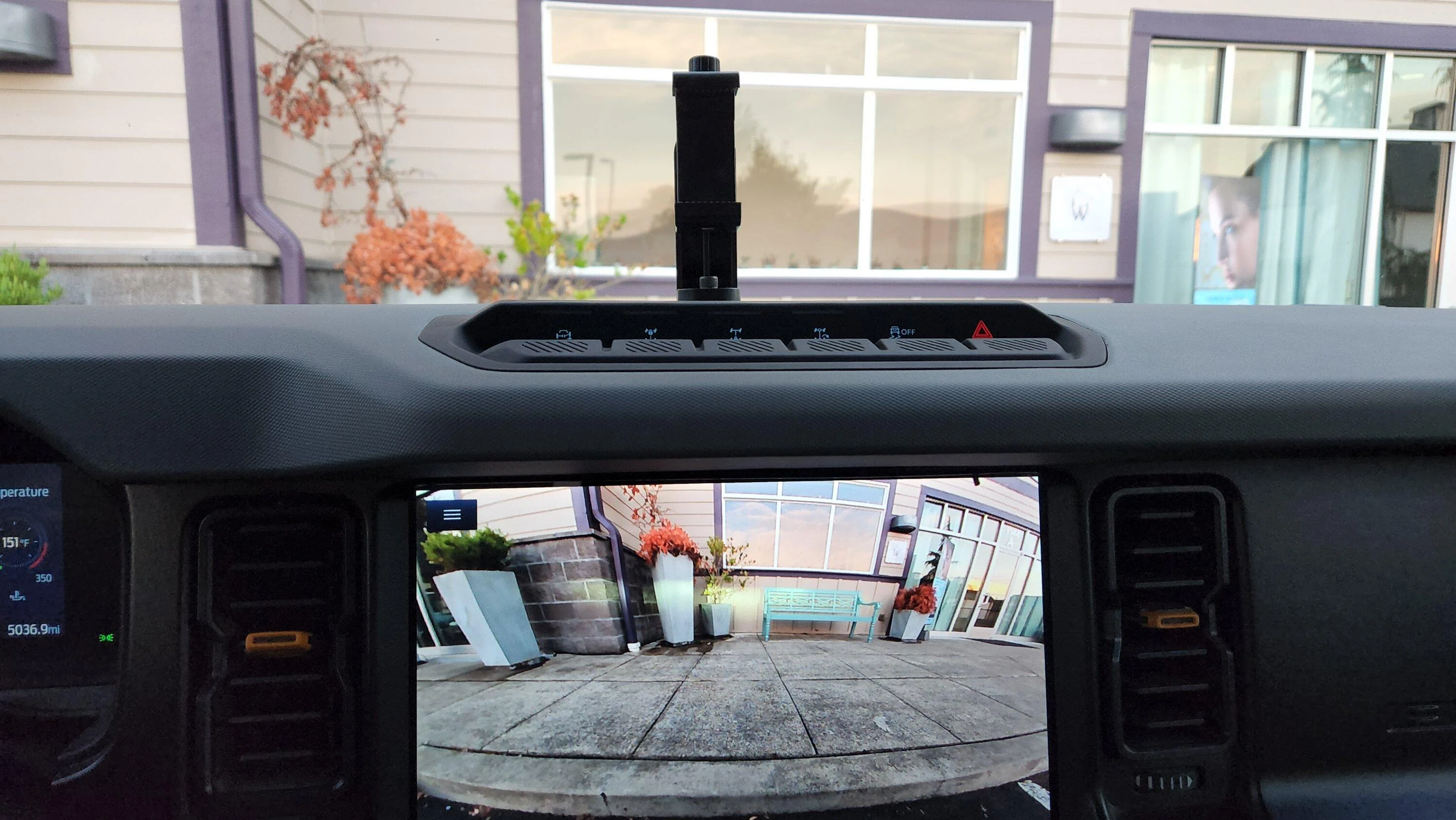

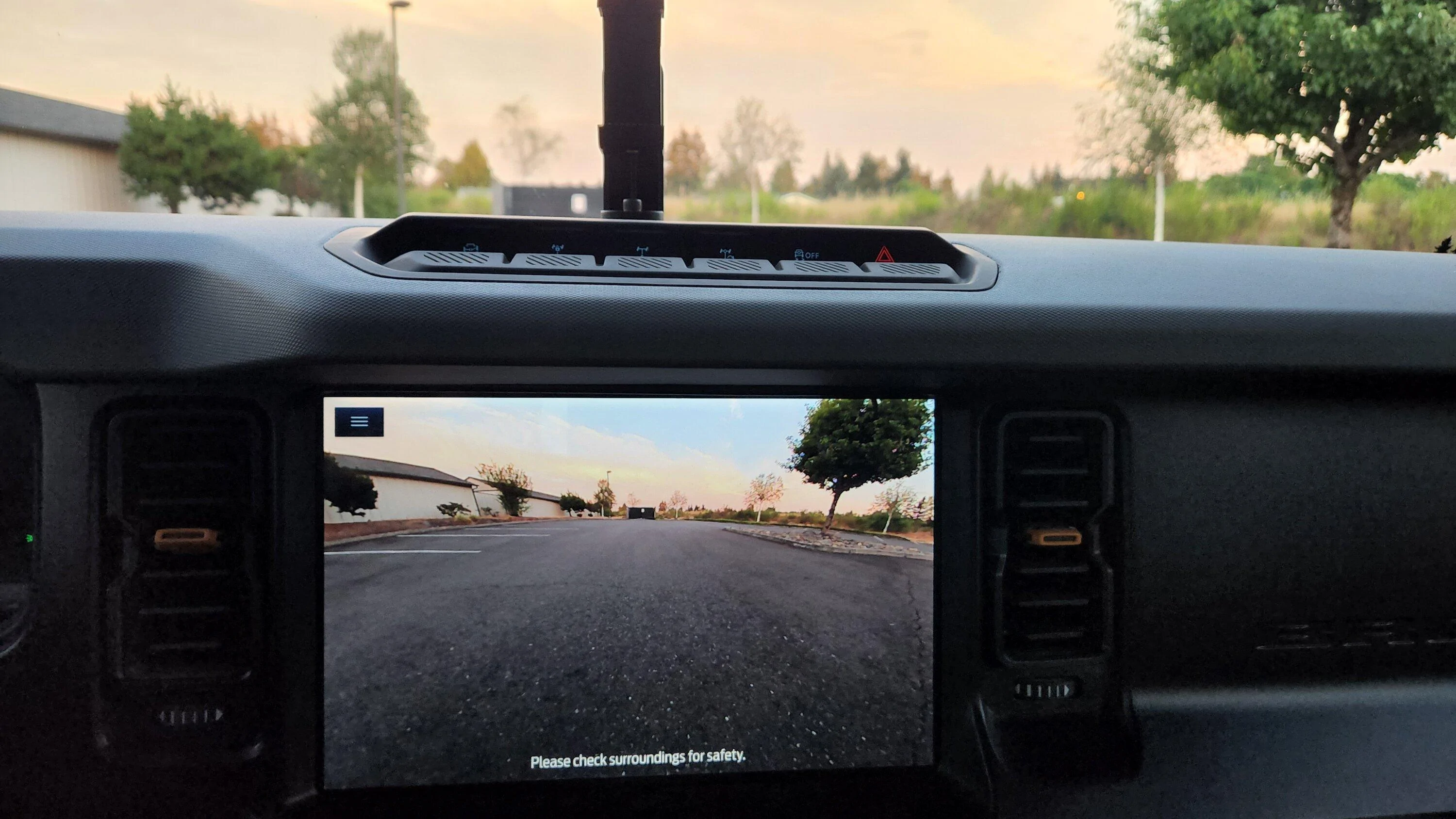

Replacement cable arrived. Here are the pics from the relocated camera. Expected there might be some interference up top from the fairlead and winch hook... but there wasn't. I'm pretty happy with the result.

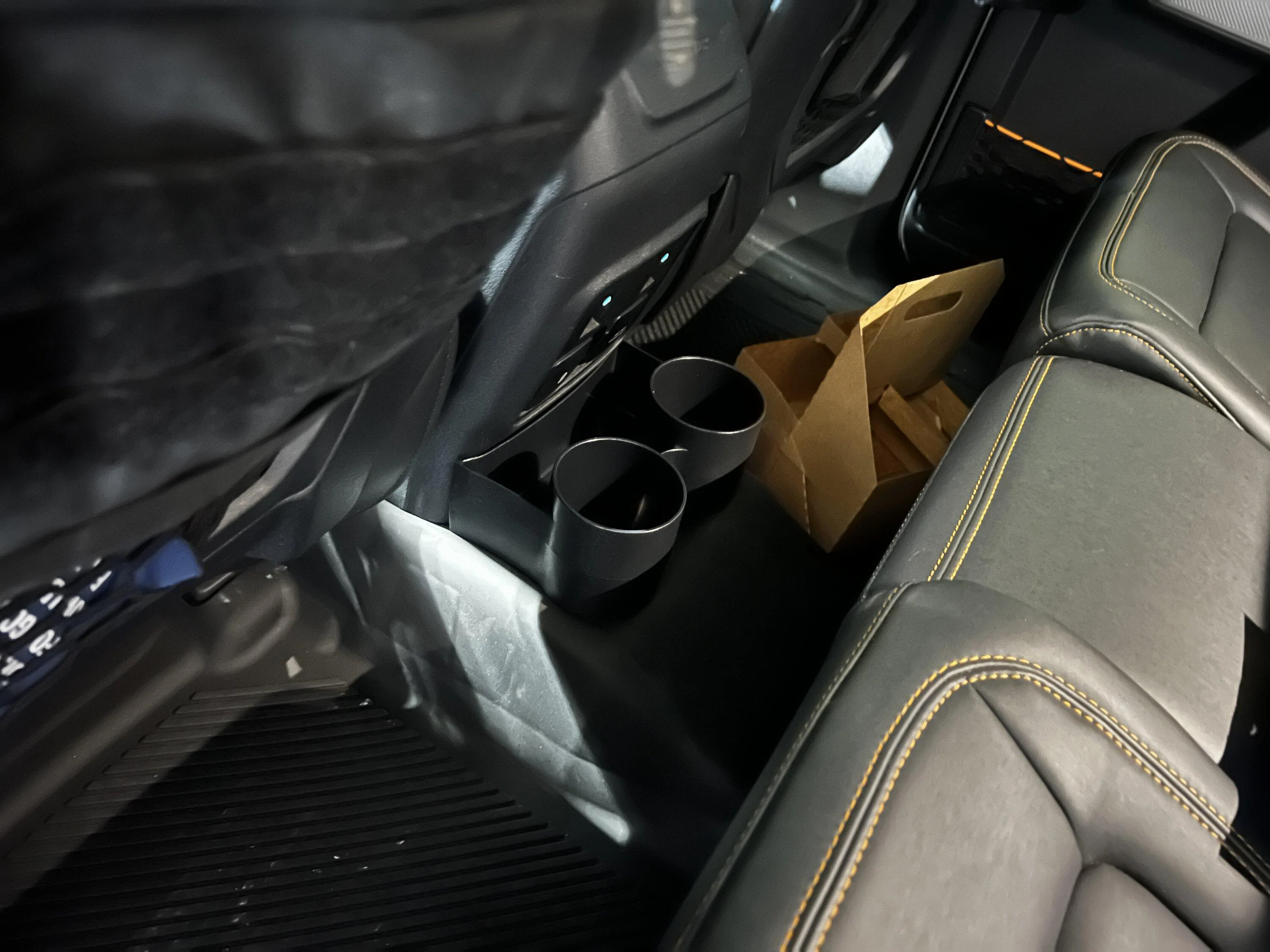

Installed IAG Cupholders. Less than 10 minutes start to finish. Great solution. You can see my temporary solution next to it in the floorboard πŸ˜‰.

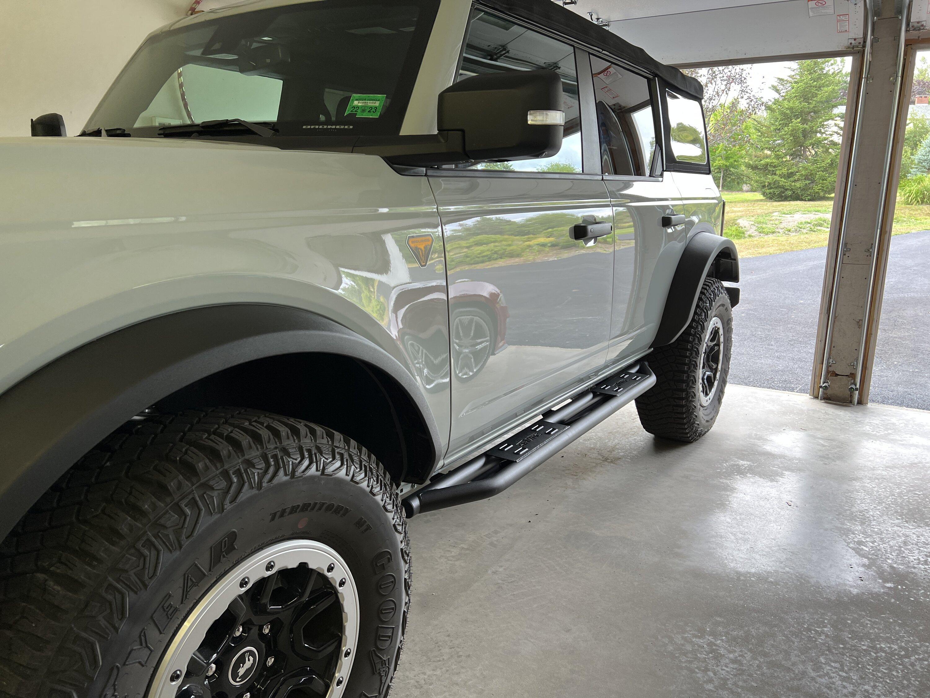

Installed the Havoc trail crawlers today. I’m a little on the fence, they seem to make it harder rather than easier to get out of the truck.
Really? Bummer... just ordered a set. I guess I'll find out. I'll be going from the factory tube steps to the Havocs. It was hard to pass up the price.
Ford Bronco What did you do TO / WITH your Bronco today? πŸ‘¨πŸ»β€πŸ”§πŸ§°πŸšΏπŸ›  F8F5DA2E-CDB4-4C52-8DB7-3843860350CC
Have the Zroadz on mine. I'm 6'1" so it's not bad for me, but they definitely are a little higher than most steps. Putting a grab handle on the roll bar helped some of my shorter passengers. I just step over it on my way in/out.
