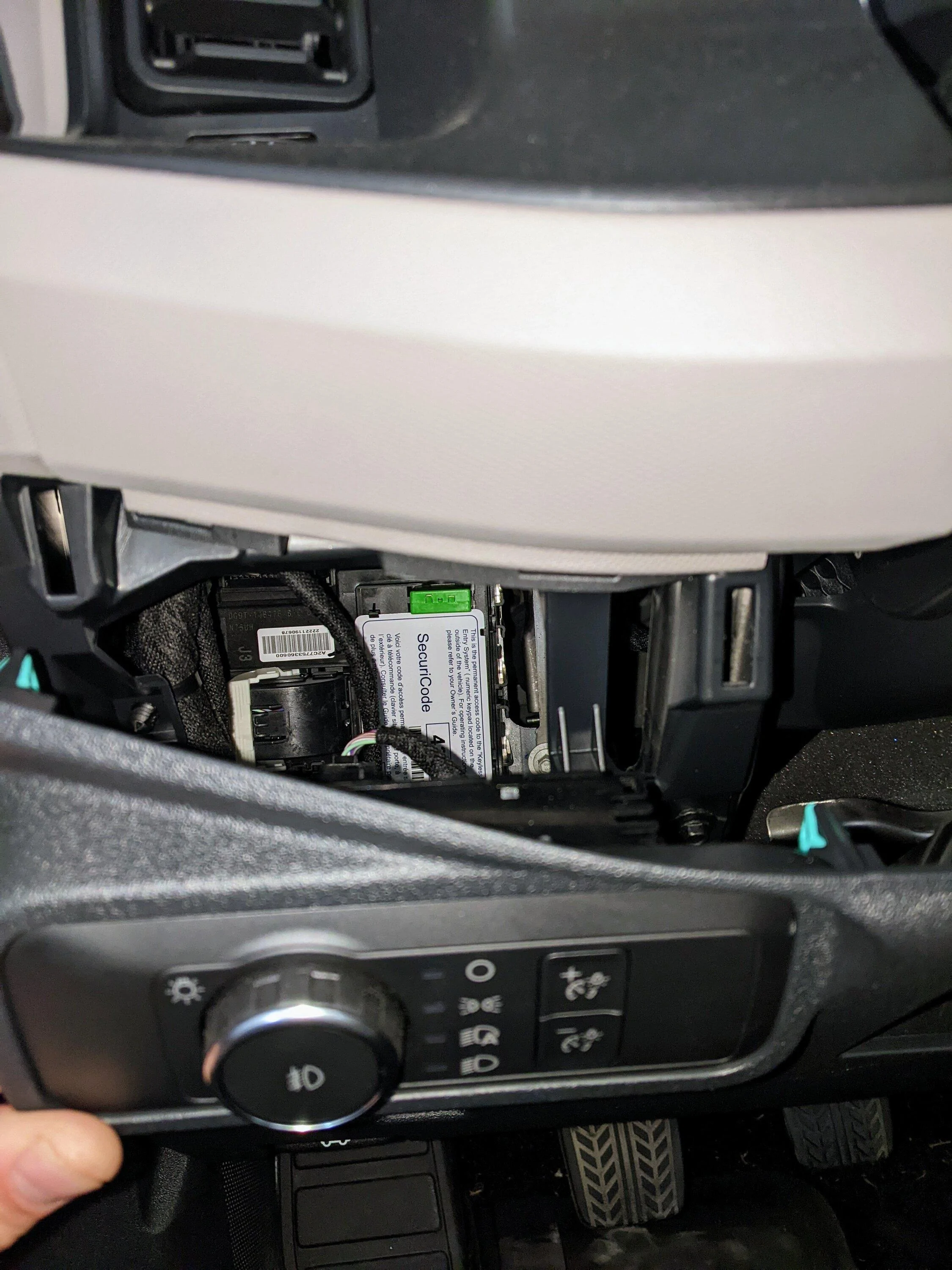

Mine had it in the glove box. It was a business card sized hard piece of this plastic.
If you pull the entire panel under the steering wheel down, it is hinged on the bottom and gives you access to the interior fuse block. The fuse block is located back under the dash, behind that panel on the leftside of the opened panel. There will be another card on the fuse block with the code on it.
If I remember right, I entered that 5 digit code and then I was able to enter a second code that was easier for me to remember twice and now that is the only number I use.
You press the 2 right hand buttons to lock the Bronco and when you come back you enter your code to unlock it.
Here is a good video of it and what the card you are looking for looks like.

Thank you for the details! Yep, there it is hiding right behind the headlight controls.
