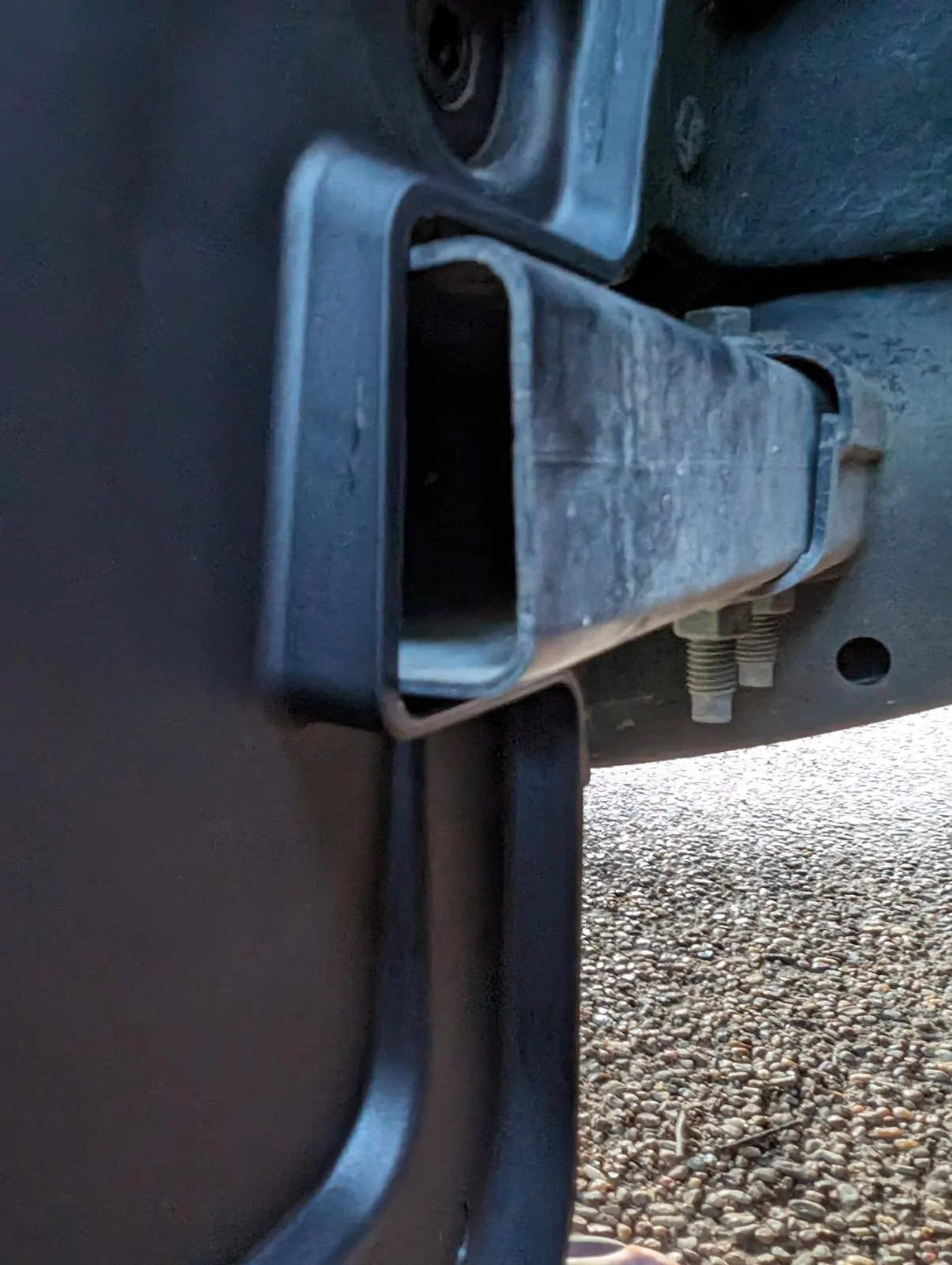

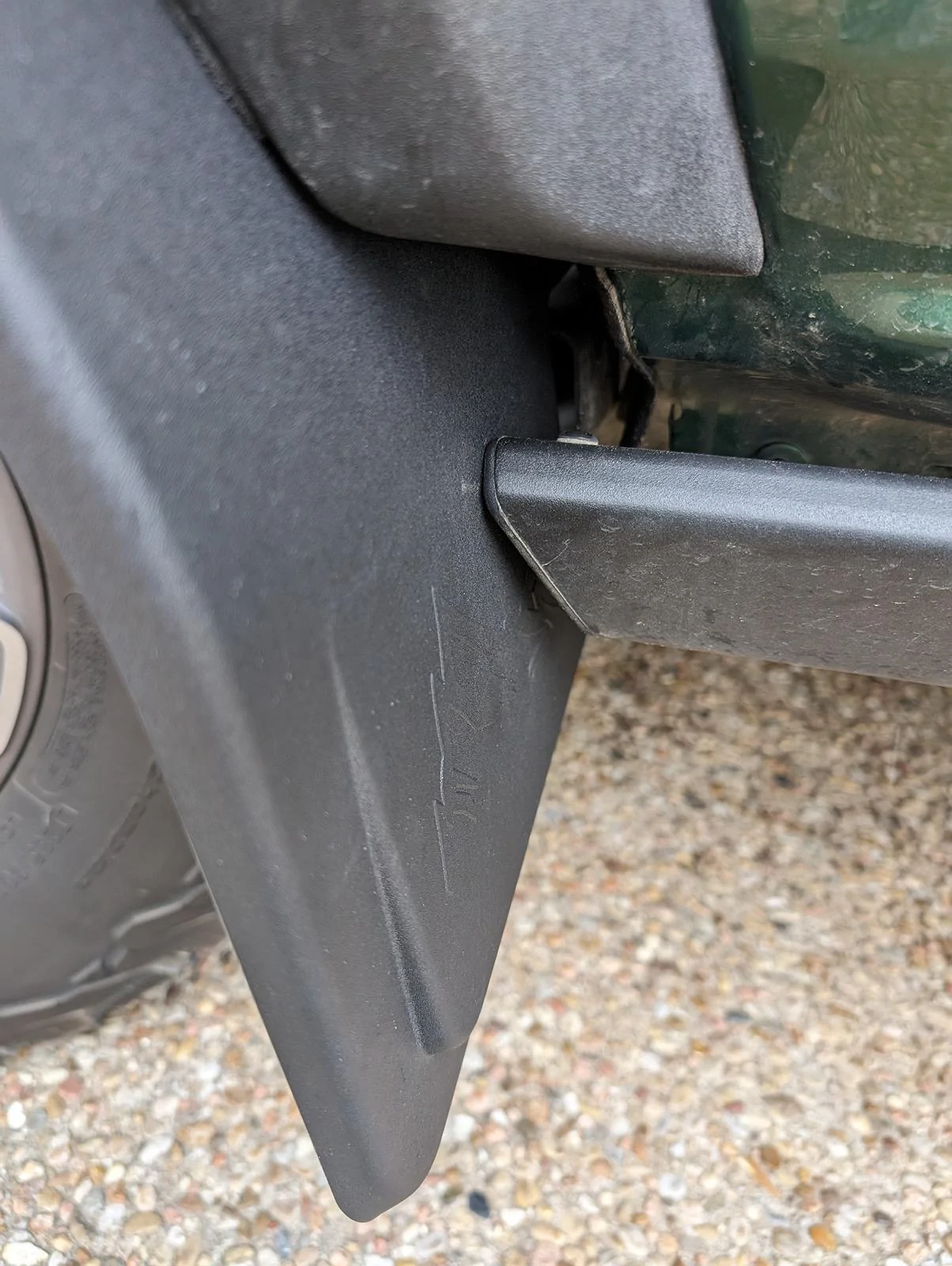

1. On the drivers side, the metal bracket is at a bit of an angle and as such the flap actually touches the rock rail at rest, is this by design? Pictures I've seen show a fairly decent gap between the 2.

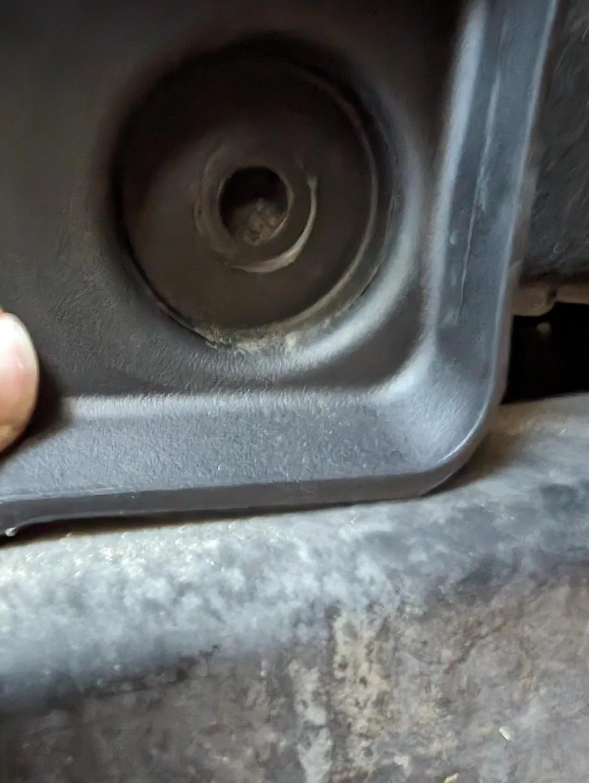

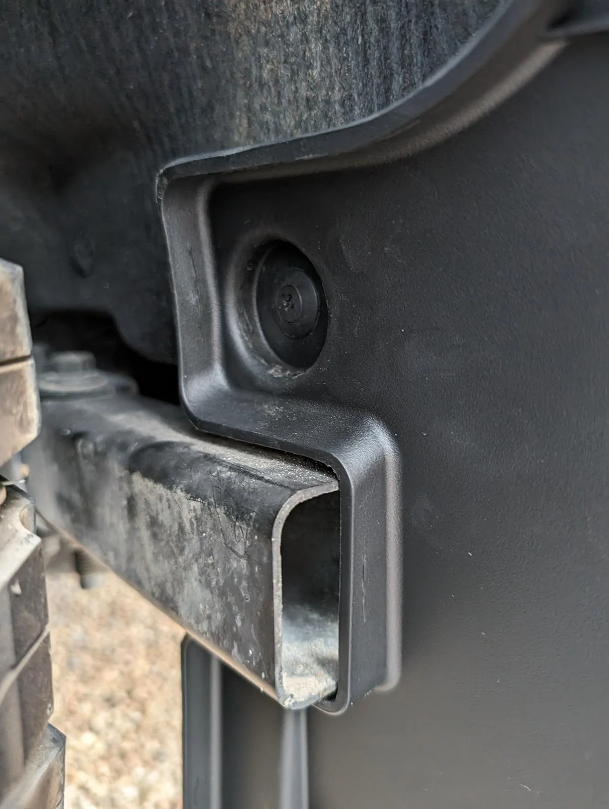

2. I can't get the passenger side on at all due to the hole for the plastic clip (inside most hole) not lining up. I can get the clip in, but at such an extreme angle it doesn't secure properly. Hard to get photos, but below you can see the "U" cutout is touching on the bottom of the rail/bar and still not close enough to the hole to fit.
Ford Bronco Fitment Help with Mudflaps PXL_20240425_002132090
The "U" shape is touching on the bottom and can't go up any further to meet the hole in the fender.

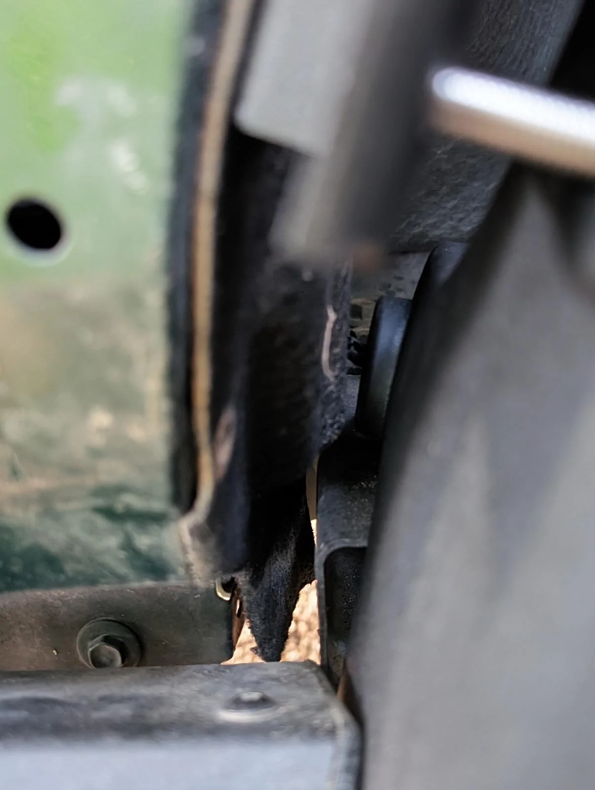

Fuzzy pic, shows the hole doesn't line up.

hard to see but the plastic clip is a pretty extreme angle to clear the hole, and as such won't screw down and secure.

Are these the Chinese knockoffs of name brand parts? Itā€™s plastic, modify to fit, slot the bolt hole. Donā€™t worry about the flap contacting the rock rail. Nothing is perfect, there are allowed tolerances and sometimes stuff just doesnā€™t line up perfectly.

As for the rubbing on the rock rails, thatā€™s how mine sit in there too and thatā€™s what the sheet of sticky felt is for ā€” to mitigate the metal on plastic rubbing.
With your other issue, I donā€™t think I experienced this if Iā€™m understanding the photos. I believe that hole lined up fine on mine.

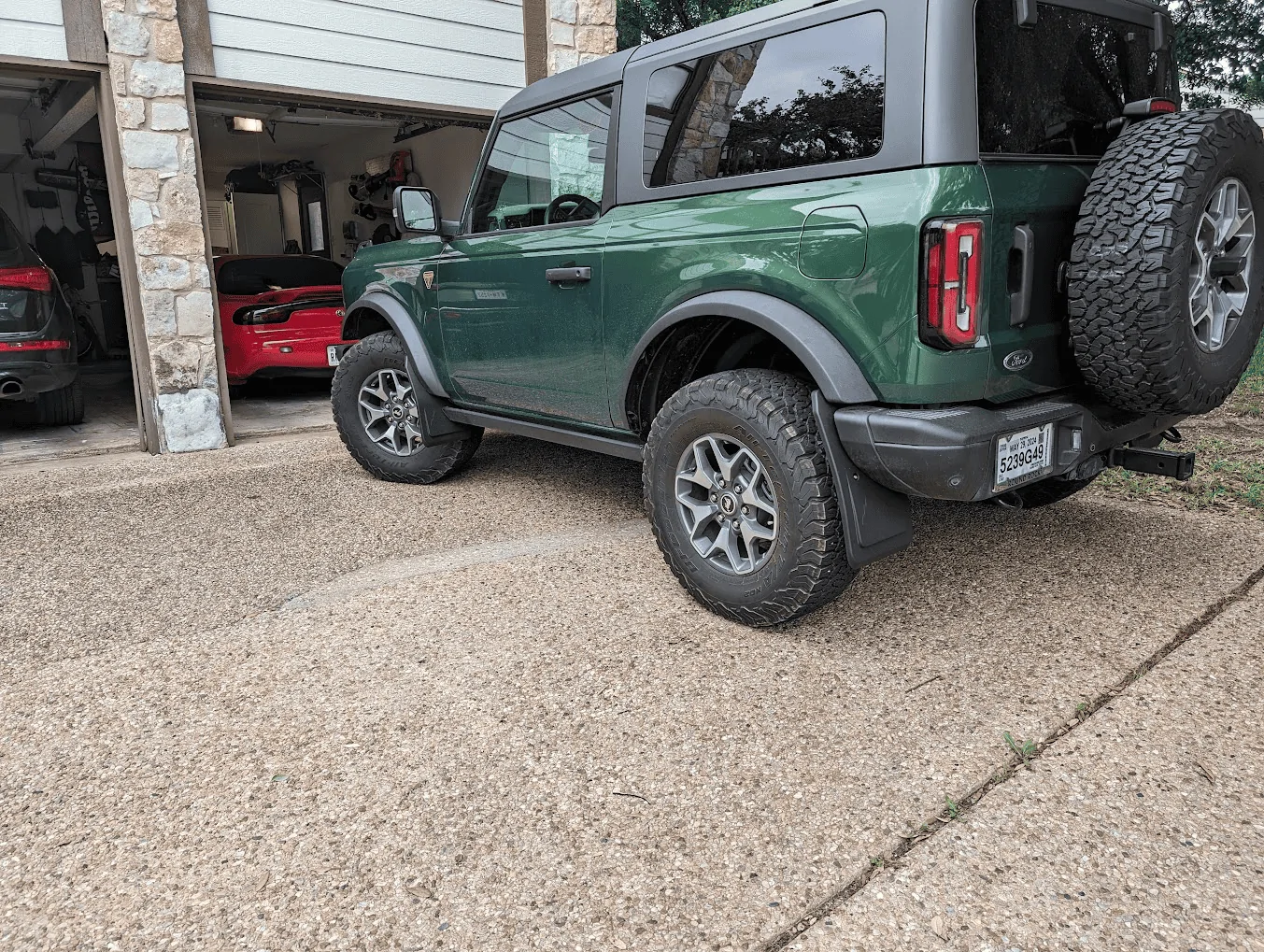

I did end up dremeling the holes out to fit, and the rear was a bit less painful, although I had to squeeze some plastic to get them lined up. I will be finding some shorter bolts so they aren't so obvious as well.
My purpose of this thread was to see if I got a funky set, or if the fitment was a bit over the place with these. Sounds like the latter, but for the price I am happy with them.
My most common use for the Bronco is going to be mud + pasture driving, not so much rock crawling so I figure they will last for quite a while.

Precisely what I did. Had to slot the holes in order to get the push pin in on one side. Drill press made quick work of it...
