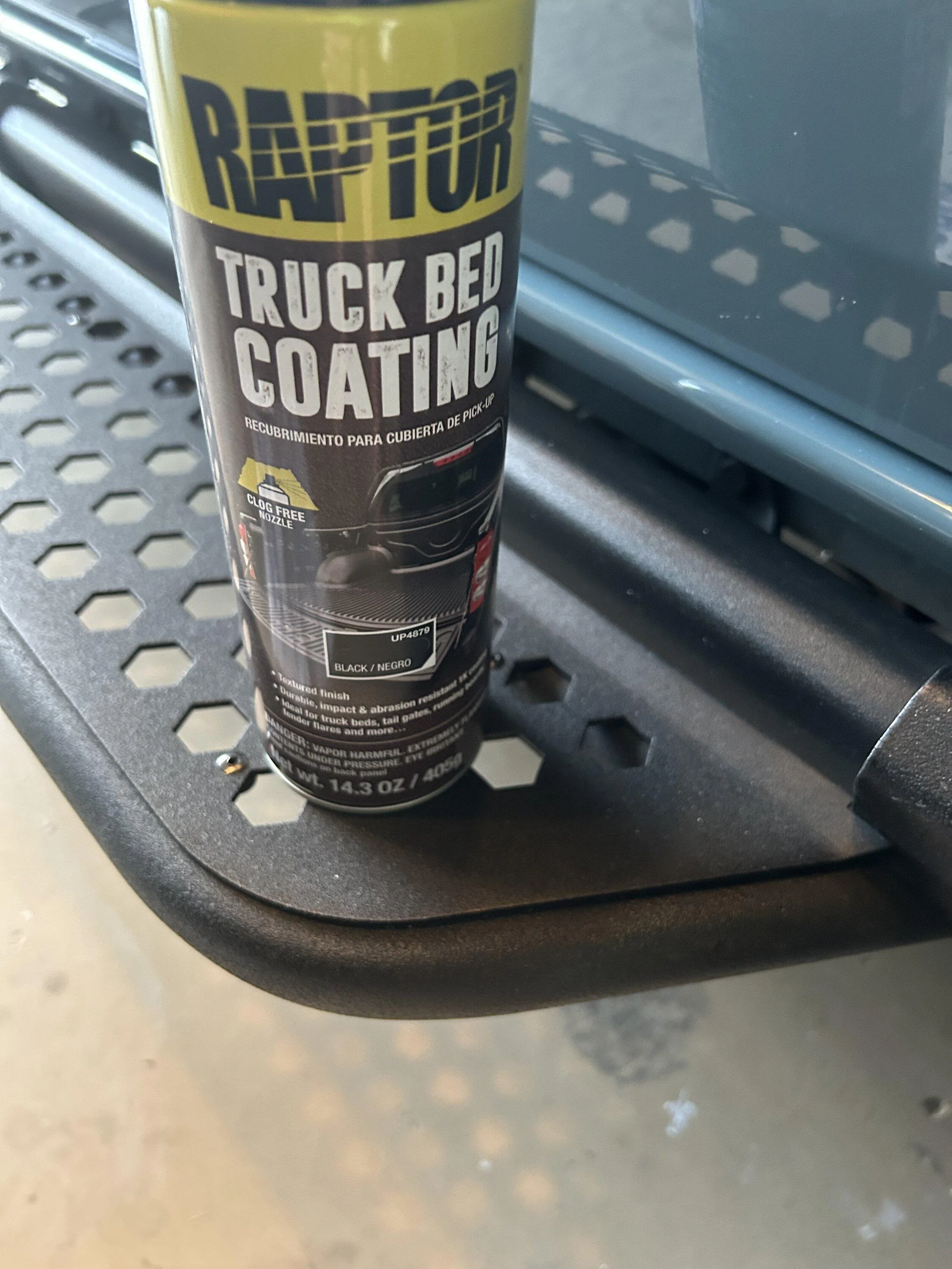

This is a perfect match. I ran edge of my step along garage door opening. Stucco over block. Long story. IAG finish stayed on but finished was shall I say different after. This bedliner spray matched perfect.

I used that on ez steps to. Covers great. Comes off a little glossier than original, but should blend with use

Or hit it with a little acetone when dry

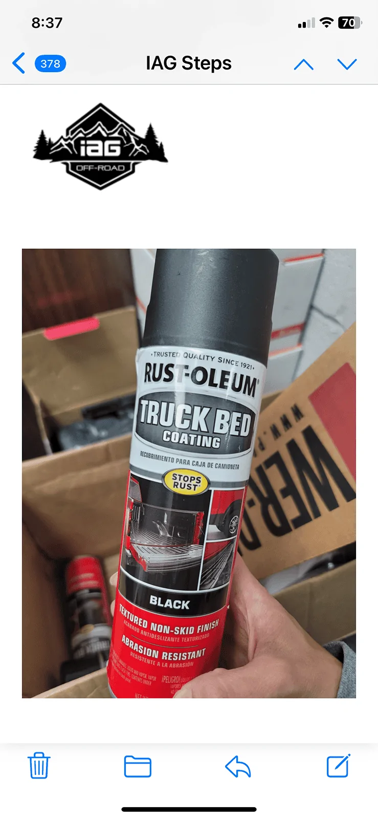

I had a similar issue except mine was rocks on the trail. I reached out to IAG directly and Kathy in customer service provided great advice. She sent me the following picture of what they would recommend for touchups to their steps. I have to say it matched perfectly.
Ford Bronco IAG ez step touch up tip IMG_8155
I guess EZ steps are also EZ to touch up.
