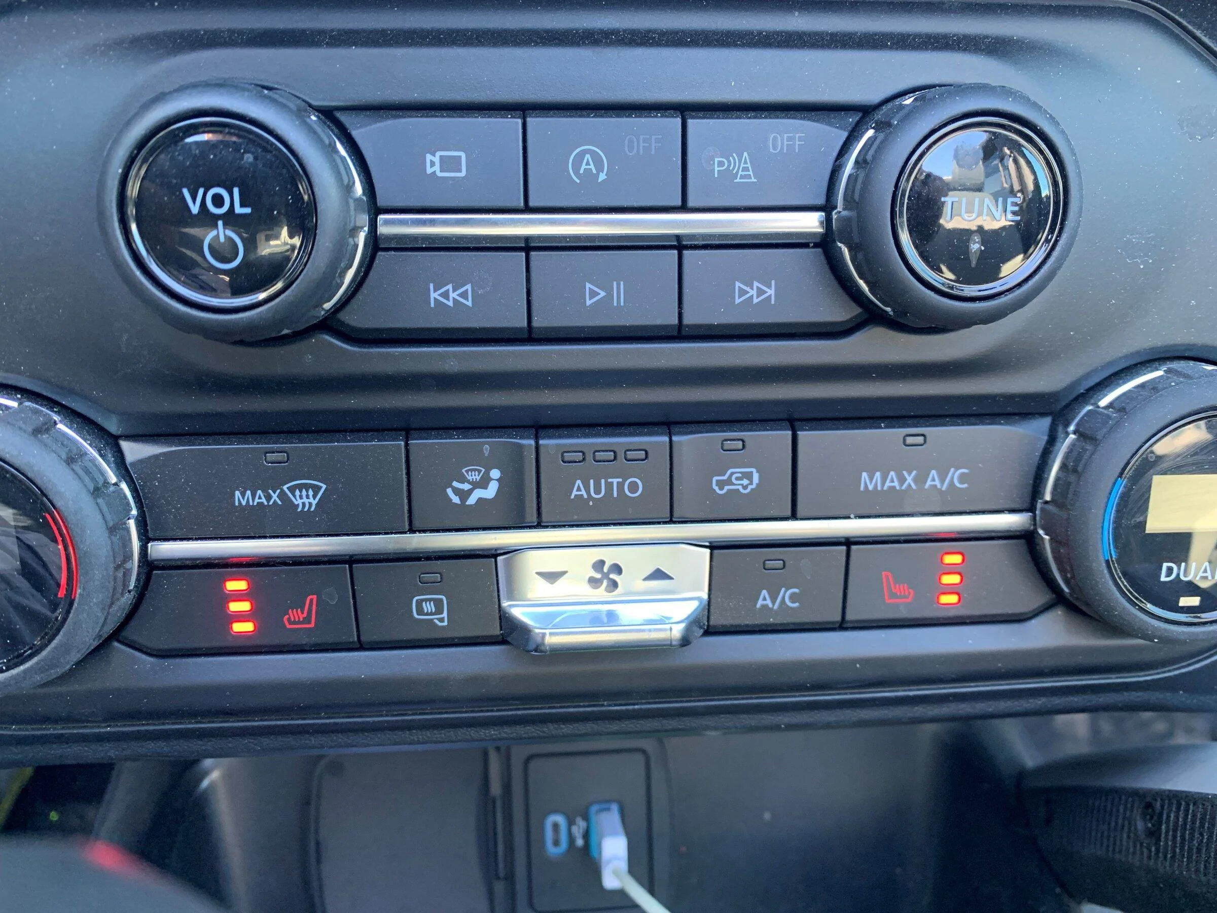

All of a sudden my seat heaters stopped working. As you can tell from the pic I have power at the controls. Fuses seem fine. Any ideas? or should i hit the dealership service dept?

Both sides? If only one side, did you check plug connector under the affected seat?
At any rate, all new Ford vehicles come with a 3 year 36,000 bumper-bumper warranty that covers nearly everything, including this. Dealer can sort it out for you for sure.

yeah both sides are out .... the dealer is so busy it takes a while to be seen, thats why i posted here first.

Is there any way you can reach under the dash to see if there is a connector that has come loose. Could be something that easy. Good luck.

sounds like a you lost relays, they likely share a common ground. I would look for a loose/lost ground if you cannot wait for a dealer

which end of the dash?

that's logical but hunting for a loose wire in the maze of this engine? I'm not capable of that
