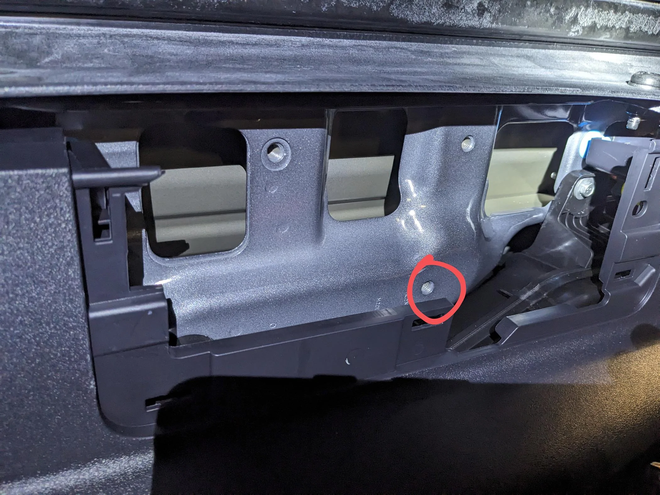

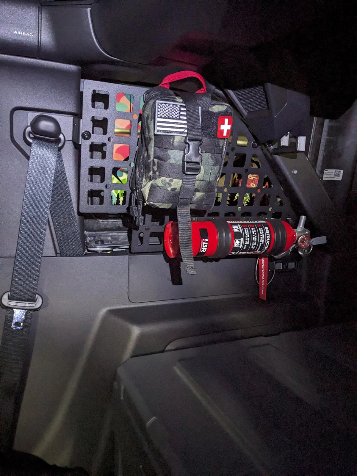

Added turnoffroad's rear window Molle panels
https://turnoffroad.com/collections...cts/2021-ford-bronco-rear-window-molle-panels
Two issues with these panels, but other wise pretty nice
Issue #1 - missing 2 bolts for a hardtop install. They promptly sent me 2 additional bolts, but it seems these bolts are not included by default
Ford Bronco What did you do TO / WITH your Bronco today? πŸ‘¨πŸ»β€πŸ”§πŸ§°πŸšΏπŸ›  PXL_20240323_011153204~2

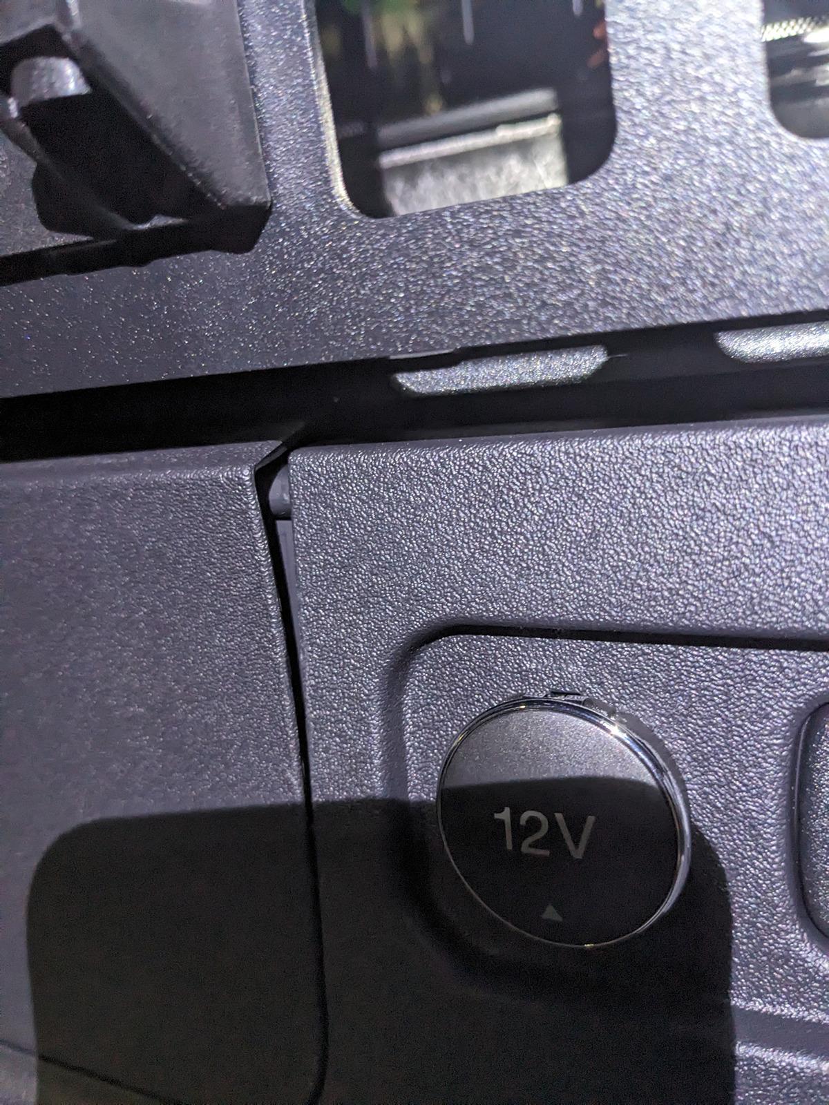

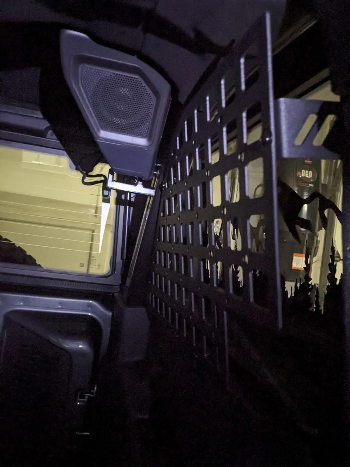

Issue #2 - the trim piece does not sit correctly after installing the bottom bracket
Ford Bronco What did you do TO / WITH your Bronco today? πŸ‘¨πŸ»β€πŸ”§πŸ§°πŸšΏπŸ›  PXL_20240328_234839505
Other than that they turned out pretty nice

For that trim piece that doesn't fit properly, are you sure it doesn't just need a good smack? I found some of the trim pieces (also in the cargo area) to be a bit finicky and needing some extra love to re-attach properly.
If that doesn't work, if you know what it's being held up on, try notching it out. You should be able to get it to sit properly one way or another.

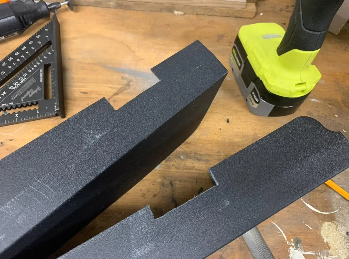

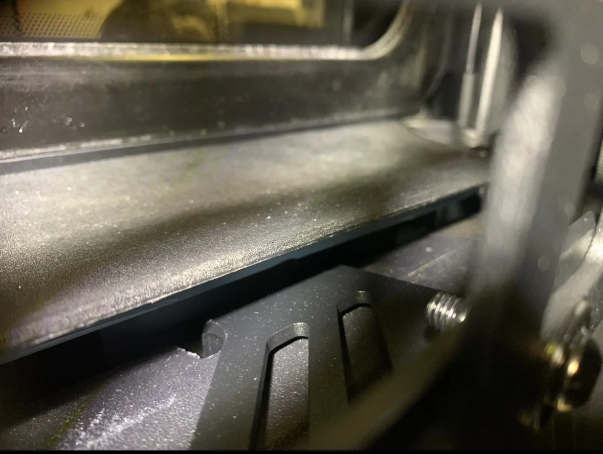

You’re going to have to trim them a bit to get them to sit flush.
Ford Bronco What did you do TO / WITH your Bronco today? πŸ‘¨πŸ»β€πŸ”§πŸ§°πŸšΏπŸ›  IMG_1266
Ford Bronco What did you do TO / WITH your Bronco today? πŸ‘¨πŸ»β€πŸ”§πŸ§°πŸšΏπŸ›  IMG_1265

oddly enough the driver side, (with a little effort) attaches fine, The passenger side, I cannot get both sides to clip in. The bottom mounts on this kit can be flexed, I might try to bend them ever so slightly to get the panels to sit properly.
At the end of the day, you can hardly tell unless you are looking for it, so not a big deal, thanks for the tip
Ah yea, that is another option I could do, thanks for sharing
