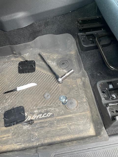

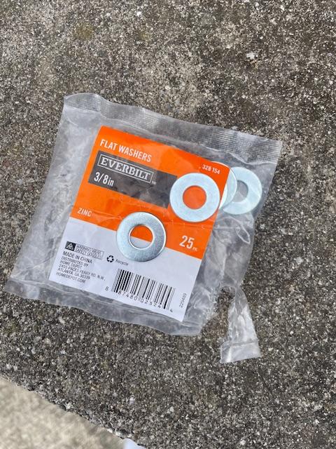

After seeing countless posts here on the seat risers/washer addition to the front seats, curiosity got the better of me and I had to try it.
Trip to Home Depot. 25pk of 3/8” washers for $5.97 plus tax. About 30 minutes worth of work in my driveway we are all done.
Process was simple. Slide the seat all the way back. Little knife to pry off the plastic covers over the front bolts. Best to come at the cover from the side, that is where the clips are. 1/2 ratchet to take the front bolts out. Moved the seat forward to loosen the back bolts. Didn’t take them all the way out, having them still in place made it easier to just raise the front and not pull all four bolts out and have to realign everything. Moved back to the front. Stacked 3 washer, ran the bolt through the seat mount and then the washers. Trickiest part was to get them to stay in place while getting the seat to sit back in place. Tighten it all back up and reattached plastic clips.

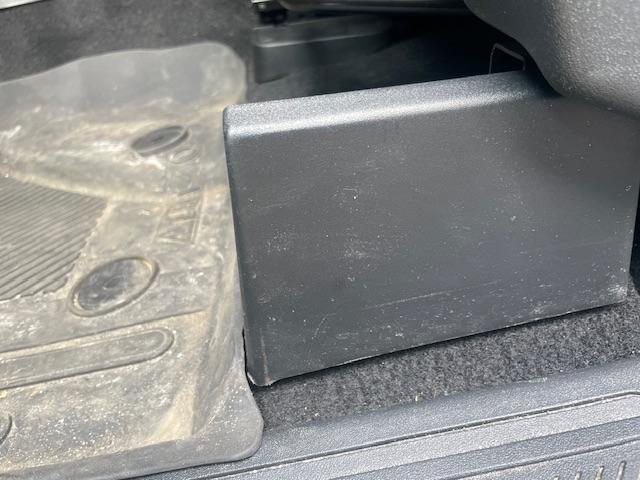

Once all buttoned up, there is now a slight in between the plastic seat trim and the carpet. Which obviously makes sense.
Only did a short drive after it was all buttoned up. It felt better, I think.….but maybe it was all psychosomatic after reading everybody posts here.
Regardless. An afternoon in the driveway tinkering with my Bronco. I’ll consider that a win for sure.
Thanks for the tip everyone.
