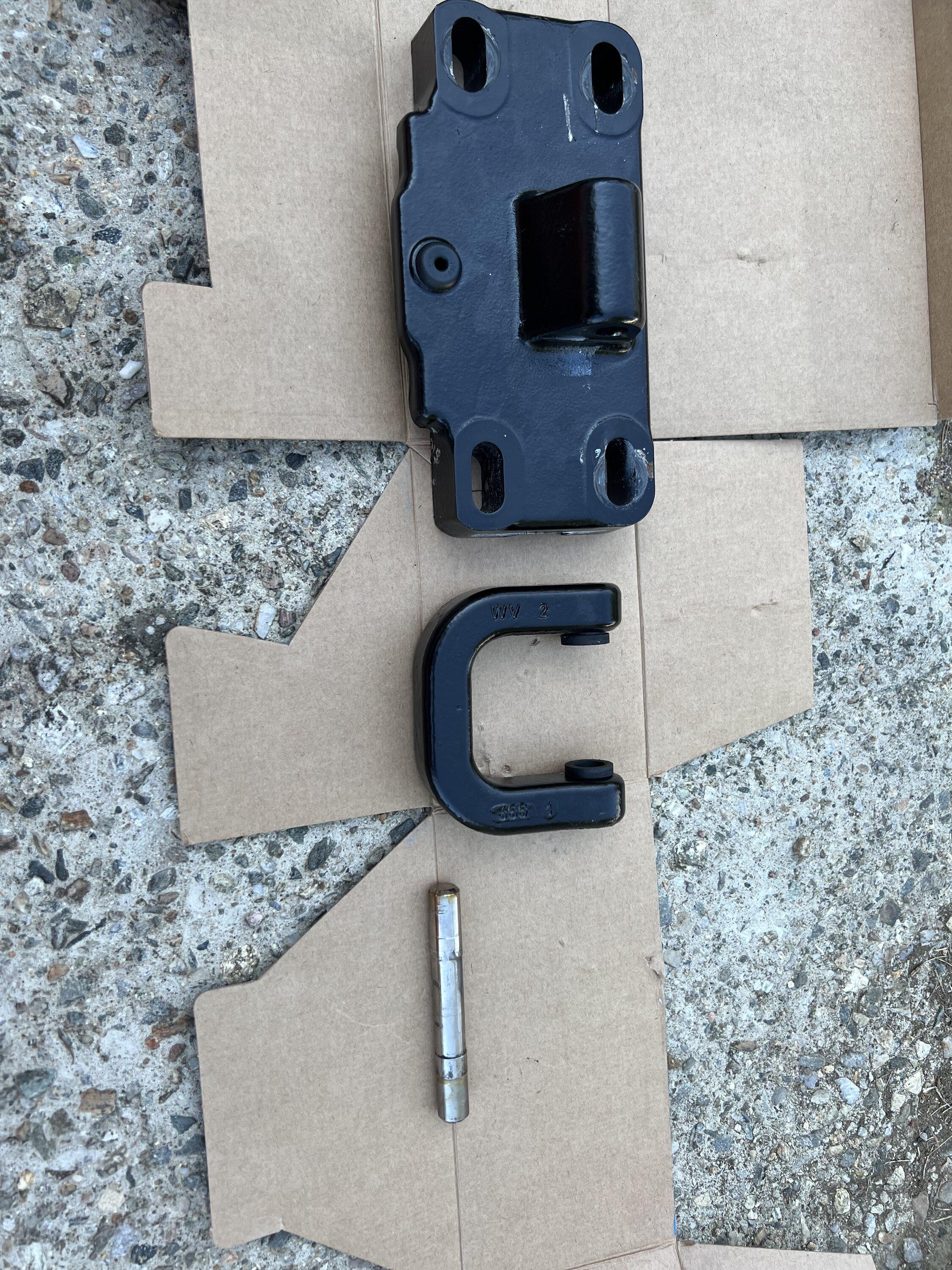

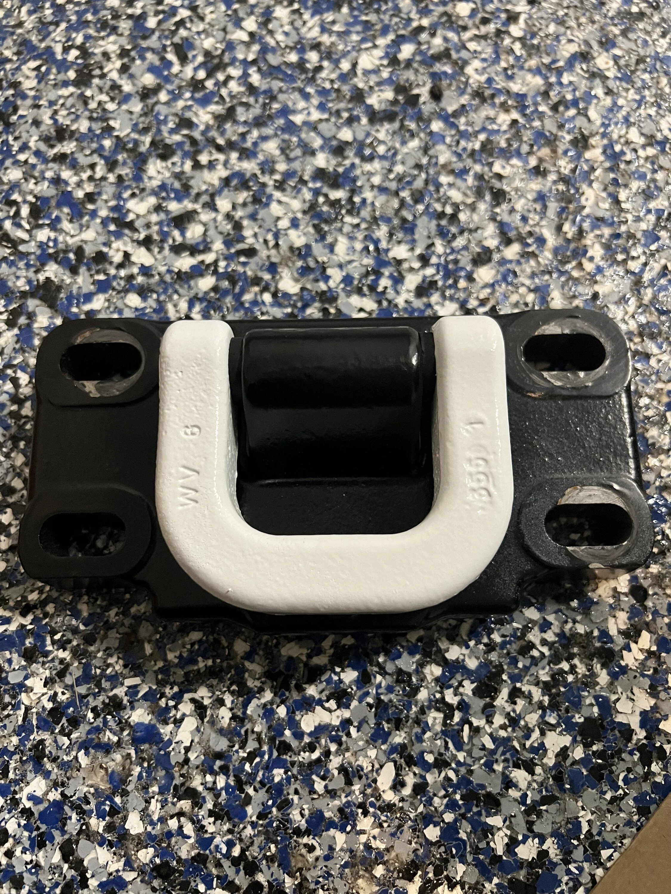

I had wanted to have just the shackles powder coated and they told me they wouldn’t be able to do it with the shackle assembled to the bracket. So I gave it a shot and you can pull the pin on the bracket with a punch and separate the shackle from the mount. Just wanted to inform anyone that was interested. Haven’t reassembled yet. Hope it all goes back haha

Nice work! Bumper removal necessary out how tricky was it to get that assembly out?

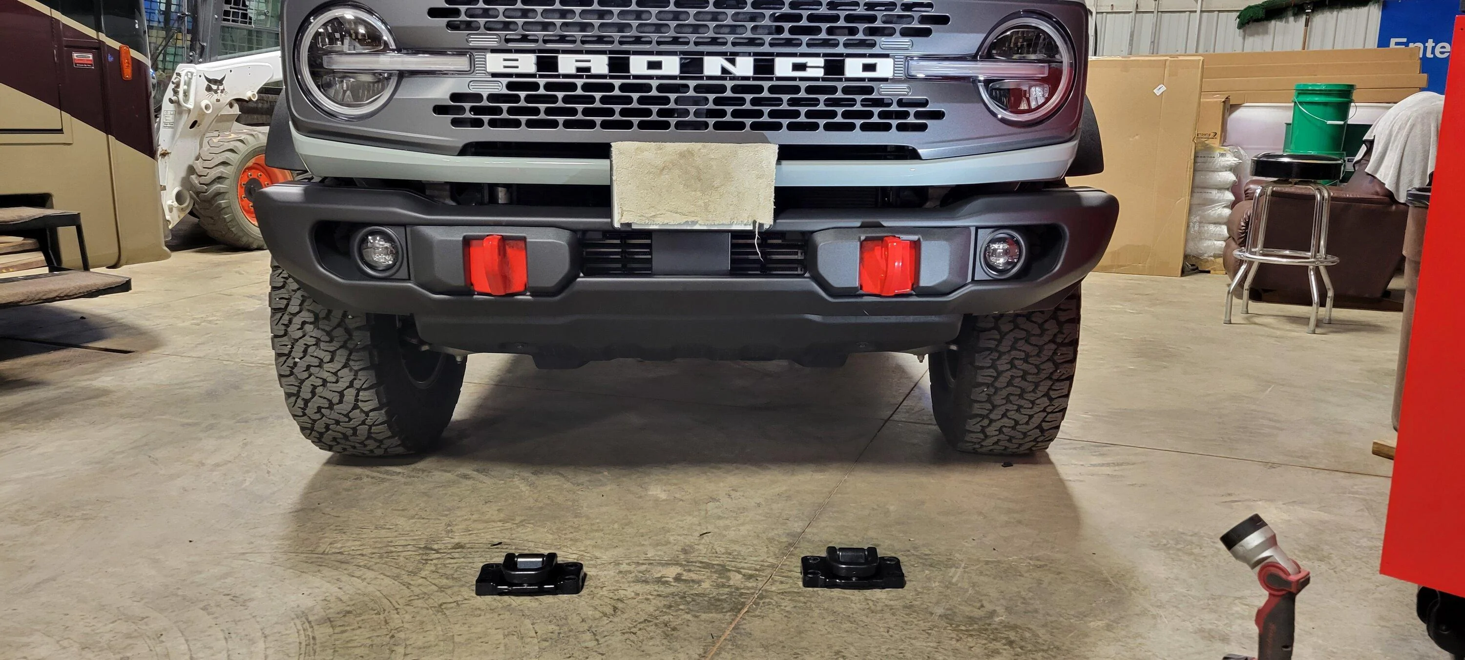

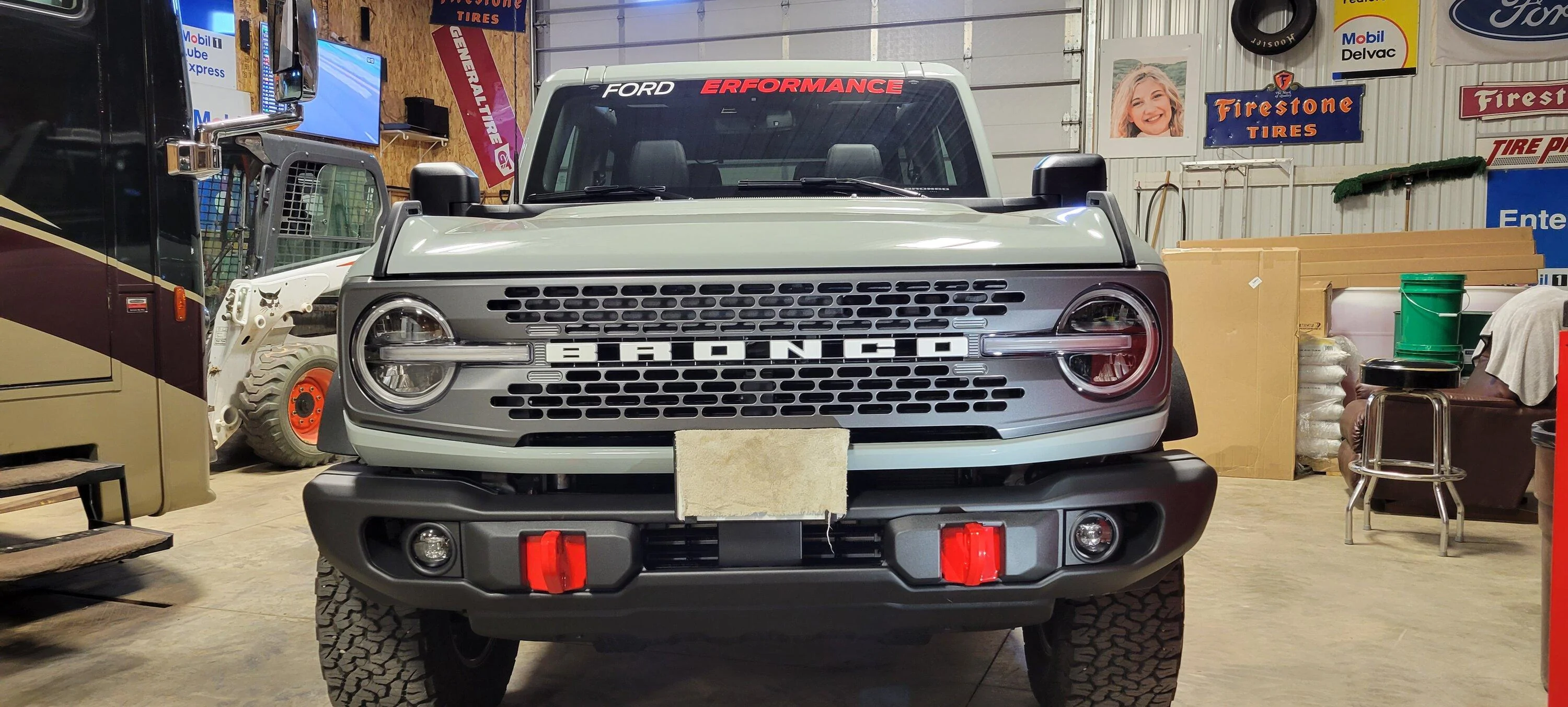

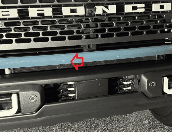

I removed and added these from Ford performance, now I can tow easily behind RV. This Bronco is the most capable fun vehicle I have ever enjoyed. Just a small amount of trimming. If I decide to go somewhere I need the hooks, pop the plastic cove, 3 bolts and done.

Update: all assembled back and went together perfectly. So it can be done taking the pins out and painting or powder coating

Where did you get these plugs? I have been wanting to cover those up.
Ford Bronco Capable Bumper Shackle Removal 1658376979895
Got them off Amazon. It was a big pack with like 5 different sizes. Just painted them with touch up paint first then threw them in.
I wasn’t sure if those would fit on the capable bumper. Looks great

Yes you have to remove the bumper. 6 bolts. Super easy
Ford Bronco Capable Bumper Shackle Removal broncodozer

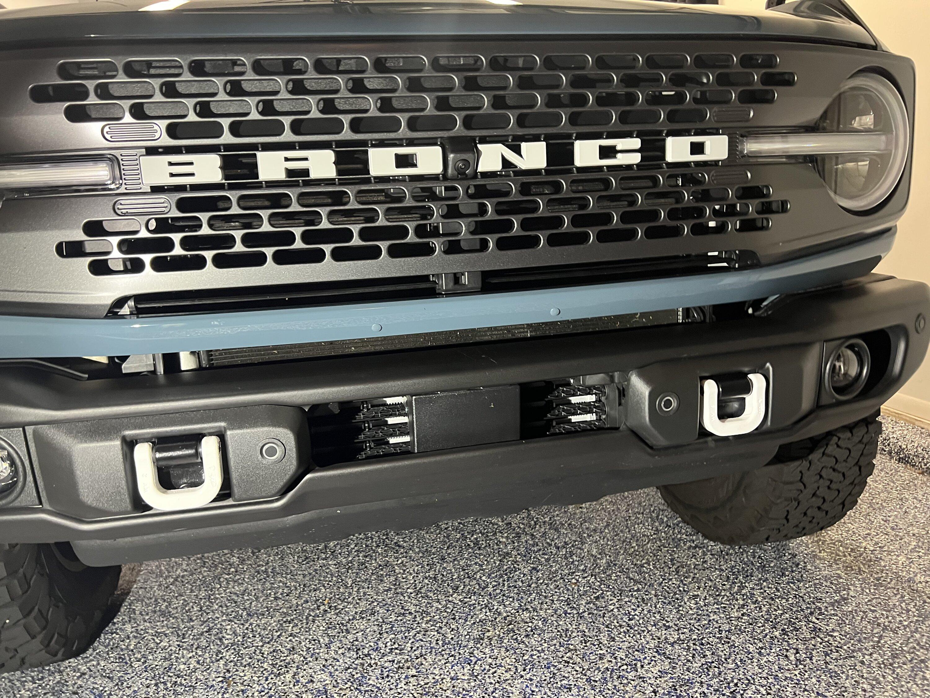

Is this all that separates the capable bumper from tbe standard one? I have the standard bumper with fog lights on my truck. Could that plate be added behind and a cutout made for the shackles I wonder?
