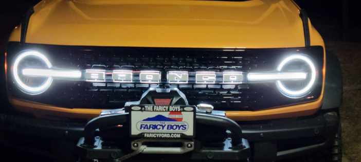

No and no. U need a camera relocation kit and need to disable the front sensors, which u can do in the settings menu
Or relocate them to the front of the winch bumper. You can see the sensors on mine. I also used the JCR camera relocation kit but had to ditch the bull bar. due to fitment issues with the JCR.
How did u relocate the sensors on the ford setup? That’s something I haven’t seen. Mountains2Metal makes a front camera relocation kit that is designed to work perfectly with the ford winch mount. It’s also cheaper than JCR
https://mountains2metal.com/BR6FCRL/
Dealership did it based on a thread from here that I sent them. I will look for it.

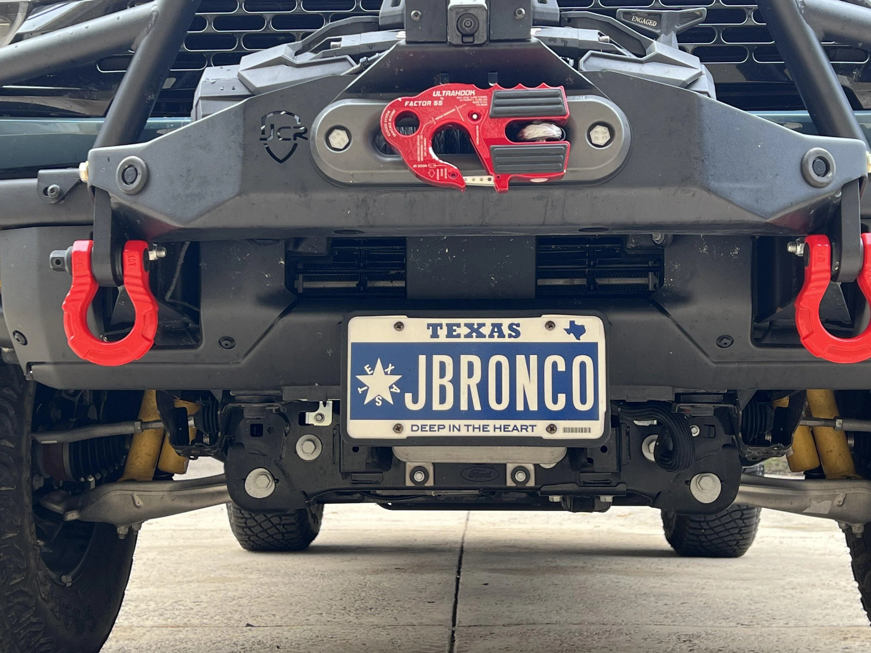

I went with the JCR as well! ACC works just fine.
Ford Bronco Ford Performance Winch IMG_0391
Awesome! You just sold me on this JCR solution. I was originally looking at after-market front winch bumpers and I am just struggling with balancing the cost versus effort. I research the piss out of everything and all the solutions I have looked at, there is a ton of extra cost and effort to buy additional accessories to make something work.......ACC, cameras, parking sensors, etc. I think the capable bumper isn't a bad looking bumper and this JCR solution appears to be cost-effective and relatively simple. I am going to use my money to then get a good rear bumper with swing-out tire carrier and after market wheels/tires instead.
