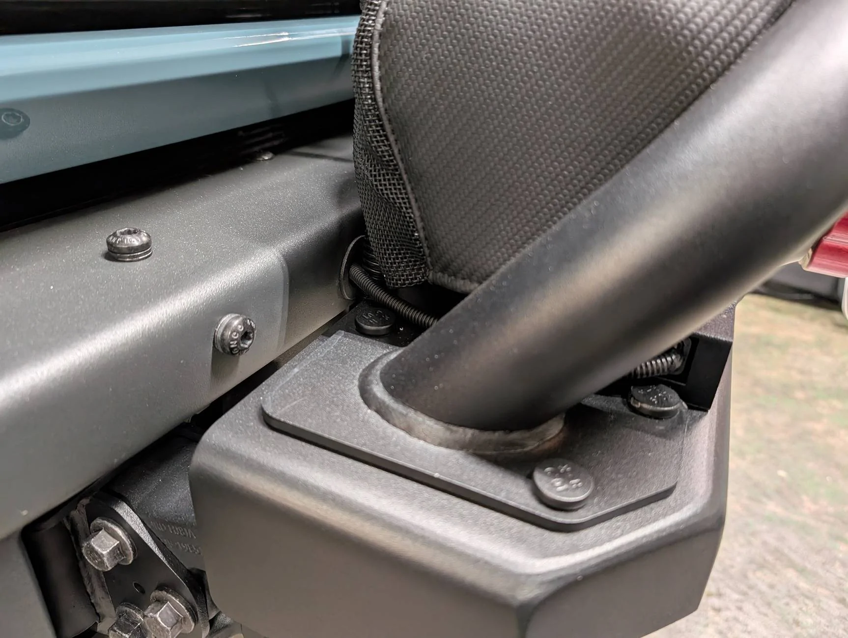

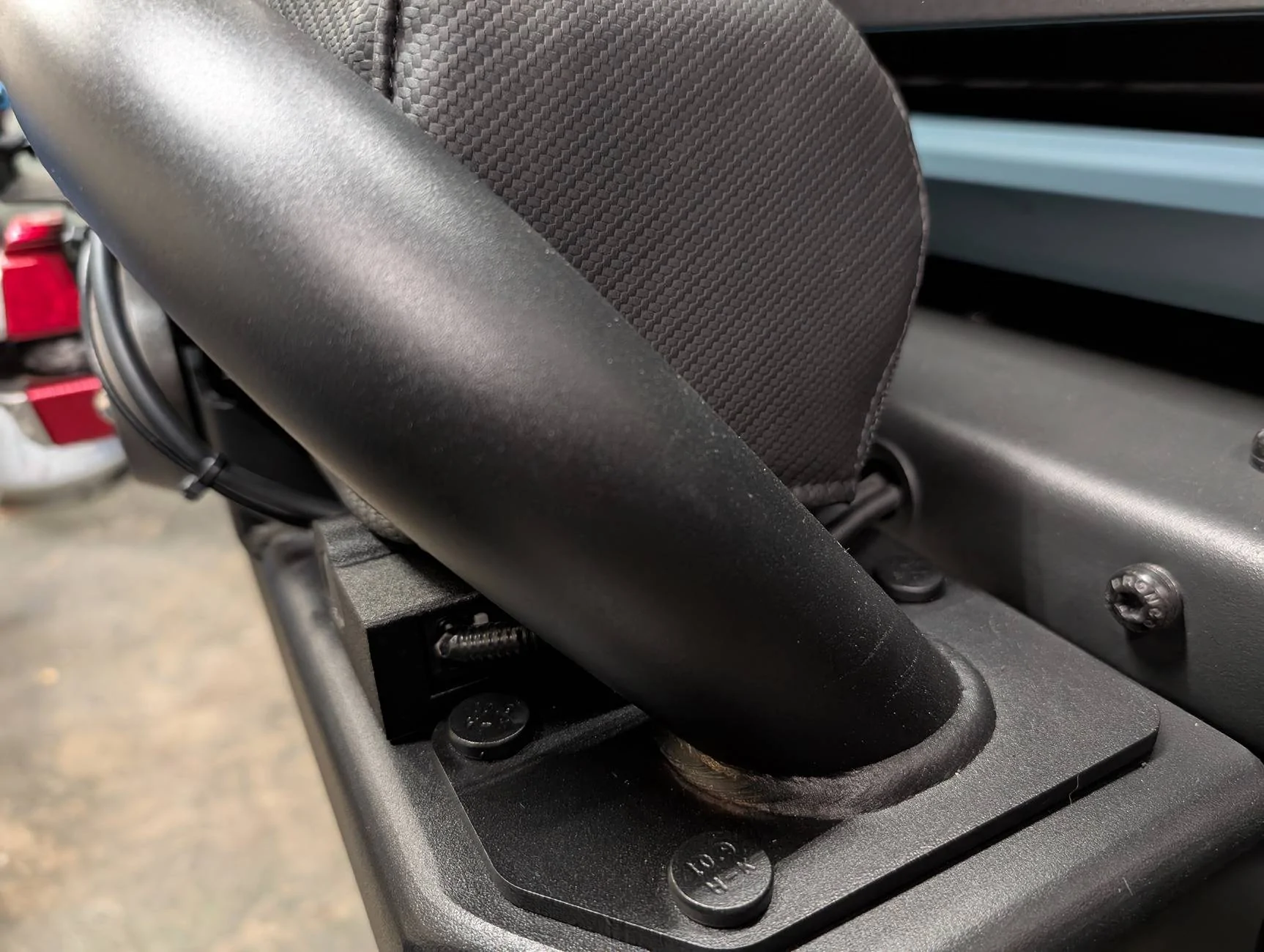

ACC!
Route positive cable high tucked into the bumper so that it stays high over the adaptive cruise control ACC radar. I didn’t do anything to attach the cable and so far it seems like it stays up there on its own! And this is after a few wheeling trips with plenty of bumpy stuff. If it does fall then I’ll look into some stick on zip-tie mounts.

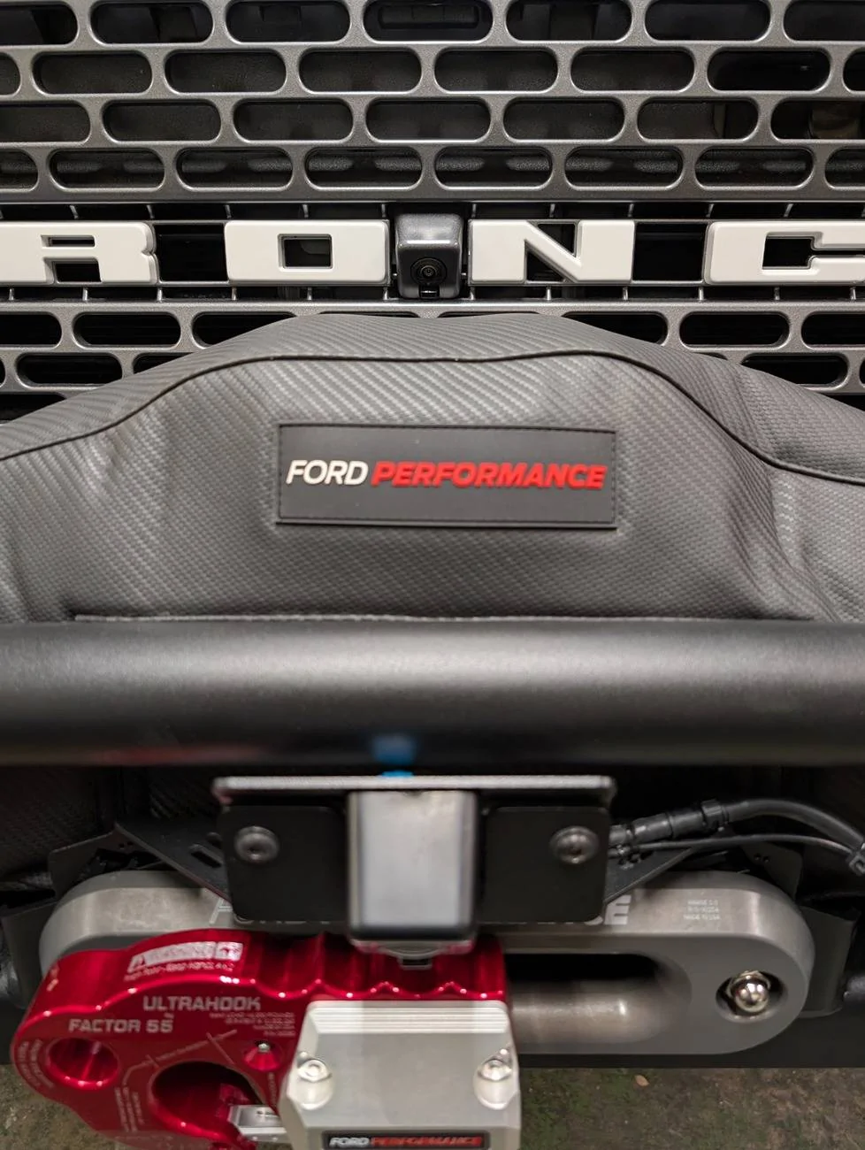

Camera!
Sadly Ford doesn’t sell the relocation mount that they show in their F55 Ultrahook page. I opted for the Mountains-2-Metal kit (BR6FCRL). I decided to leave the factory camera install alone and run a new separate camera to the front of the winch. I wanted to compare the two camera views and make it easier to remove the winch setup. I have it setup now so that I can swap the electrical and washer connectors under the hood to change the active camera. To do this I bought a camera, camera mount, camera sprayer, a washer hose that had the right connectors, and a fakra cable just to steal the connector to “plug” the unused side. (See the parts list below)
There’s a small subset of people like me that will like this idea .. the rest of you will just move the camera parts to the camera relocation bracket. Just in case you are like me, I posted the parts list that I used for the additional camera.
I removed the front grill and routed all of the cables before installing the winch and that made things pretty easy. I routed the washer and camera hoses through the driver's side parking sensor hole along with the parking sensor extension cable.
The camera works great in this location. The 360 view looks fine to my eye .. a little wonky maybe.

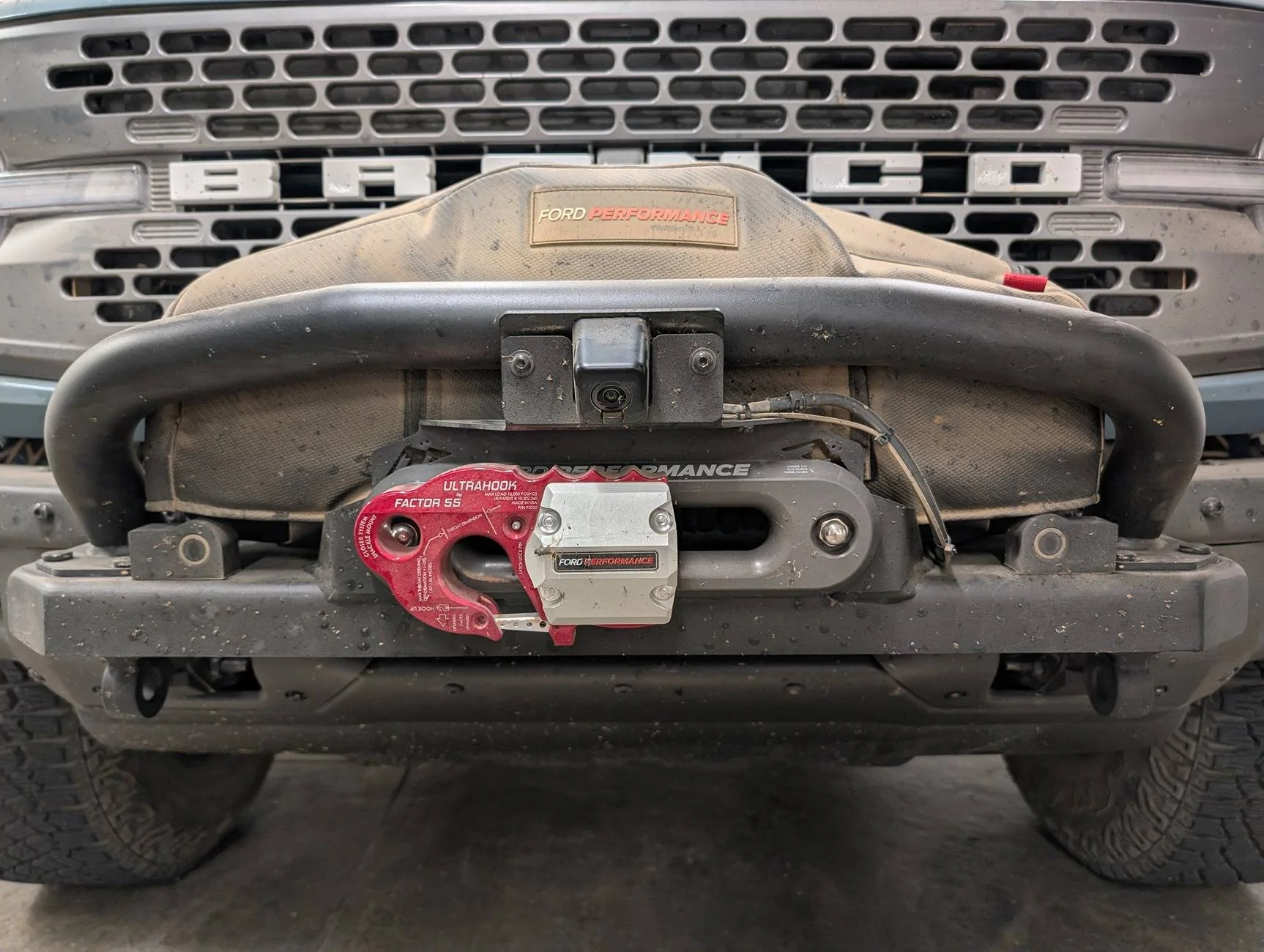

Parking Sensors!
Lots of people drill. Some hand drill and some hire a machinist. I wasn’t comfortable drilling for a few reasons. The first was that if I misaligned I wasn’t sure that I could get another plate. And the other was that I wanted to keep the plate intact; both because Ford has this as a crash tested piece and for possible resale if I decided I no longer needed the winch. Seeing how FPP mounted their sensors (again on that F55 Ultrahook page) to the top of the plate made me want to do the same. Like the front camera mount, I was disappointed to find that Ford performance doesn’t sell these. And I didn’t find anyone else that did either.. so I ended up designing my own parking sensor mount. The mounts are a press fit designed to be as small as possible. There is no drilling required; they stick to the winch plate top with double sided automotive acrylic tape. I lined them up “dry” and marked out a box with painters tape before I put the 3m tape and actually stuck them down. I routed the cable through the original hole and left the original mount in the bumper to act as a chafe guard. I routed the cables when the bumper was off during the winch install. (See the parts list below)
One note about the front parking sensors; they don’t turn on unless you are actually moving forward! So don’t panic when you finish hooking everything up and they don’t start beeping right away.
Ford Bronco Ford Performance Winch with Sensors (ACC, Camera, and Parking) Works Fine; Parts List and Photos parking-dr
Ford Bronco Ford Performance Winch with Sensors (ACC, Camera, and Parking) Works Fine; Parts List and Photos parking-pass

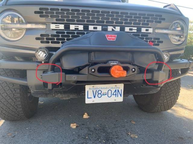

Is this a Ford winch mount? Your bull bar looks like it’s welded on, I think the Ford is bolted and removable. Maybe it’s just the picture, but I can’t see any bolts.
Bschurr
Jan 28, 2021
1,816
4,165
NY
Wow - keen eye @Finbox
It certainly appears to be welded and not bolted. Remind me to never play Eye Spy with you!
