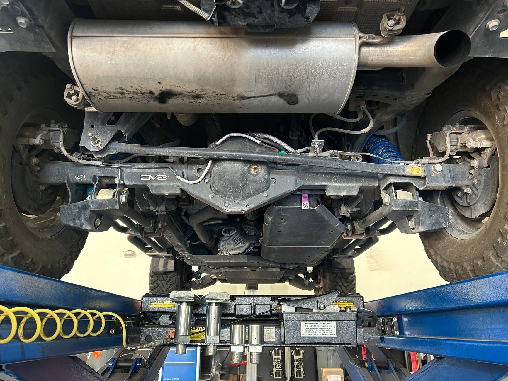

So, I'll start this off by saying this - if you have lifted your Bronco and don't already have a Relocation Bracket for your trac (or track) bar, get one. It just works. And yes, EVEN IF you already have an Adjustable Track bar....
About 2 years ago I got an Eibach Pro Spring Lift (springs only) for my SAS Bronco. At the same time I also installed Rear Control arms (RockJock) and an Adjustable Track Bar (ICON). I figured that since I had an "adjustable" track bar I was all set. I always noticed a very minute amount of rear "wiggle" or "bump steer," but nothing crazy. I never really had issues with alignment so I kinda just dismissed it. Fast forward almost 2 years later and I install a TracBar Relocation Bracket (TRB) - and the difference was felt so immediately, I actually thought is was some massive "placebo-effect" taking place. On the road, lane changes feel more planted/grounded. What little rear bump-steer I had when going over bumps and road irregularities, were virtually non-existent afterwards. Off-road it just feels more communicative and easy to direct/point in whatever direction I want, especially when going on faster, windier trails. One of the best ways I can describe this is - "when your rear unweights and then lands....and the tires find traction again......it feels like the rear shifts towards your intended direction with more purpose." That change in geometry from having a track bar that goes at a "slight angle," to now being almost perfectly horizontal with the rear axle is giving me that much more overall confidence. I just wish I did this sooner :mad:

Here is a pic BEFORE the Relocation Bracket:

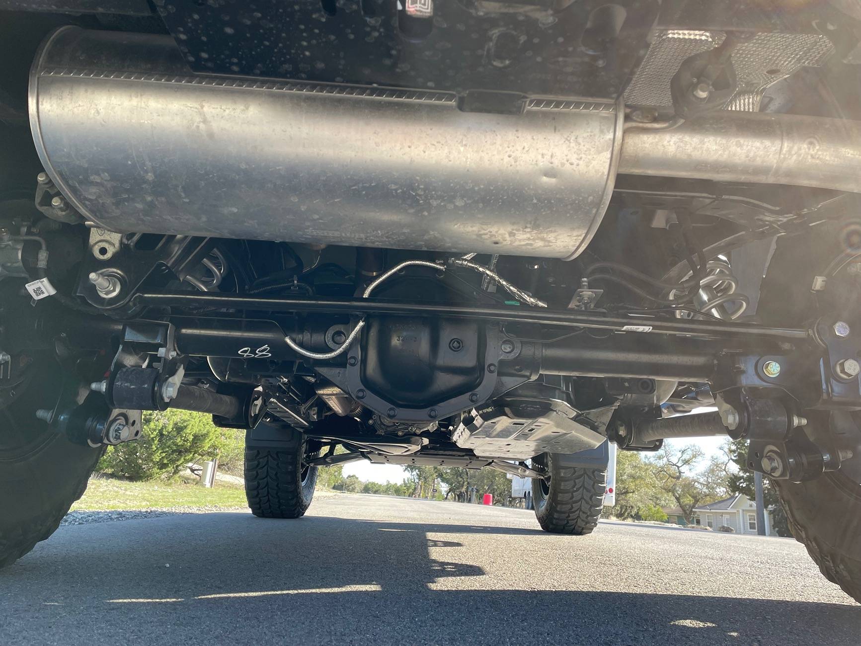

Here is AFTER the Relocation Bracket installed:
Ford Bronco Rear TracBar Relocation Bracket - Get One! IMG_7290

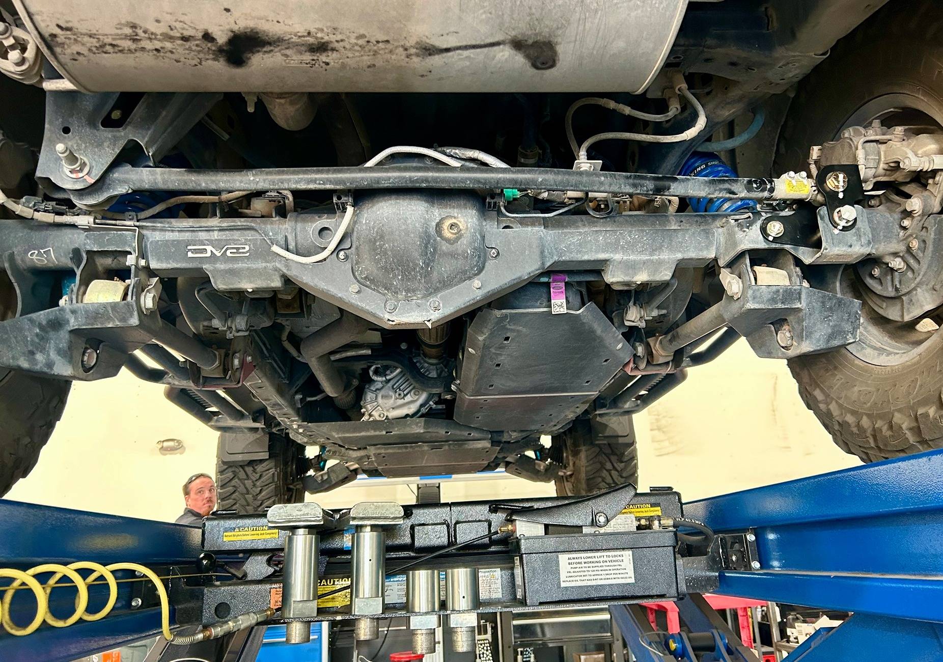

My non-Sasquatch BD with Eibach 2.0 after RockJock relocation bracket.
Ford Bronco Rear TracBar Relocation Bracket - Get One! IMG_0099
