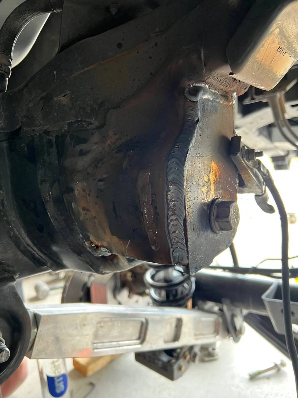

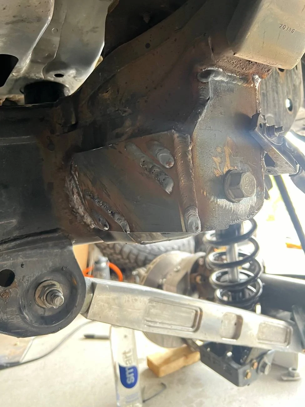

If you’re just swapping the arms you can get away with just lowering the tank. But you’ll still need to disconnect the fuel filler hose and I think one breather.
Now if you’re planning on really wheeling it, you’ll probably want to reinforce those mounts and to do this you’ll definitely need to drop the whole tank. It’s a biatch. So if that’s something you plan on might as well do it all at once.

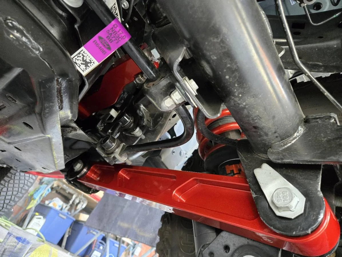

They are called trailing arms. there are two upper and two lower. They attach to the frame of your bronco and to the rear axle. They are what keep the rear axle attached to your bronco and allow it to move up and down. Stock they are black and round. The stock bars have a big "rubber" center the bolt goes through. These "pretty" milled billet aluminum bars big advantage is in two parts... 1) the length is adjustable allowing you to change the pinion angle of the differential and 2) the joint that the bolt goes through at the frame and or at the axle will be a different style of joint instead of "rubber" they are bearing style of joint that is easier to move.... less resistance. when I say "bearing style" I do not mean ball bearings but look up "Heim joint"....
