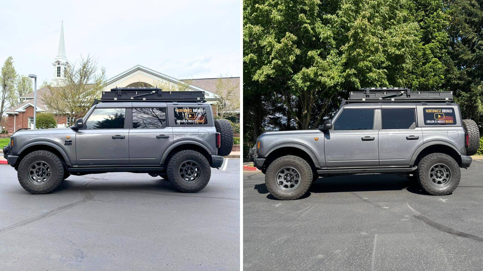

Here's what I learned after the process of lifting the Bronco about 2". My original goal was to lift the bronco 3" with the ability to adjust the level and run HD springs. Reason for the lift is to not collect so much debris under the bronco in the desert. (fire prevention) Hopefully this will help some folks out.

In the end I didn't get the height I was looking for, but I did gain the ability to adjust height and level at home with a simple floor jack and provided wrench. The Bronco rides and drives leaps and bounds better than factory. I was worried the HD springs would make the ride too stiff, but ended up great for my set up. I'd say don't be afraid of the HD springs, they are wonderful.

  • Front ground to fender flare 40.5"
  • Rear ground to fender flare 40.75" (allow some rake for occasional extra weight)

In conclusion, I didn't get the full lift I was hoping for. But I'm very happy with the set up and the ability to make height adjustments at home. The HD springs were a good choice as they are not too stiff. The cost is pretty darn decent. The bronco rides and drives much better than factory. Hopefully this will help someone out in the future!

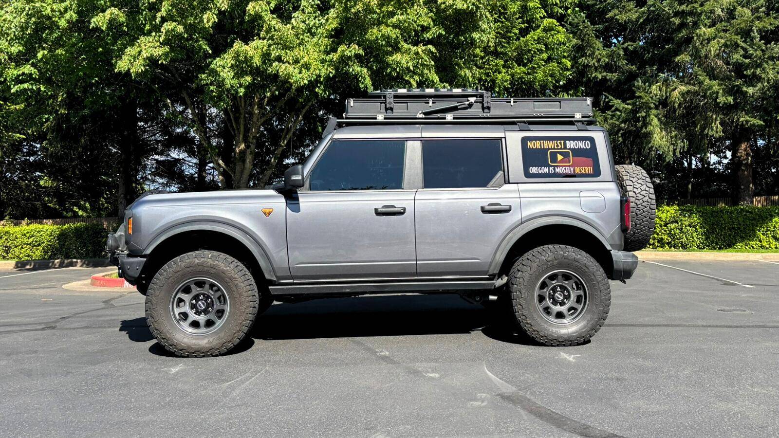

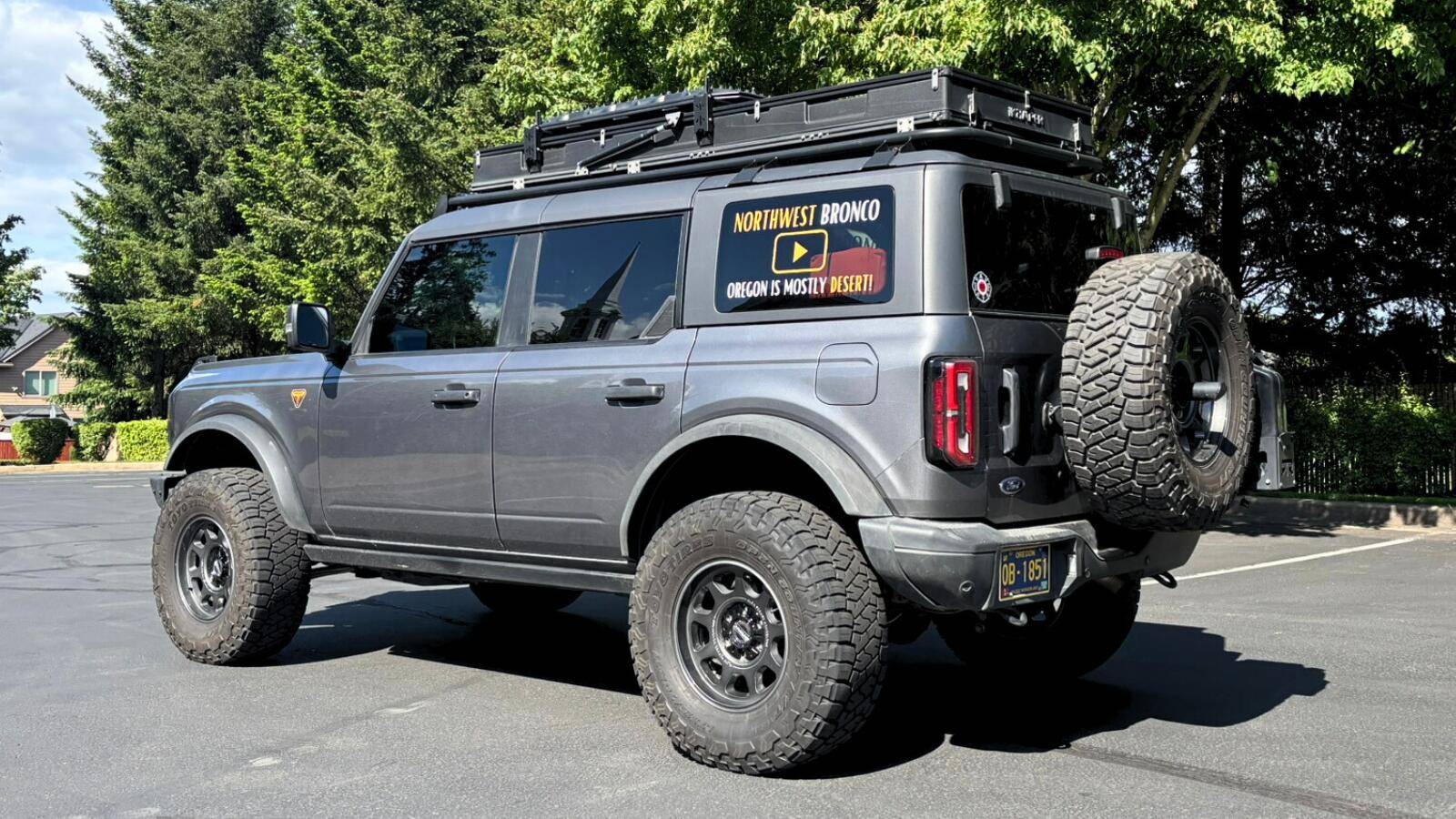

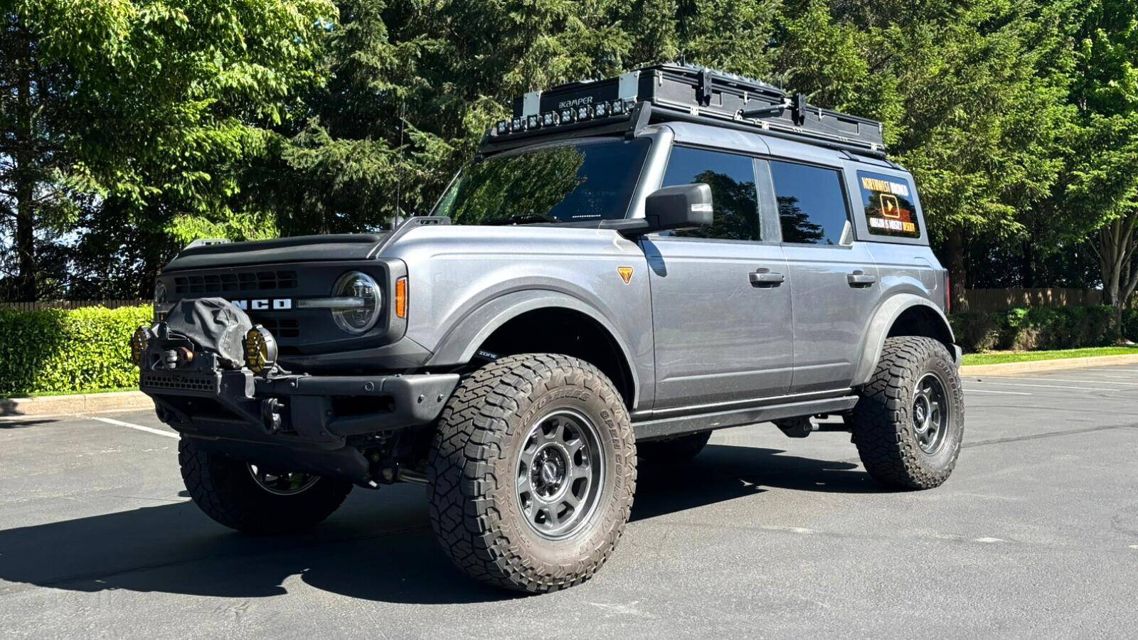

Ford Bronco Lessons Learned After Lifting the Bronco 2"  (What Works & Doesn't) rear
Ford Bronco Lessons Learned After Lifting the Bronco 2"  (What Works & Doesn't) front
Ford Bronco Lessons Learned After Lifting the Bronco 2"  (What Works & Doesn't) side

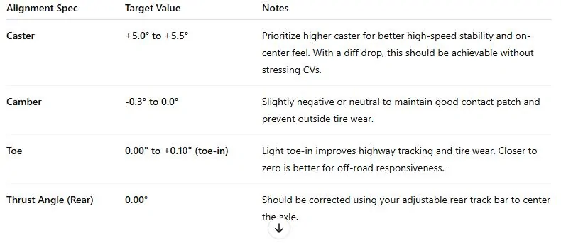

Explain more in the alignment. I’m dealing with mine now since the lift. What’s your caster and camber and toe?
Take this with a grain of salt as I'm not a alignment expert. If there are folks who know more than I about alignment, please comment! You won't hurt my feelings. But mine is close to this set up.

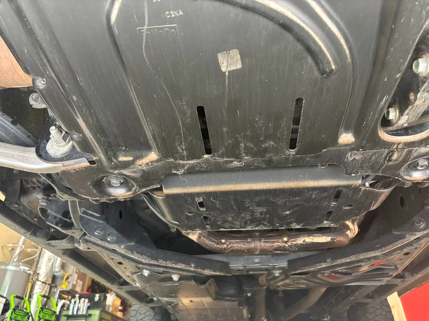

Can you look underneath your bronco and see if your skid plate is cut to fit?

I see no cutting, here's a photo. Let me know if you need more. Happy to help.
