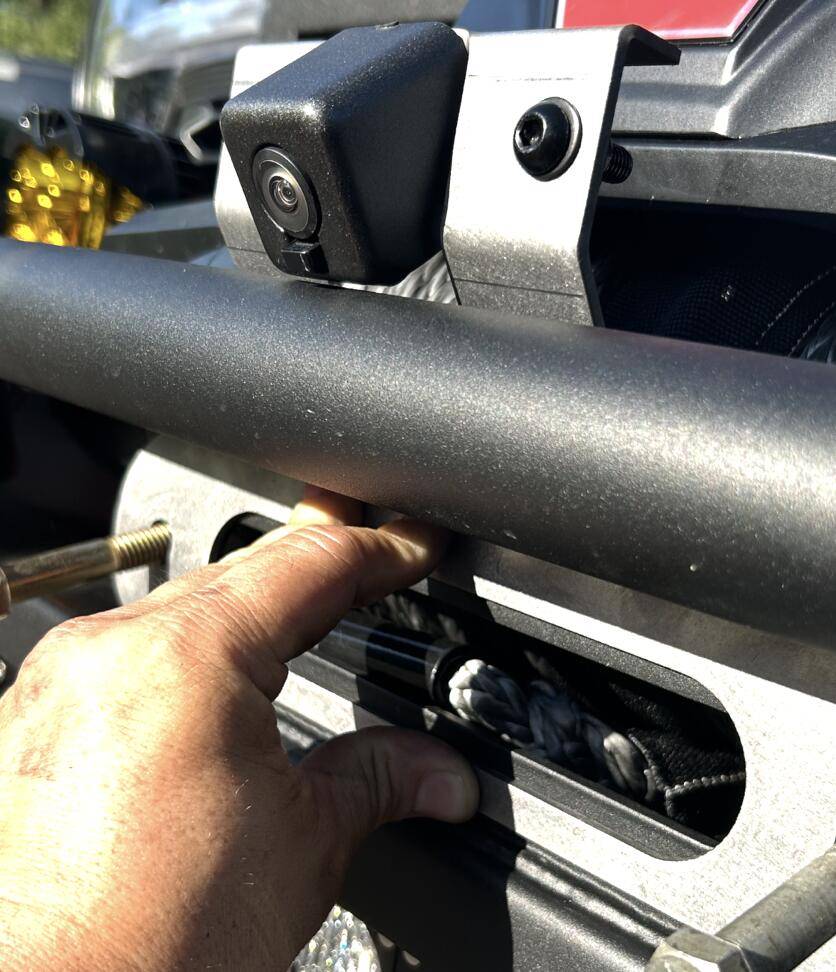

RE CAMERA RELOACTION
My prep work with ADD had validated that their camera relocation kit was compatible with the Rock Fighter bumper. What I didn’t know when I had that discussion with ADD, is that that meant turning the camera bracket that goes behind the fairlead around 180 degrees and mounting the camera BELOW the fairlead. For a build that I was keeping as off road survivable as feasible, putting it in that location really wasn’t an option I wanted to do – it just feels like a vulnerable place to mount the camera. I also envisioned having that one time where I have a winch pull angled below the bumper and the line pulls down over that area, or the hook drops when I disengage the winch clutch and bangs on the camera, etc.

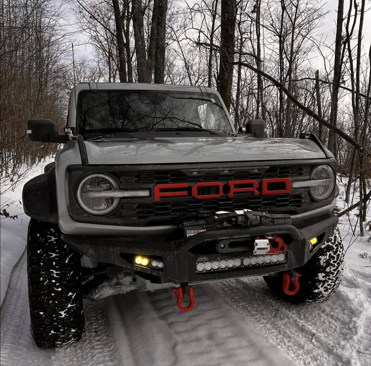

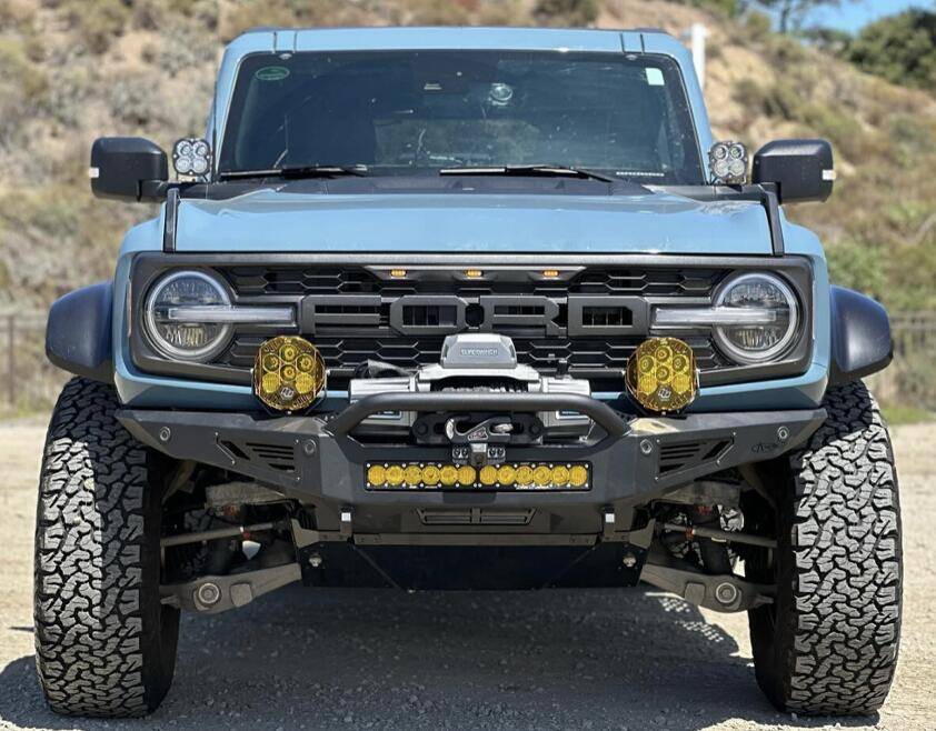

Not my build, but a reference picture I found for the camera install below the fairlead using the ADD bracket on the ADD bumper.
Ford Bronco 2024 Bronco Raptor - Bumpers, Winch and Lights Build Screenshot 2025-06-30 at 5.55.14 PM
Here comes in the first need for a custom bracket. Essentially, if ADD would offer a version of the camera bracket with extended uprights to the bracket section that fits behind the fairlead, the camera could be high enough to be above the bull bar. But they don’t (or didn’t at the time of this build).
If you don’t have the option for a custom bracket that does, another solution is to drill a second set of holes in the bumper fairlead mounting plate, above the fairlead mounting points that line up with the camera bracket in their kit. Note if you go this route, you are drilling through steel and will need a means to protect the exposed surface from exposure to the elements – like re-powder coating (I am aware of one build that had their bumpers sprayed with bedliner coating after these holes were drilled). I opted to go the custom bracket route and I was fortunate that my garage had a resource and interest in solving this riddle. The garage wanted a solution that both protected the camera and hid the hose and wiring. The garage also needed to use some of the parts from the ADD relocation kit for this, specifically the washer hose extension and some mounting hardware, so in hindsight, having just found a source for those would have been a more cost-effective option than using parts out of the kit.

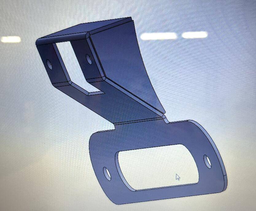

The initial CAD rendering for the custom bracket (there were a few versions)–

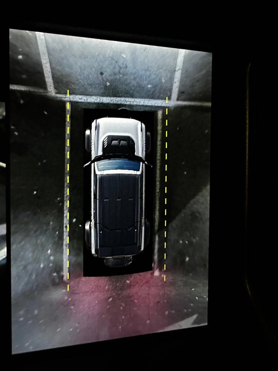

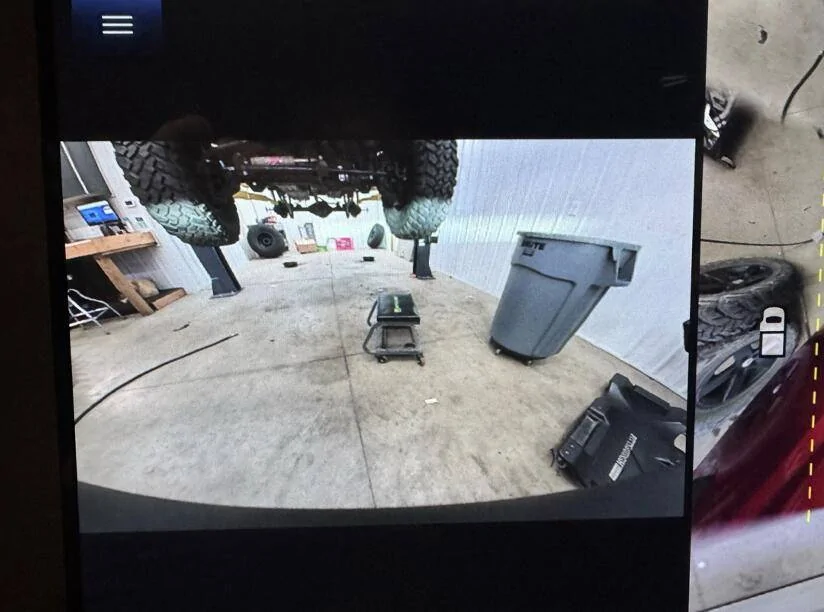

And the view from the relocated camera.
Ford Bronco 2024 Bronco Raptor - Bumpers, Winch and Lights Build Screenshot 2025-06-30 at 6.00.51 PM

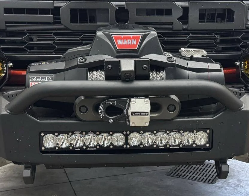

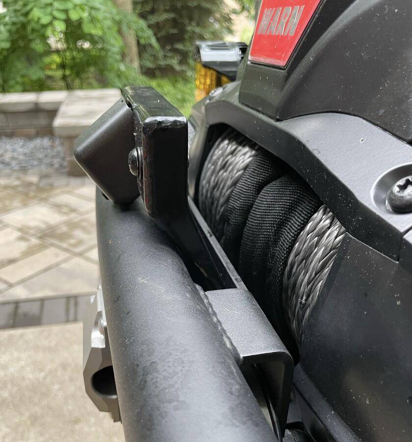

Next fitment issue we ran into is that the bumper bracket plate for the fairlead only really allows 1.5” from the bottom edge to the center of the mounting holes for the fairlead. What this equates to is needing a fairlead that is 3” tall (with additional tolerance to account for any raised top that manufactures use for their logo, etc.). Most offerings are 3.5” with a few that are 3.25” – unless you venture into the unbranded offerings from Amazon, etc. Yes, you can shoehorn in a 3.25” tall one, but it will be on an angle and not sit flush to the bumper fairlead plate. It will function and I’m aware of a few builds that have done this without issue.

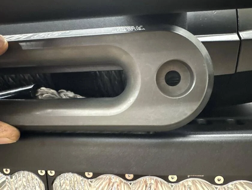

The fairlead that comes with the Warn Zeon XD will not fit. The Warn Elite fairlead will not fit. The Factory 55 fairlead (which is the offering from Ford Performance as well) can be shoehorned to fit (the angle scenario mentioned earlier). Of course, the “Capture” fairlead from ADD/DV8 will fit – but that limits you to their style hook, which I didn’t want, and my research found some folks had operational issues with the rope line getting hung up on the uneven fairlead line opening surface (because it is shaped to the outline of the partially recessed hook when not in use).
The solution I worked with my garage for is to remove about 3/8” material from the bottom back edge of the Factor 55 fairlead (no need to powder coat since the fairlead is aluminum and the exposed side was hidden by the adjacent bumper section). This was definitely a more extreme solution than I had intended – but it mattered to me that the fairlead was a proven and known option – so I opted to stick with Factor 55 versus an unknown brand whose coating may not hold up, or the line opening not be as smooth for the line, etc.. Before committing to that solution, I did reach out to several other known manufactures (beyond just Warn and Factor 55) and of those that responded, none were any shorter than Factor 55 – and I had already purchased the Factor 55 as my 3rd fairlead option hoping it would fit.
This is the Factor 55 before modification. You can see if you line up the bottom of the fairlead with the clearance on the bumper fairlead plate that neither the mounting holes or the opening for the line are quite lined up.
Ford Bronco 2024 Bronco Raptor - Bumpers, Winch and Lights Build Screenshot 2025-06-30 at 6.02.00 PM

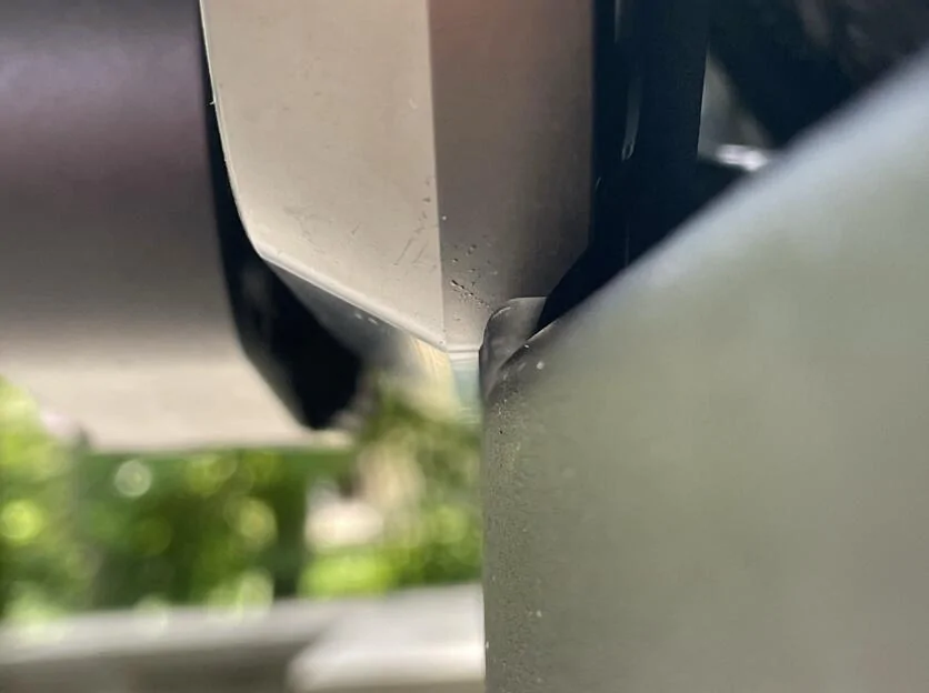

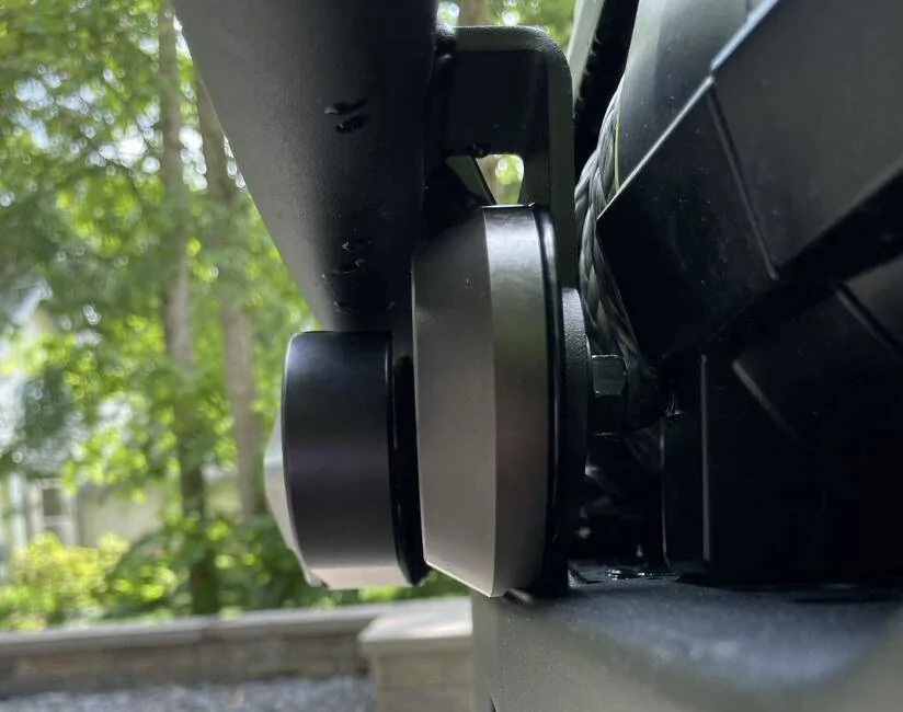

Here is the modified Factor 55 fairlead installed. It’s tight to the bottom area of the bumper fairlead mounting plate and flat to the same plate on the back.
Ford Bronco 2024 Bronco Raptor - Bumpers, Winch and Lights Build Screenshot 2025-06-30 at 6.02.51 PM
With the thickness of the new camera bracket behind the fairlead, the shop only needed to trim a bit off the lower backside of the fairlead for the needed clearance.
Ford Bronco 2024 Bronco Raptor - Bumpers, Winch and Lights Build Screenshot 2025-06-30 at 6.03.47 PM

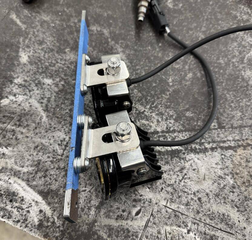

RE FOG LIGHTS

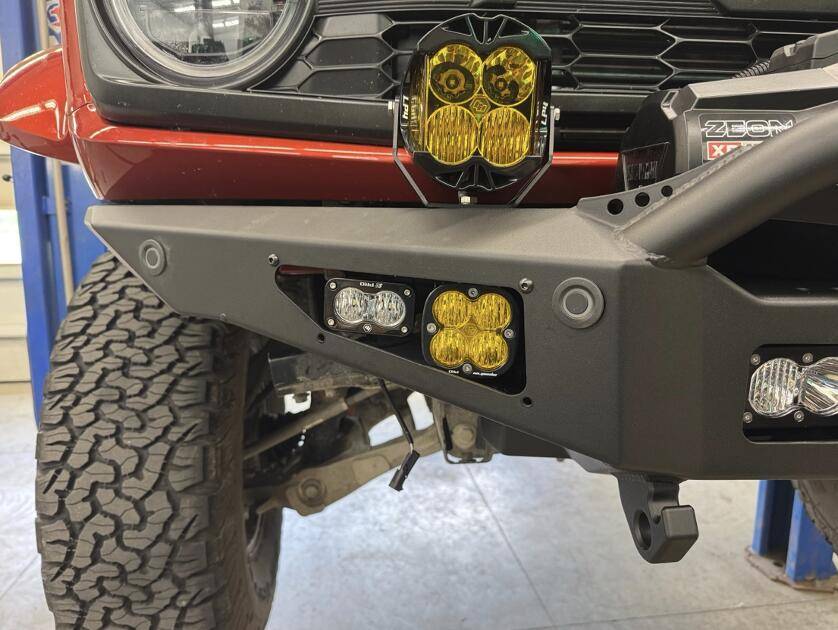

Going into the build, I knew the ADD bumper did not have fog light tabs and we would need to come up with a custom solution. This was the only actual custom bracket and fitment issue we were expecting. I was also aware from my research of at least 2 different builds that had accommodated putting fog lights in the wings of the bumper.
The overall design approach from ADD for these bumpers are to maximize clearance and approach angles – so they are clean and tight. The build I found to mimic included a custom bracket that would secure to the top holes in the bumper for the back plate in the wings, use of mounting brackets from Baja Designs that comes in their fog light kit (that you can order separately if you contact them – they are not on their web site), and mounting the lights upside down (so the thickest part of the fin is on the bottom). For those that are OCD like me, that also means taking off the lens cover and flipping it so that the writing is still right side up.

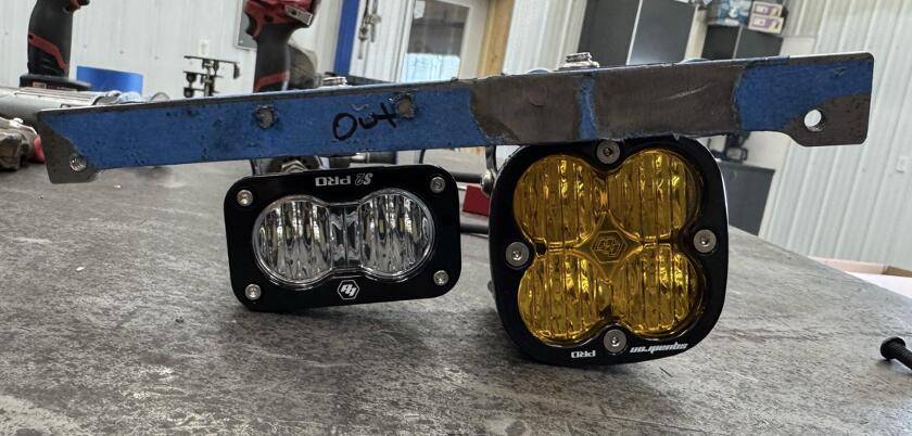

Note that my garage did a custom plate design different than my research found was used for the same approach, but the installation and result are essentially the same and they spent quite a bit of time with various adjustments to accommodate placement, light spread/pattern and allowing for some adjustability. This ended up being more involved than I was expecting, so ADD, if you are reading this – consider offering a solution for this as an add on product – based on the various posts I read when researching options, there is definitely a market for it.
This is the custom bracket as it was being built and dry fit by my garage (before powder coat and flipping the lenses). The silver top slotted “L” brackets are the ones that are usually included in the Baja fog light kit that you can order separately if you contact them. Note there are separate part numbers for the right and left sides, and I ordered 2 of each.
Ford Bronco 2024 Bronco Raptor - Bumpers, Winch and Lights Build Screenshot 2025-06-30 at 6.04.49 PM
Ford Bronco 2024 Bronco Raptor - Bumpers, Winch and Lights Build Screenshot 2025-06-30 at 6.05.33 PM
Ford Bronco 2024 Bronco Raptor - Bumpers, Winch and Lights Build Screenshot 2025-06-30 at 6.06.09 PM

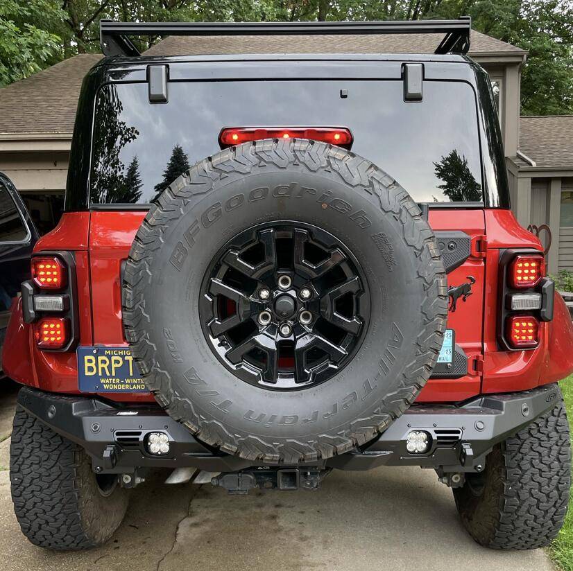

The completed mods from the back –
Ford Bronco 2024 Bronco Raptor - Bumpers, Winch and Lights Build Screenshot 2025-06-30 at 6.09.36 PM

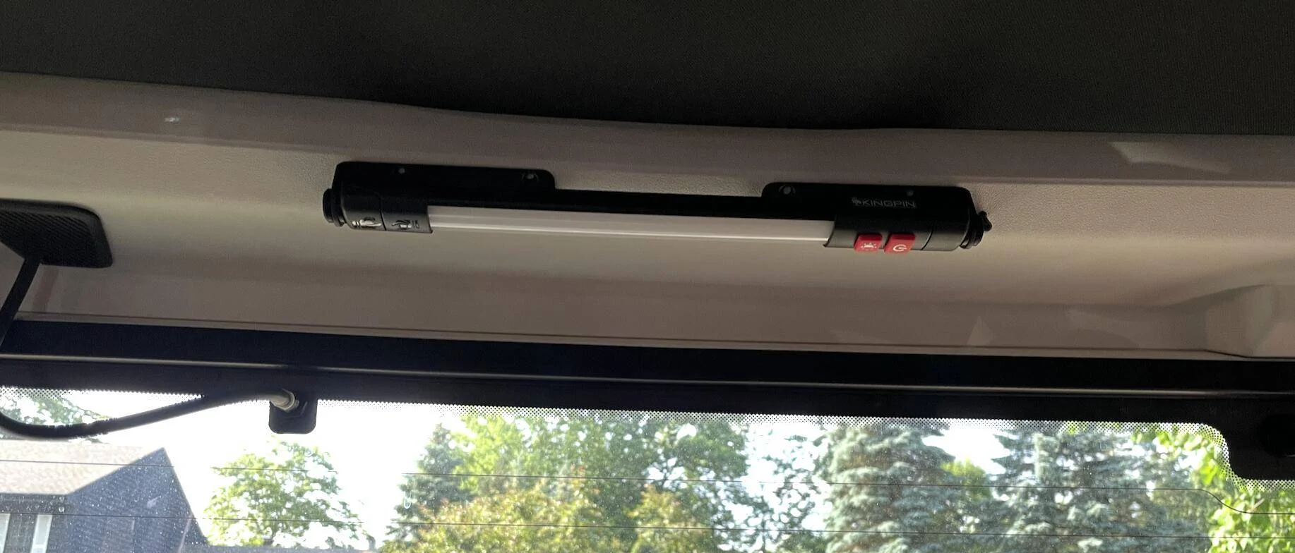

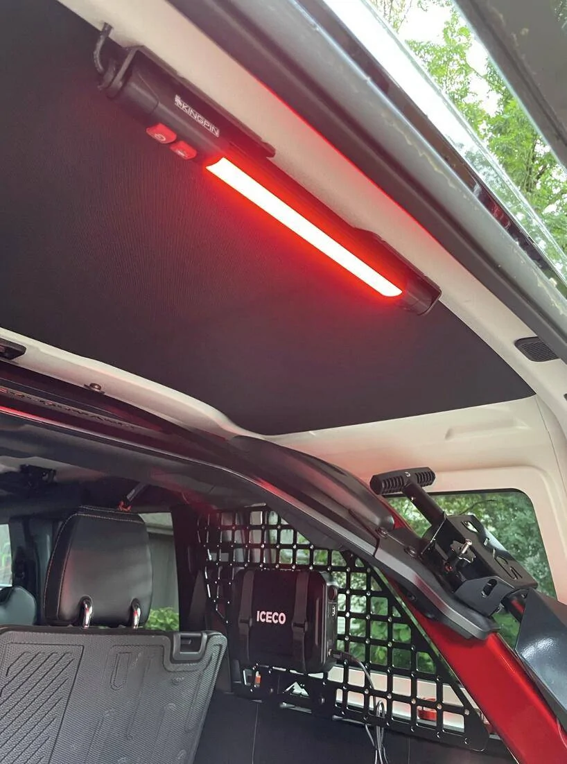

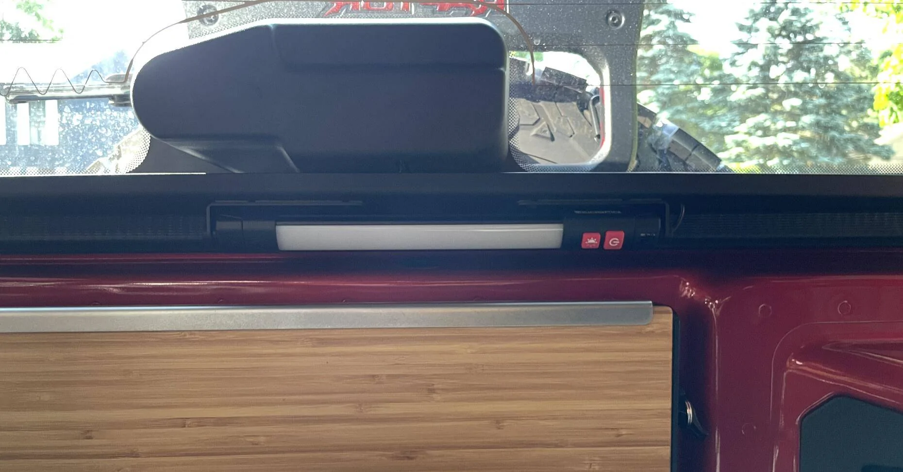

12” light on interior of hard top – red mode
Ford Bronco 2024 Bronco Raptor - Bumpers, Winch and Lights Build Screenshot 2025-06-30 at 6.11.10 PM

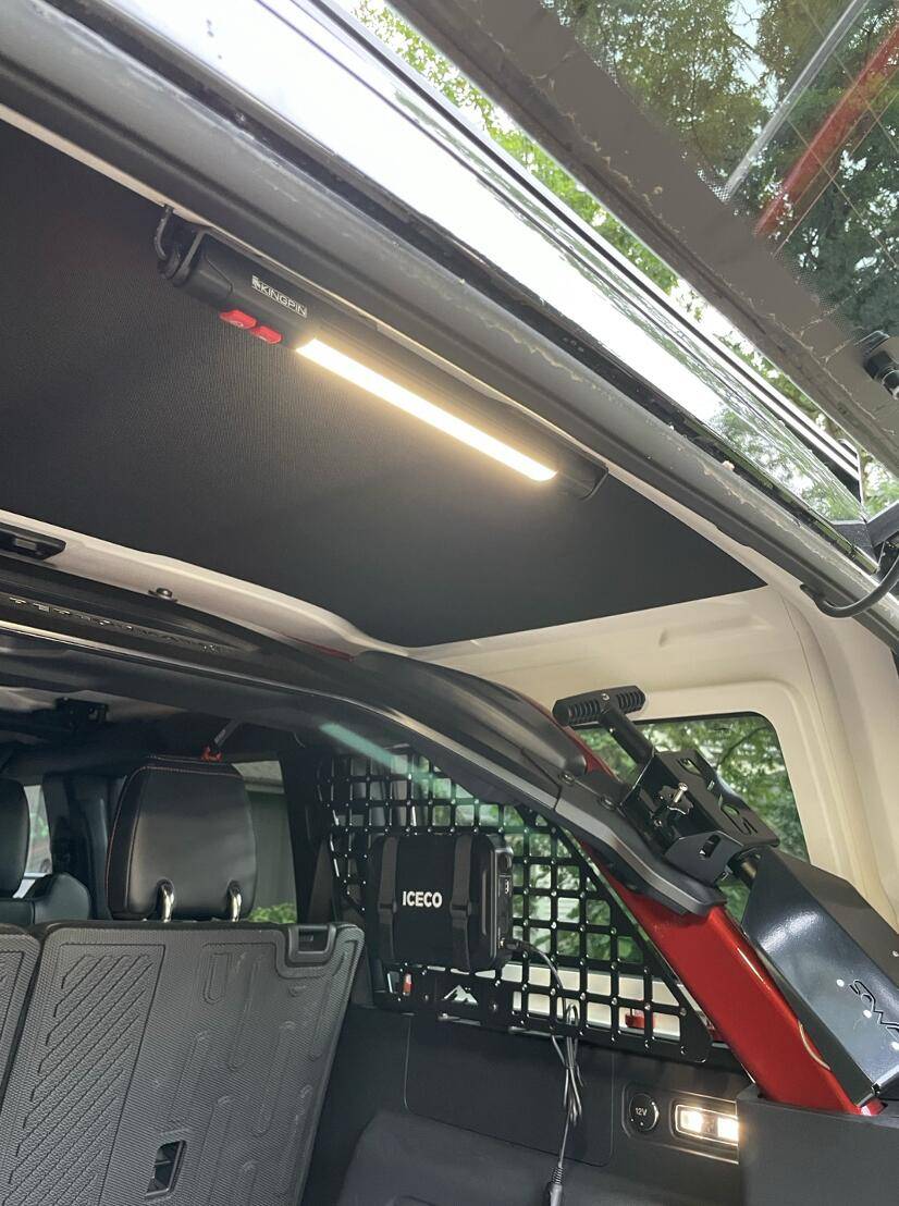

12” light on interior of hard top – white mode
Ford Bronco 2024 Bronco Raptor - Bumpers, Winch and Lights Build Screenshot 2025-06-30 at 6.12.00 PM

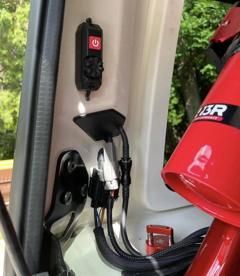

Control dimmer switch mounted on interior side of hard top and a quick disconnect to allow for the removal of the top.
Ford Bronco 2024 Bronco Raptor - Bumpers, Winch and Lights Build Screenshot 2025-06-30 at 6.12.36 PM

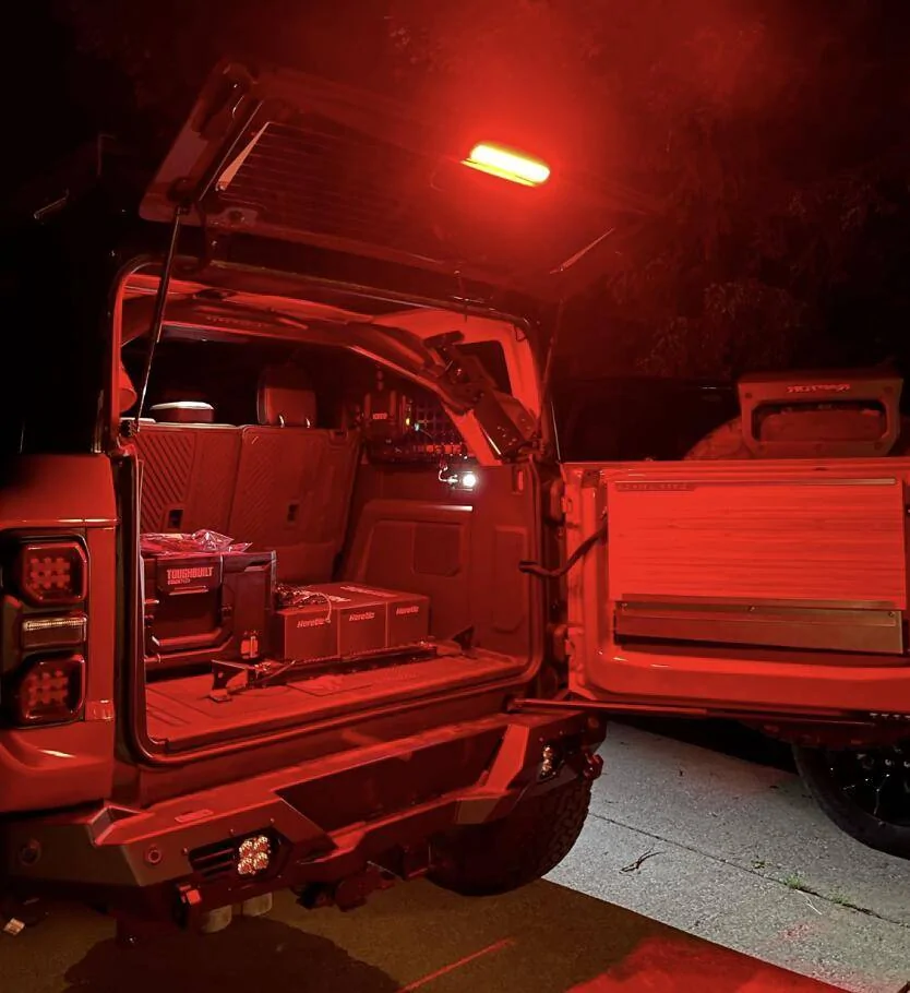

Evening picture with both of the 12” bars on – red mode
Ford Bronco 2024 Bronco Raptor - Bumpers, Winch and Lights Build Screenshot 2025-06-30 at 6.13.11 PM

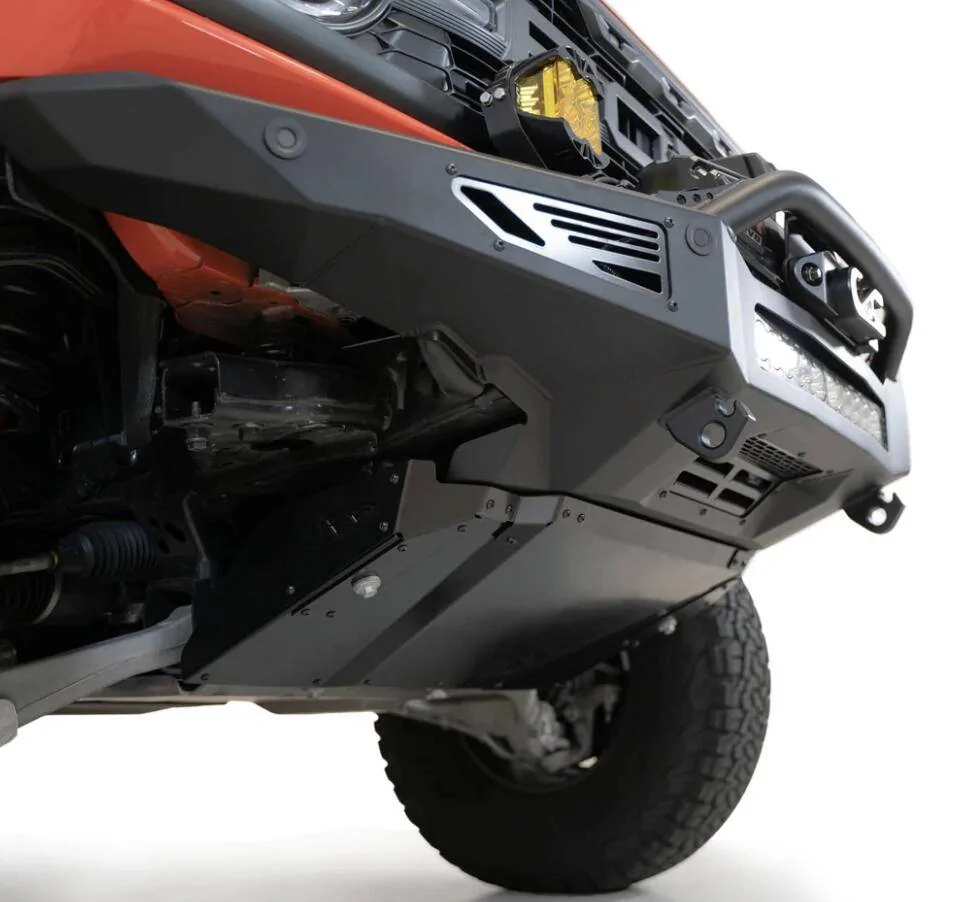

That said, the ADD Rock Fighter bumper is designed with the IC in mind and I haven't come across other cooling issues with that bumper (yet). And I'm hoping I won't be starting that thread at a later time...
From the ADD web site -
"Included is a vented bumper skid plate that allows air to flow freely to the intercooler."

The “dry fit” of the first run of the custom bracket –
And here’s the finished camera bracket with camera installed.
RE FARILEAD
RE FOG LIGHTS

I had no functional reason to swap out the rear bumper – other than aesthetics to match the front bumper – so down the slippery slope I went for an ADD rear bumper.
RE REAR BUILD
For the rear – my parts list included –
  • ADD Bomber rear bumper (Raptor version) – this comes with the license plate relocation bracket that mounts behind the spare tire)
  • Baja Design Squadron, clear wide cornering lights
Note that that ADD lists 3 rear bumpers specific for the Raptor, but there are some additional offerings not listed specific for the Raptor that will accommodate a 37” spare tire and in my research, have been installed on a Raptor.
I stuck with options listed for the Raptor, and of those, wanted one that kept the license plate out of harm’s way (the Rock Fighter rear has the license plate extending below the bumper and my research found many with that bumper have bent their plate on more than one occasion). The compromise of blocking the “Raptor” badge below the door handle and sticking out when the tailgate open isn’t ideal, but for my needs, it was a compromise I was willing to make. I also mount my recovery boards horizontal on the rear tire using the American Adventure Labs recovery board mount for the spare tire, so I’ve gotten used to needing a bit more clearance when operating the tailgate (I’ve learned that the hard way by catching the recovery boards on my shoulder a few times – and now I can relearn that by hitting my side/hip with the license plate).
The rear install and fitment was pretty straight forward, which was well welcomed after the various unplanned items that came up for the front. The parking sensors were plug and play and the license plate electrical still feeds to the new bumper (the light shines up, versus sideways – so I’ll need to be conscious about keeping that clear of snow in the winter). Some other 3rd party offering to mount the license plate behind the spare tire include re-routing the electrical for the light through the tailgate for a side light that is secured to the relocation plate. As I have the Trailgater table installed, along with wiring for the GMRS Midland Ghost antenna already through the tailgate – I was trying to avoid needing to have that taken that apart to have another wire join them.
My WeatherTech license plate cover however was not compatible with the ADD plate relocation bracket and couldn’t be re-used.
Picture of the rear with recovery boards prior to the mods for reference.
I’m initially opting to not re-install the rear mudflaps. The ADD Bomber bumper will accommodate them, but functionally, they aren’t a necessity and since I have body color painted fender flares, like the look of the new bumper without them a bit better. If you ride behind me on muddy or rocky trails, I apologize now.
INTERIOR LIGHTS
The last item on this set of mods was adding some interior task lights. I wanted both additional lighting for the cargo area, as well as an easy way to have lights behind the vehicle when trailgating.
As a side note, one of the reasons for the TrailRax Half Rack on the roof was to have a location to secure a MoonShade – which is the portable canopy option I went with instead of a ROAM 4’ pull out canopy that you keep mounted to the roof rack. After being at SuperCell East and being in a group that had various portable shade rooms, etc., I wanted an option that was small to carry, easy to setup, and allowed me multiple use case scenarios other than just from the rear of my Raptor. My plans to use the Moonshade over the rear of the vehicle in a tailgating setup prompted looking at lighting options with that in mind.
After seeing some various solutions for this that mainly included RGB light strip options I ended up going with offerings from Kingpin. I selected them for 2 main features – they had swivel mounts so I could direct the light interior or exterior and they have a red light mode for use in scenarios when you don’t want to interfere with you adjusted night vision.
For my interior lights – my parts list included-
  • 2 Kingpin 12” F-series lights
  • 2 Kingpin F-series search mount kits
  • 2 Kingpin Rotary Dimmer switches (only one used)
I had planned to have 12v connected to each of the dimmer switches and then have each of the dimmers connected to each of the 12” bars, one installed in the cargo area above the lift gate and the other on the lower lip of the liftgate. In full disclosure, I left it up to my shop to figure out the best option for an engine independent 12v power source to wire them to and they ran 16/2 wire to a 15-amp weatherproof fuse holder directly to the battery.
What my shop recommended is using only one dimmer since I can control the red/white and on/off individually at each light, and it made for a cleaner install.
Granted, this isn’t a very difficult install but having a shop do it that is meticulous with wiring definitely made it clean install. They leveraged the “accessory” access points to interior channels in the hard top (I have the newer OEM painted hard top that was first offered late 2024 model year) and a few supplemental holes to accommodate some of the specific wire locations.
I like your lighting options. Can you post some more photos of the inside lights in the back, the lower lip of the liftgate light looks vary usefull. The bronco can be a dark cave at night and I want to do something to help that.
Sure will - in the meantime, this is the build thread I found that introduced me to the use of the Kingpin light options. There are some additional photos on that thread as well.
Using the search mount option for the F-series 12" light, I mounted two separate lights so that the lense is center side to side. One is mounted interior of the roof, just above the rear lift gate and the other is mounted to the under side of the lip on the lift gate.
The wiring for the one on the roof required drilling a single hole to the interior of the roof only - to route the wiring from the edge of the mounted light into the accessory channels in the roof.
The wiring for the one on the lift gate required drilling a single hole through the lift edge. The wiring then mimiced the routing for the existing wiring along the bottom edge, up the side and into the accessory access in the roof near the hinge.
The wiring for each were connected inside the roof and a single wire brought down the side to a 3rd hole that was drilled above where the control switch is mounted.
A 4th hole was drilled below the switch and the wiring routed down the accessory channel and through the bottom to a quick disconnect that allows me to remove the top with the lights still installed.

Yes! I've been looking for examples of the BD pocket lights in that specific space on the ADD Rock Fighter bumper for a while and agree it's something ADD should consider... This is my dream build - Well done and thanks for the detailed write-up!
jclark
jclark
Jeanette
Sep 25, 2022
242
154
Mid-Michigan
This is one of the threads that I referenced for options for getting BD lights in the wing cut outs on the Rock Fighter bumper. There are some additional detail photos of that build in that thread. The bumper and fog lights are introduced in post #20.
https://www.bronco6g.com/forum/threads/2024-badlands-2-door-build.102915/
I actually reached out to the shop that did the work on that build and unfortunately, the brackets they used were a custom one off and not something they could offer me. If I were closer to the shop, I'm sure they would have done the work, but too far of a commute for me (I'm in Michigan, they are Texas).
Here's a pic of another build I found with fogs in those cut outs. I'm assuming a similar approach, but they used the bottom to align and mount a bracket to versus the top and used 2 S2 versus a squardon and S2.
Thanks for sharing as I must have missed that thread. I like the top alignment on your build and the custom bracket looks like it should be fairly straightforward . The Braptor from the image above looks like it's using the DV8 camera relocation bracket - Did you happen to look at that option (as that was the route I was hoping to go)?
Also, I just noticed you have another thread on the DV8 box and an ARB compressor. Now that the ARB brushless dual is out, I've been revisiting mounting locations and was about to give up and just get the portable version (I have reservations about the spare tire mount and don't think I want to mount it in the cargo area), but am also concerned about heat with DV8 box - I'm guessing it's fine but was curious if you had any additional thoughts?
So, that Raptor build with the ADD bumper and BD S2 fog lights - I've been fortunate enough to see that one in person and throw multiple questions at the owner. They worked with a shop for a number of the mods and their shop drilled additional holes in the ADD bumper above the fairlead on that same plate so that the drilled holes lined up to mount the ADD camera relocation bracket there. This is also the build that had their bumpers coated with bed liner before installing - which mitigated exposting the steel in the bumper from drilling those holes to be used with that camera relocation bracket. It's a nice build. And I admire that the owner actually gets out and uses it offroad.
Regarding the air compressor, I'm running with the Morrflate air compressor that I need to connect to my battery. I didn't come up with a solution for the dual ARB that mounts on the rig. There isn't room in the engine bay, I was talked out of putting in the spare tire hub (because the larger gage wire to feed it would need to flex every time you opened the tailgate), and DV8 advised to not run it in their cargo floor box with the lid closed. I looked at a number of the in cargo area mounts that would put it on a molle panel or other mount to one side of the cargo area - but it's not space I want to give up 100% of the time for that use. Instead, all of my air gear is in an open top crate for my stacking toolbox system that I use - StackTech by ToughBuilt. I have my recovery gear in a bin with lid and my air gear in an open top crate that sits on top of that. I like that this system fits 2 side by side in the back of the Bronco and the release for the stacking mechanism is in the front, versus needing to release items from two sides. Not as many options as with the offerings from Milwaukee, but the size and the features are better suited to my needs.

RE FOG LIGHTS

@jclark - I have been considering attempting to move my camera relocation bracket up above the brush bar on the ford performance winch kit. Maybe by drilling and putting nutserts into the brush bar and just rebolting my existing kit to the back side of the brush bar instead of the winch fairlead.
How much distortion are you seeing between the front and the side cameras in the 360 view where you have mounted yours?
This is what mine looks like:
Ford Bronco 2024 Bronco Raptor - Bumpers, Winch and Lights Build IMG_9442
Ford Bronco 2024 Bronco Raptor - Bumpers, Winch and Lights Build IMG_9578
