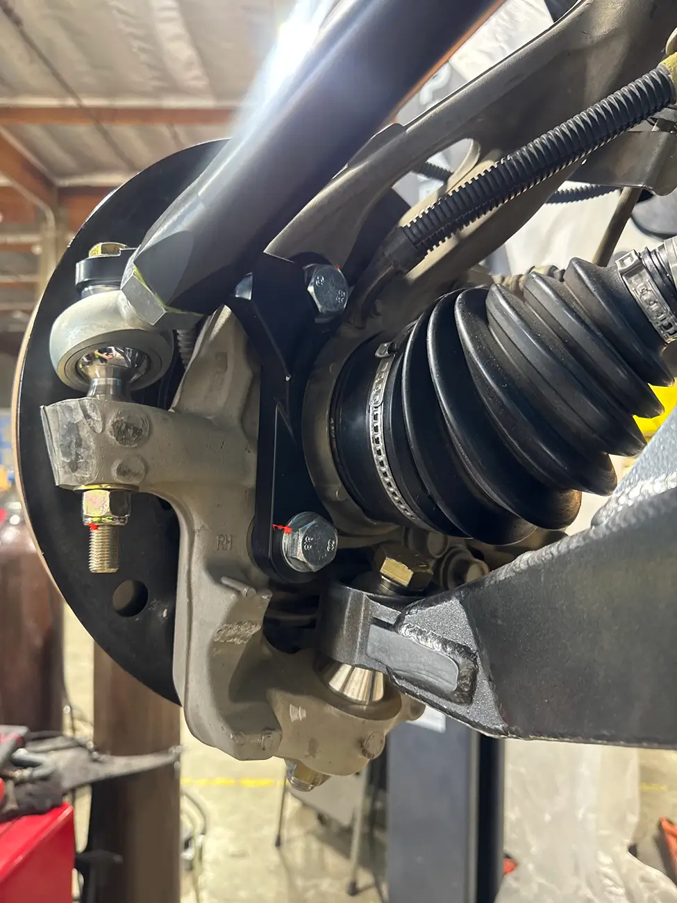

12/16/2025 Update (Frontend is Complete):
King 3.0 Coilovers, King 2.5 Secondary Bypass Shocks, King 2.0 Bump Stops, double-sheer billet aluminum HD tie rods, APG upper and lower control arms, and even the Braptor sway bar are all completely installed. This setup re-uses the OEM Bronco Raptor knuckle, too.

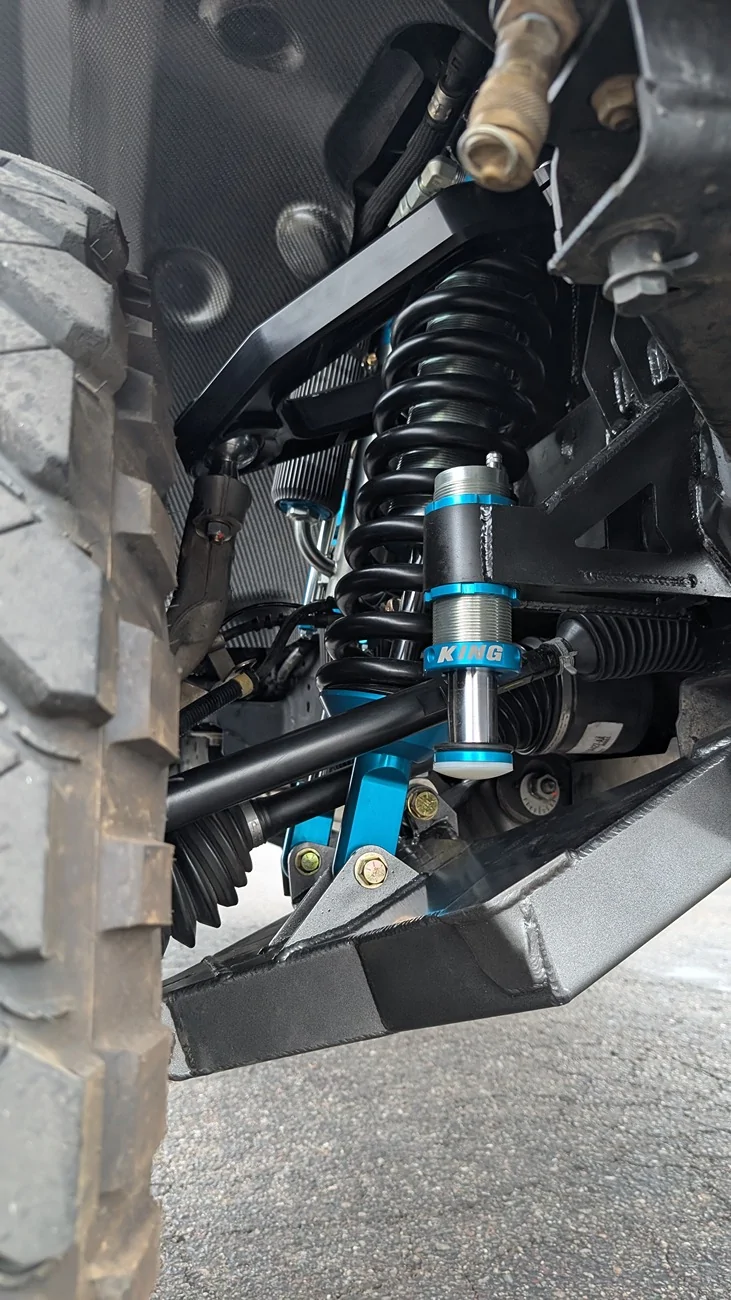

Here is an in-progress update of the suspension partially installed on the frontend of my Braptor:
The APG ProRunner System details are as follows for the Bronco Raptor:
APG ProRunner Front Suspension:
  • APG ProRunner +3.5" Long Travel Suspension System
  • Raised 3.0 Shock Towers
  • Chromoly Steel Lower Control Arms (replaces OEM Bronco Raptor Lower Control Arms)
  • King 3.0 Race Series Internal Bypass Coilovers with Long Finned Reservoirs and Compression Adjusters (replaces OEM Bronco Raptor Fox Live Valve suspension and OEM coils, or in my case, replaces the Hyperco HD front coils I was running)
  • Proprietary shock valving and spring rates
  • King 2.5 Secondary Bypass Shocks with Long Finned Reservoirs
  • King 2.0 Threaded Adjustable Hydraulic Bump Stops
  • Billet Aluminum Upper Control Arms (replaces OEM Bronco Raptor Upper Control Arms)
  • Double-Sheer Billet Aluminum HD Tie Rod Kit (pair) (replaces OEM Bronco Raptor tie rods or, in my case, the Foutz aftermarket tie rods I was running)
  • Raised Shock Tower System with Bypass Mounts

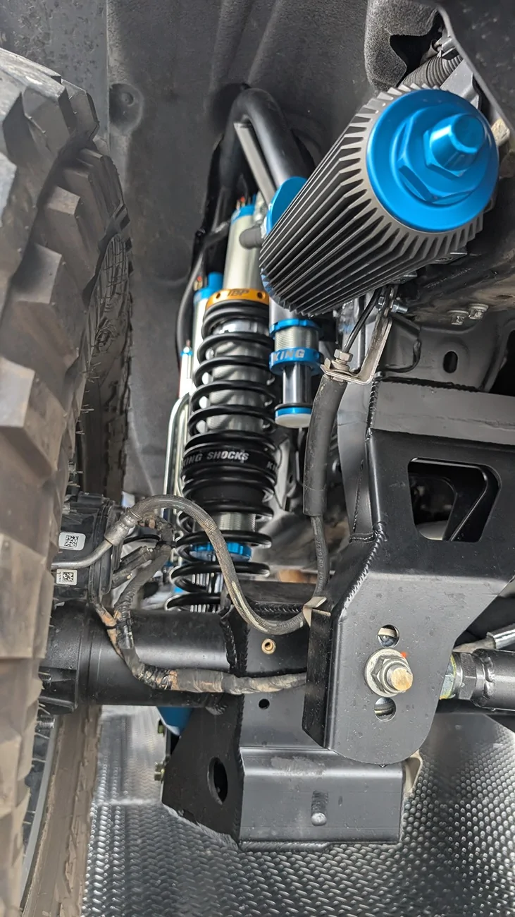

APG ProRunner Rear Suspension:
  • APG ProRunner Long Travel Rear Suspension System
  • King 3.0 Race Series Internal Bypass Coilovers with Long Finned Reservoirs and Compression Adjusters (replaces OEM Bronco Raptor Fox Live Valve suspension and OEM coils, or in my case, replaces the Hyperco HD rear coils I was running)
  • Adjustable Long Arm Kit with Johnny Joints (replaces OEM Bronco Raptor rear control arms or, in my case, the Foutz aftermarket control arms I was running)
  • Adjustable Track Bar Kit with Johnny Joints (replaces OEM Bronco Raptor track bar or, in my case, the Foutz aftermarket track bar I was running)
  • Weld-on axle brackets
  • Weld-on track bar brackets
  • Weld-on link brackets
APG ProRunner Drivetrain:
  • Ultimate Dana 60 Rear Axle Assembly 76” WMS (replaces OEM Dana 50 Bronco Raptor rearend)
  • Rear Electronic Locking Differential
  • Dana 44 AdvanTEK Front Drive Unit
  • Front Electronic Locking Differential
  • 5.38 Gears (replaces 4.70 OEM gearing)
  • Retains Bronco Raptor wheel bolt pattern
  • Dana 1350 HD rear Drive Shaft
