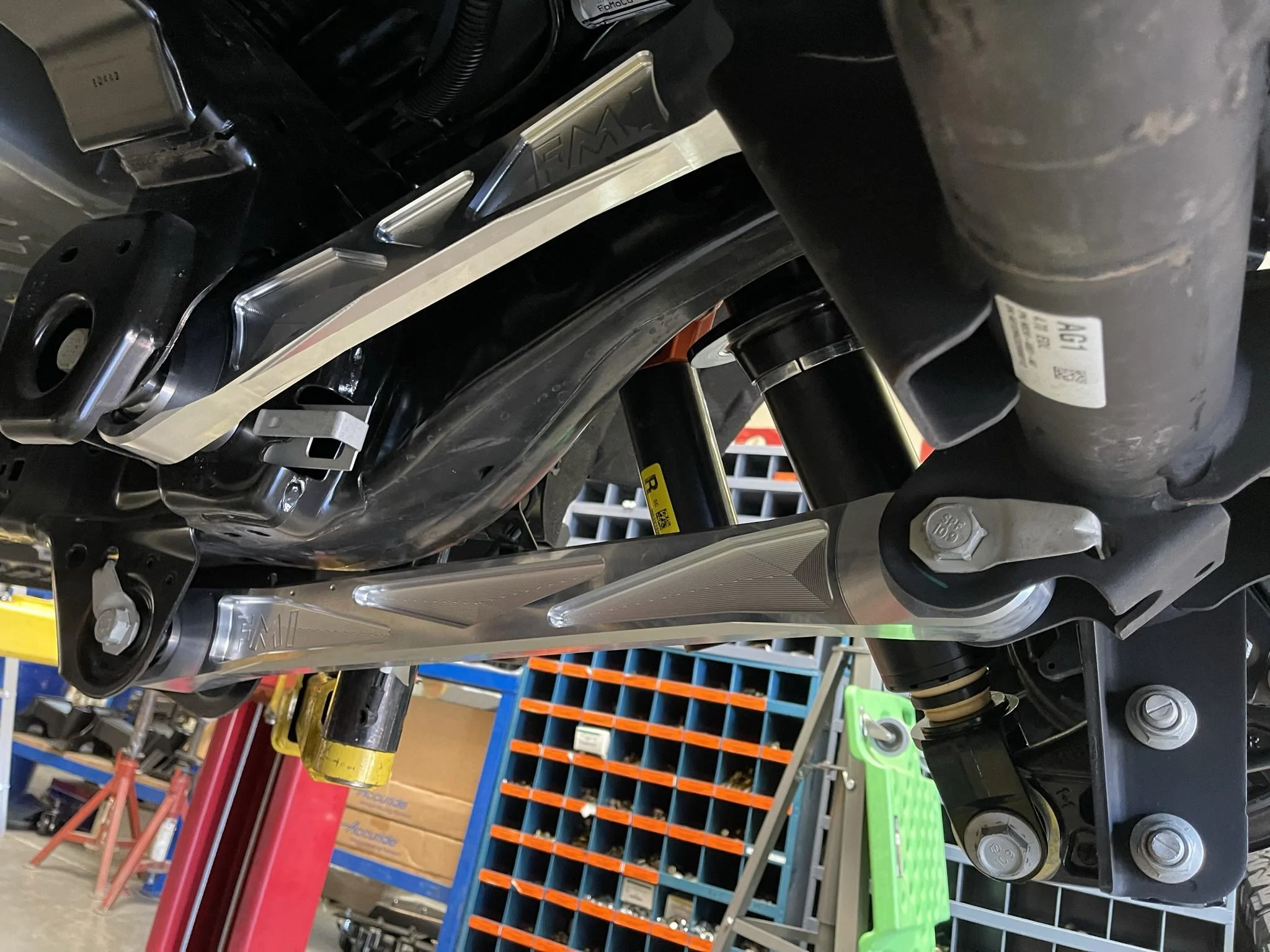

We got the new billet aluminum rear arms installed on the Bronco Raptor today. Looks great and works awesome. Check it out. Get your orders in now to get some of the first batch of production parts.

The upper arm on the gas tank side, I assume you had to cut the bolt or did you drop the gas tank?
you have to drop the fuel tank to get it handled. you cant just cut the bolt its trapped on the inside of the frame up there.

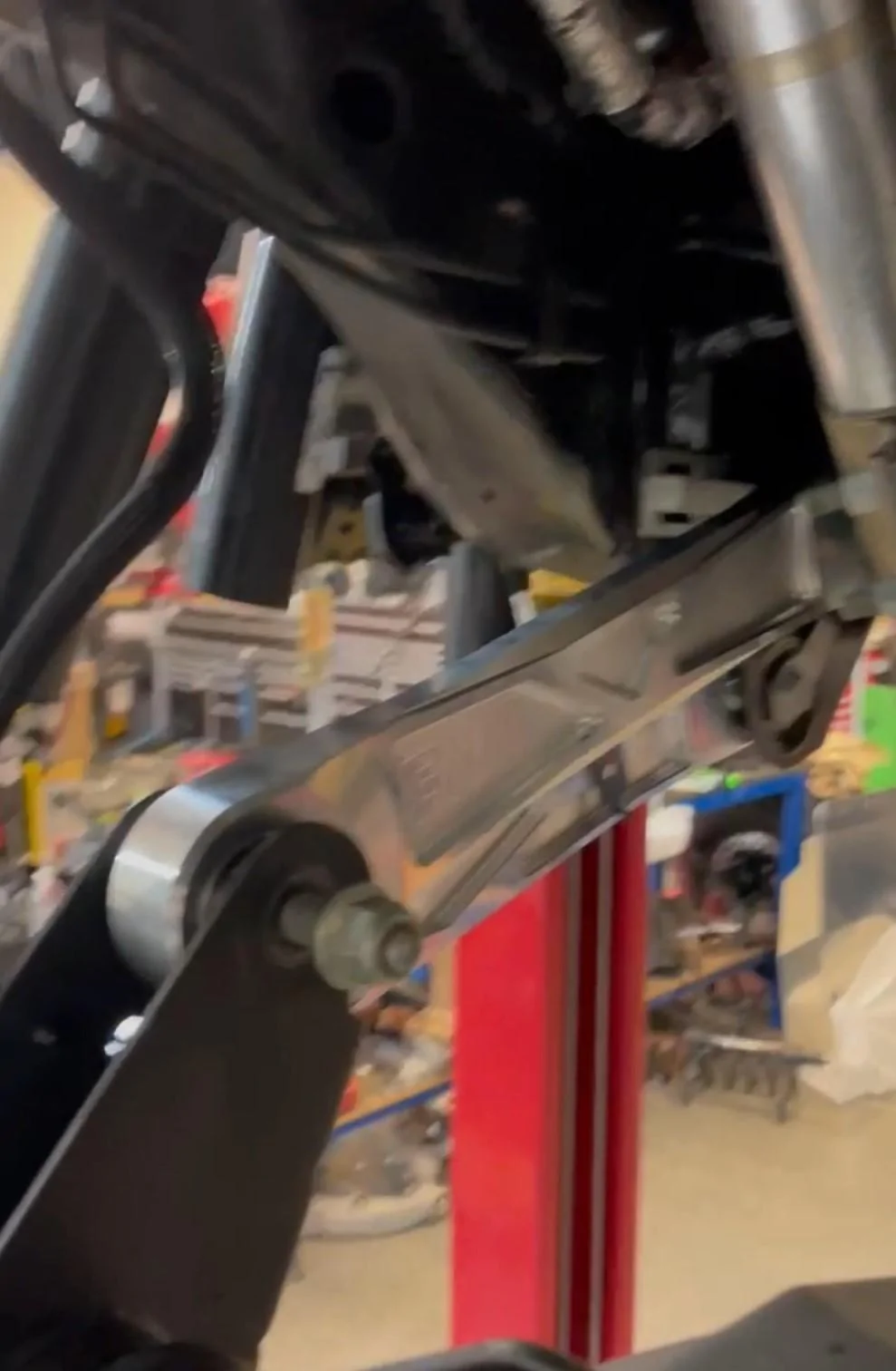

I sure hope you tighten this nut on the upper rear driver side arm before you hit the road.
yes obviously we did. we were assembling and cycling when I took the video. all good now but thanks.

Interesting. On the f150 raptor you can cut the bolt
yea we do Raptor leaf springs and Gen 3 arms all the time. The differnce in the bronco is where the nut is on the other side of the mount you cant put the bolt in the opposite way. Only way to remove or install the bolt is without the tank in the way. A bit of a pain in the neck but not too bad. we have it down where we can drop the tank in like 10-15 minutes now.
