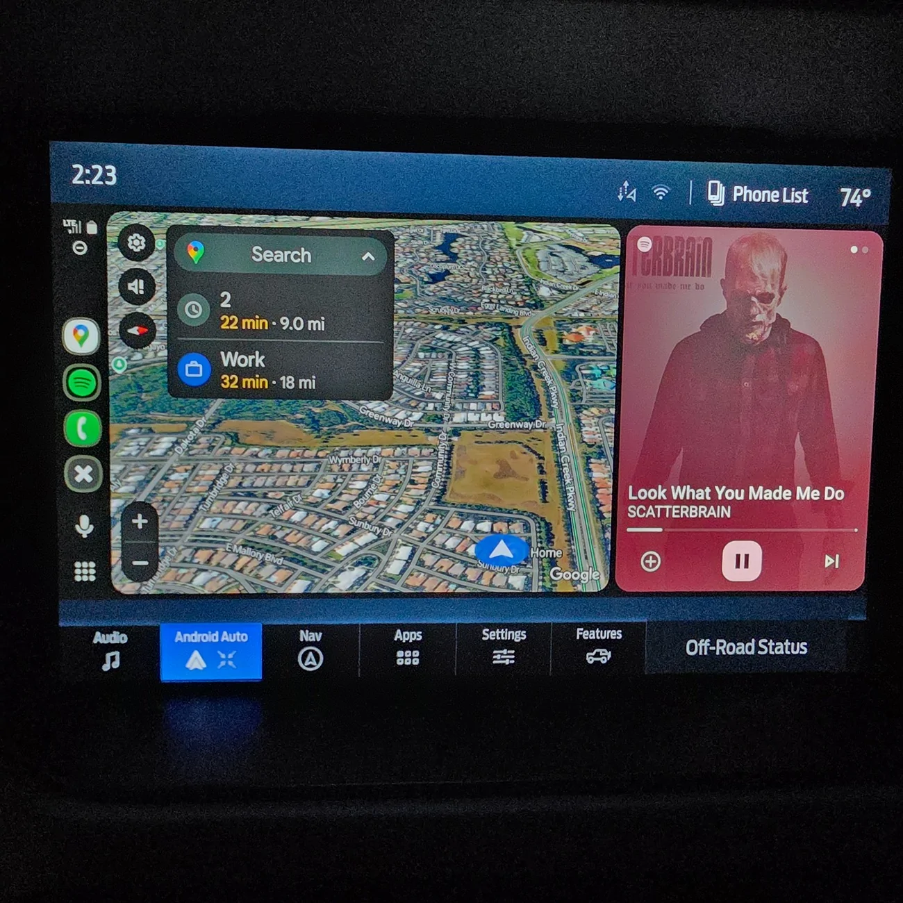

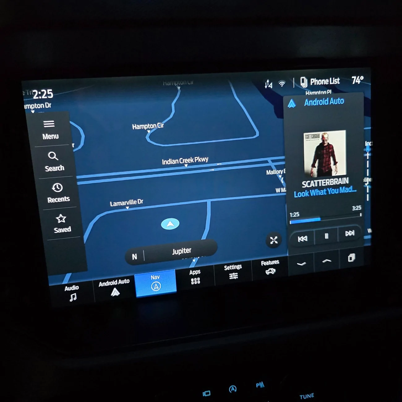

Here's what the MY2025 updated theme looks like:
Ford Bronco How To: Update Sync to MY 2025 Style Theme Graphics 1000077016
Ford Bronco How To: Update Sync to MY 2025 Style Theme Graphics 1000077011
Ford Bronco How To: Update Sync to MY 2025 Style Theme Graphics 1000077010
Ford Bronco How To: Update Sync to MY 2025 Style Theme Graphics 1000077015
Ford Bronco How To: Update Sync to MY 2025 Style Theme Graphics 1000077012
Ford Bronco How To: Update Sync to MY 2025 Style Theme Graphics 1000077014
Hopefully this hack helps solves any 2025 model envy you may also be having. Drop a comment below and let me know how you made out.

Maybe its my colorblindness, but I really dont see any difference...
Its a darker shade of blue, almost black. Consistent with the recent Ford Pass app updates. The button "textures" are embossed and edges are round vs square. There's a few others as you click through it.
