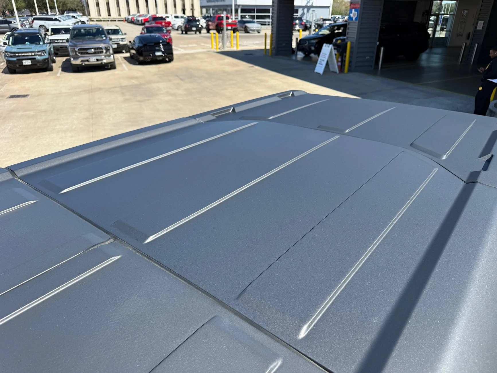

Once replaced, the mid-panel didn’t match the front or rear. It wasn’t drastic—but it was noticeable. I was told it would “fade and blend” over time with sun exposure.
It didn’t.

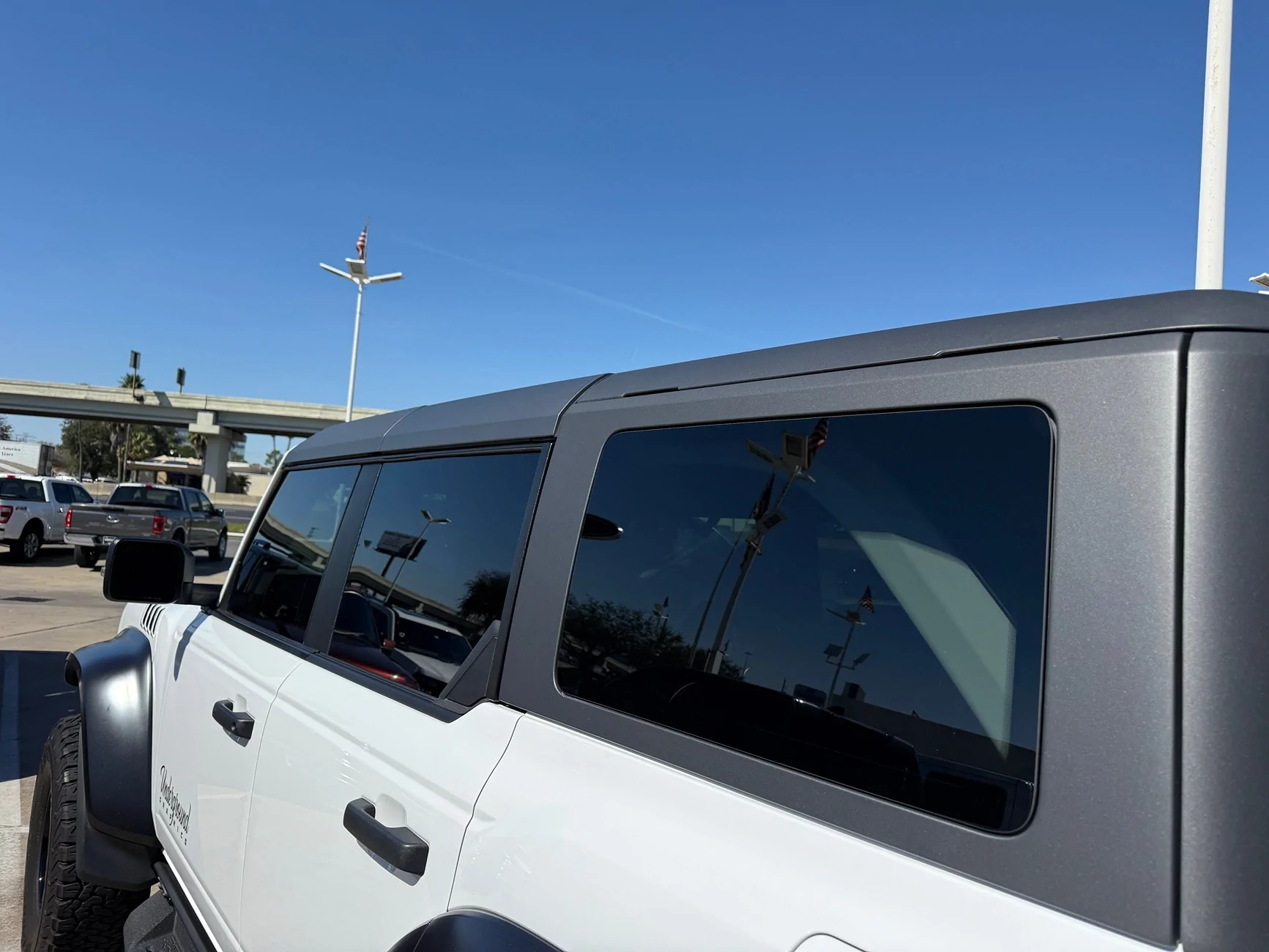

Fast forward to early 2026—I returned for another service visit (oil change, tire rotation, a door rattle, and to revisit the rear top issue). By now, those original hairline cracks had worsened. Initially, Ford denied the claim. After a week or two of back-and-forth, the dealer was able to get it approved.
Two weeks later, I went to pick up the vehicle. The rear panel was replaced—and it was a completely different shade.

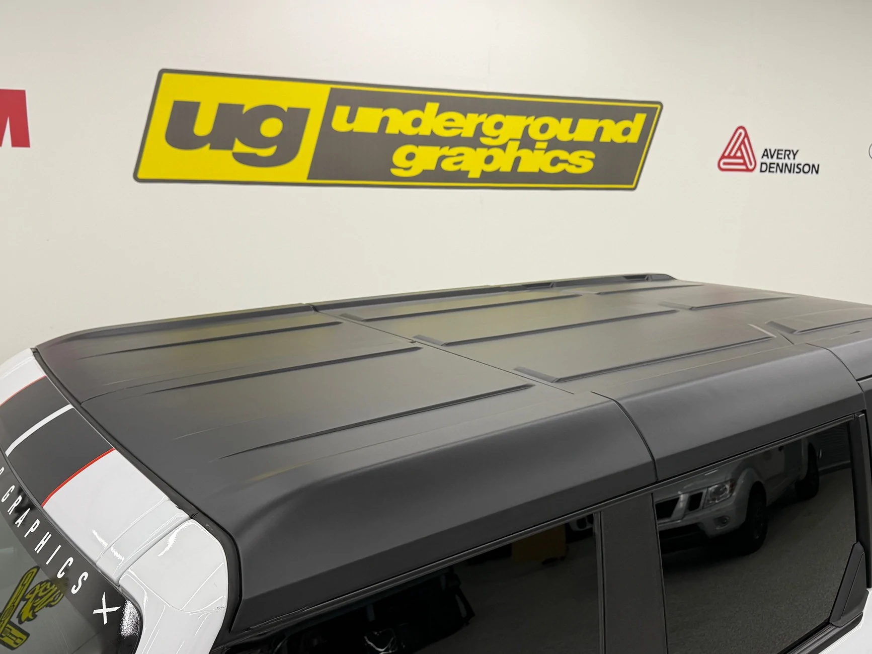

For context, I’ve been in the graphics industry for 26 years. Vinyl wrap is designed for painted, smooth surfaces. Applying it to a rough, textured MIC top—with deep channels—is absolutely not recommended. It’s a challenge in both adhesion and longevity.
But I wanted a real answer, so I wrapped it myself.

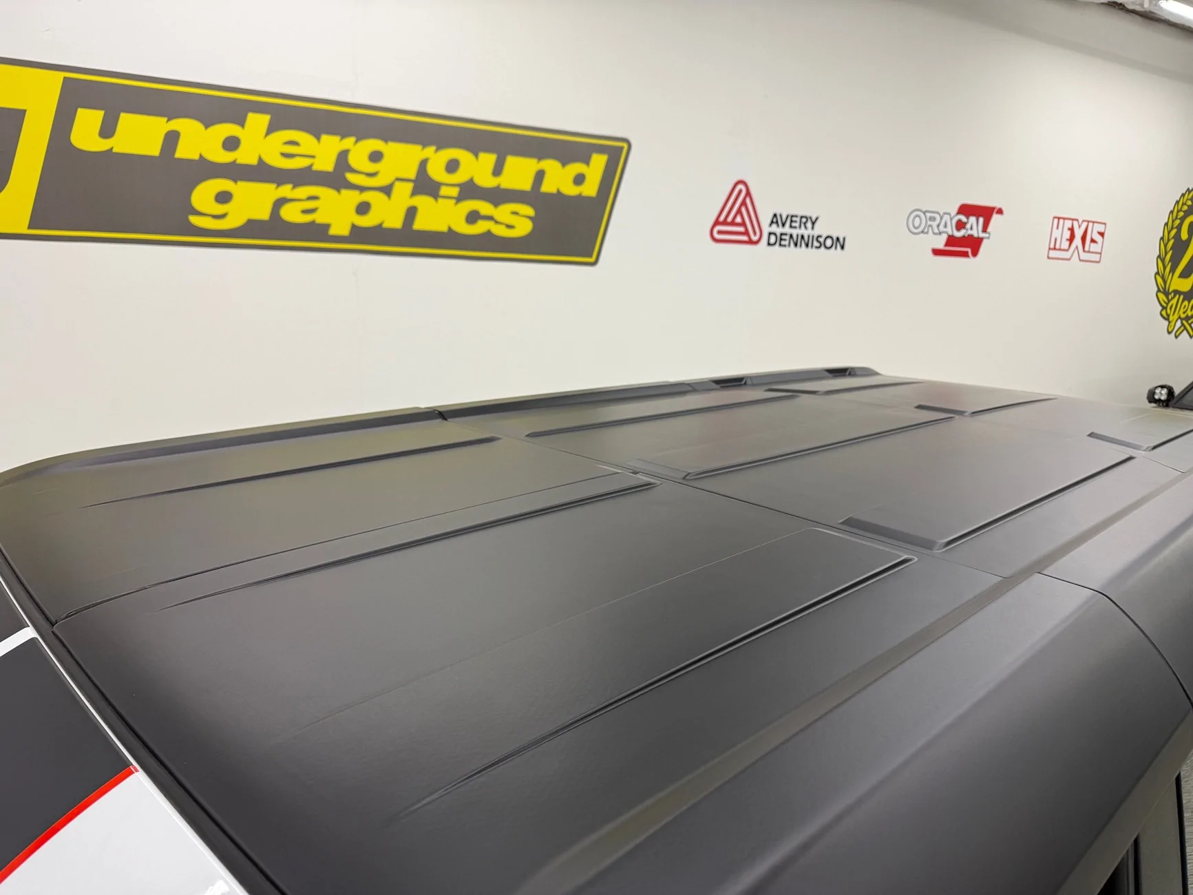

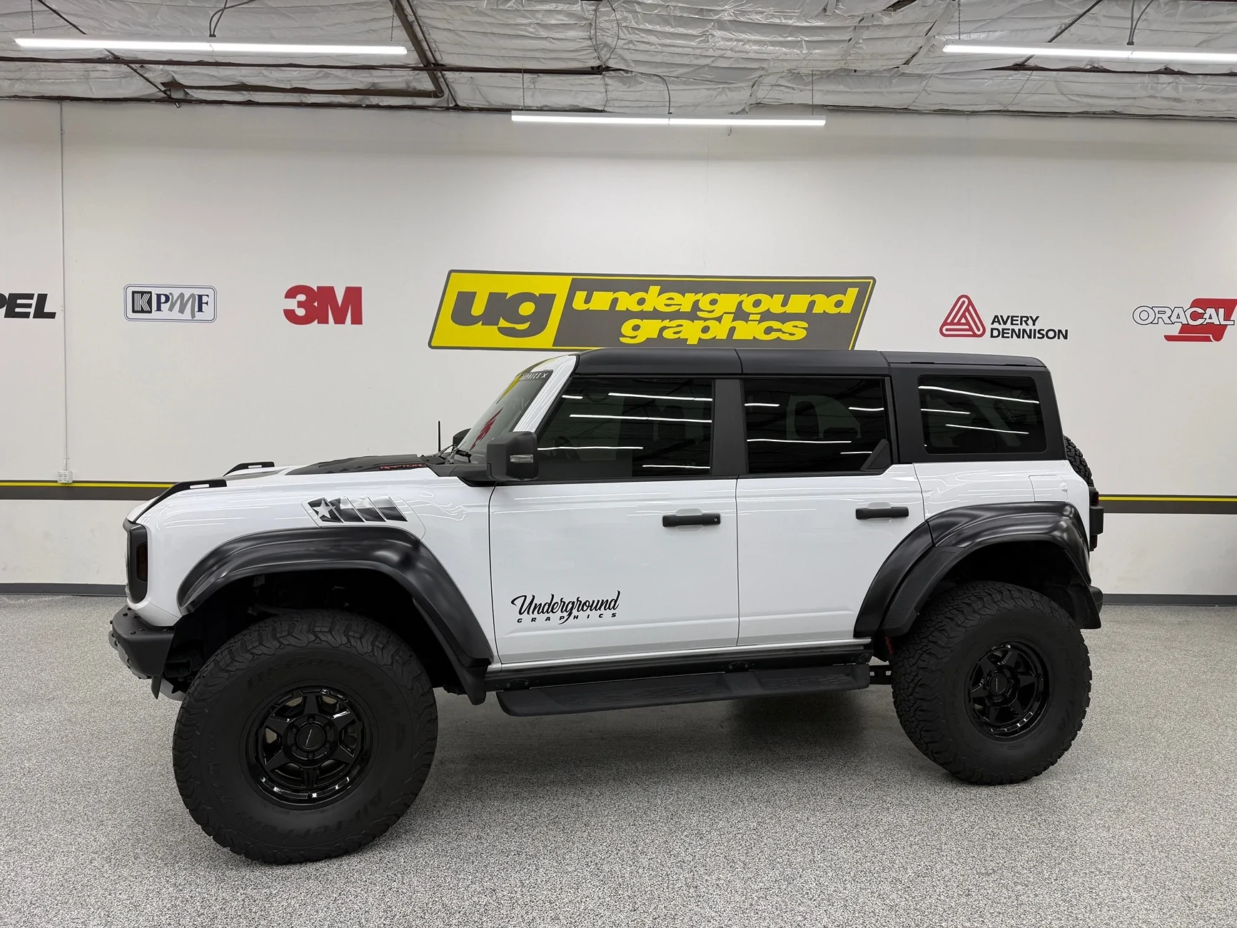

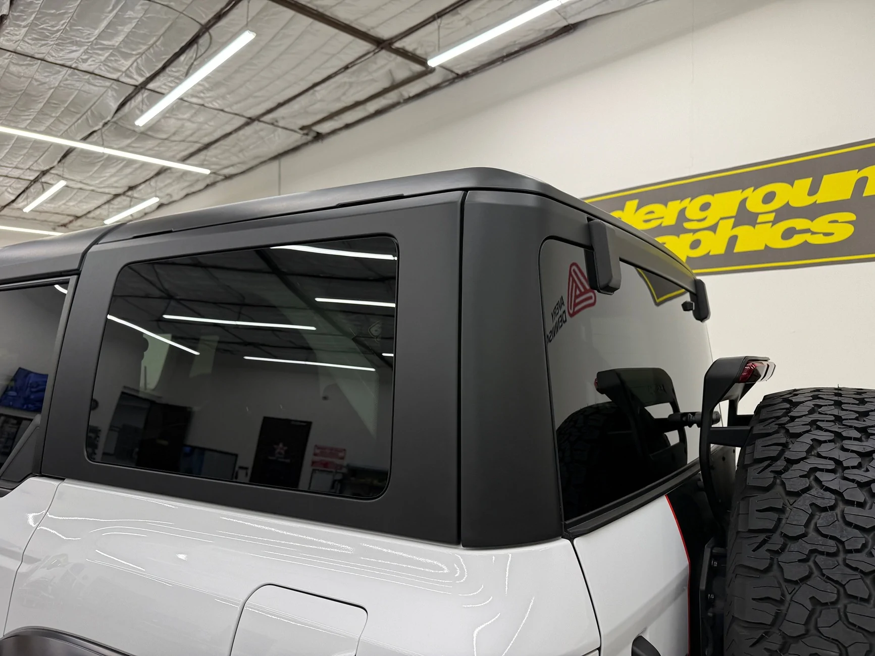

About six hours later, it was done. I used a 3M Deep Matte Black, prepped the surface thoroughly, primed the edges and channels, and post-heated multiple times to ensure adhesion. Material and labor would realistically put this around $1,200.
Right now—it looks incredible. I even applied a HyperClean SLIQ treatment to help maintain the finish.
But here’s the honest truth:
I don’t know how long it will last.
If I had to guess—I expect failure at some point. That’s simply the reality of wrapping this type of surface. I hope I’m wrong, because I genuinely love the look and would prefer this over alternatives like Line-X.
