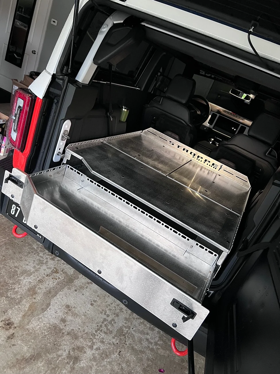

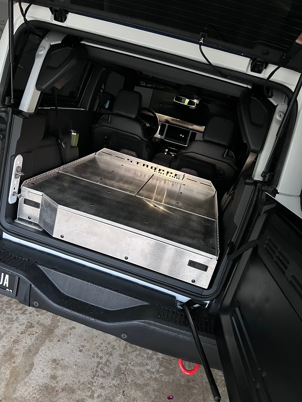

Little teaser of today’s project: rear storage drawer system with rear seat leveling platform. The forward panels are removable allowing use of seats as needed; can use one with panel or remove both panels and have two seats. All custom made by me for the 2 Door life -Stroppe Edition-

That’s very cool. Nicely done

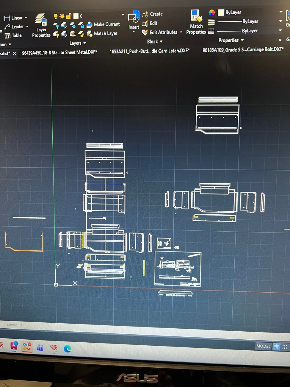

Thanks had a lot of hrs of design time that went into it, have a few things to button up on it then off to get powder coated and then decking foam added upon final install.

Impressive! And it looks lightweight, so even better.

Nice work!!
It also makes me smile that even with the rear seats folded and covered by the front platform, you still show off use of the rear cup holders. 😂
Cheers to the 2-Door Life! 🎉🍻

Nice! How's the rear drawer secured to the floor? just under its own weight or are things bolted/strapped down?
It utilizes the factory tie down bolt locations so it is all 100% bolted in and secure, front removal panels are than bolted to the main drawer system using small allen head bolts quick and easy removal yet secure and safe more pictures to come once finished, have a few finishing touches to do than off to get powder coated.

I’ll ask the $64K question? How much … ballpark?
I have just material cost being I work in a shop that has around the million dollars worth of cnc equipment I can utilize on my time, but if you were to pay someone to build it you would be looking at around 2800-3k.
