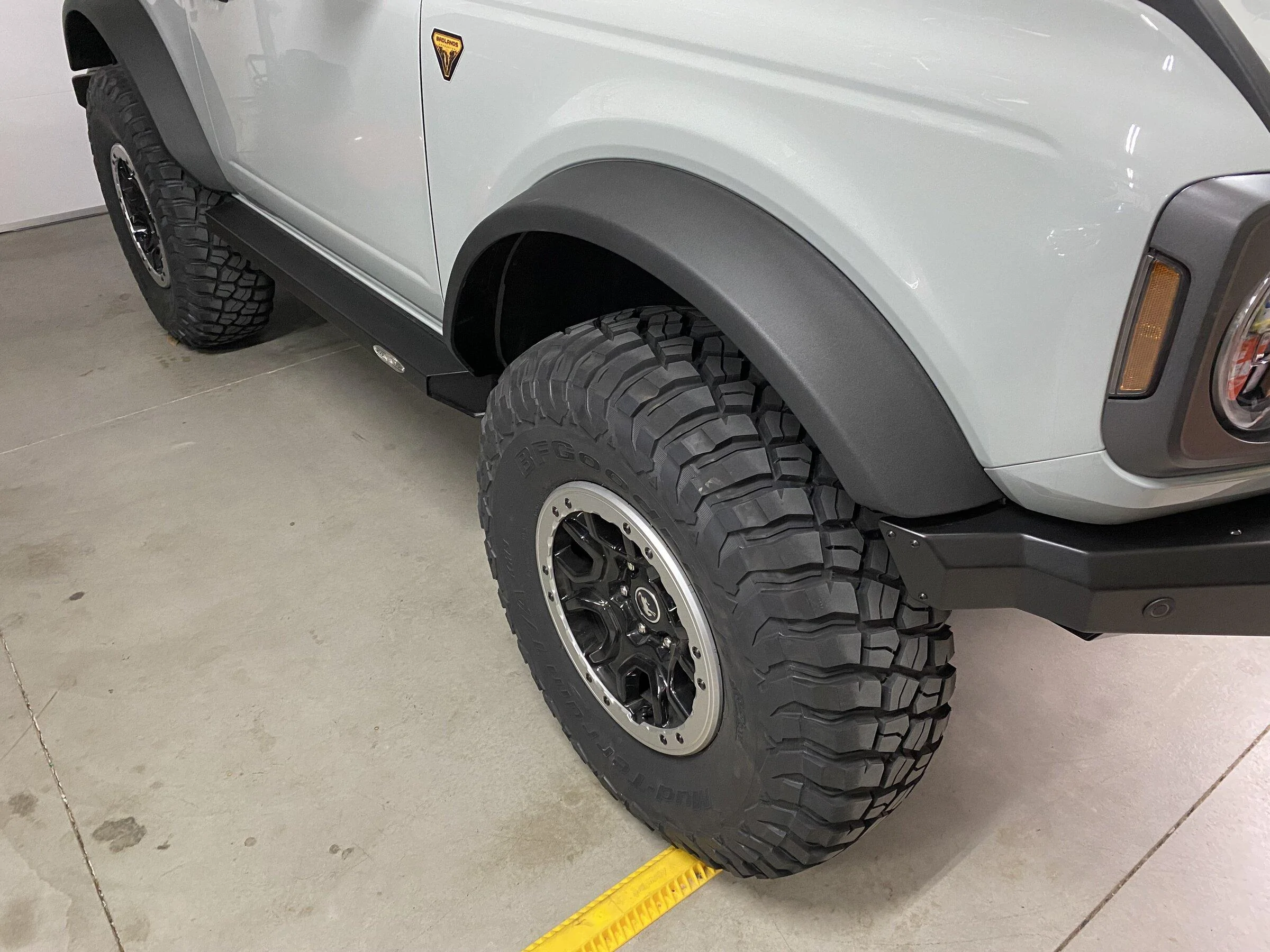

Probably asked snd answered. We have a 2 door SAS and was curious what we need to do to install 37s on SAS wheels? Do I need spacers or can install without. I do wheel my Bronco, so would prefer to not rub at full lock. Thank you in advance.

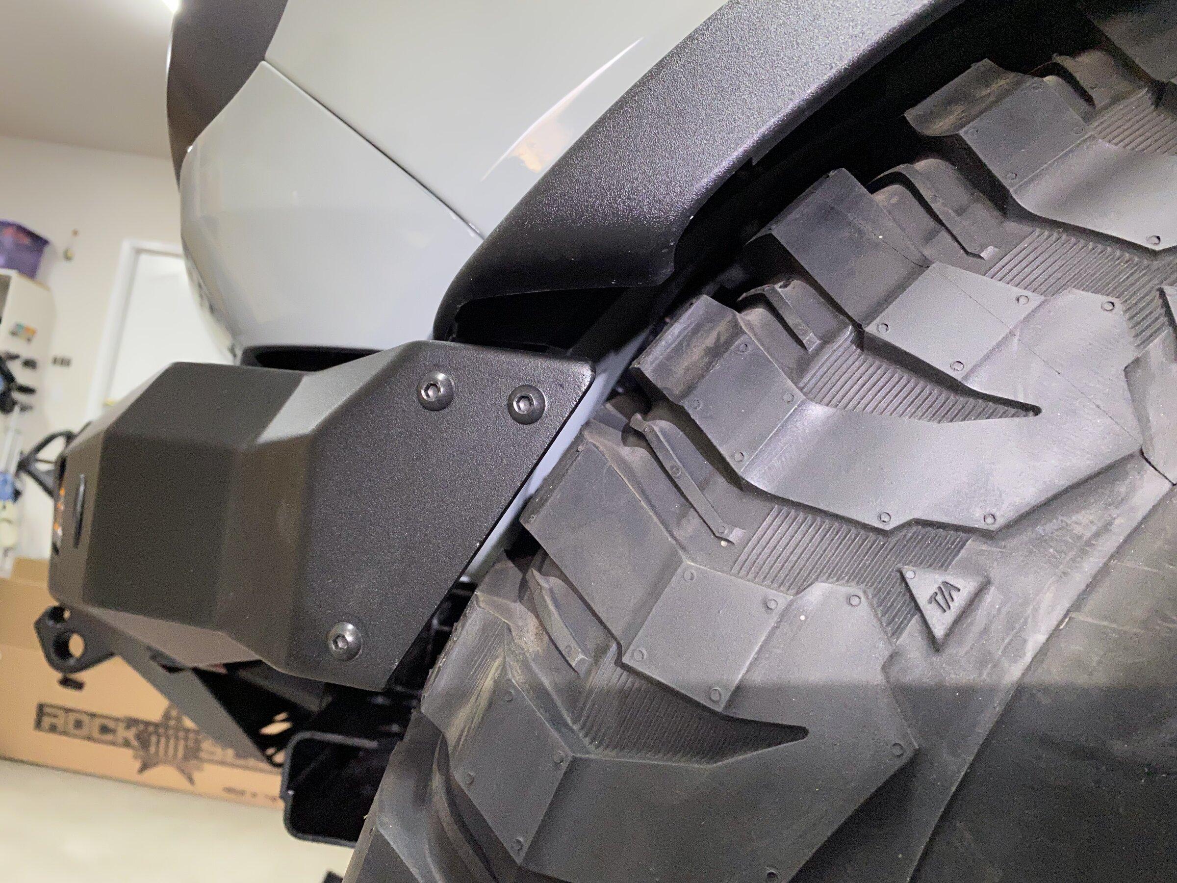

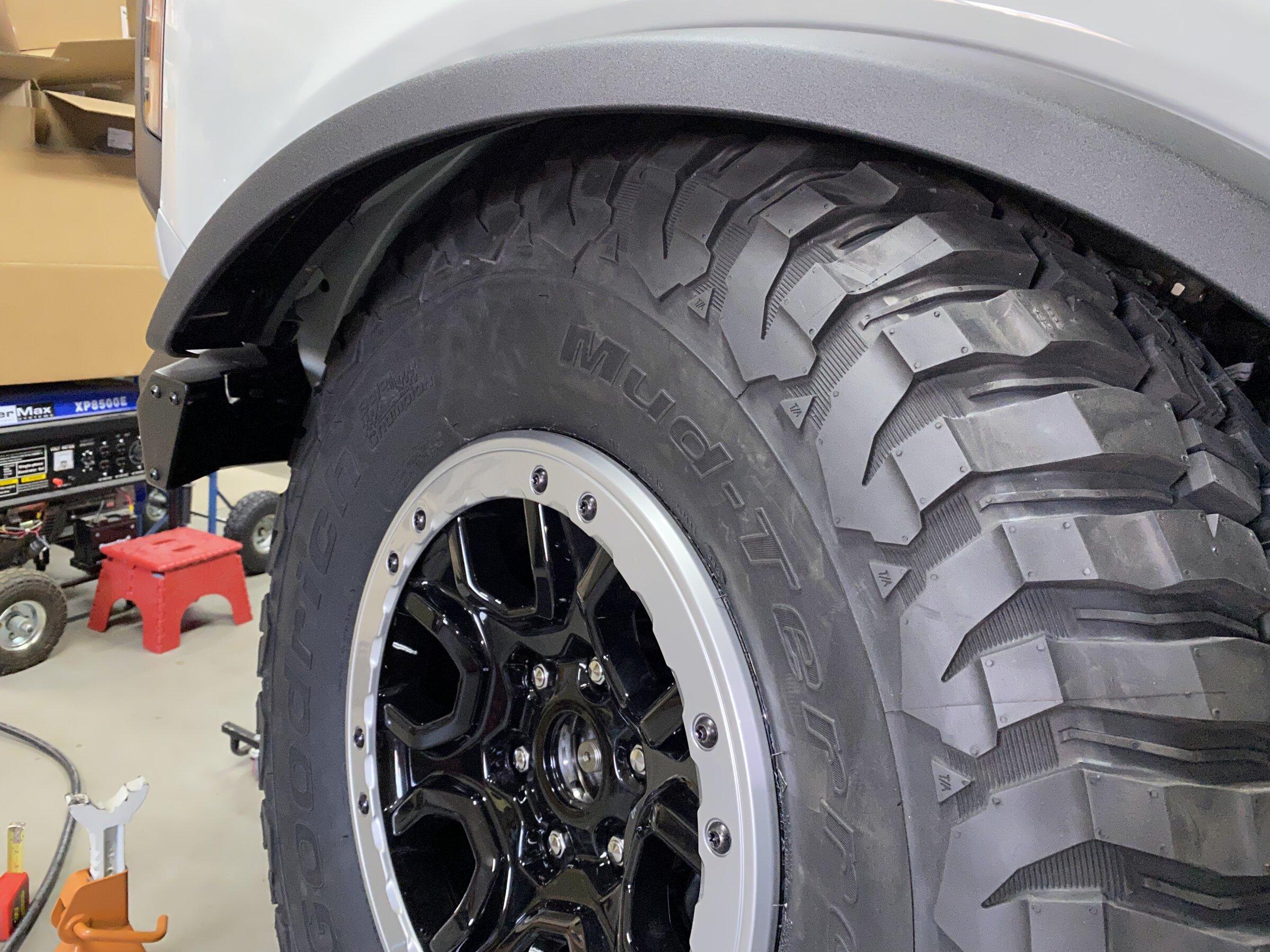

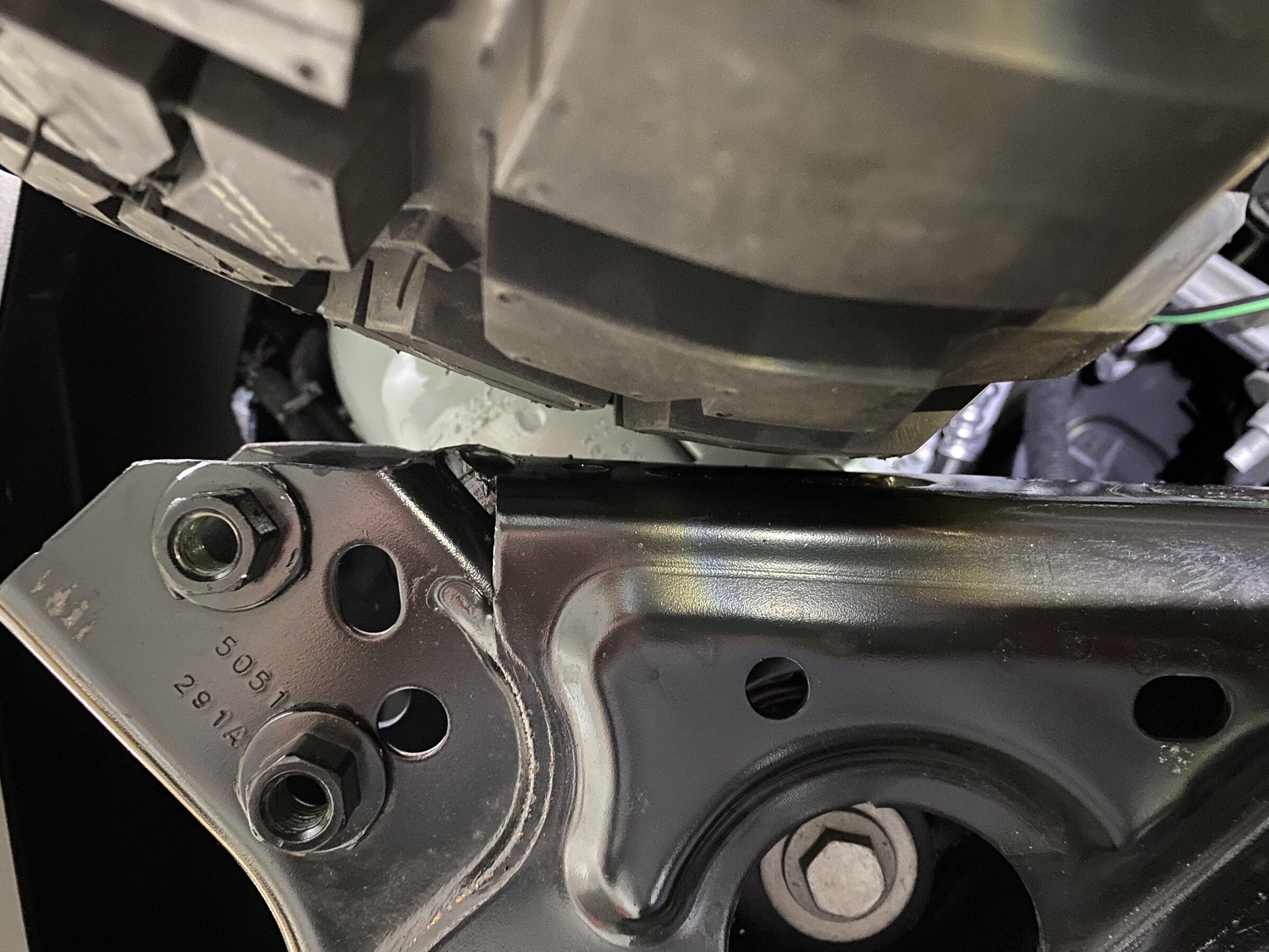

0.75" wheel spacers to avoid lock to lock rub. Minor trim of crash bar mount corners may be needed. If your wheeling involves full compression, then perhaps also a lift that adds a strut spacer such as zone 2"/1" or icon 3".
