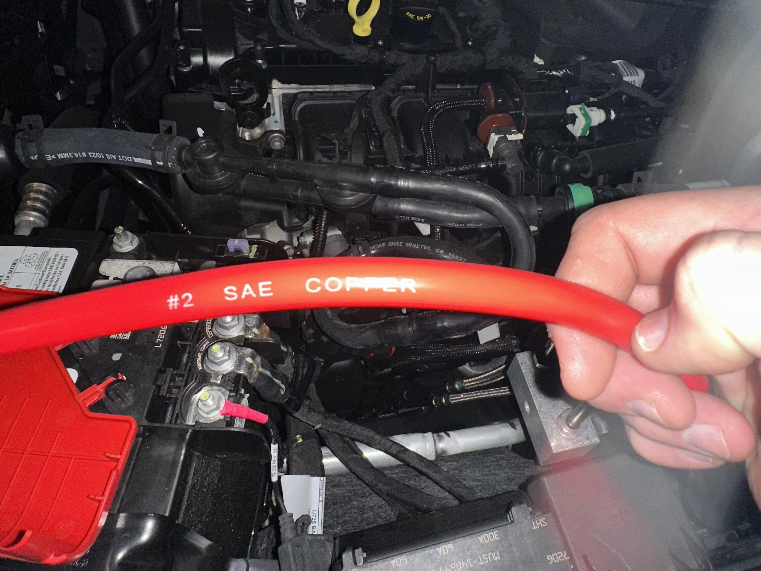

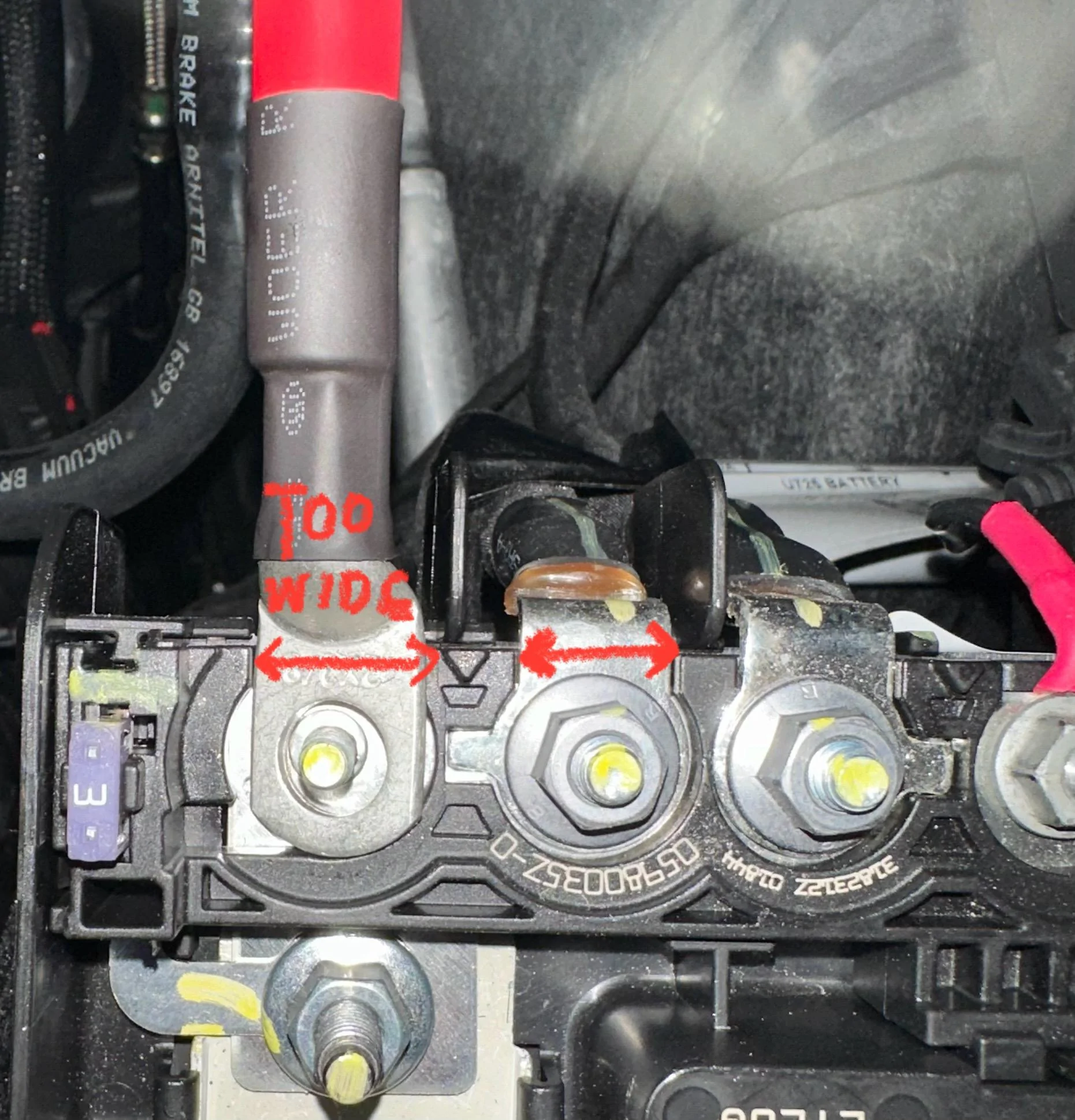

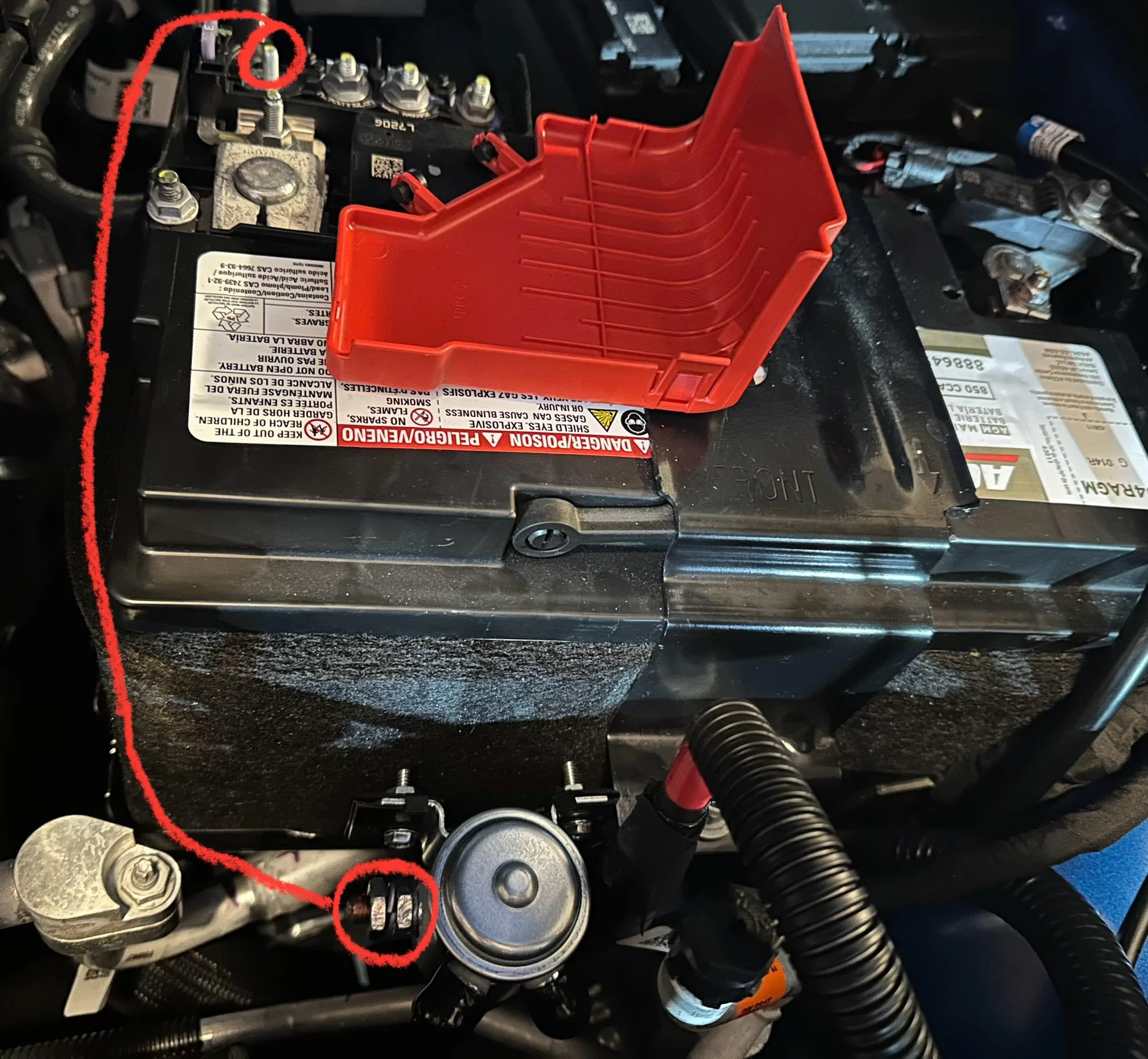

I need to connect #2 copper wire provided with WARN power interrupt kit to positive battery terminal. The provided wire (lug) does not fit into the terminal bay as it is too wide. Bending the lug to fix the angle does not solve the width problem. Am I just dense? (Please don't answer that last question)
I also need to create a 3 foot cable rather than 2 feet (as provided by WARN) to reach around the battery from my solenoid mount. Any thoughts?
I'm trying to search for a #2 lug that has a slightly narrower neck to fit within that slot on the terminal bay. However, almost everything I can find seems to be the same style with one width throughout the lug.
Many thanks!

How about an end with a smaller hole ? The cable you have has a hole that is too big.
https://www.oreillyauto.com/detail/...pper/ss01/08786?q=battery+cable+lug+2ga&pos=4
then you could trim the sides to fit the bay.
And since you want a different length just build one the way it should be/how you want it.
