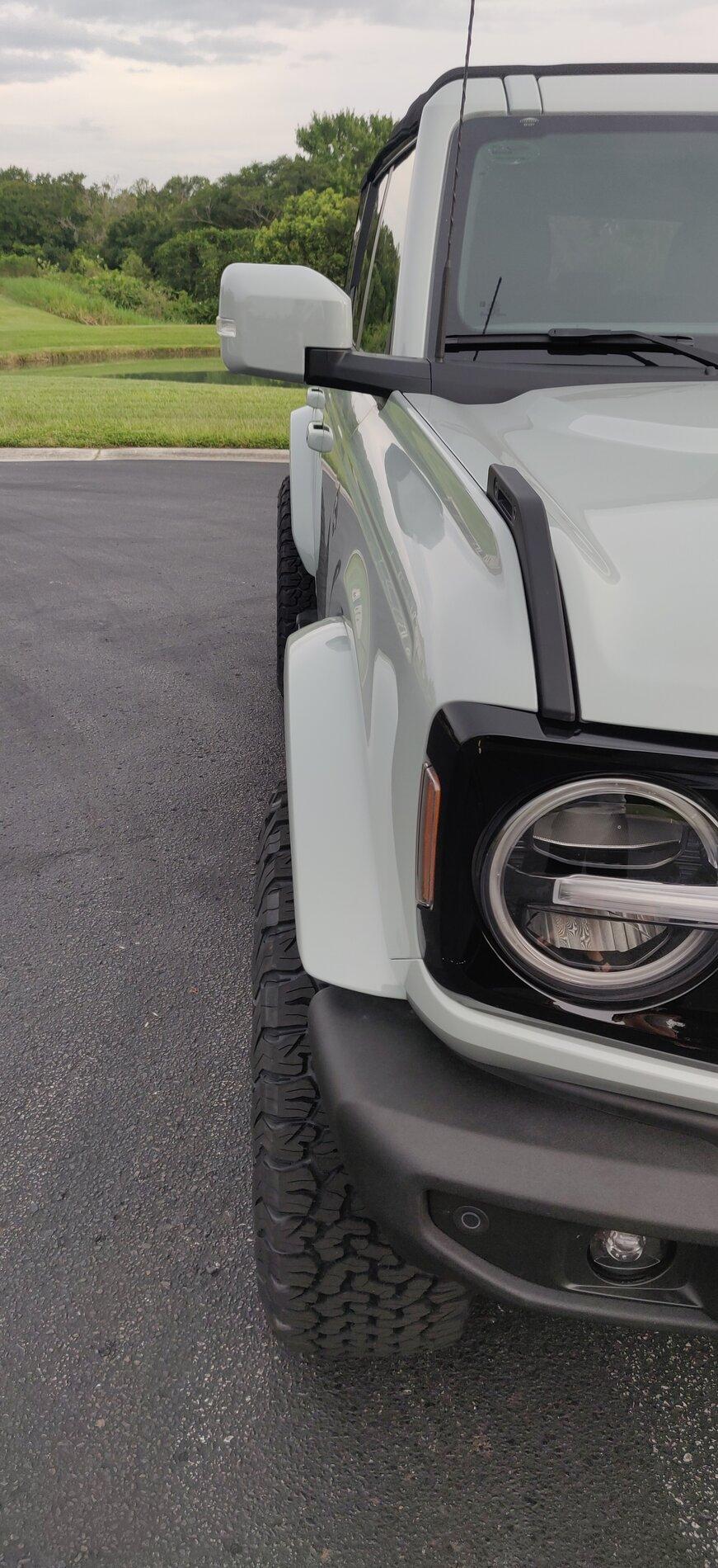

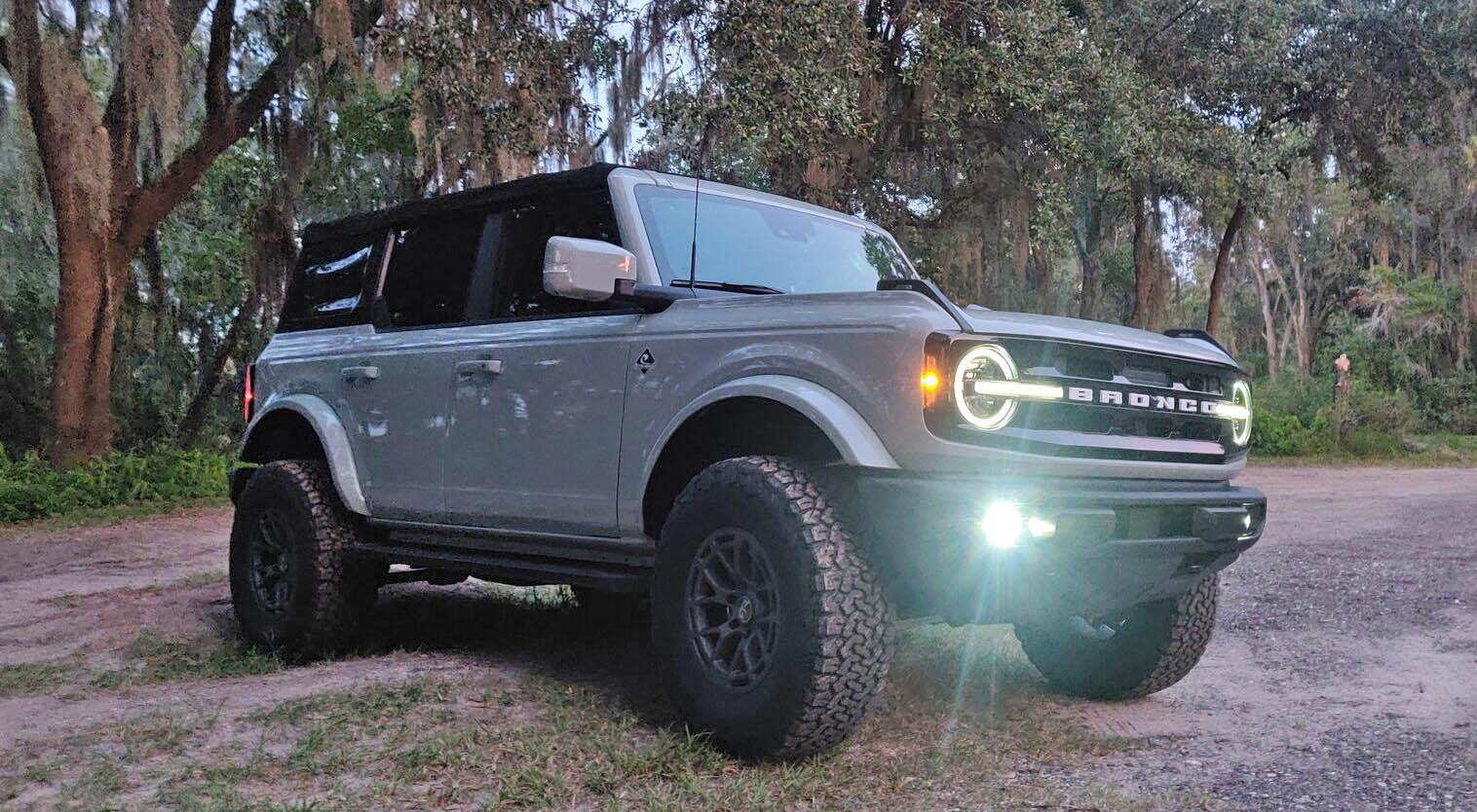

After a few struggles I am excited to share the final outcome of our leveling kit and wheel/tire install!
Our specs:
Non-Sas OBX
4WP Leveling Kit with Big Tire crash bars
17x9 +30 RTR Tech 6 wheels
315/70r17 BF Goodrich KO2
1.25 inches of tire "poke" beyond the Non-Sas OBX fenders. No rubbing even at the limits of the OBX articulation.
Also the stock 3rd brake light clears the tire, just barely but it clears! I was worried I would need a taller 3rd brake light mount.
Ford Bronco 17x9 RTR Tech 6 wheels (+30 offset), 315/70r17 BFGs, 4WP Level Kit installed on OBX IMG_20210727_202836__01

Looks great. That was a cool Easter egg that you found as well! Look forward to more.

Like it. Personally, I feel like the chunky standard bumper looks more at home for the bigger tire / lifted builds. From the front view, the ratio of 'lift to body' looks off with the mod bumper since it's thinner. It's too much height for too slender of a body. I.e. mod bumper looks good on non-sas to give appearance of more lift, but chunkier standard bumper looks better on sasquatch.

how's the ride versus sasquatch suspension?

Can you post some pics of the wheels that have some better resolution? I watched your whole video hoping for some closeups to the side profile in good light but only the spare seemed to be clearly viewable. Stoked for you guys!
