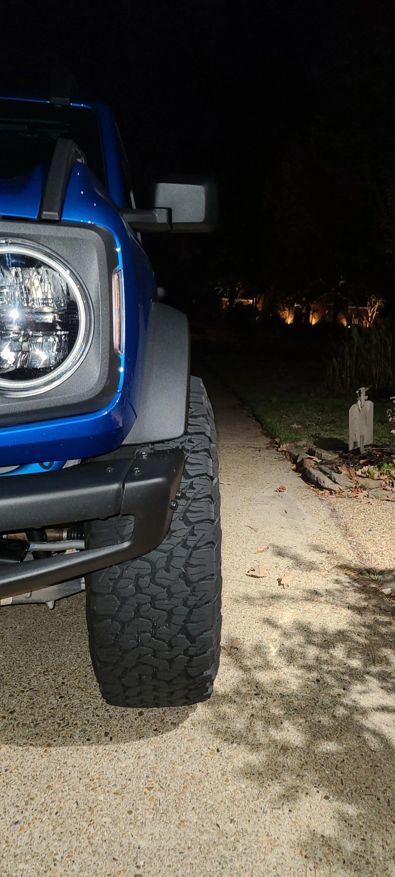

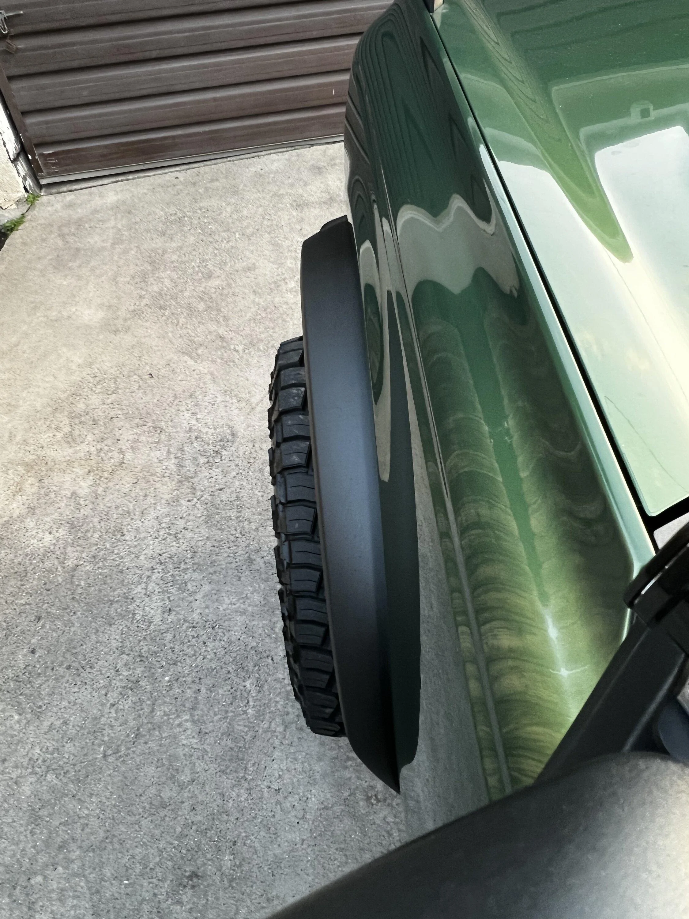

I’ve attached some pics of my wheel setup. Running American Racing AR172s that are 17x8 at 0 offset. Tires are KO2s at 295/70R17. Rims are a little more narrow than yours but tires a bit wider. The first picture is after I put them on with standard flares, the second picture is after I put on Sasquatch flares after trading someone. 1mm offset will poke for sure beyond stock flares.

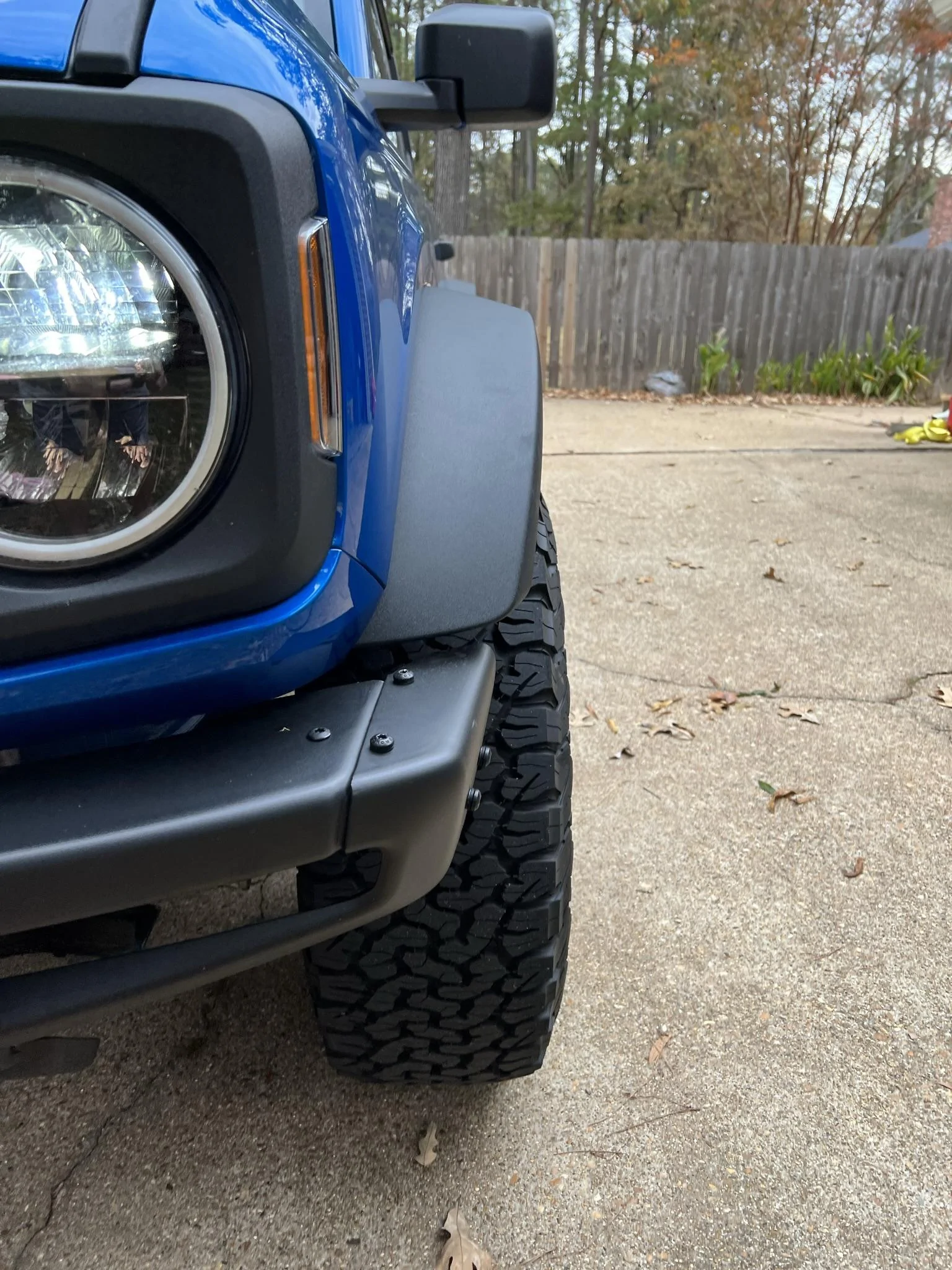

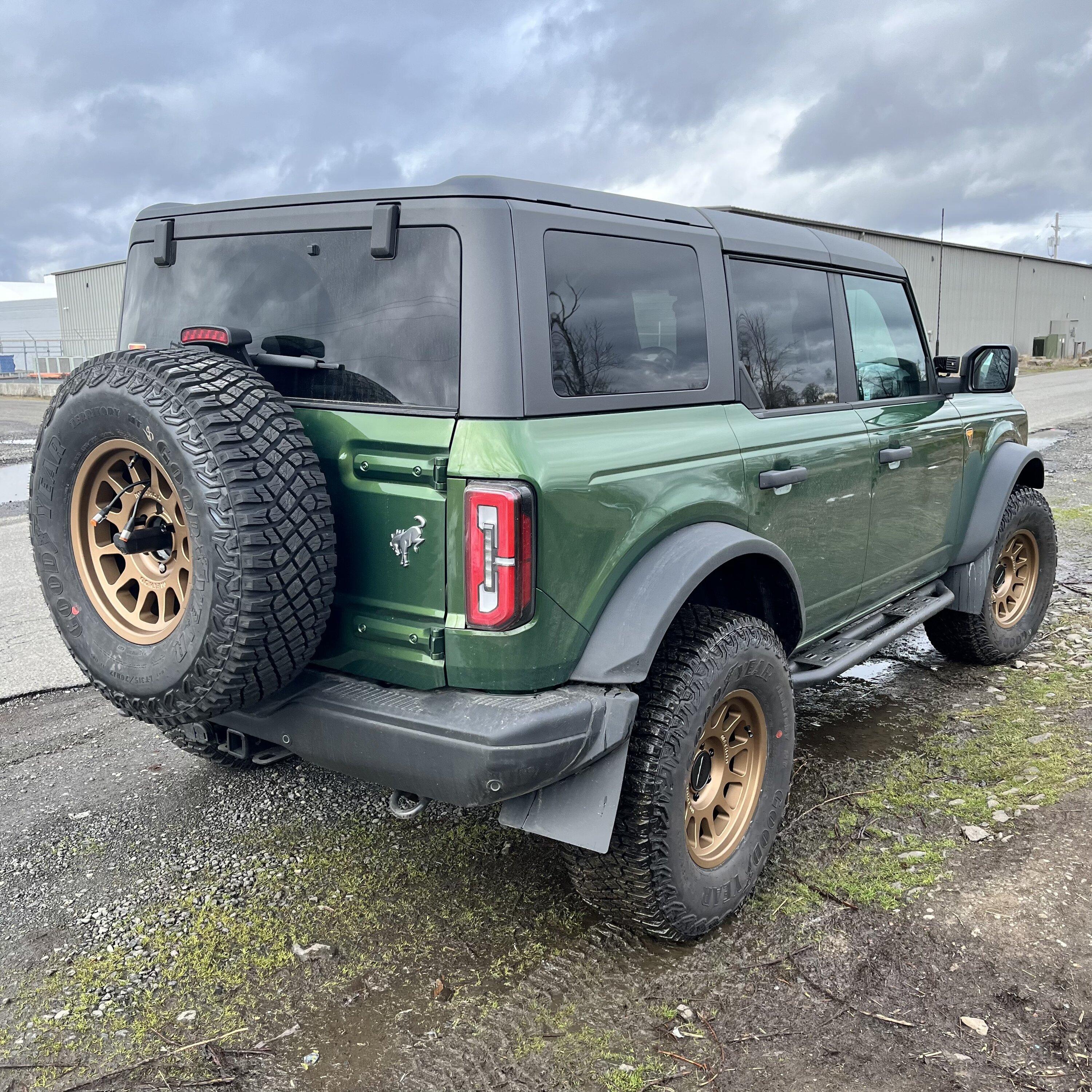

Again, why 285 on 9s? Are you sure that’s the look you want?
Also you are going to stick way out past stock flares. And past Sasquatch flares too.
These are the 315s on 8.5 with 0 offset. And Squatch flares.

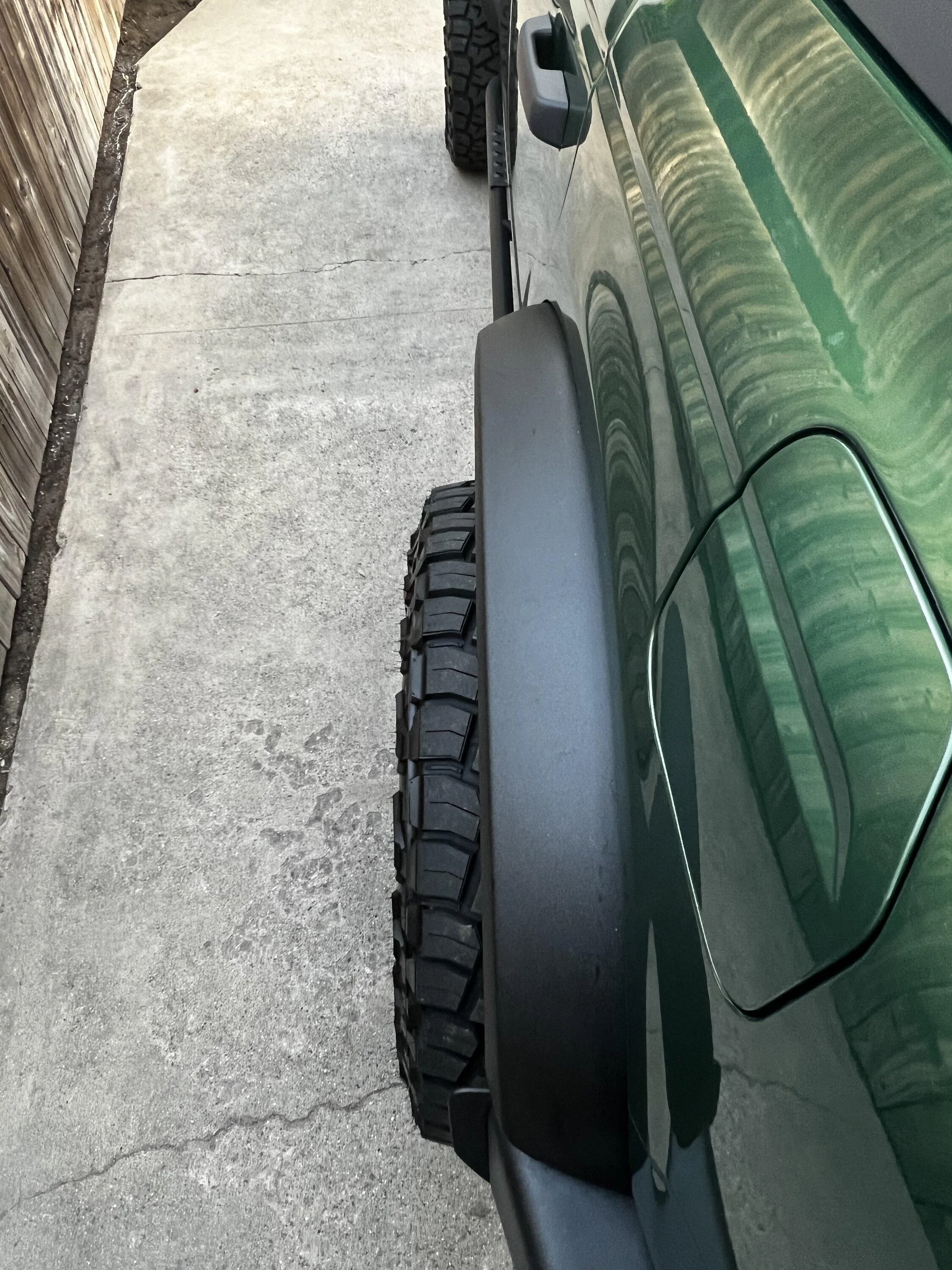

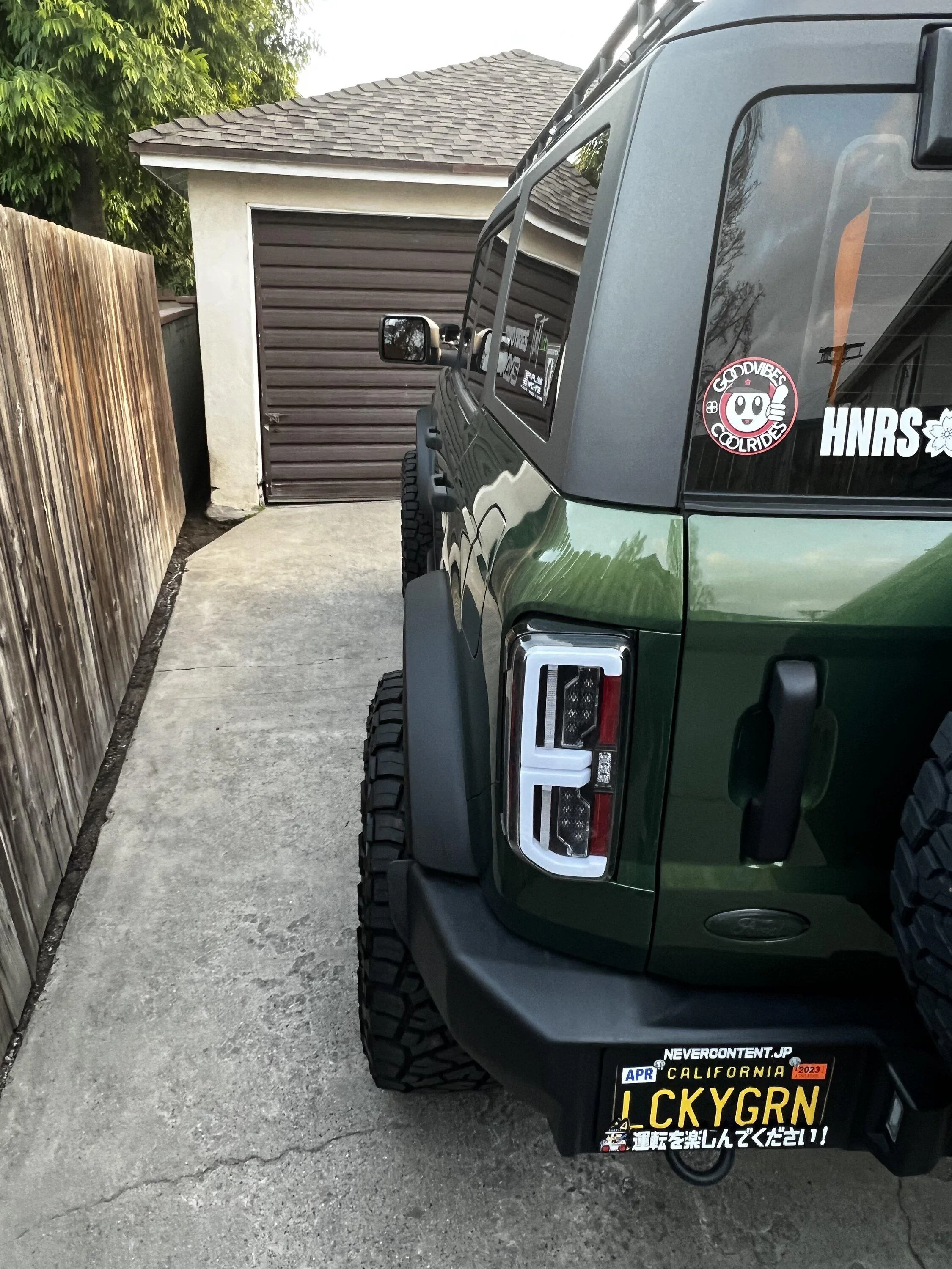

Here is a 285/75/18 on a 18x9 wheel at +12 offset. Sasquatch Flares included. The outside bulge of the tire is even with the outside edge of the Flare.
With a -12 Offset and a Standard Flare the tire will stick out about 2 inches beyond the Flare.

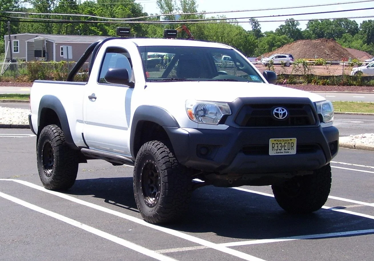

I think you want to go with the +1 offset. You may want to look at 305/65/17 tires which are around 33" and would fit the 17x9 wheels a little better. I ran them on my old Tacoma.
