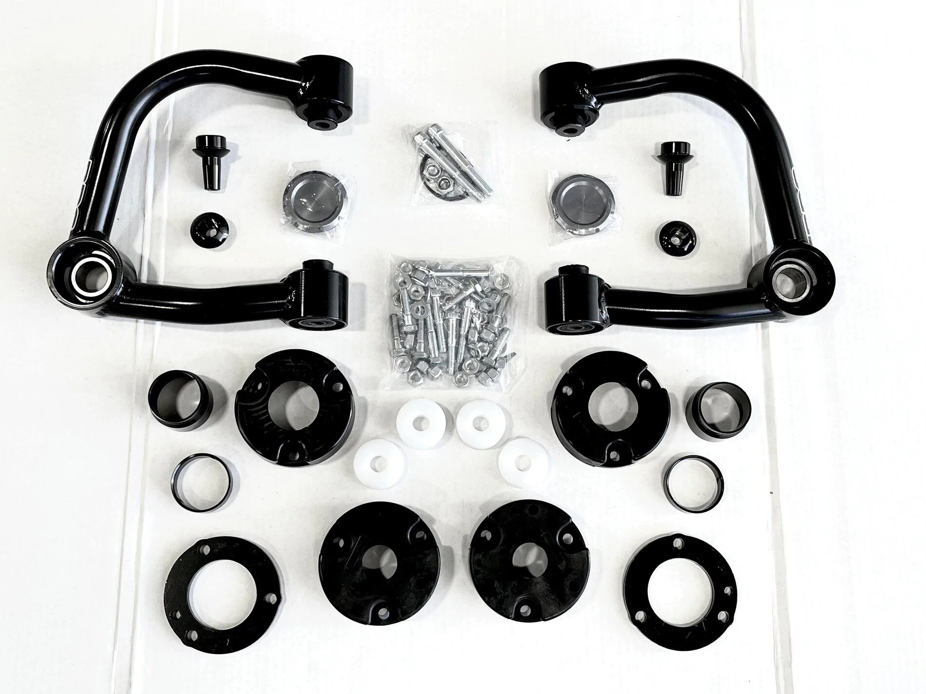

Kit includes:
  • 2 - BDS Suspension upper control arms (left & right)
  • 2 - front upper strut spacers
  • 2 - rear upper strut spacers
  • 2 - 3/8" rear upper strut spacer
  • 2 - front preload spacers
  • 2 - front bump stop extensions
  • 1 - hardware package (includes bolts, washers, & nuts)

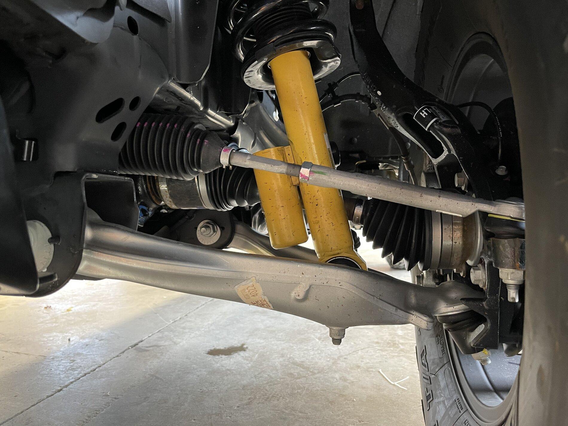

Since we're all still learning about what can be done to our Broncos, it would be good to know what testing you did to assure that the stock CV axles are ok with 4" of lift. Do you have any info on the limits? Thanks.
We and BDS thought it looked pretty good….

What does "look pretty good" mean? The question isn't about ride height, it's about at full suspension extension. What do you have about that? If on the trail and one side is drooped out and the tire is also turned hard is the CV maxed out at that height or not? We have no way of knowing except that you guys tested it.

Well, I didn't post the question to be negative. I really want to know how much those axles can take. One company said no more than two inches, this company says OK at four inches. Just give us the data. If there actually was no testing, and nothing to give, well........

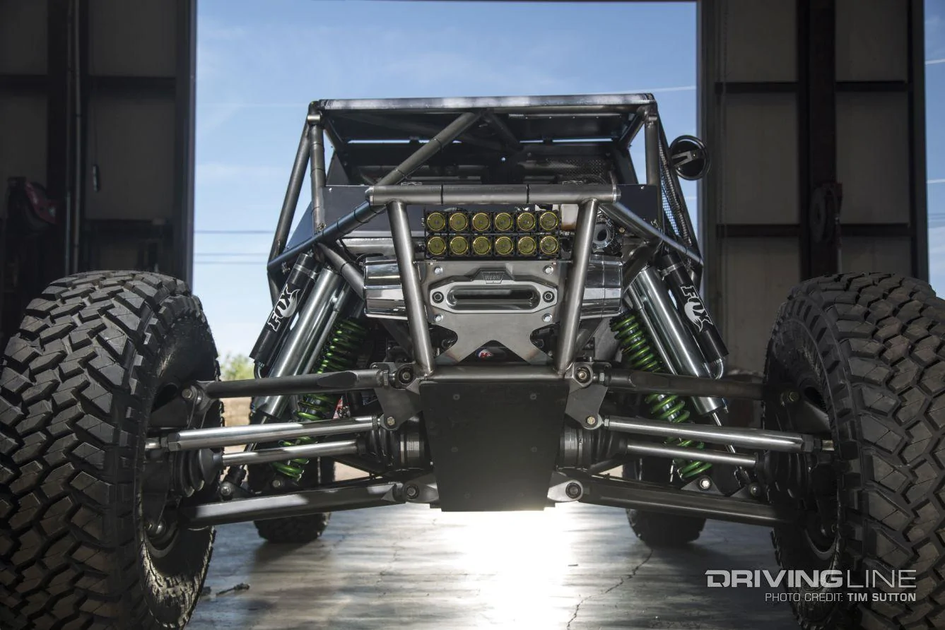

While I agree with your question, keep in mind that for the masses and new-to-off-roading members, they won’t know the difference between lifting a vehicle for looks vs. performance which I too had to learn the hard way by taking my then IFS lifted truck on the Rubicon and shattering both CV’s (driver and passenger) after being dropped out and bound up.
This is essentially a coil spacer/A-arm kit utilizing the majority of the factory components without any attention given to long term durability or performance which is why I’m not a fan of any IFS lift kit since millions are spent in R&D by the OEM to achieve optimum working angles throughout the entire range of suspension cycling. However, as you probably know this is also the difference between a $1300 bolt on kit and a $50k full-on custom long arm IFS suspension (below).
In time I would expect that there will be other companies coming to market with a decent compromise that will address the real complexities of IFS and balancing that with durability and performance similar to what the Raptor guys have available to them currently, but the Bronco is a new platform so it won’t happen over night.
