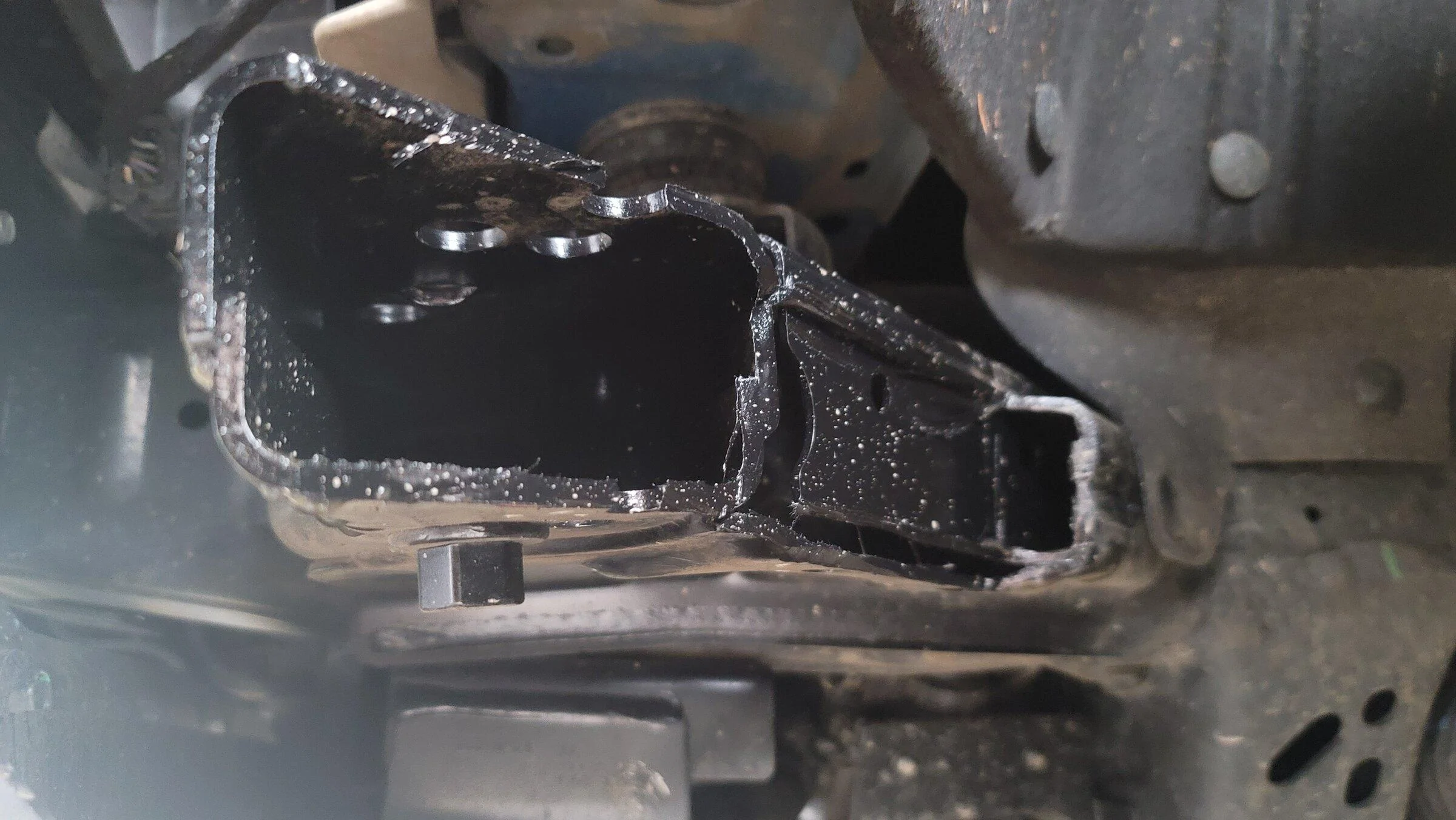

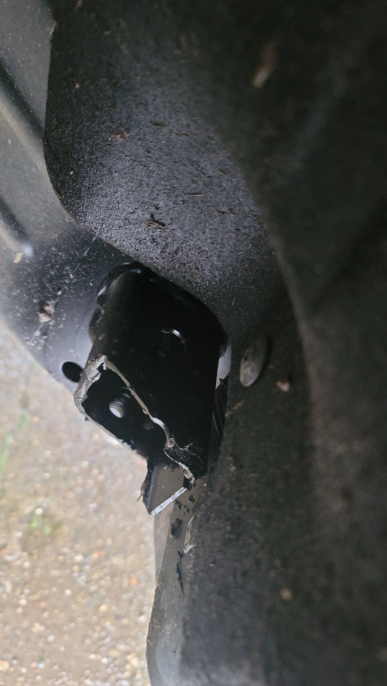

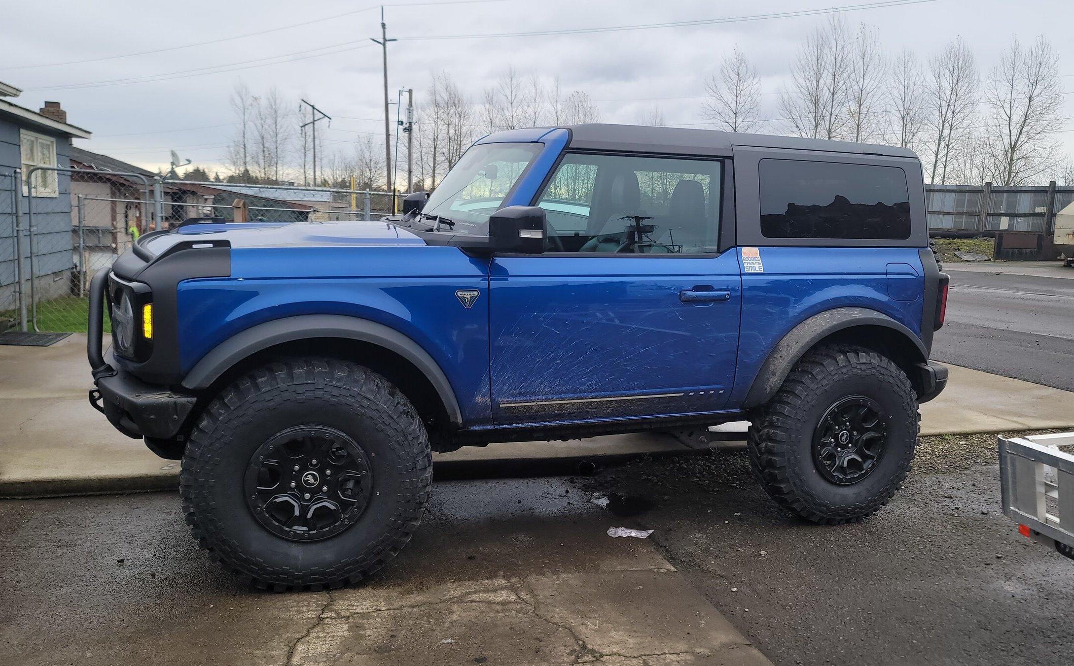

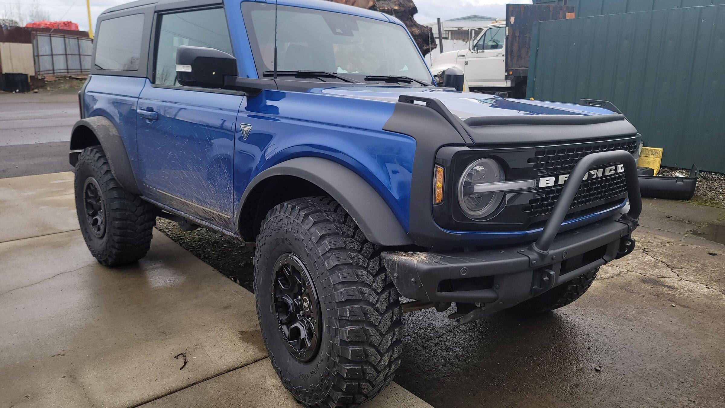

Picked up a set of 37x12.50R17 Maxis Trepador Radials. Sasquatch wheels.
These fit very well. No rubbing around town at stock Sasquatch height. Under full compression with swaybar disconnected, there is NO rubbing in the rear, however the front needed a bit of trimming in a few areas. An hour with angle grinder and some fresh paint and it's trimmed up enough for zero rubbing on the front with 1” leveling kit.

Looks better than I thought it would. Very clean. (y)

Wow. Well done. That's a lot of wheel to be able to put on a stock rim with just a 1" leveling kit... with only minor trimming. I think we'll see a lot of Bronco owners following your lead. 😎👍

Wow! 37s with No rubbing (minor trimming, +1" up front) with the Sasquatch +30 offset wheels.
Would it not rub at all with a popular +18 or 0 offset wheel?

Hey, that's the #1 question I get. "If 37" would fit on their non sasquatch edition".... I have a Wildtrak with 37" K02s.
Thanks for sharing....👍👍

I would really
like to know the answer to that!

Looks great from the outside! But what did you use to trim? Chainsaw?

Is the Trail Armor dealer installed?
