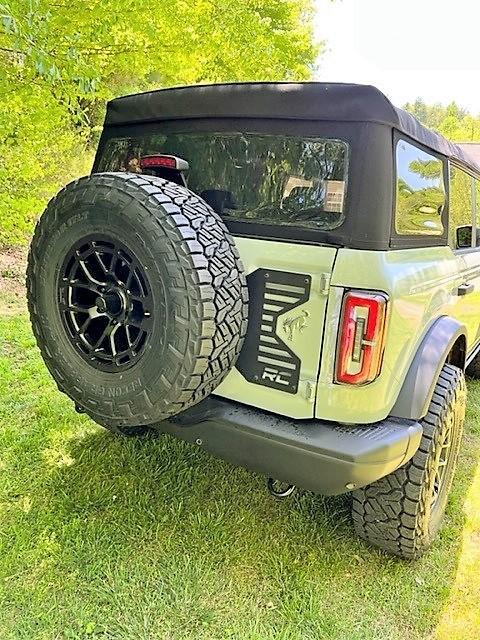

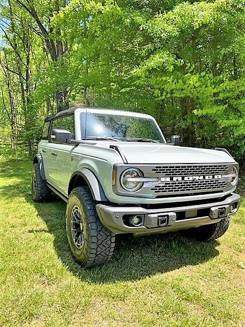

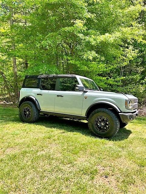

If anyone was wondering what a NON-SAS Badlands looks like with RC 1 inch level, and true 35's.
Looks good, did you need the lift or was it to level?
You can run 35's on a stock badlands but the one-inch level is cheap. just pull the crash bars and your good to go.
Ford Bronco Badlands NON-SASQUATCH on 35's and 1" level lift b2
Ford Bronco Badlands NON-SASQUATCH on 35's and 1" level lift b3
Ford Bronco Badlands NON-SASQUATCH on 35's and 1" level lift b4

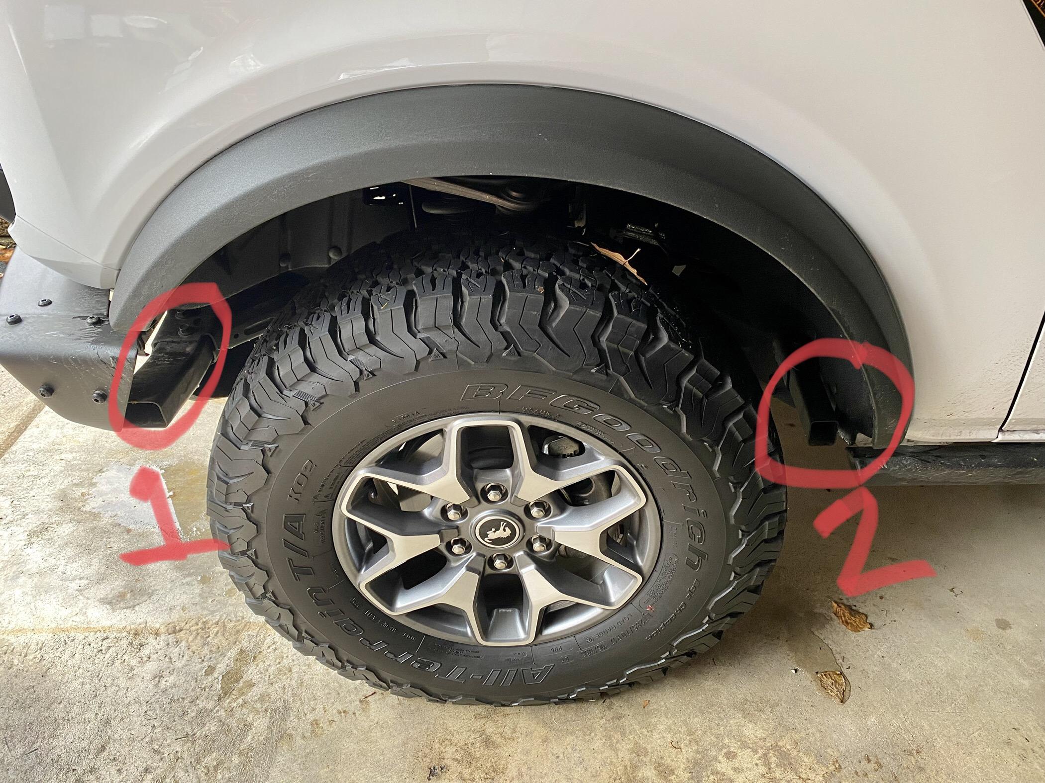

In my mind, that’s really the best option for me. I was already pronounced dead at the scene of an accident and then revived and life-flighted after a car crash. Completely removing “crash-bars” makes me a bit queasy 🤕
At the risk of asking a dumb question. What are crash bars and why are most people on B6G so cavalier about removing them? My gut instinct would not be to saw off something safety related so I can squeeze in another half inch of tire.
Mattwings
Matthew
Jul 29, 2020
47
2,719
8,477
Northville, MI
2021 Badlands Bronco
They are what I would call "intrusion bars". they are fore and aft of the tires and they are designed to absorb energy, particularly in an off-set collision. Ford actually removes the front bars on the Sasquatch package, which probably doesn't create a failure in crash testing (might lower the front off set score?), but can't help but lower the level of safety to some extent. I think that's part of the reason people feel OK about removing them.

Put it this way. If you order a bronco with the SAS package, they come from the factory without the front crash bars..
You can see them here, and they’re intended to help prevent cab intrusion
