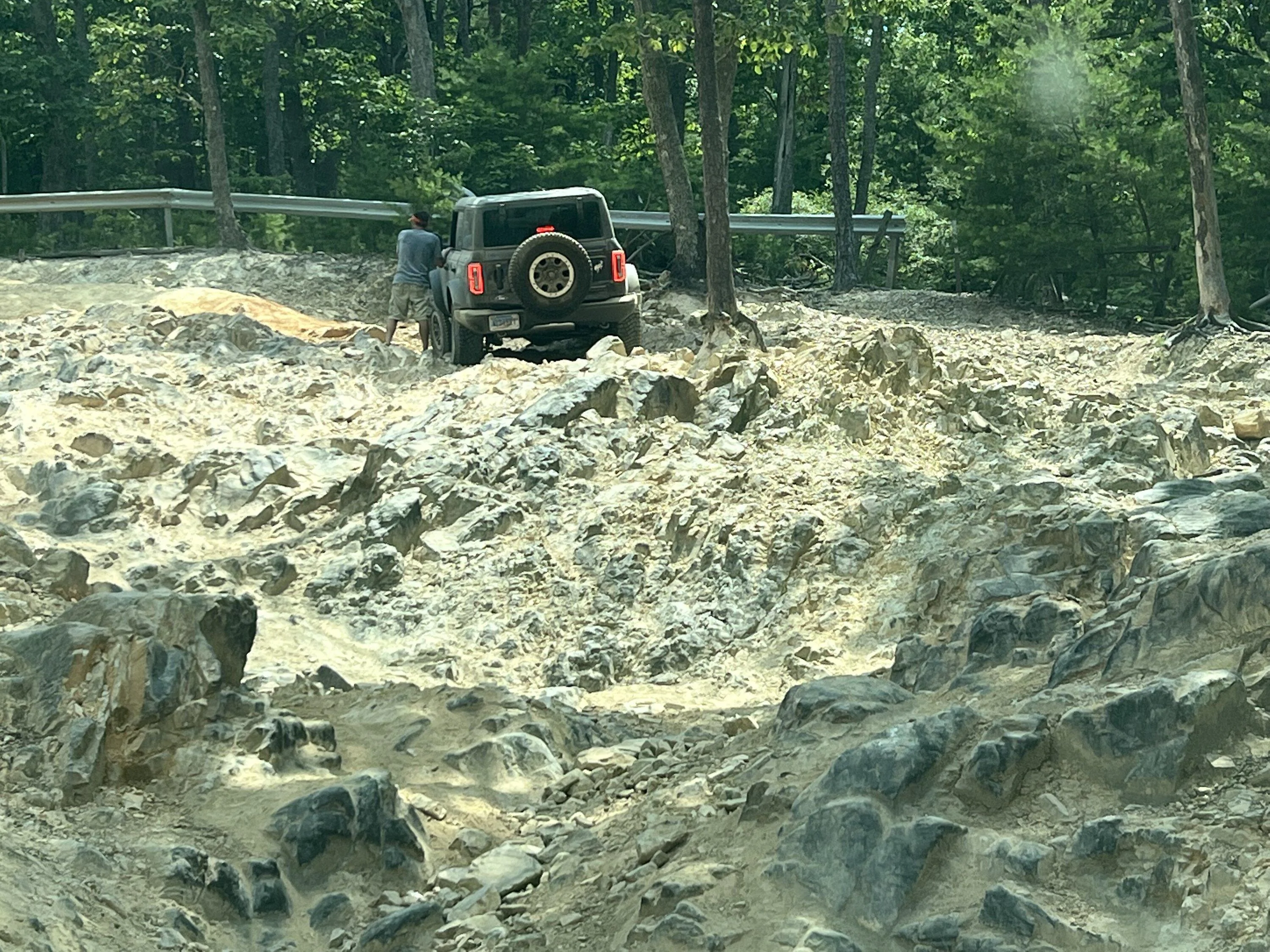

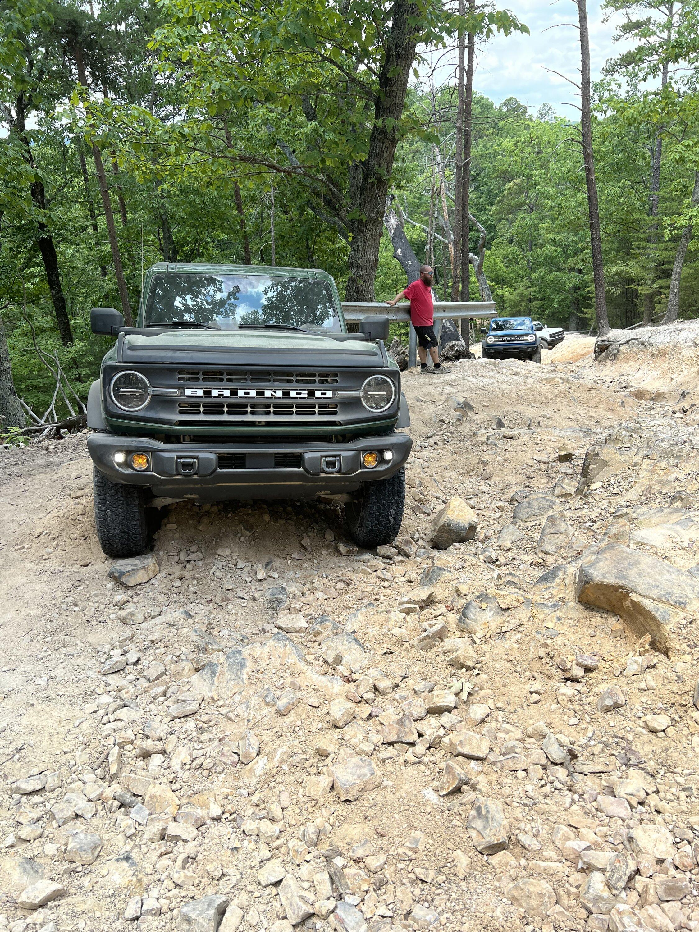

Hey guys…. We had a great group of Broncos this morning out at Uwharrie in central North Carolina….
I was the only guy rolling on 33s in a stock Black Diamond.

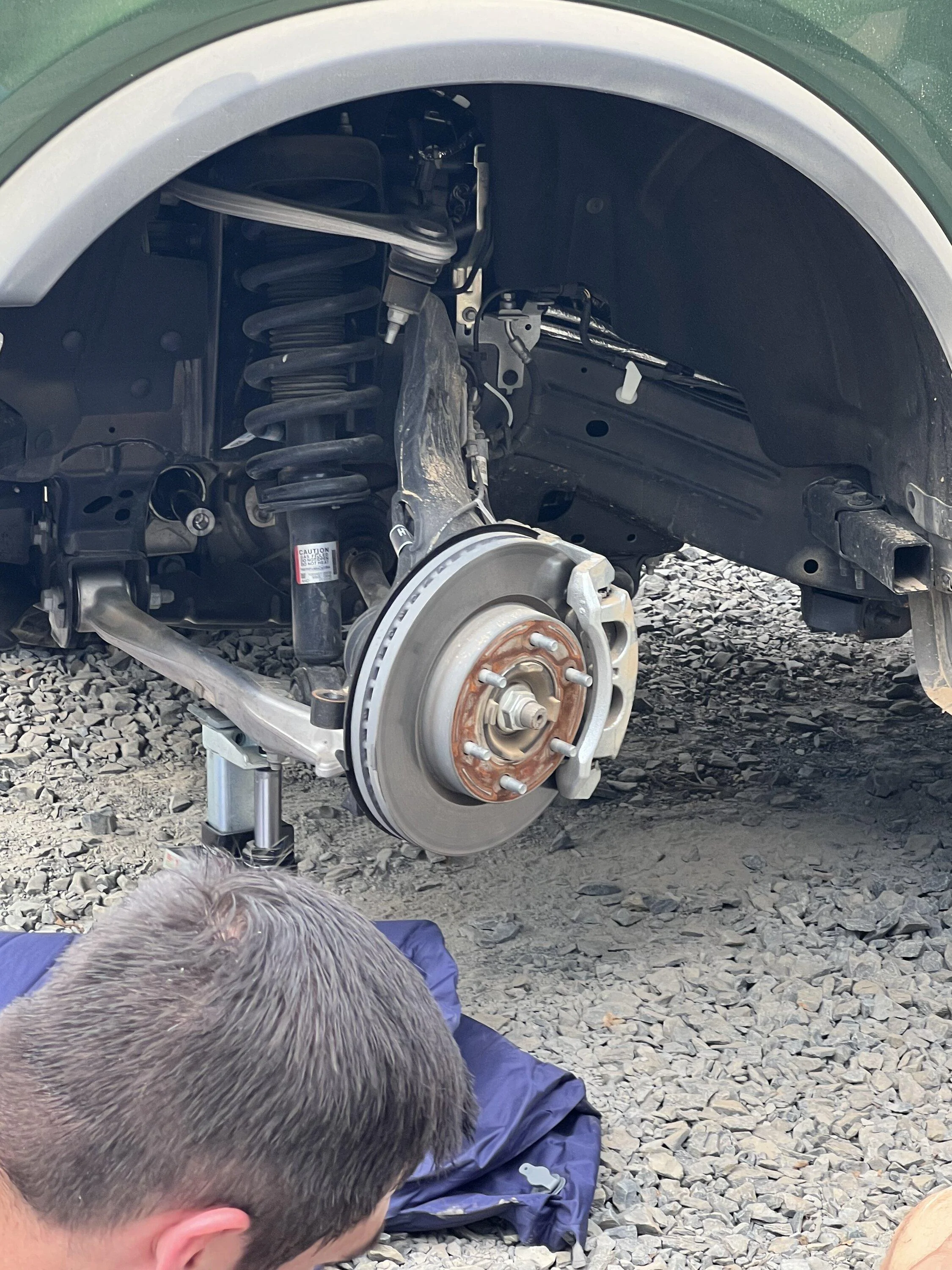

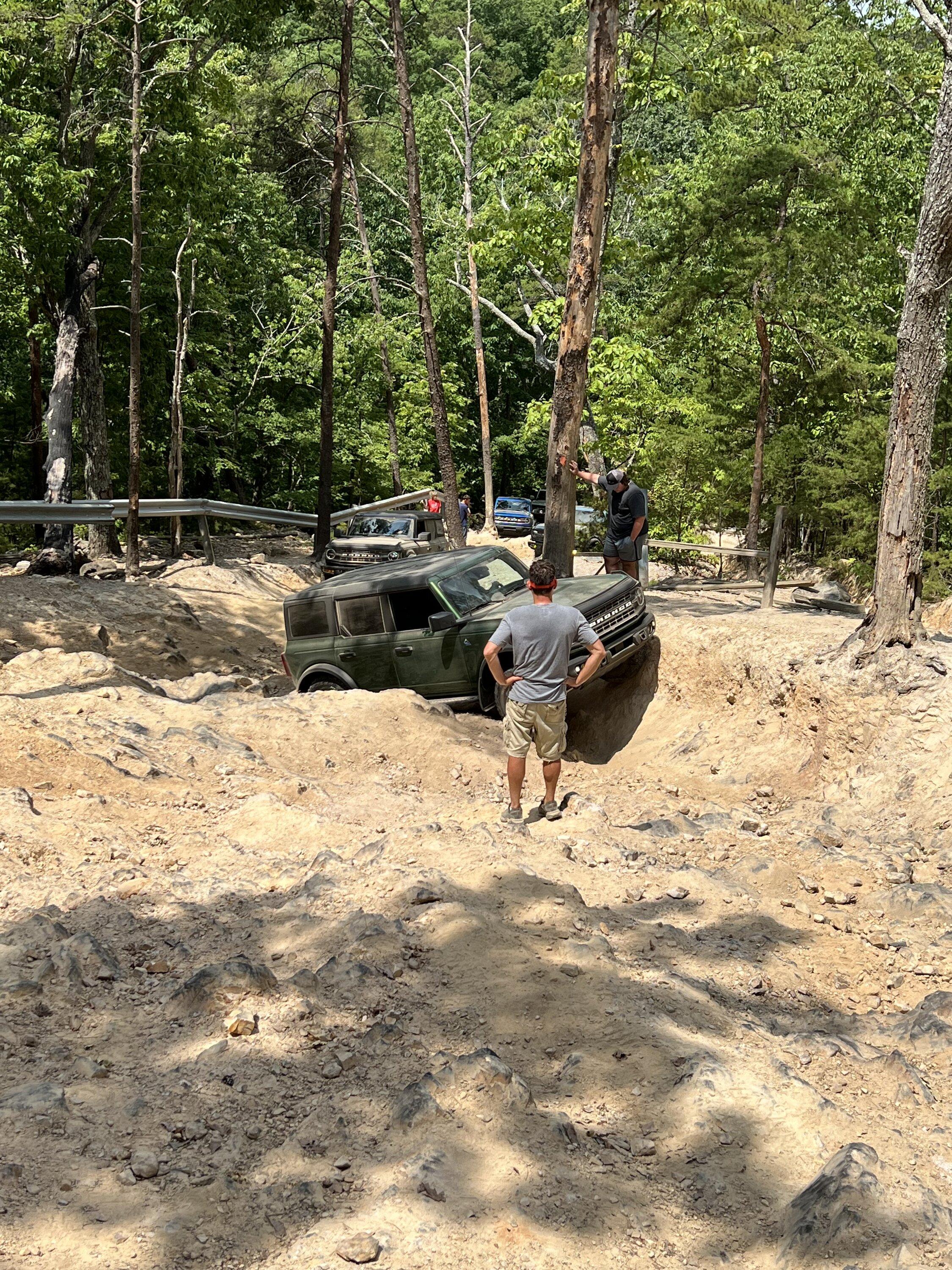

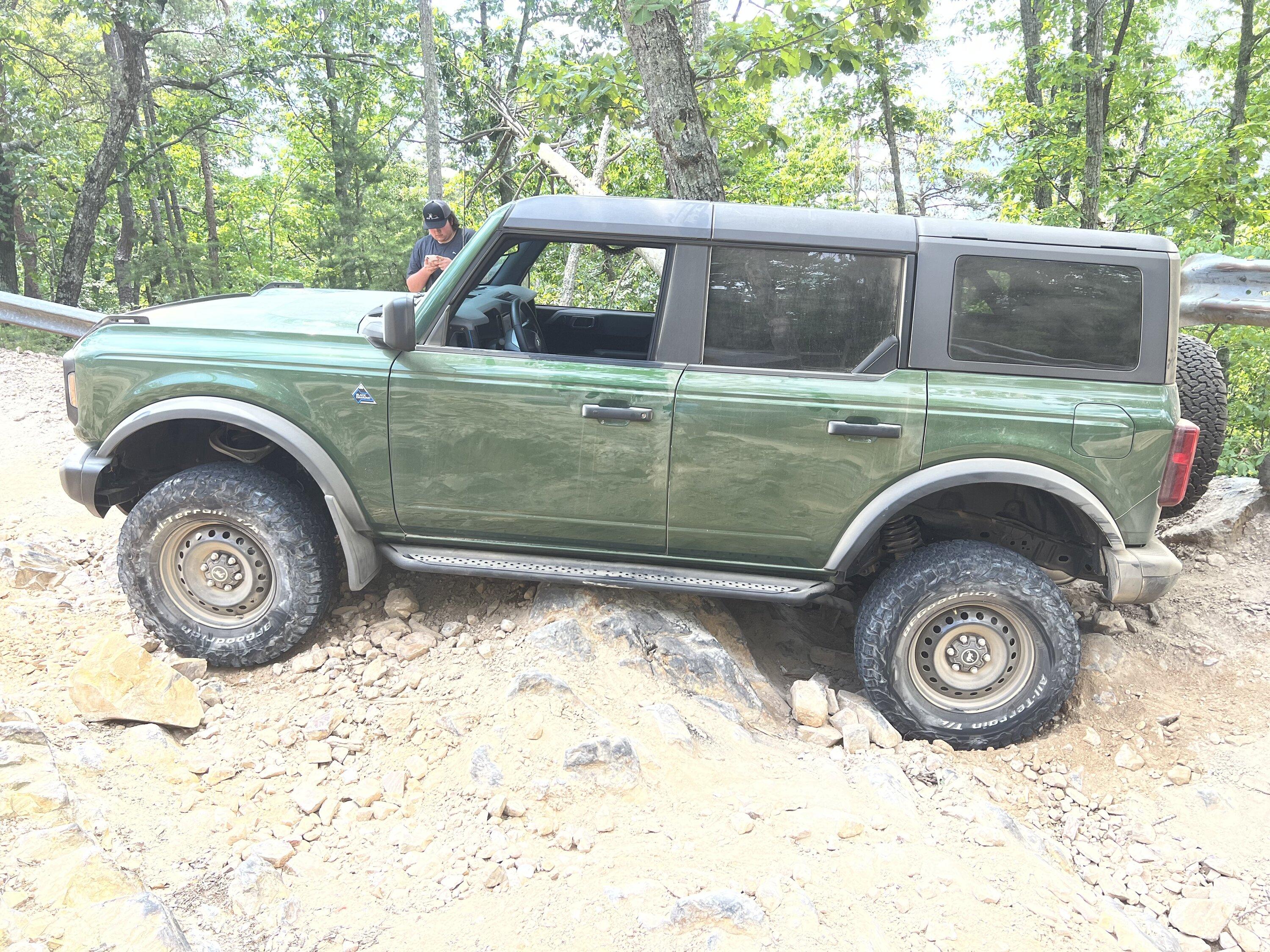

Got myself stuck on a rock, and one of the guys used a kinetic rope to pull me off…but when my left front tire caught traction…the tie rod snapped like a chicken bone.
Thanks to @Mountains2Metal for having the @BroncoBuster tie rod braces to get me off the trail…

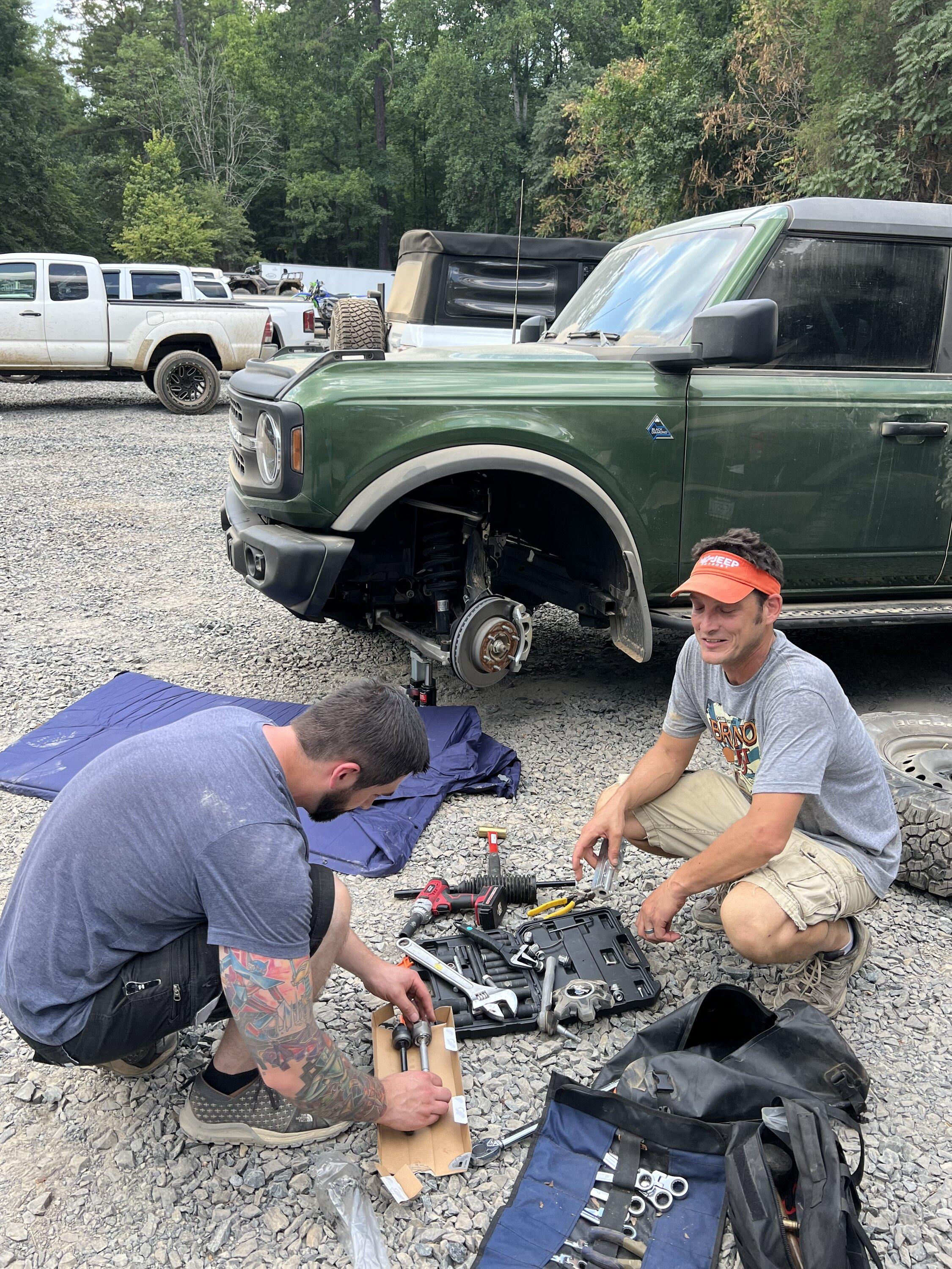

And then thanks for @Tricky Dick and @Copperhorse73 for installing a 2004 Ranger tie rod to get me home.
Great lesson on never wheeling alone.

It broke for a different reason than the ones I've seen up til now. The rest have all been big tired and beat on. Wes was yanked off a rock and the tire came down and at an angle. I thought the tire was going to debead at first.
This is something to keep in mind and carry a spare, but nothing to be paranoid over.

I don't remember the original bronco part number off hand, and there's no aftermarket one out yet, but you could order one through a dealer. We got Wes home with an EV317, meant for old gen Rangers. Perfect fit.

You want the inner tie rod, the outers are holding up. They run $70-100 each from what I've seen from various dealers.
