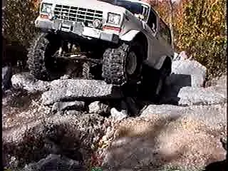

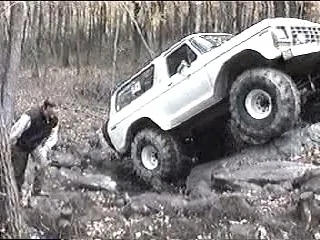

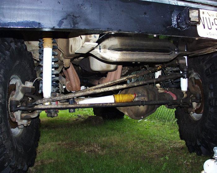

Completely user error, I shouldn’t have spun up that much, but I was trying to throw a little mud as well.
I just don't get this mentality. 45 years later and we can't equal a stock set of 78/79 tie rod ends? (which I modified to run on a kingpin 60 front with 44 boggers and healthy 460). Also made an adjustable drag link out of another stock tie rod.
That thing spun up locked 44 boggers no problem and I even rock crawled it as it was the only thing I had after 9/11 and I really wanted to go (charity run @ Paragon).
http://luxjo.supermotors.net/OLD BRONC VID PICS/PATCH JULY 06/MOV01240.MPG
