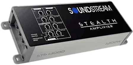

I have not used Stinger but have a soundstream in another car that ROCKS!
