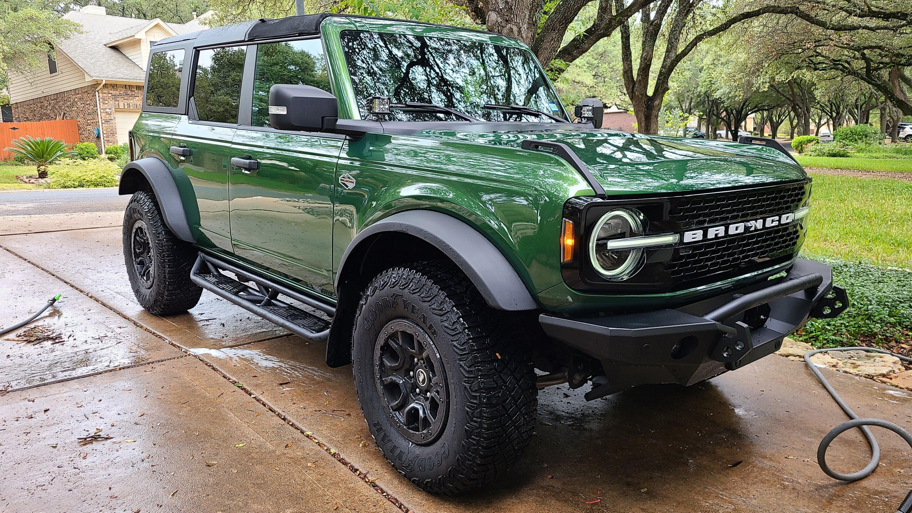

Completed my exterior transformation this weekend - love how my Wildtrak functions and looks now.

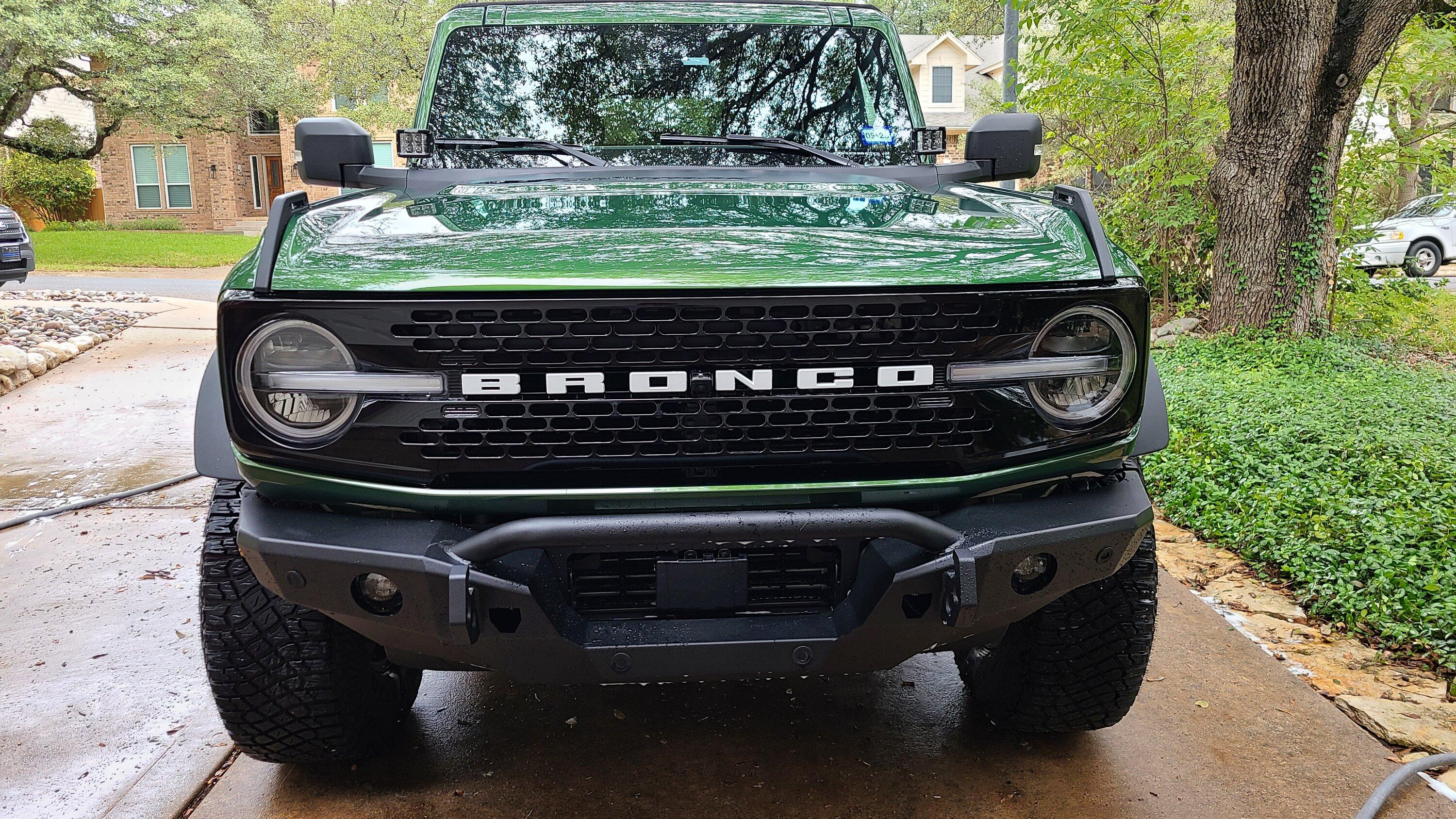

Havoc bender front bumper
  • Didn't need a winch, wanted something I could beat up and stand on, and still retain full functionality of luxe sensors, adaptive cruise, front camera without relocation
  • Both bumpers arrived FAST. Ordered on a Wednesday, arrived on Friday. Really impressed with that

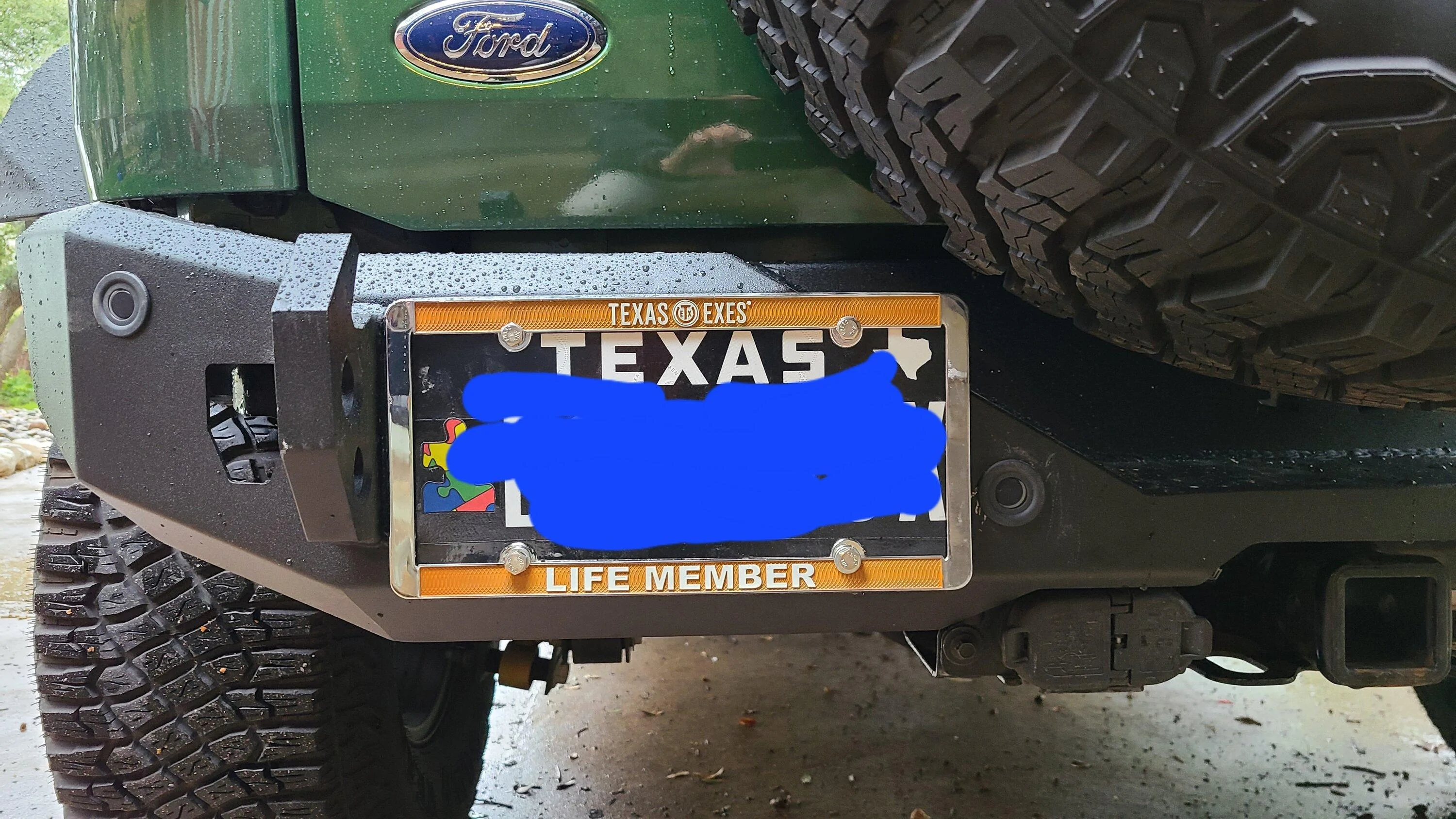

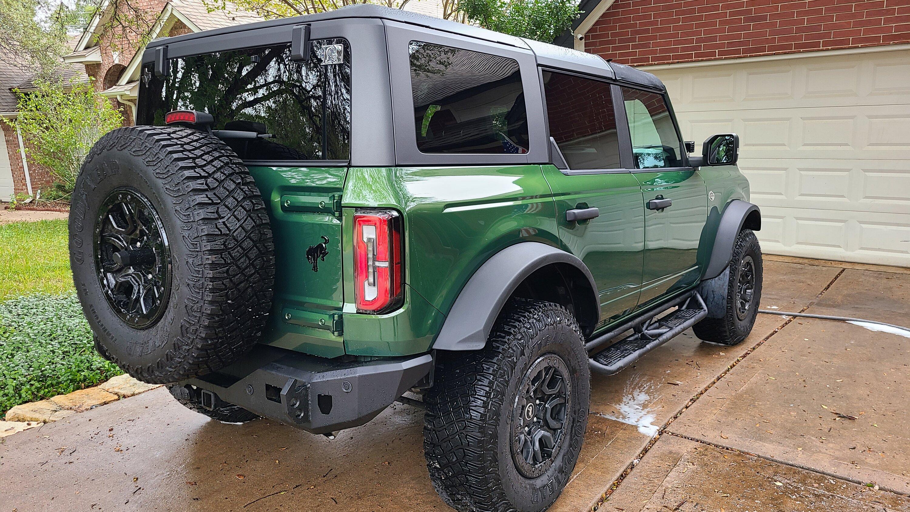

Havoc bender rear bumper
  • Modified to mount rear license plate for street driving. Tapped holes for plate mount, relocated inner driver's side parking sensor
  • Need to figure how to re-mount the license plate light now. Shouldn't be a big deal
Rigid pod lights
  • Connection to interior switch #1 was straightforward
  • Lucky to have already had a 3-leg puller to remove the wiper blade arms. You have to pull those to remove the plastic cowl and run the passenger side wires
  • Deleted antenna, ran a strap wire from the antenna connector to the pod light bracket to utilize the bracket as an antenna for FM reception. Works great

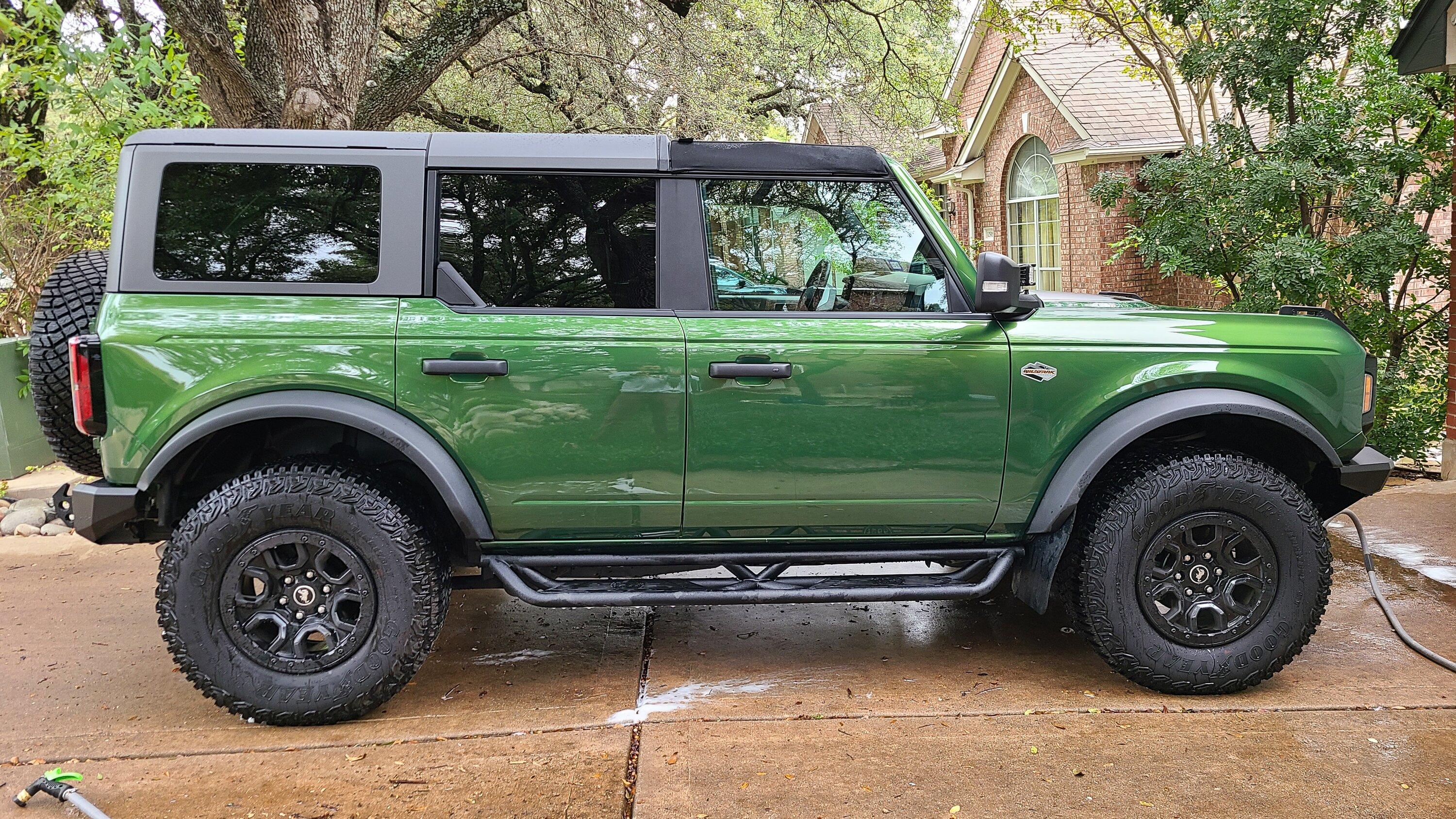

Hooke road step rails
  • Hides pinch weld, adds some lower protection, still gives my 3-legged lab something to step on when getting in
  • Installation was very simple and straightforward
  • Researched several options. Hooke Road steps had the most heavy duty looking mounting brackets, all welded construction, nothing screwed together. Feel very solid. Fast delivery turnaround.

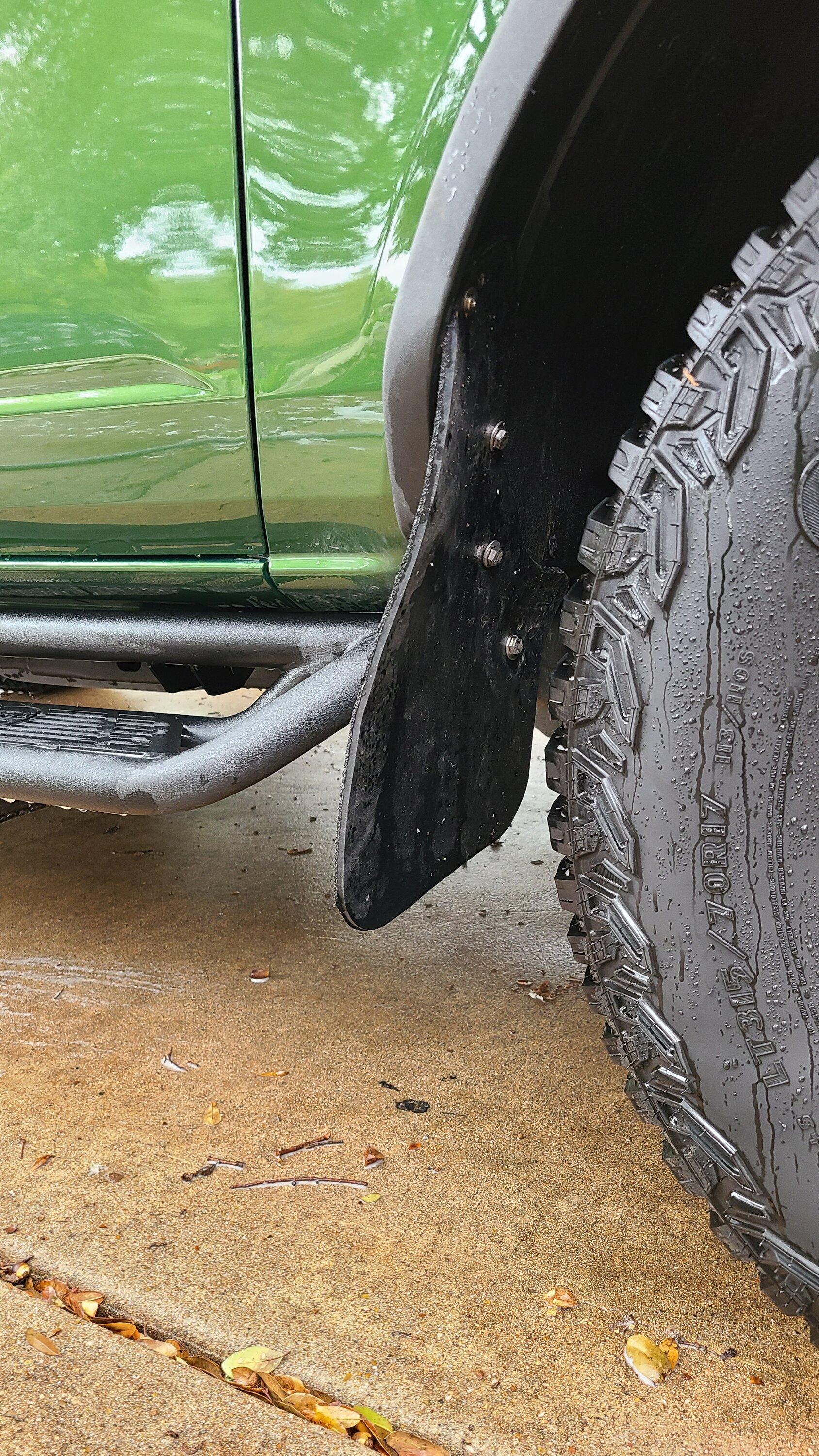

Custom mud flaps
  • Didn't like the plastic ones, wanted heavy composite/rubber ones like I see on big trucks
  • Ordered basic 12x18 composite flaps from Amazon, cut with a jigsaw, drilled holes for mounting bolts, used automotive U-clips to mount. Love how these turned out

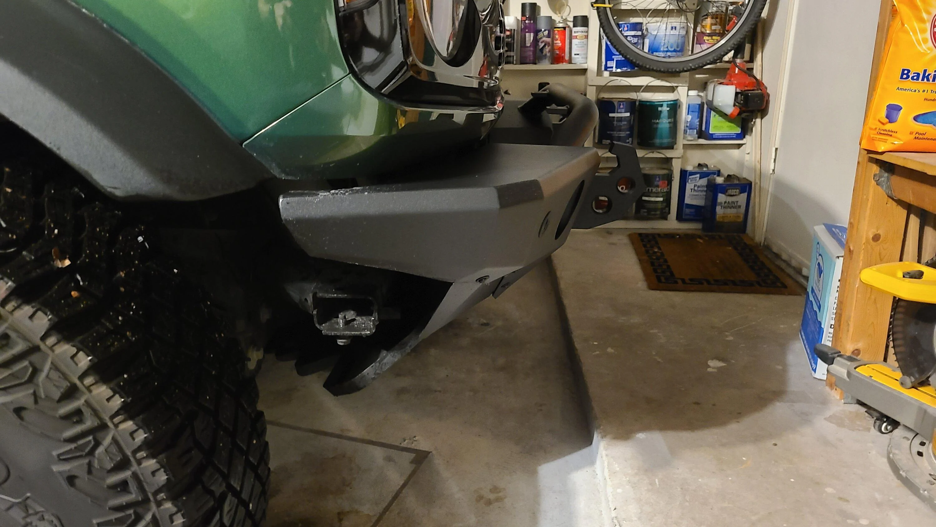

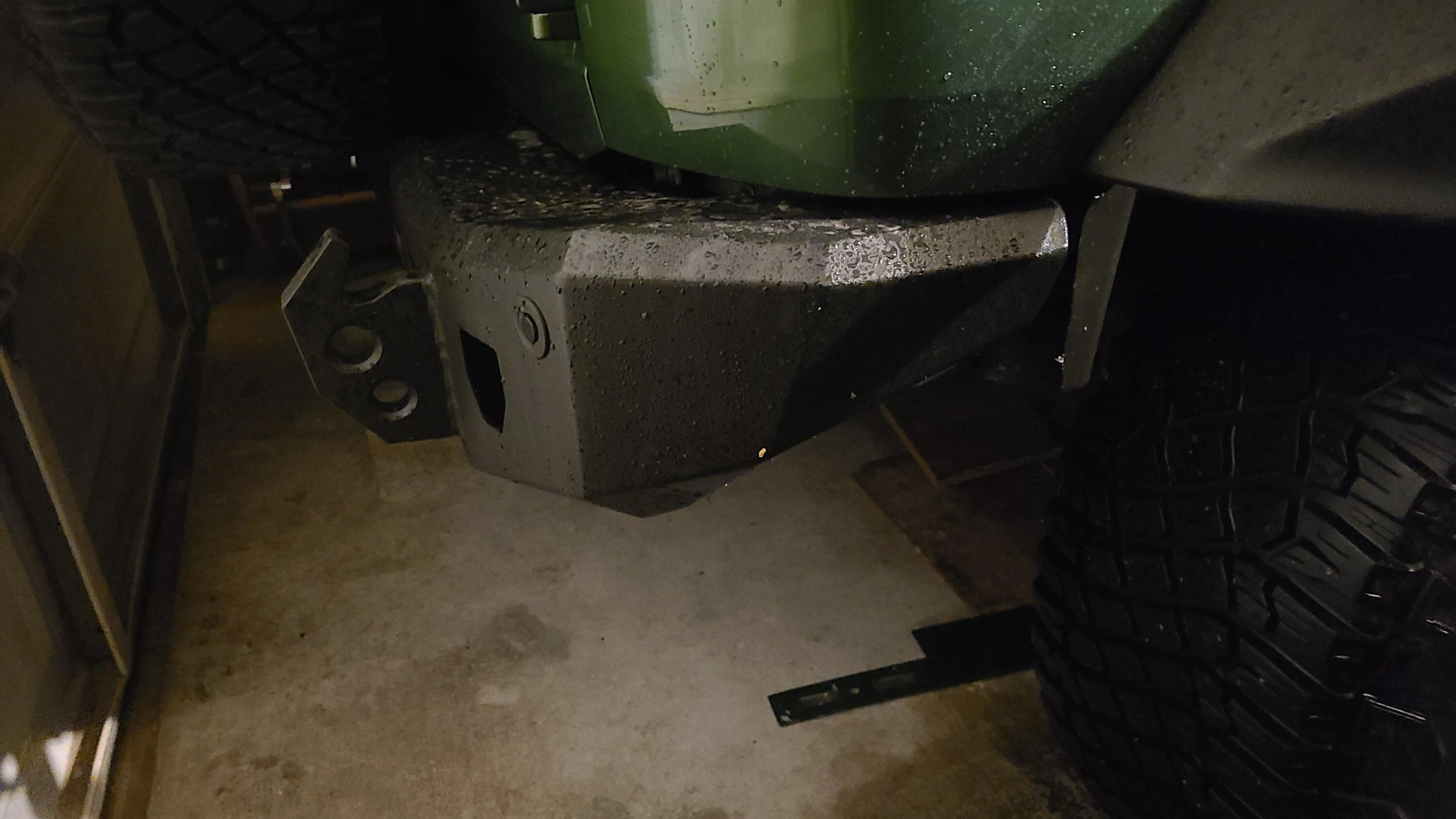

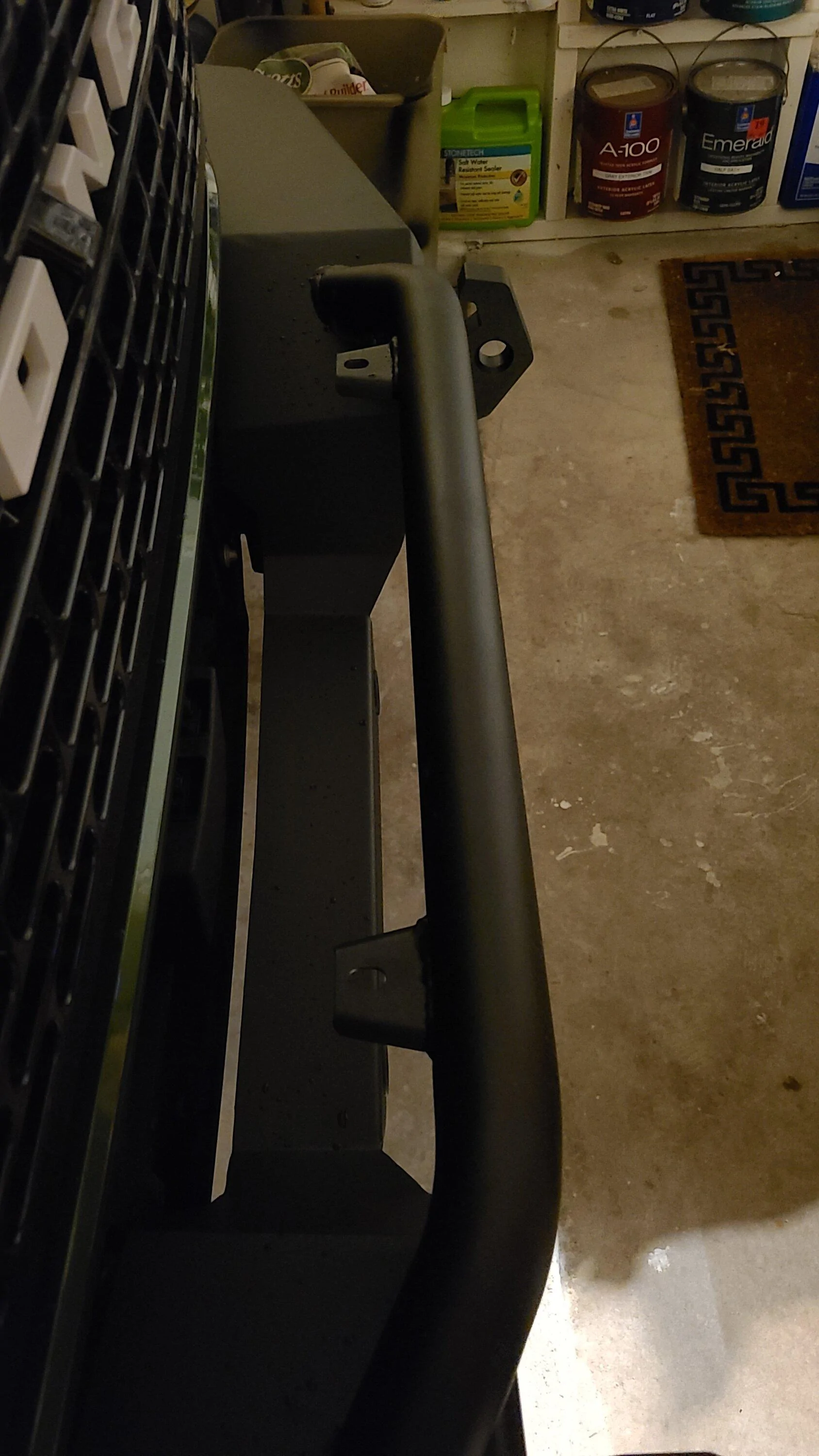

@smast looks great! I am close to pulling the trigger on the same bumper, but was curious if there is any provision for mounting pod lights on the bumper? How do you feel about quality and mounting? Sensors work as they should? Thanks!
There are definitely mounting points on the bar for either pod lights or a 10" light bar. I can't recall whether there are any other locations for pod lights.
Quality feels really solid. Everything is welded, nothing held together with screws except for the plates on the bottom that cover some of the exposed areas after mounting. I found installation pretty easy - did it by myself in about 2 hours. Relocation of the parking/collision sensors was also pretty straightforward, and the adaptive cruise and camera need no relocation with this one. Was pretty easy also to transfer my OEM fog lights over to this bumper. All mounting hardware was included, and included instructions were easy to follow.
I mostly wanted something I could stand on, use to push open a bump gate, and generally provide full armor around the front and back of my Bronco. This one had a great price point, arrived quickly, and made a huge difference in the look of the Bronco. Highly recommend.

Couple more question, who did you buy from and any side profile shots of front bumper?
Bought directly from Havoc. Free shipping and they are running 10% off. Side shots and pic of light mounts attached. Bar has holes plugged with rubber stoppers for running wires through

Curious what you did with you mud flaps? You mentioned you wanted "composite/rubber" ones.
But you ordered the plastic ones from Amazon and then what did you do?
Added rubber to the plastic flaps?

Pics of rear bumper license plate mounting?
Drilled and tapped for the four mounting bolts directly into the bumper. If you do that make sure you put some rust inhibitor paint or something in the areas where you expose the steel. You'll notice I also had to drill a hole to move the sensor that would have been covered up by the plate. Still need to solve for how to relocate the license plate light.
