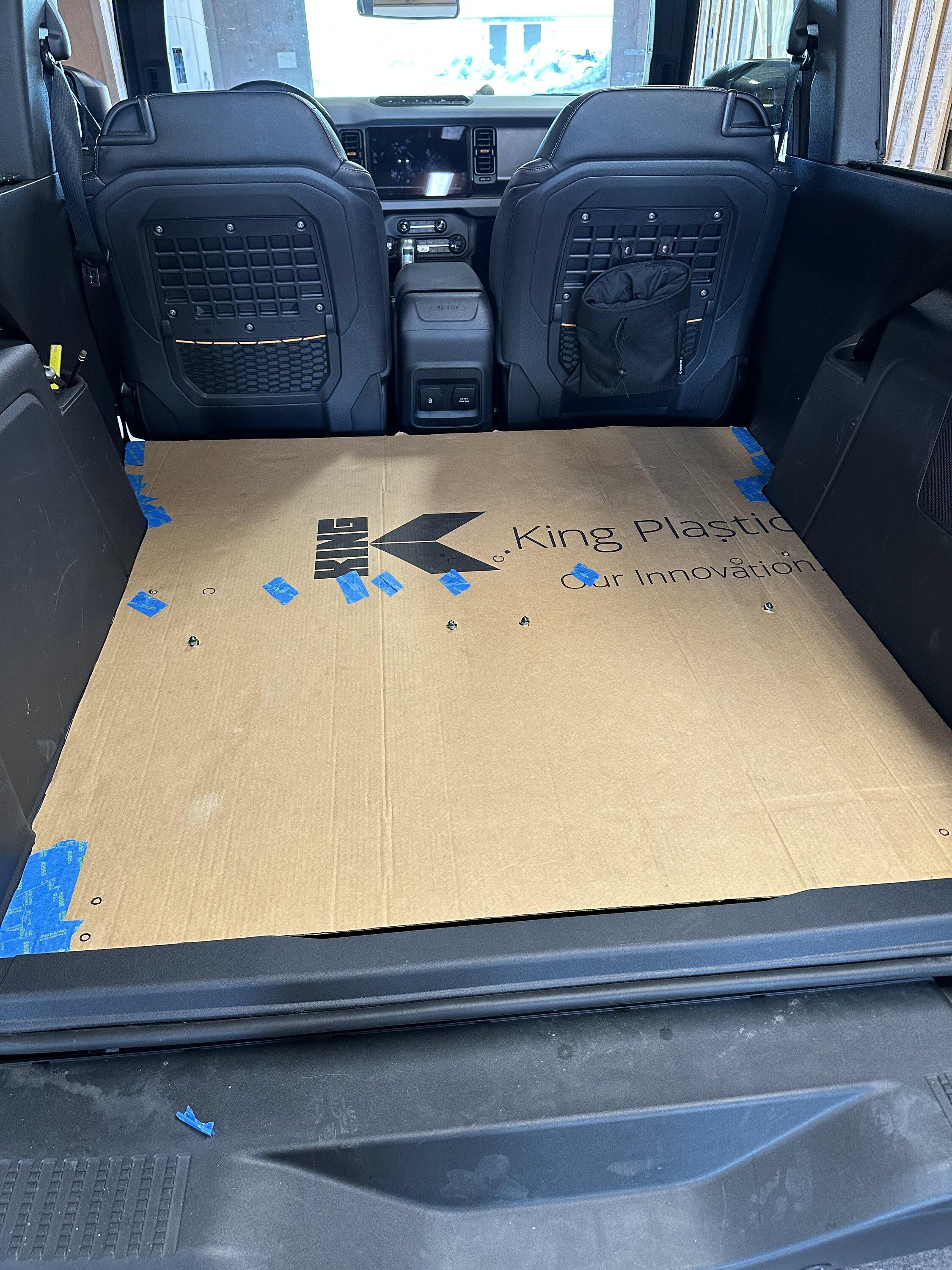

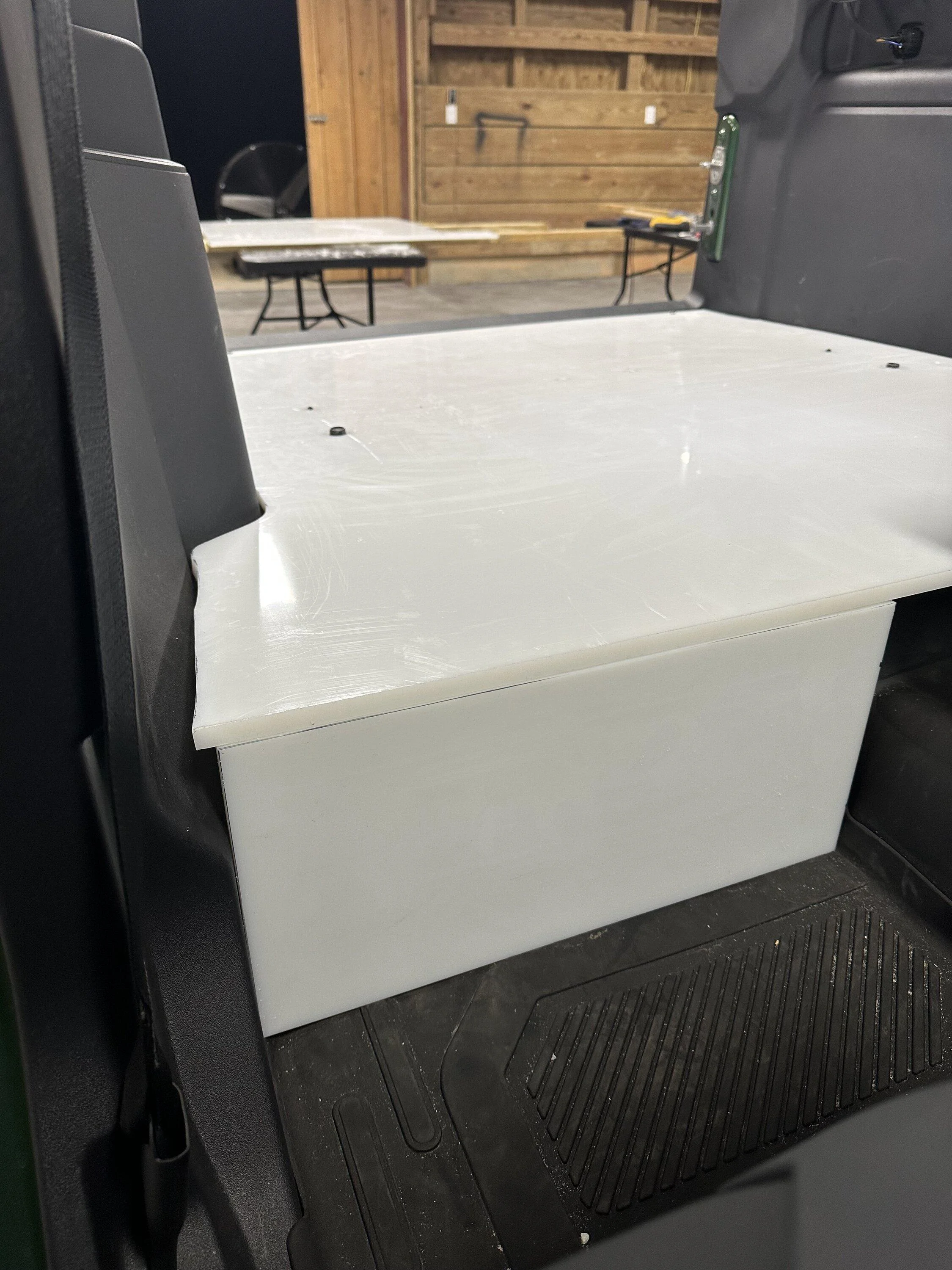

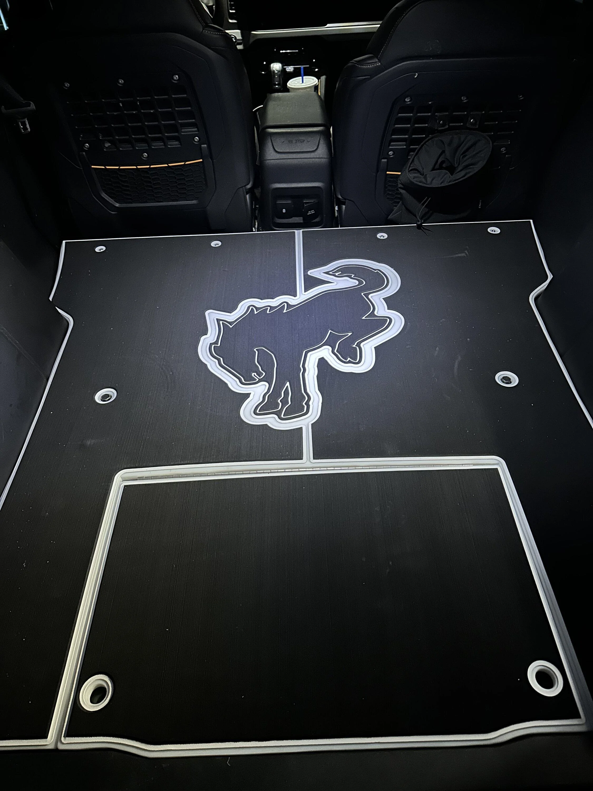

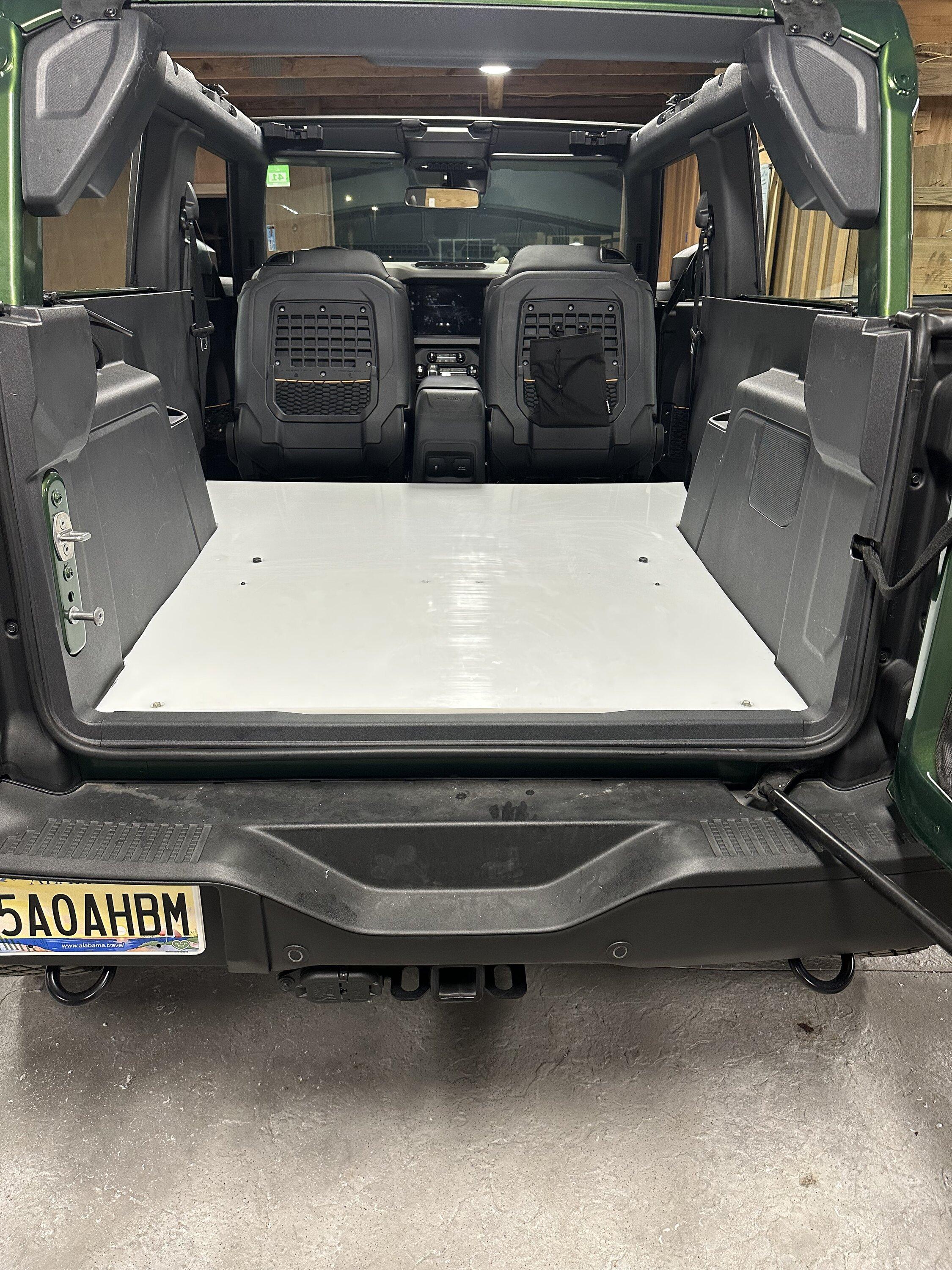

Thanks to #broox and his thread. https://www.bronco6g.com/forum/thre...ined-cargo-platform.78538/page-3#post-2069570 for dimensions and guidance. I wouldn‘t have been able to do any of it without his help and many other people that have done the same. I took the time to make my version of what he did. I was playing with the idea of trying a material that wasn’t what Goose Gear uses or some type of plywood for moisture protection. I found HDPE Plastic sheets that come in 4 x 8 sheets in many different thicknesses. I used 1/2 inch but others have used 3/4 inch. Working with this plastic was just like working with wood. Very easy to control cuts and drill. Now the top is made of Sea Dek, another reason I went with plastic. I have a dog and this space will be mostly for her and my gear that I go with. It’s a closed foam and slip resistant for the dog. It’s an awesome product and is mostly used for boats but thought why not!

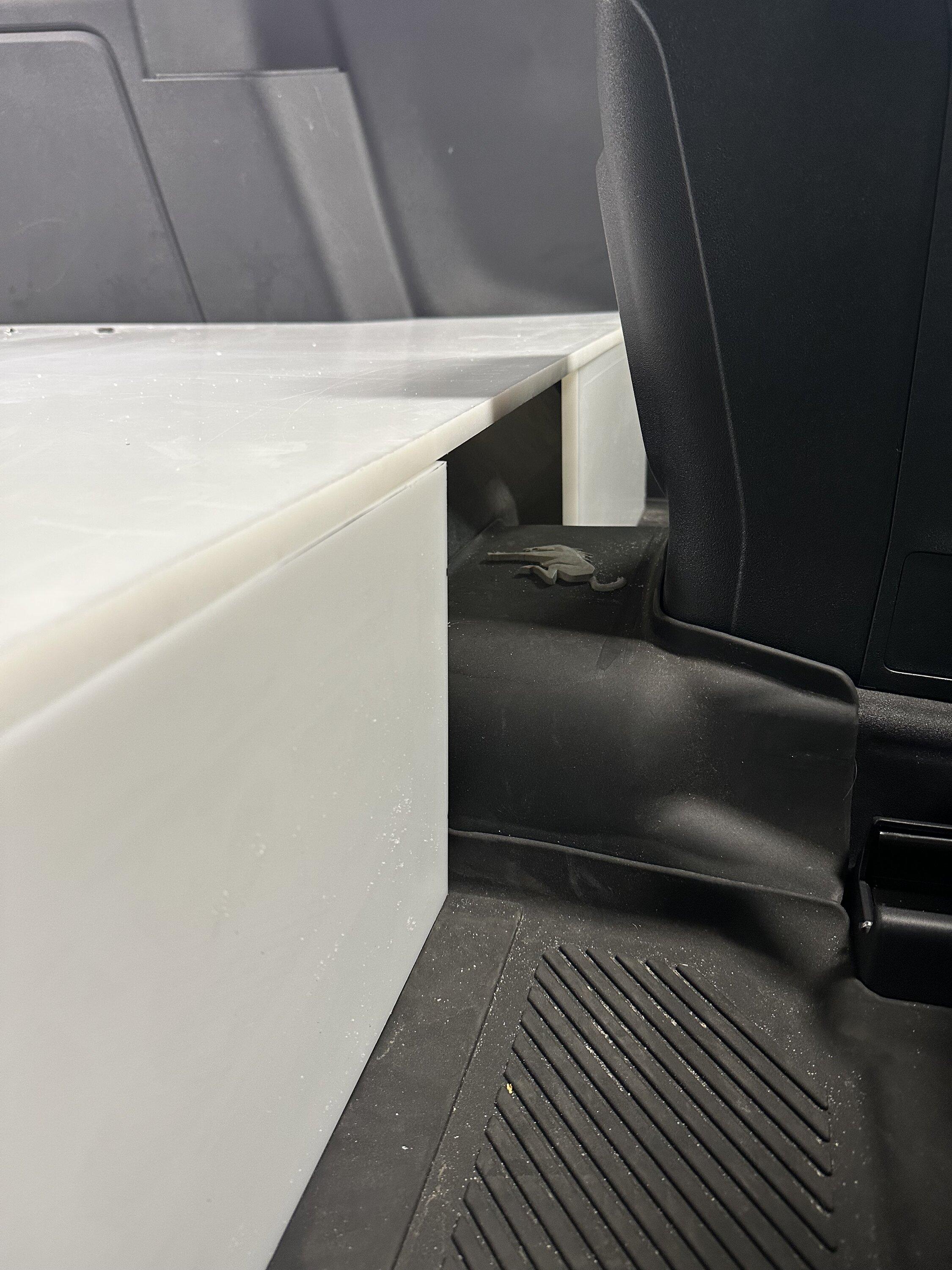

@Prest33 It appears that your front supports are vertical. @broox mentioned that if the floor panel was not long enough then they would be at an angle. What are the dimensions of the HDPE sheet on the floor?

The HDPE sheet is 4’ by 8’ but the actual measurement of the board was about a half an inch longer on both length and width. The vertical supports are a tight fit and I can see if I made it out of a thicker board it wouldn’t be possible but maybe working with a thinner material made it perfect to line up vertically. I‘ll get back to you on dimensions I know that are 18’’ long but cant remember the height. Ill let you know though.

It’s just like working with wood! No I have never played around with this type of material before but it was very simple! I was going to go with black but didn‘t have the patience to wait for it haha. I think the threaded inserts would work just fine! I haven’t used threaded inserts and didn’t with this project. I’ll take a picture but I used a piece of wood to secure the two vertical braces instead of inserts. I felt more comfortable having the wood behind the vertical braces to secure everything.

That turned out awesome! Where did you get the sea deck cut into the bronco logo? Any details on how you built, or did you pretty much follow the build you posted the link of? How is the sea deck in terms of holding dog fur? I'd be concerned it would be a pain to clean, but maybe it's not that bad.

I just followed basically what the I posted in the link! The one thing I did do was grind off the studs that the seats were attached to that are on the floor half way off. So they dont stick up so high. I left enough on as guide into the deck floor. But basically just followed what broox had suggested.
The sea dek was done buy a sea dek certified installer. Once I cut all my pieces I gave it to him and he scanned the entire floor. I told him what colors how I wanted it and just asked for the bronco logo to be in the middle and he went to town on it. Super super simple! I got it done in Orange Beach, Alabama he was my local dealer. Castaway customs I believe is the company.

Well, it turned out great. Really nice job on it. I'd be hesitant to grind off the seat studs. I assume they will no longer work for holding the seats in place? Or is there enough left of them to still get the nut on there and hold the seat down? Looks like the cardboard that was on the plastic sheet was perfect for making the template. That's reason enough to consider using the plastic sheet!
