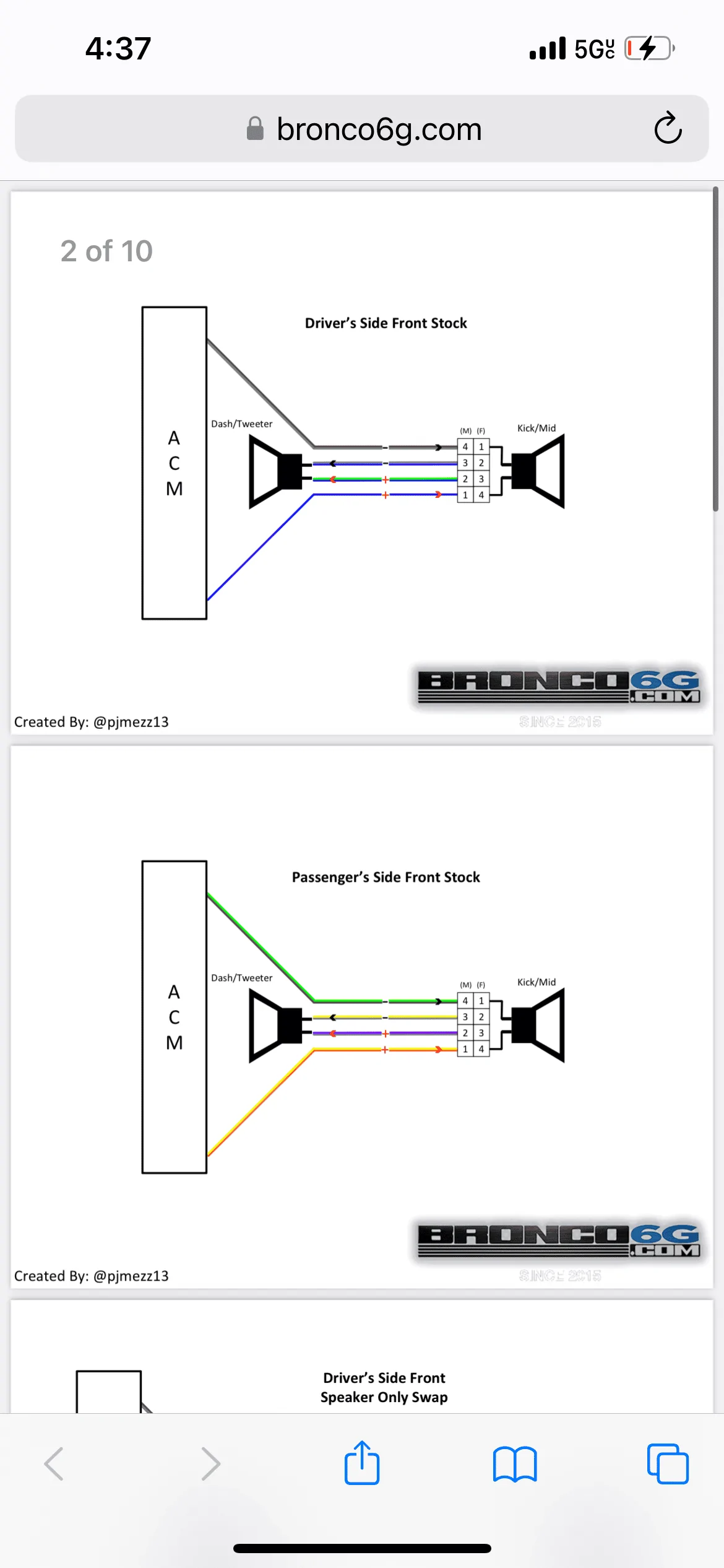

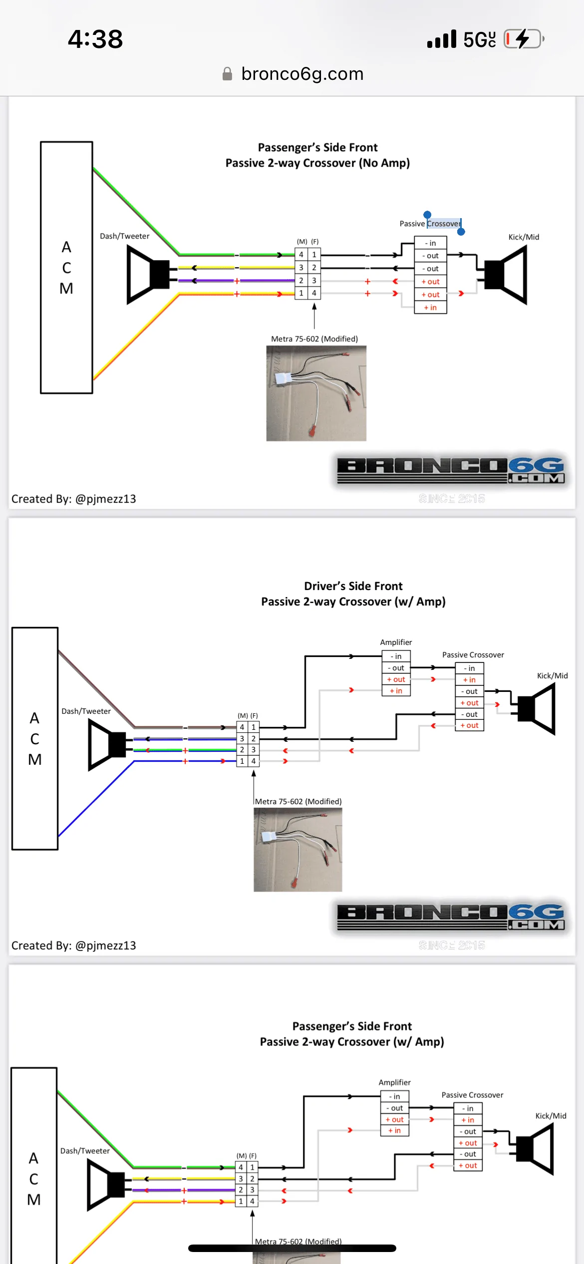

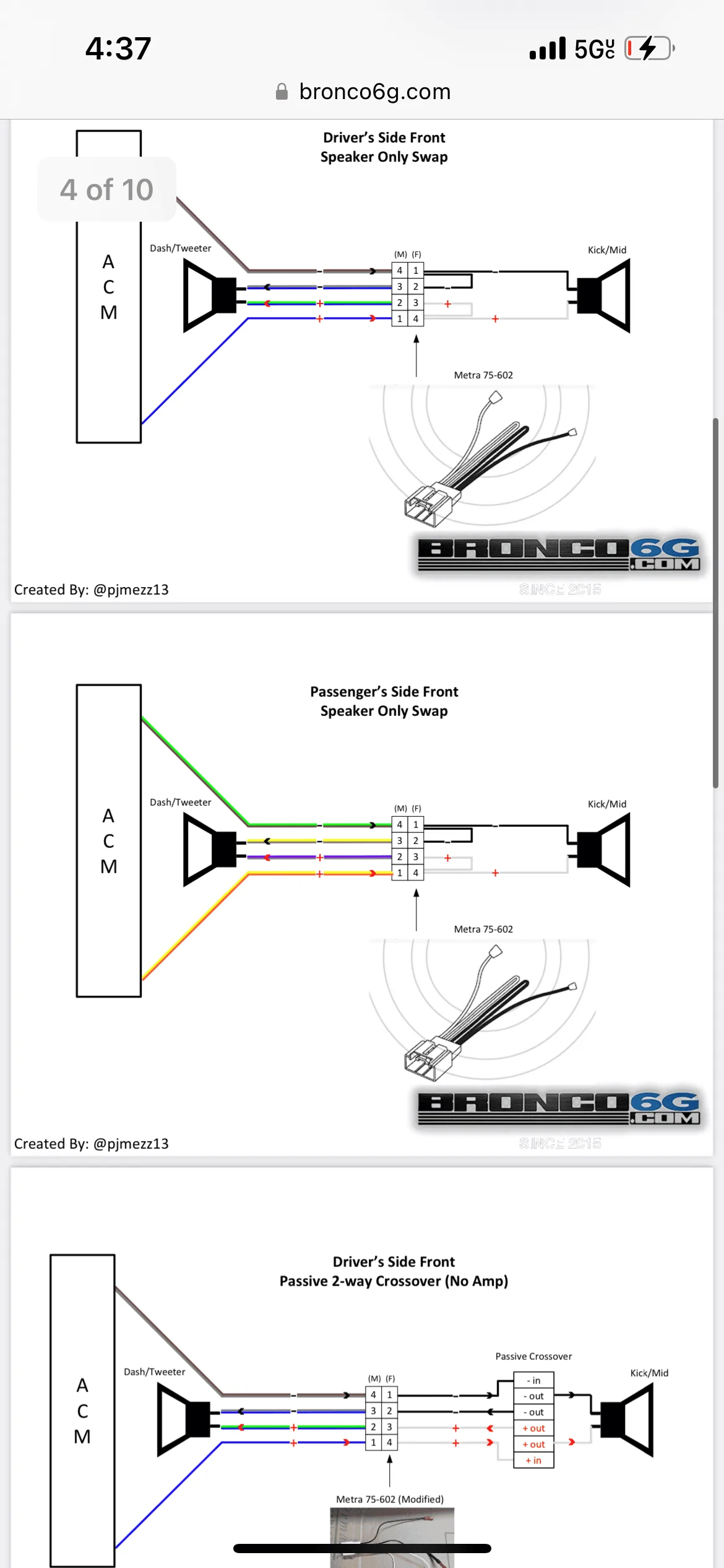

Replaced my dash kicker cs witn the ks version. And switched to a 600hz bass blocker instead of the 300hz i had.
To Anyone considering upgrading, do yourself a favor and go with the ks
Do it once
These wiring diagrams helped alot as well.

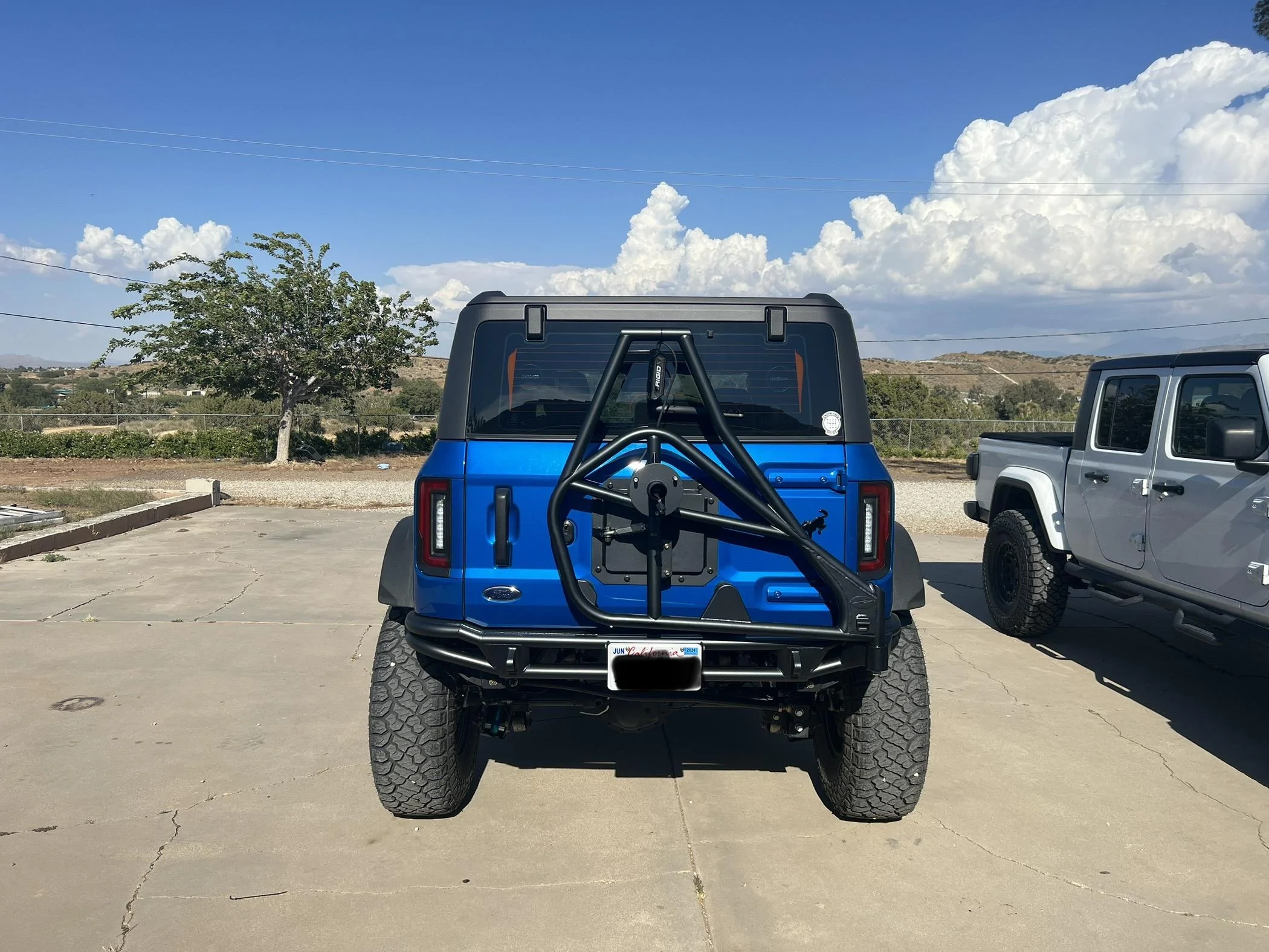

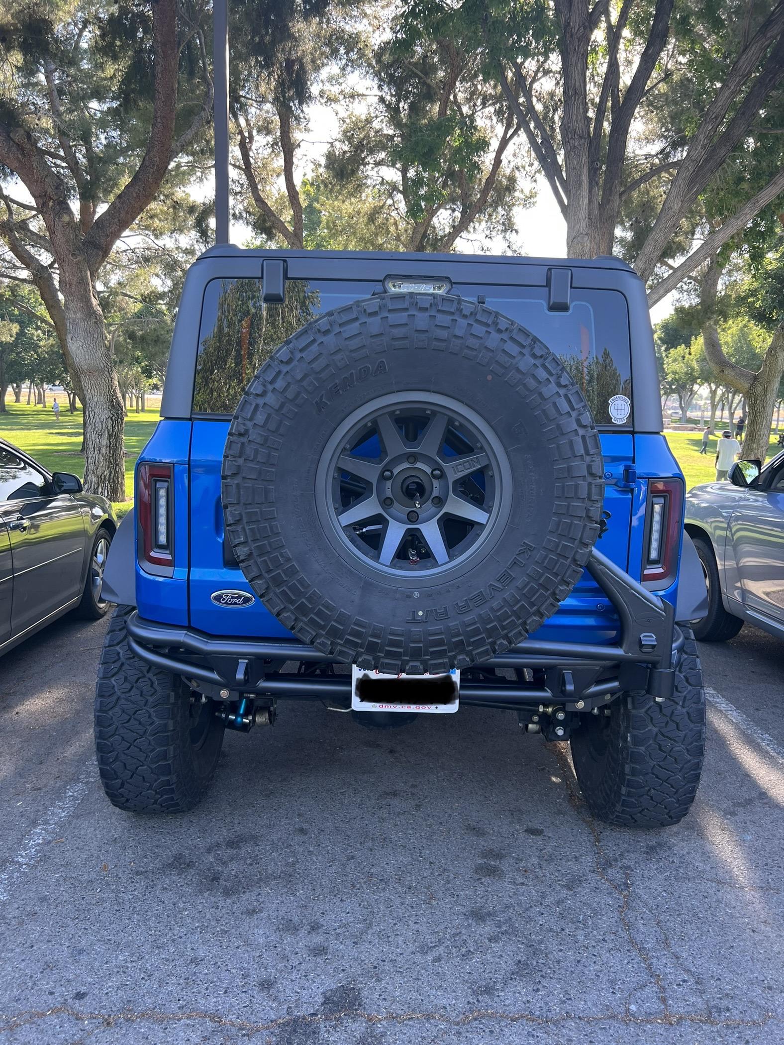

So, the spare tire mount is connected with linkage to the tailgate and they both open together at the same time? Very impressive fabrication work.

yes, they open together, took a while to figure out a solid solution.

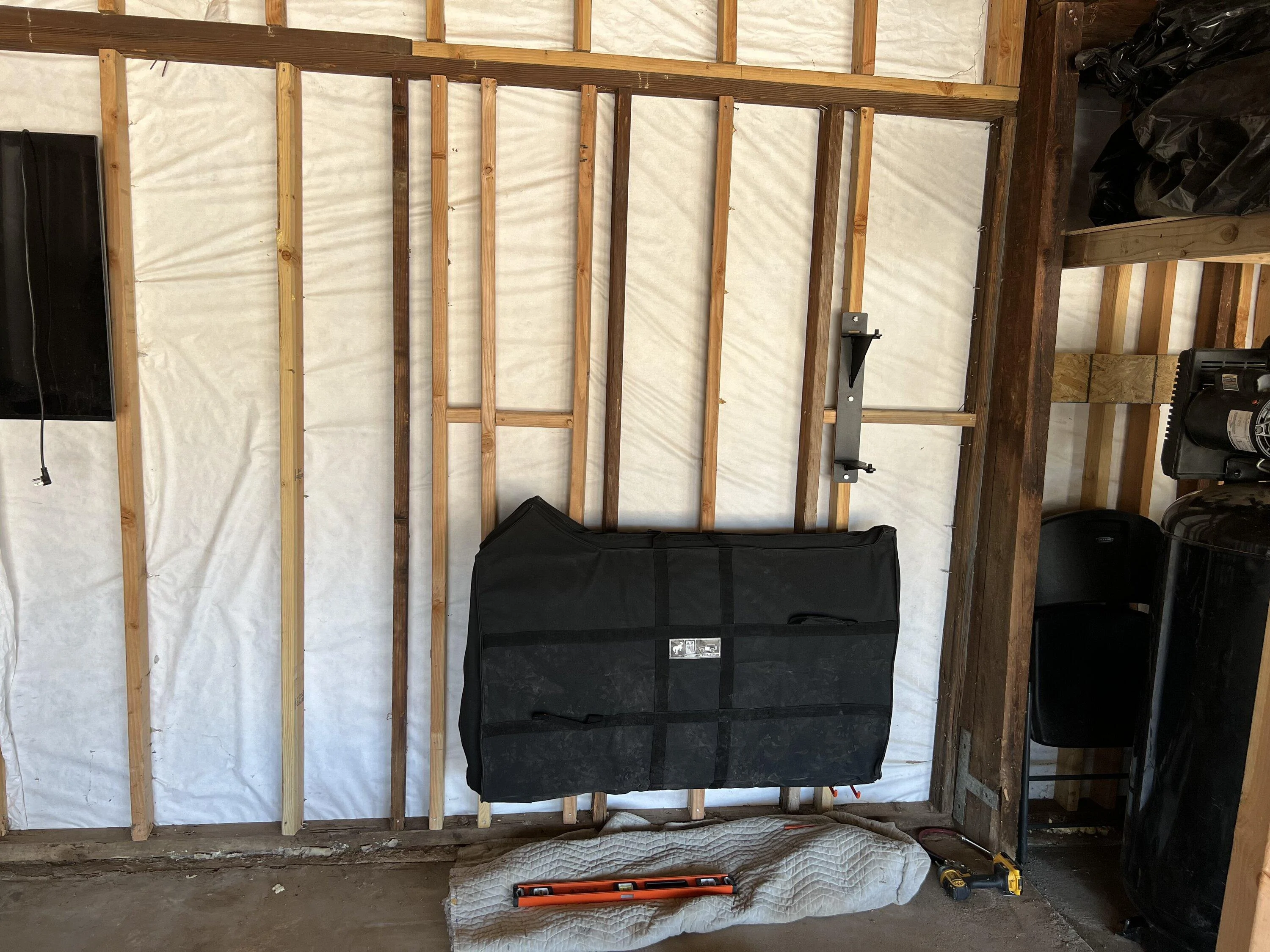

Finally took the doors off and installed the goat fab door hangers

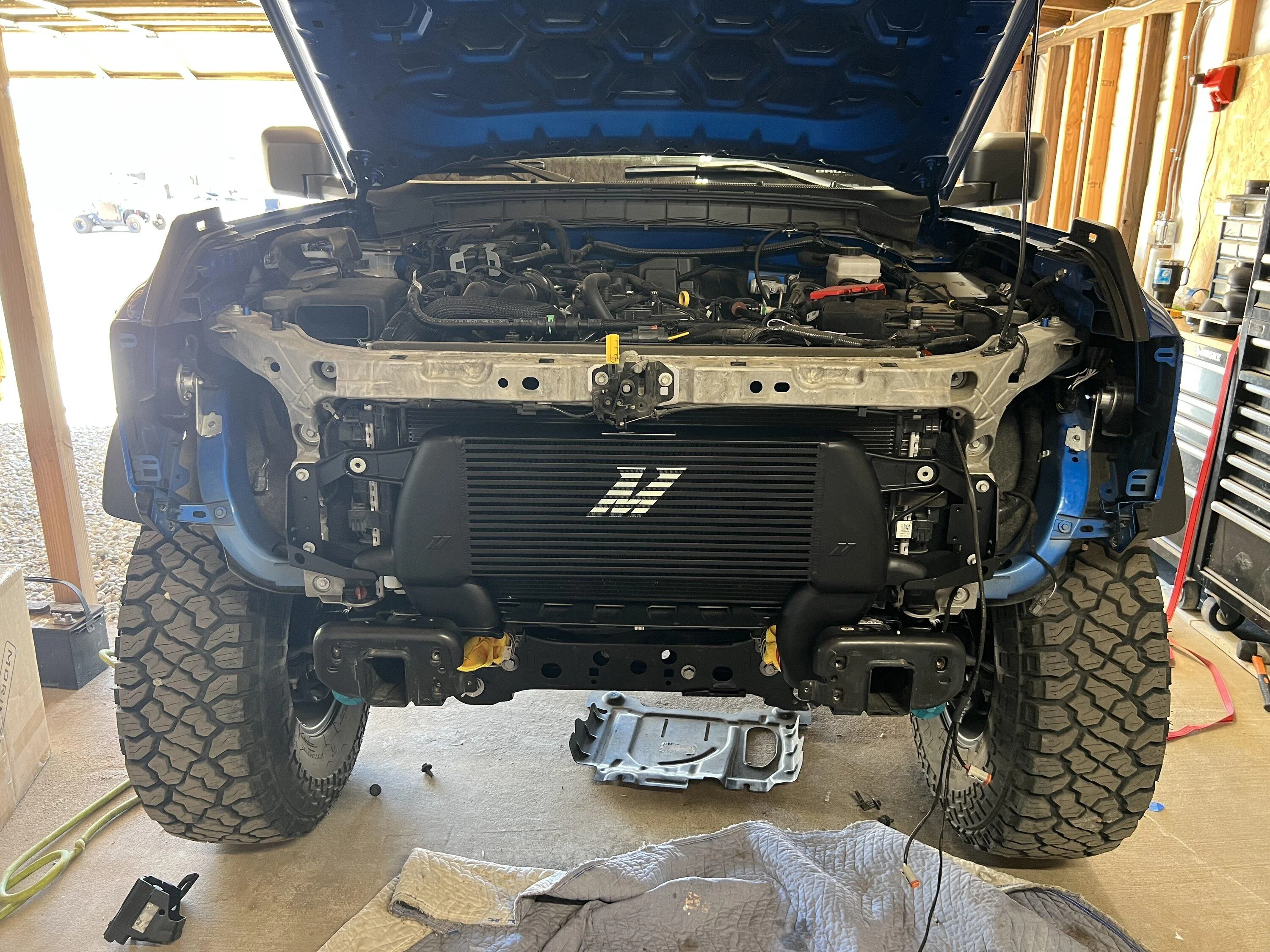

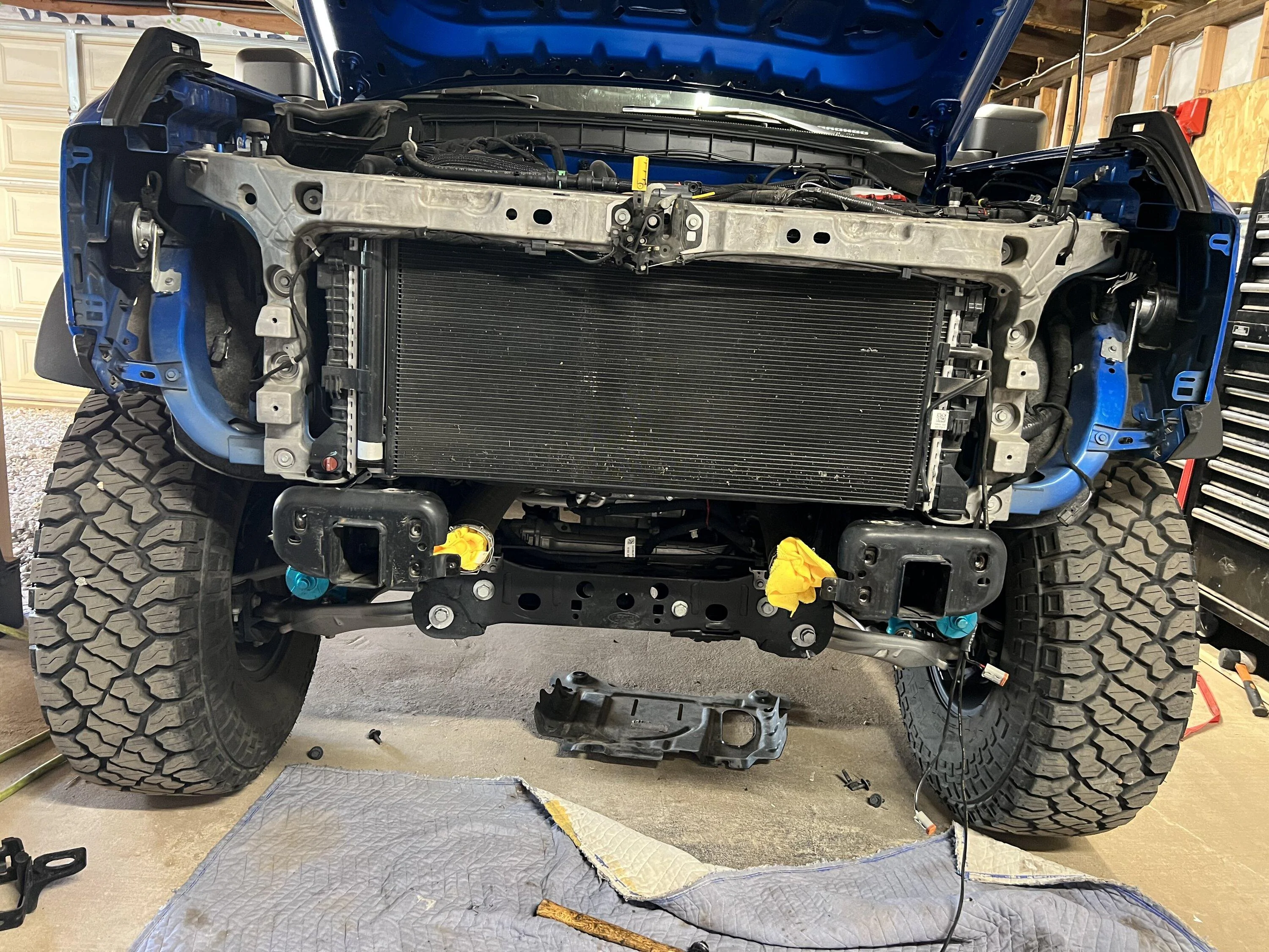

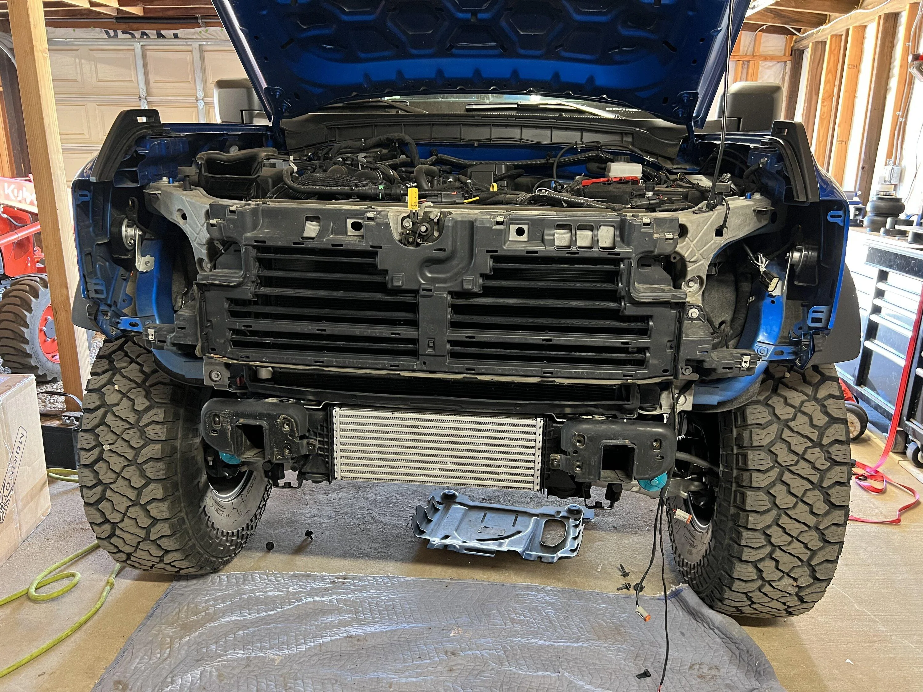

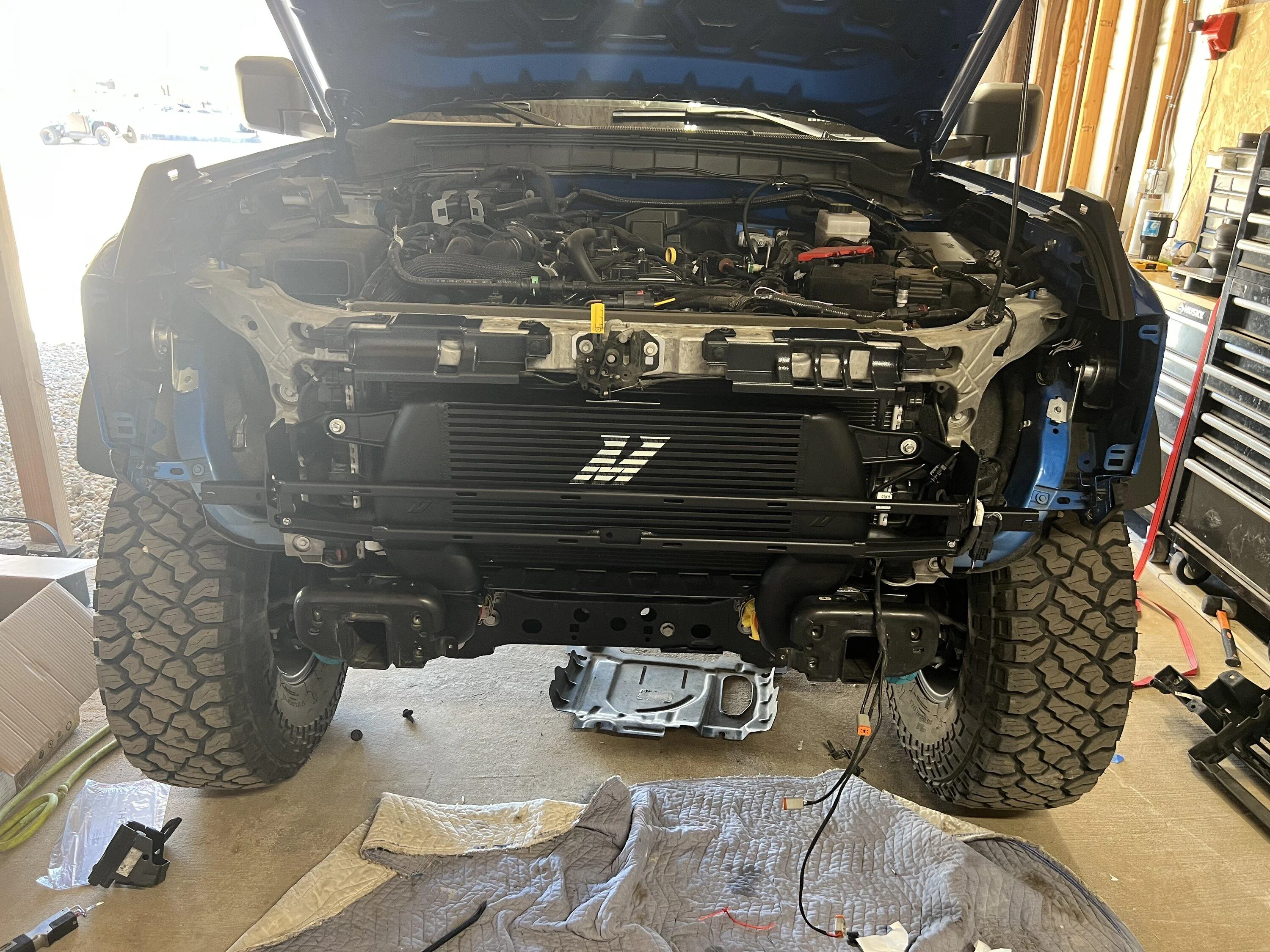

Finally got around to installing the mishimoto intercooler
And morimoto replacement headlight
That intercooler install is a pain
Took about 3 hours
But sucked
Took about 3 hours
But sucked
NIce !!!!
Yeah, you can't get ahead of the directions. Thought I was cool and tried to work ahead and it bit me in the butt. Gotta leave the brackets loose before you put the intercooler in. 😁
I have not had any ill effects from the intercooler being in front of the rad. Runs the same temp as before. No CEL.

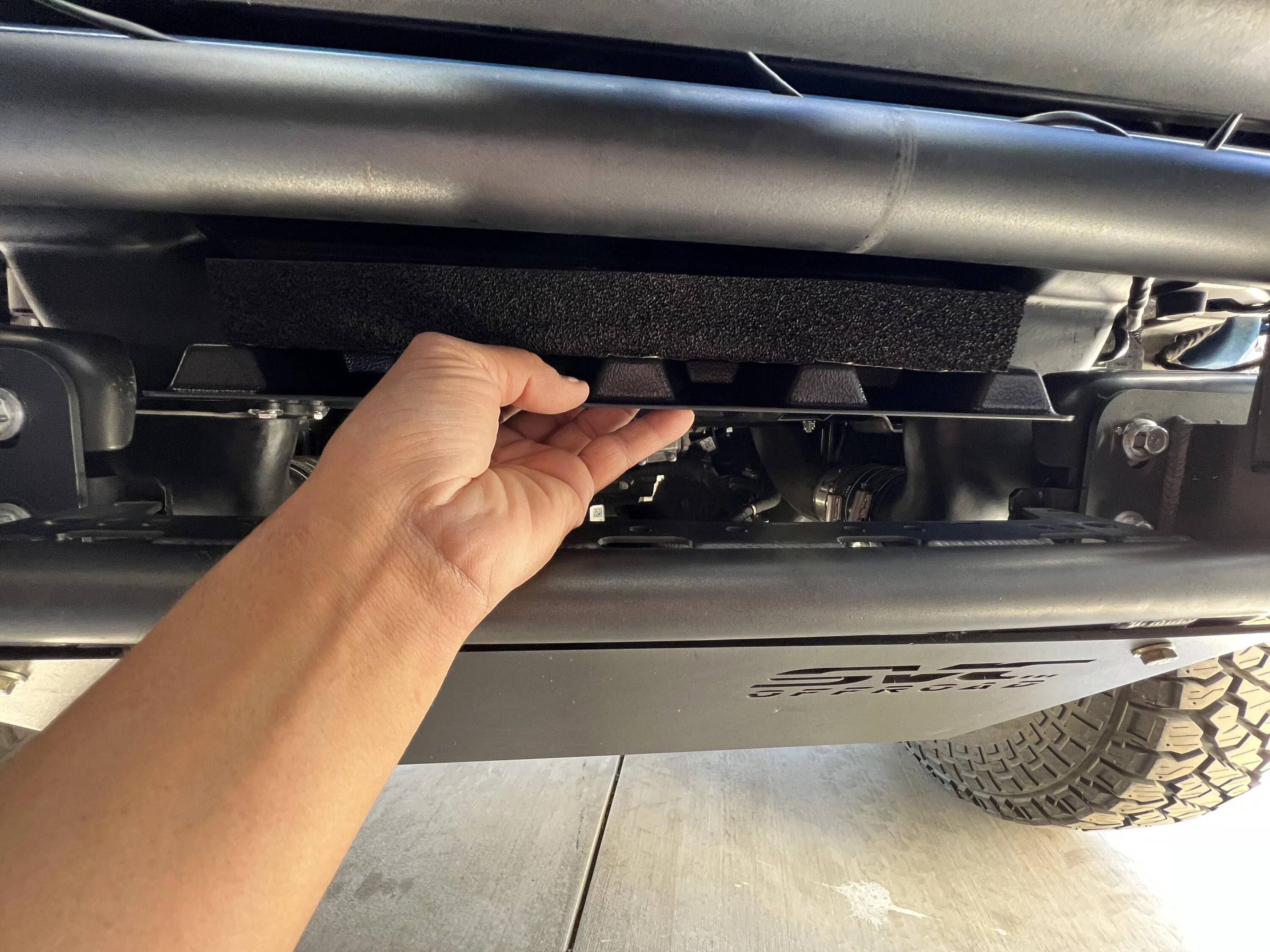

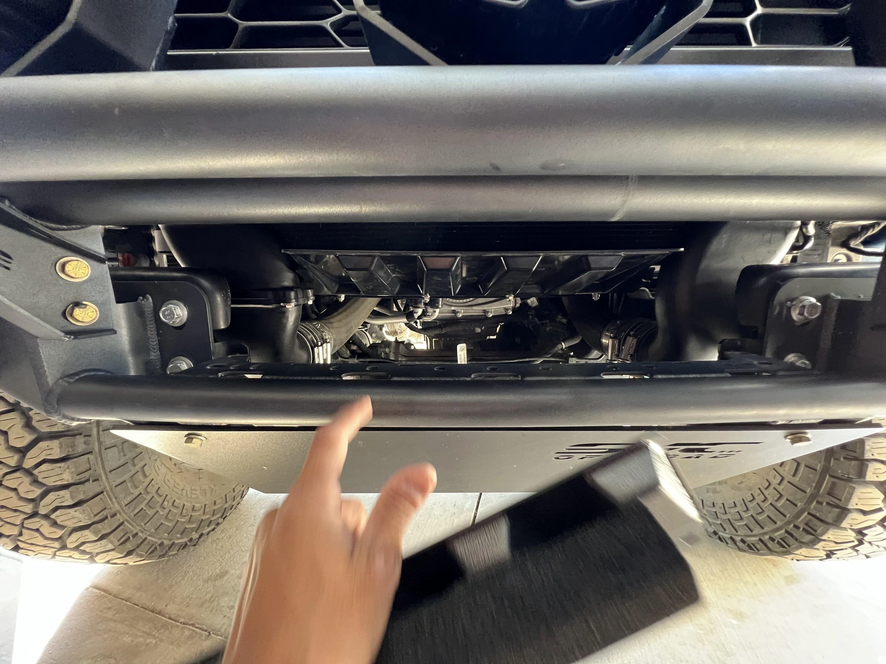

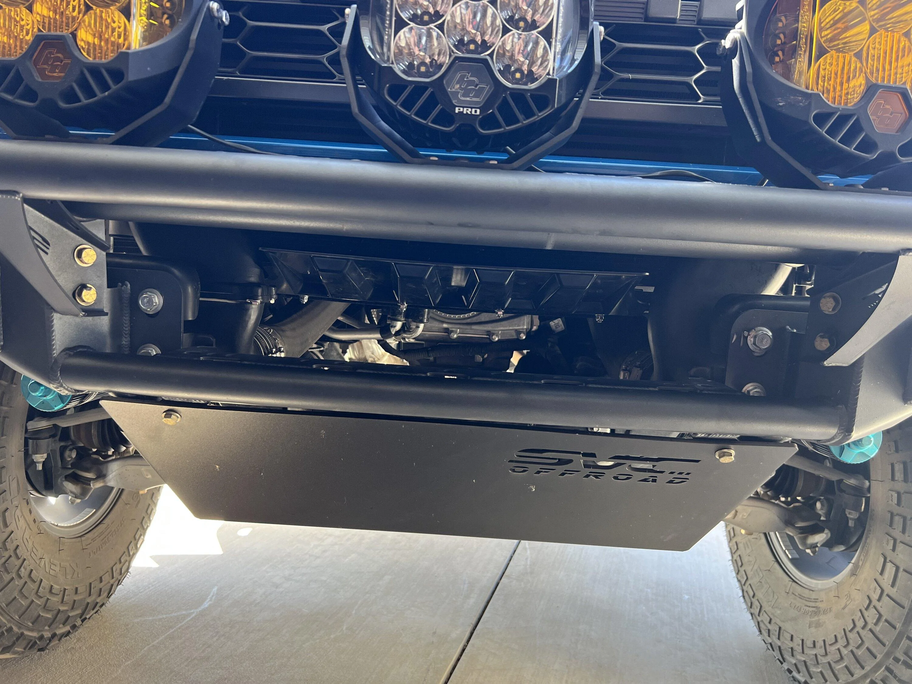

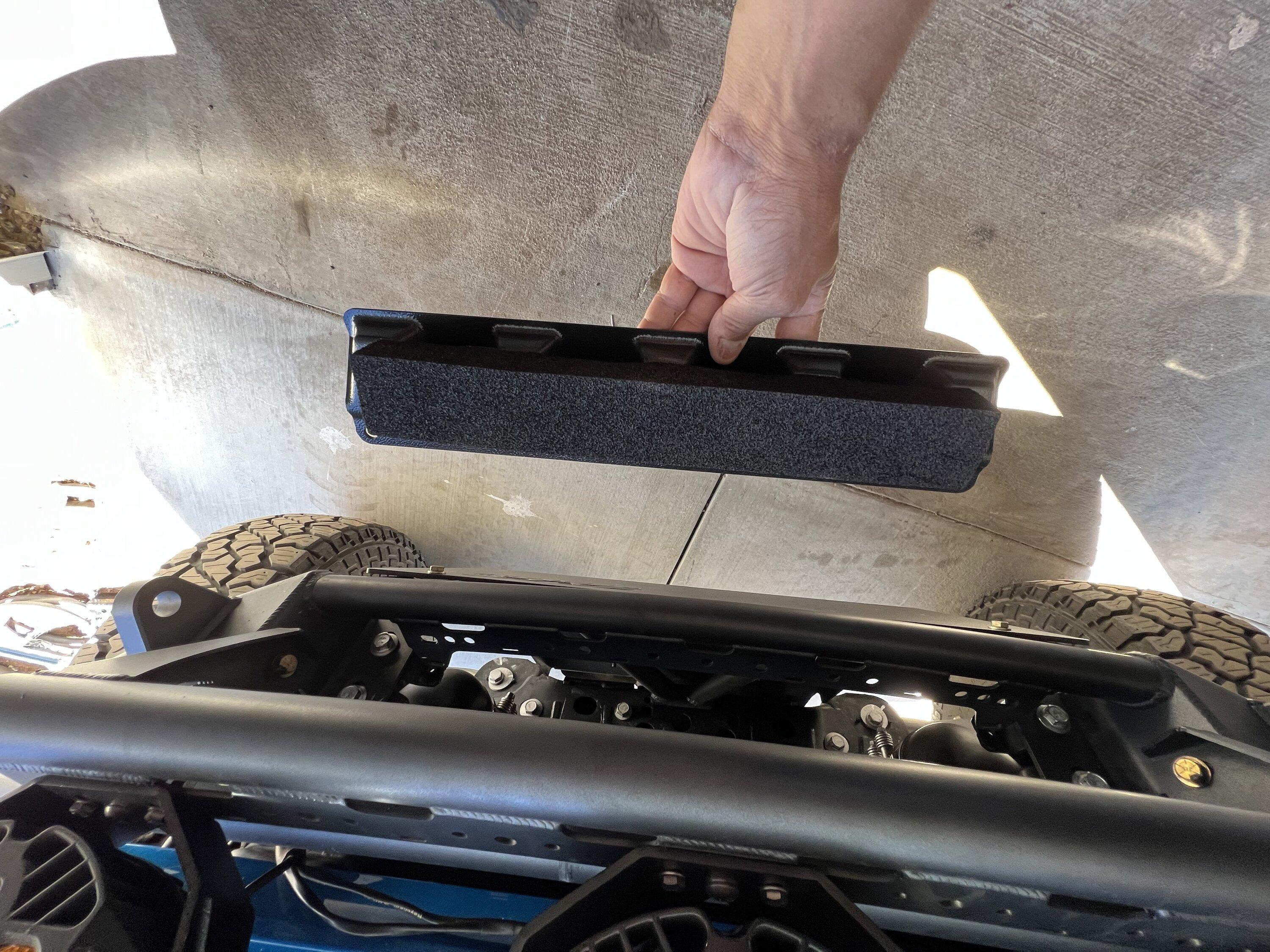

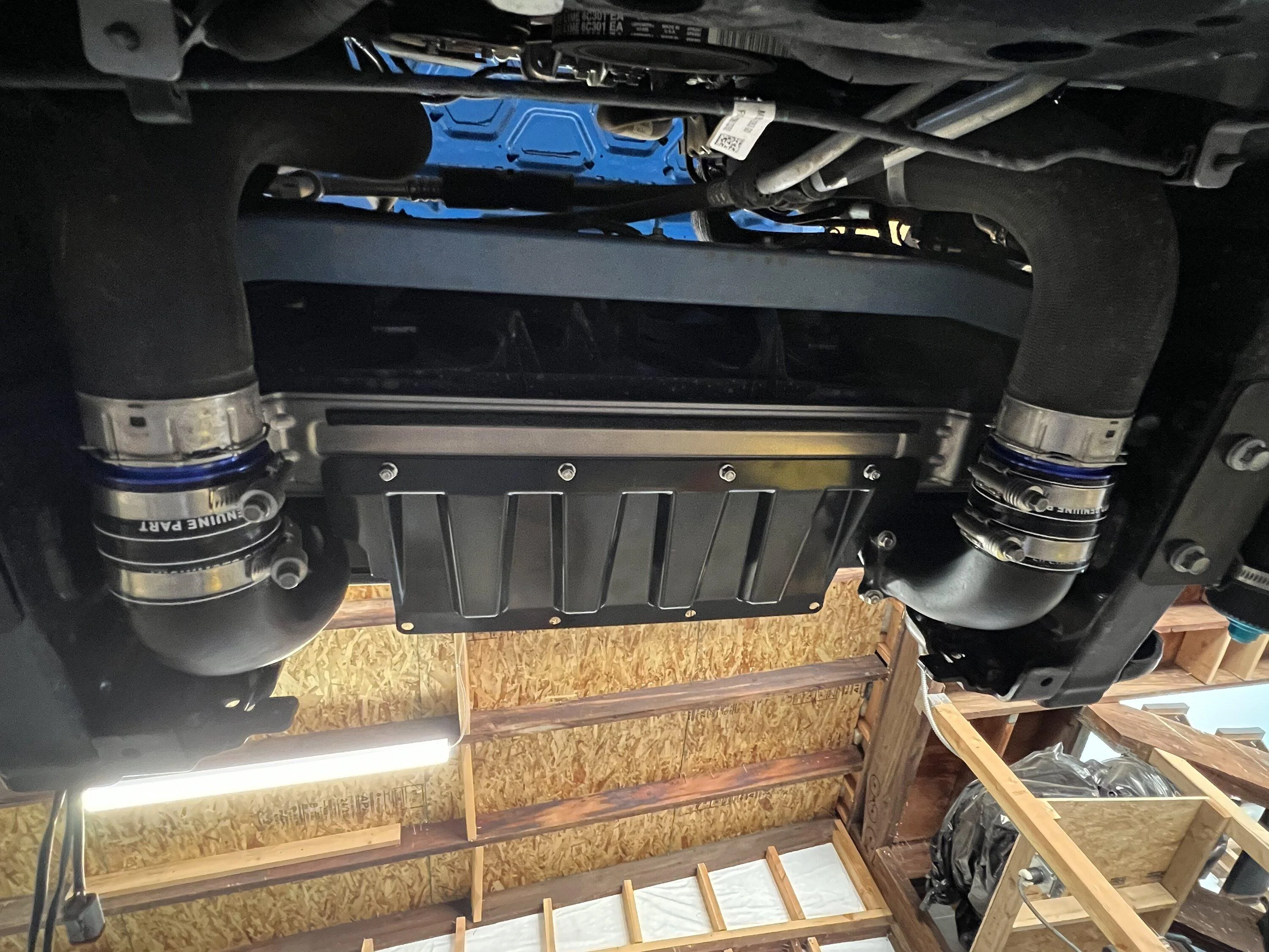

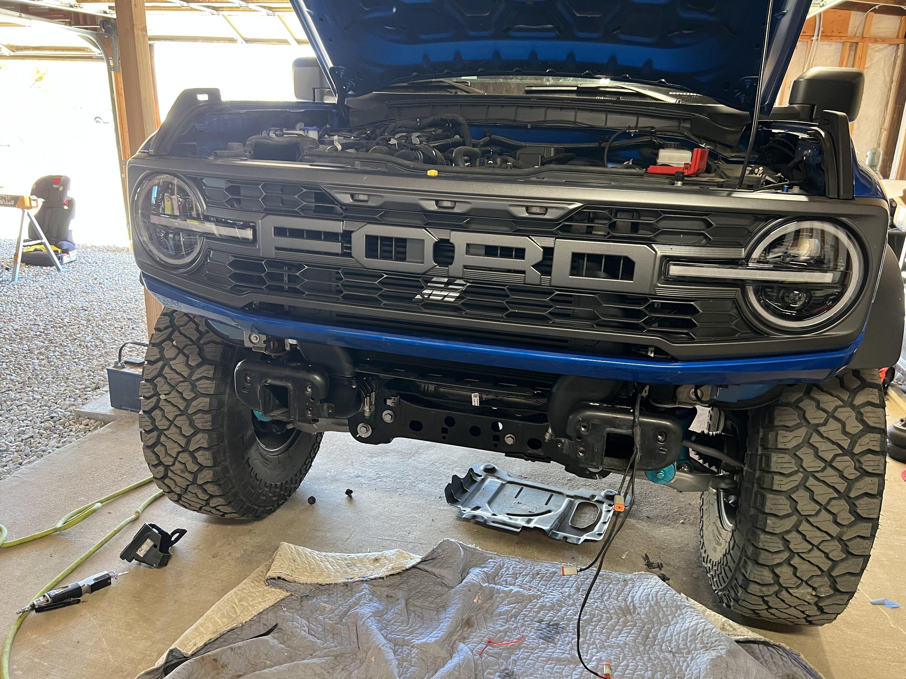

What is everyone doing with this bottom plastic piece
When nit running a stock bumper
I did not install mine. I asked Mishimoto about both of those plastic bits. I knew the one you pictured in your hand, would not work with what I was doing so I asked. They told me you can run without either one of them. They are just to help the air flow. Neither is "required". I still ran the inner one because it was not in the way on my build.
It is amazing how much room is in there when the IC is not there.

Hey @Aztec1382 - Sweet rig! Your tire carrier + rear bumper build is epic.
Like @BAUS67 mentioned, that ducting is not mission critical. The more air you can duct toward the intercooler, the better. We were able to optimize for the stock bumpers, but in a perfect world, we would have every aftermarket bumper in house to design ducting. That would just be insane! I'd consider it a challenge to fab whatever ducting you needed for the bumper you designed/purchased. :cool:
Let me know if any questions come up!
