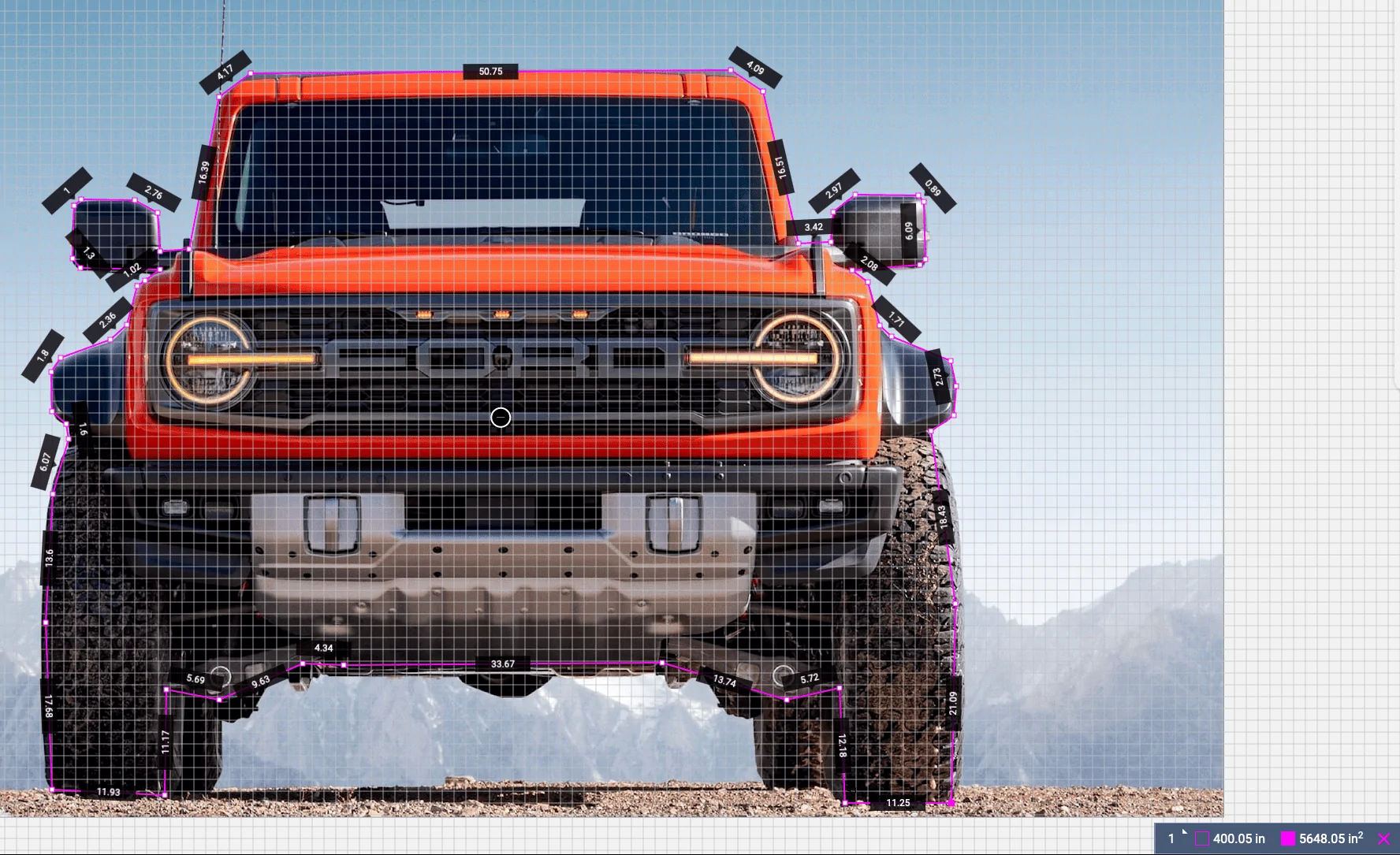

There are a couple other threads here on the top speed of the Bronco and Raptor (if delimited). Those have been full of nervous nellies, to say the least. Due to not being able to find the trucks frontal area online, I calculated it. This number is required for such simulation to calculate drag force. The vehicles frontal area is 35 ft^2 (calculation below, and notes as to why numbers shown in this image do not quite match the 35 figure are here).

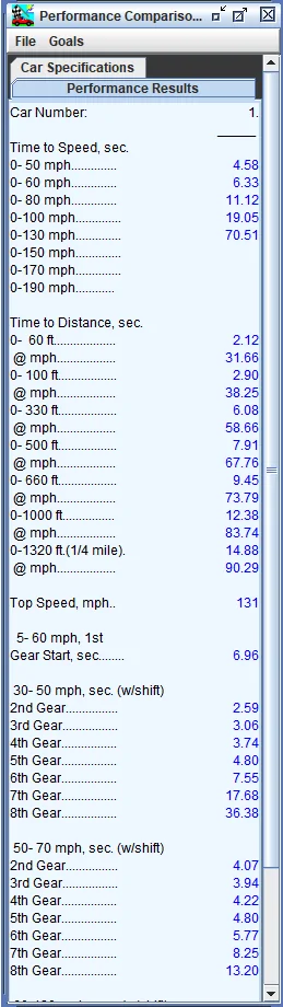

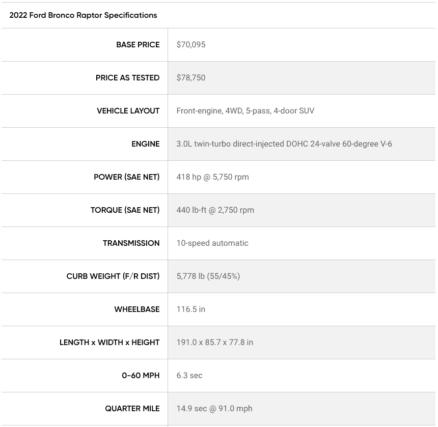

With this in hand, I updated my full vehicle performance simulations. Overall numbers compare well with MotorTrend results (also shown below). 0-100 vs. Car and Driver is nowhere close though. Looks like they may have got a "purposeful outlier" from FMC based on that number. Maybe they had the (not yet available to us) Ford Performance Tune already installed...

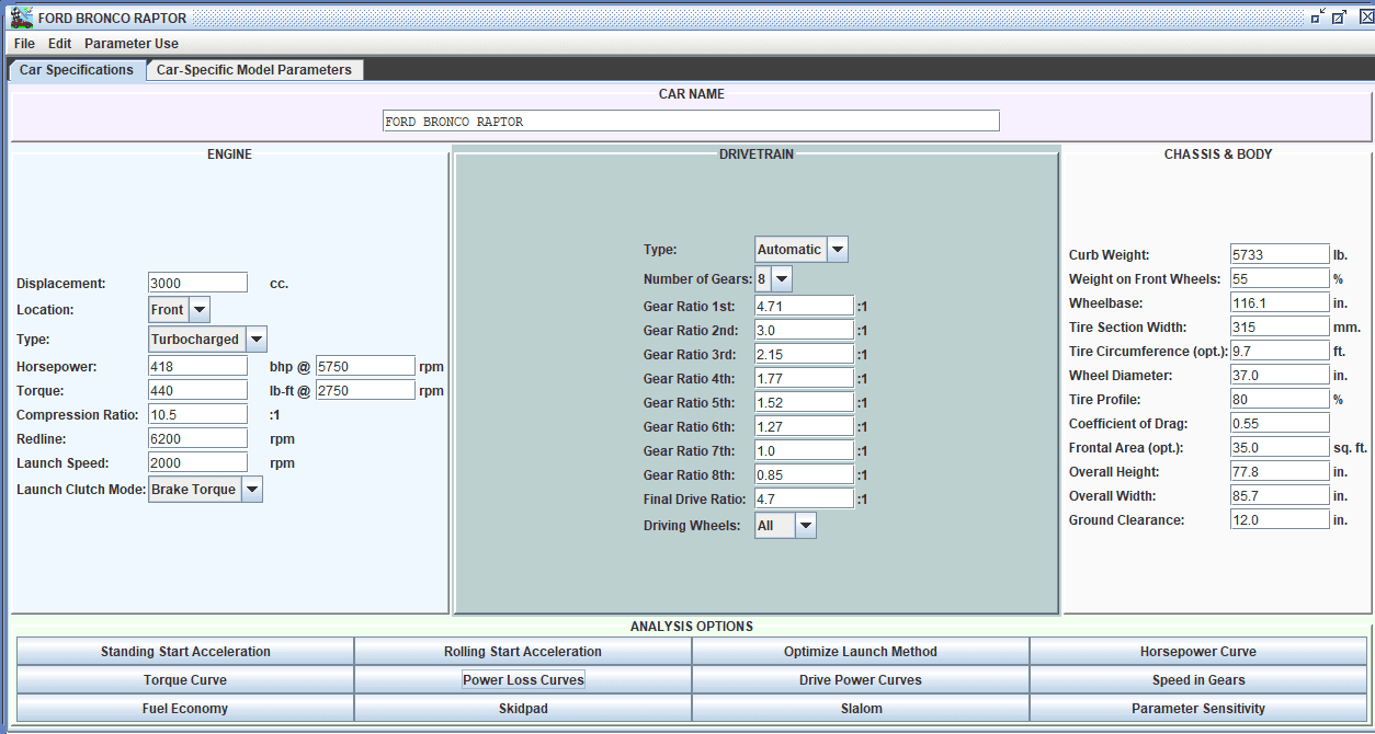

Here are the basic inputs:
Ford Bronco Physics Based Performance Modeling/Simulation - 0-60, 1/4 mi, Top Speed Screenshot 2023-07-17 at 1.00.18 AM

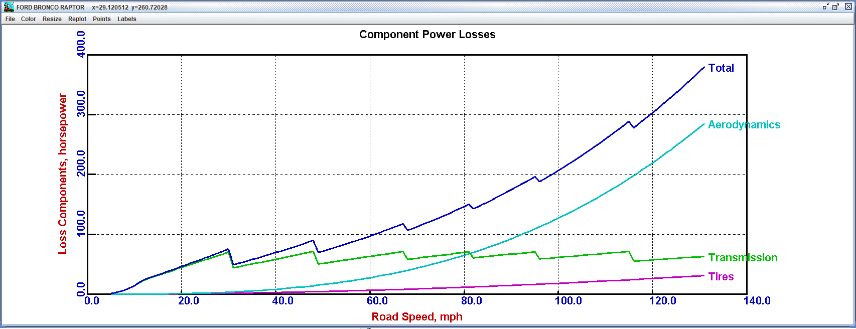

Power losses typically have to be tweaked a bit on a second screen of real geeky details. I'm using about a 17% total drive train loss.
Ford Bronco Physics Based Performance Modeling/Simulation - 0-60, 1/4 mi, Top Speed Screenshot 2023-07-17 at 1.00.00 AM
Power losses are shown vs. vehicle speed and demonstrate my prior comments about aero losses being insignificant below ~50 mph and dominating above ~80.

I wonder what software created this? I would love to see how other vehicles perform.

It is called CarTest. It's decent out of the box, but needs some significant adjustments beyond the main input screen to be accurate.
One of it's most significant shortcomings (likely bug) is how it deals with drivetrain losses, which are absolutely critical to get good results. The inputs here do not appear to sum to match the output loss graphs. Thus, after discussion with the developer, I somewhat arbitrarily adjust the individual drivetrain loss numbers to get a graph with the total desired loss at peak rpm in 1st gear.
I also wrote my own huge/complex spreadsheet based version of such a tool. It generally agrees with CarTest but it's very difficult for me to implement a tire slip/spin capability inside Excel. CarTest includes this phenomena.
