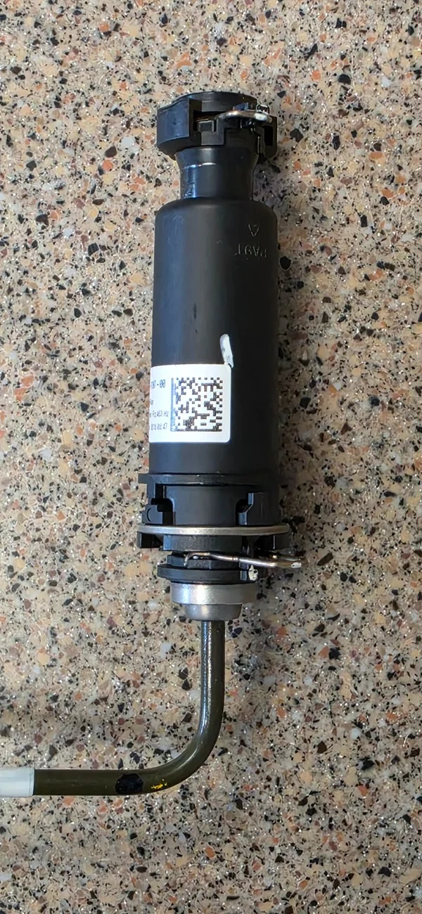

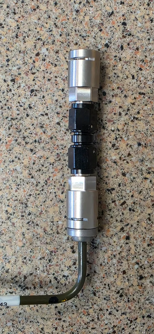

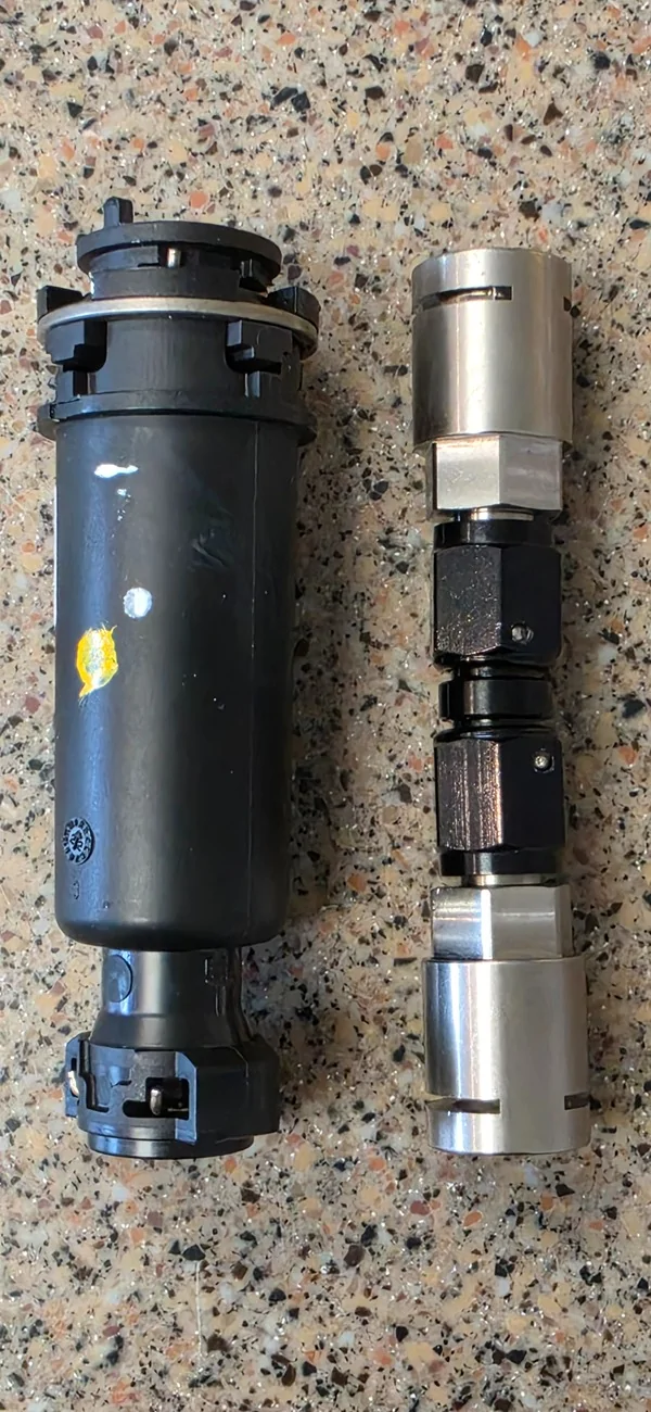

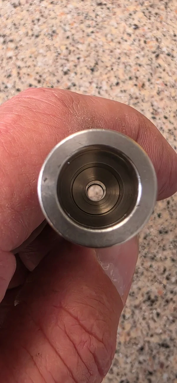

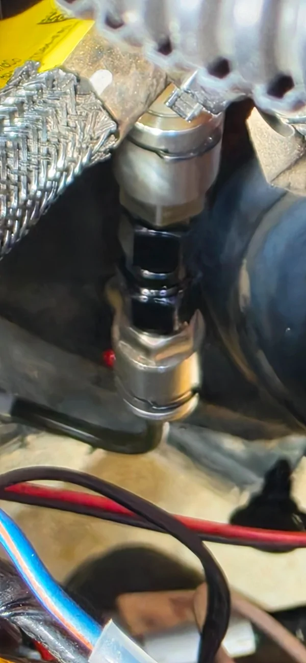

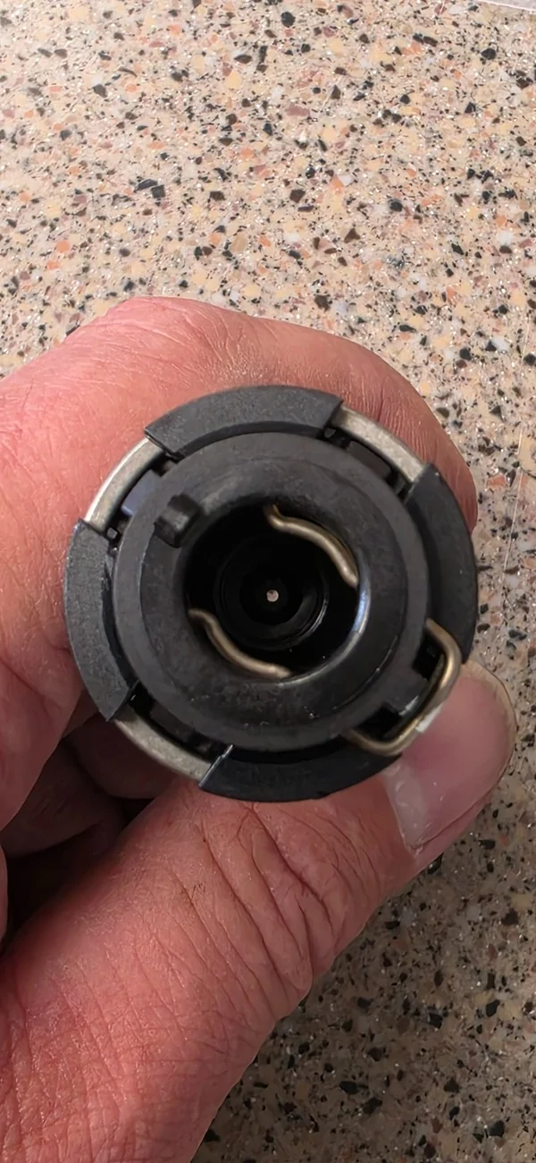

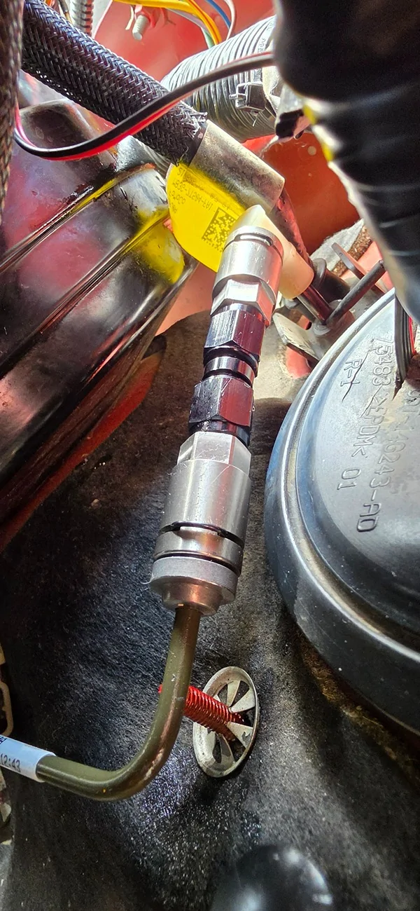

Okay, so I have built and installed the new all metal piece. I have driven it all day today with no problems. The clutch does feel better to me. Before it felt like I was pushing on a balloon, now the pedal sweeps with less resistance and less of a squishy feel. We are going down to Galveston for a long weekend camping trip. I will likely have to pull some people out of the sand and bogs more than a few times, so I will report the performance of the repair when I get back. Here are some pics of the new factory piece next too my delete. As you can see, the orifice in the factory piece is tiny and redirects some of the fluid through alternate passages in the body of the accumulator, this is why it feel like you are pushing on a shock absorber. The metal piece has a much larger orifice that allows a direct high flow passage to the pressure plates.

Awesome! Good work. Sorry if I missed it, could you post part numbers or links to what you used? Thanks!

Two of these as the broken part is female on both sides.
https://www.tickperformance.com/4an...gmwFgmvZAGeEKrukbq0kp0h14s2xDvQcaAuK7EALw_wcB
And one of these to join in the middle.
https://www.summitracing.com/parts/..._Y2kWQOYcAbMIMK7TI33Hew-RnqvILVRoCZskQAvD_BwE
should completely replace the plastic part
Thanks! Wanted to make sure what you ended up using was what you had planned on.
I'm definitely doing this, may carry this setup as a spare for a little while before swapping. We'll see.

Update on the clutch repair. Everything worked great. You defiantly have more control over the clutch engagement. To be honest, I was never able to really get used to the weird delay and sometimes stalled my Bronco in first! I have owned and driven everything from Camaros & Corvettes, Ford-Chevy-Dodge trucks, and even a Pete 379 and a Volvo VNL.... and never had problems stalling out, but this stupid Bronco, it always gave me problems because the clutch never felt consistent and has that horrible mushy delay. Not now! Even my wife, who has a keen ability to pick up on little changes like this, said the Bronco was much easier to get going and even said shifting between gears was smother, which I didn't notice at first, but I have to agree with her. We spent 3 days in beach sand and bay mud, pulled out one Tacoma, two half ton Chevys, and a 1 ton Ford, and the clutch worked flawlessly.
Also, I reported the failure to the NHTSA.
