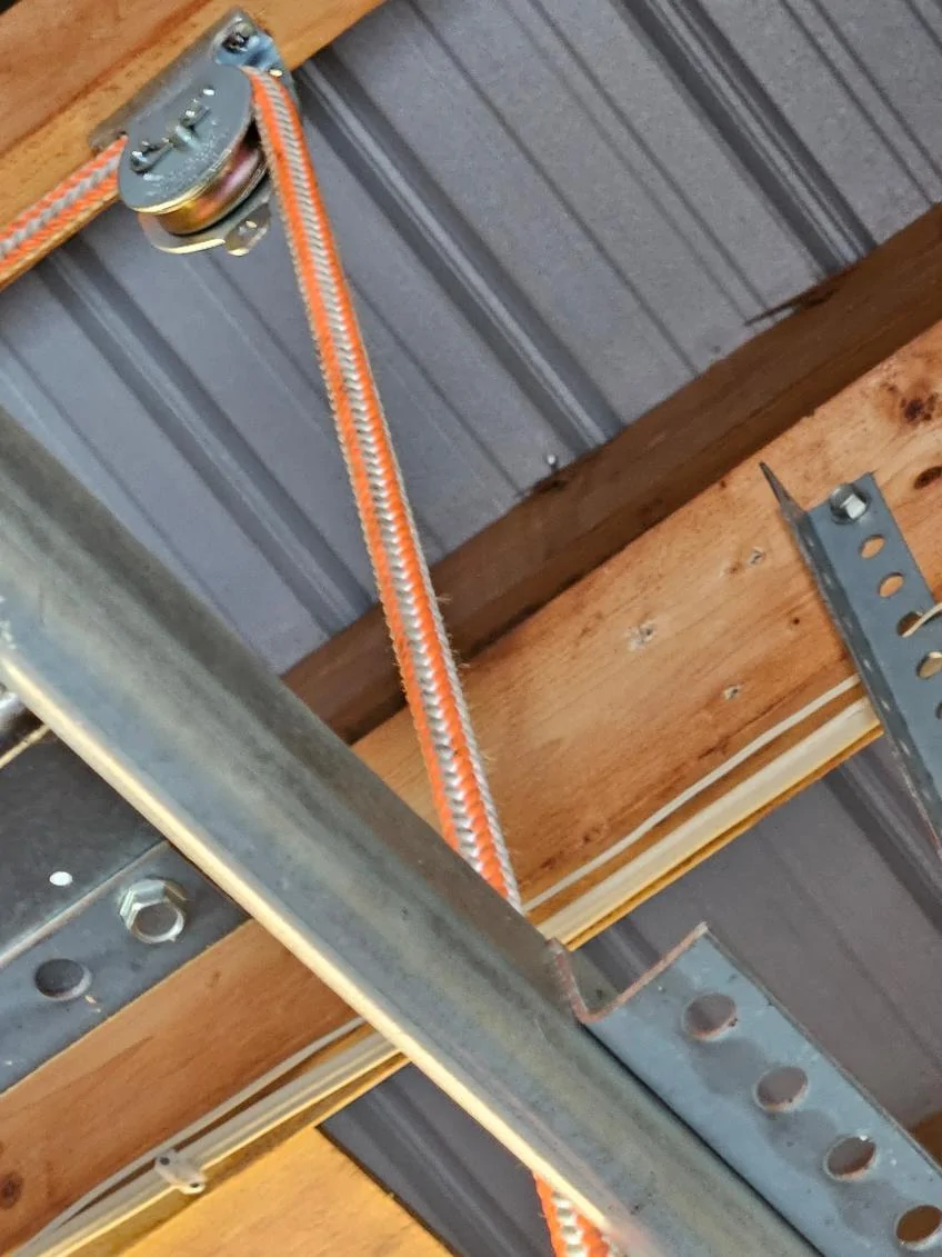

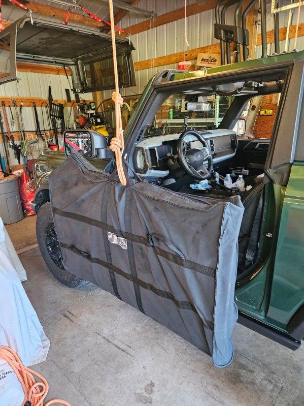

I mounted the pulleys where the lift rope would hang right at the center of the door bag grab handle with door fully open. Before removing bolts, slide your door bag all the way on to the door and zip it as far as possible to still be able to access the bolts. This length of rope allows the door to easily swing around to guide it to or from its hinge mounts.

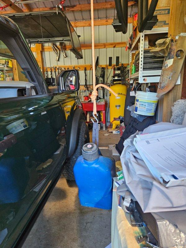

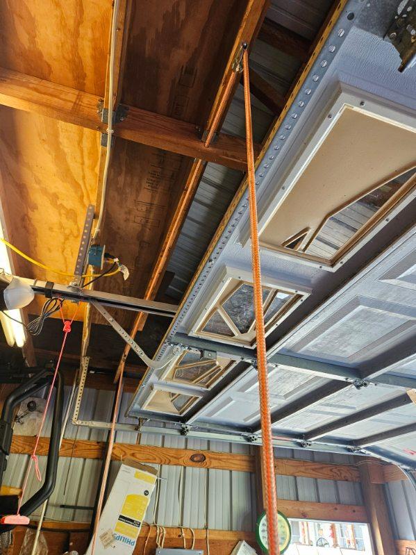

The pulleys were mounted so the counterweight jug could be swapped to either side of the the Bronco and remove either door if needed. I simply turned my Bronco around because I had more room in the shop on that side.

This jug was filled with water to about 40lbs. which worked for me. Did not want it to weigh more than the door, just enough to make the door "float" on the rope.
