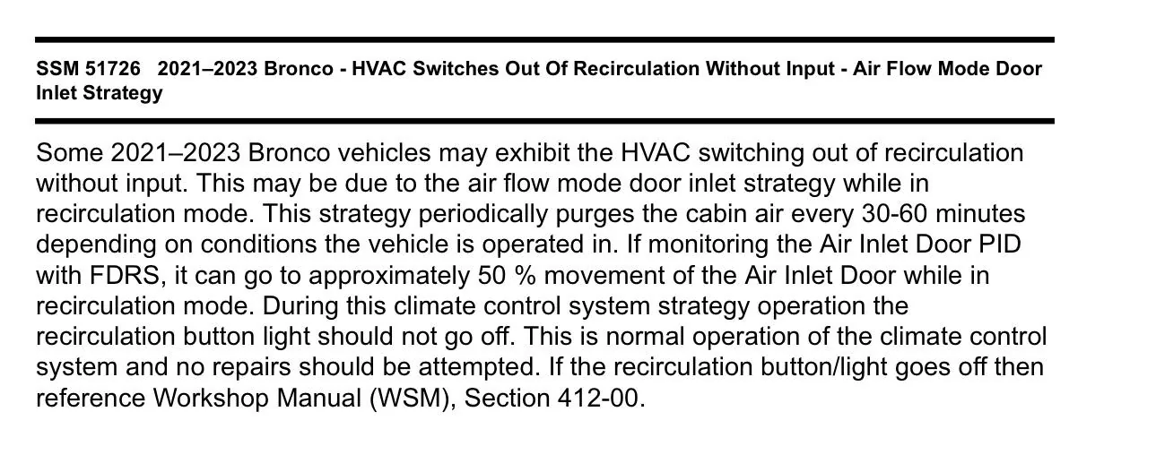

This is normal. It’s due to strategy Ford built into the HVAC system to open the fresh air inlet door even when the system is in recirculation mode. There is nothing you can do to change this.
When the door opens you get a rush of fresh air making it seem like the blower speed has changed. Here is an SSM explains why it happens.
