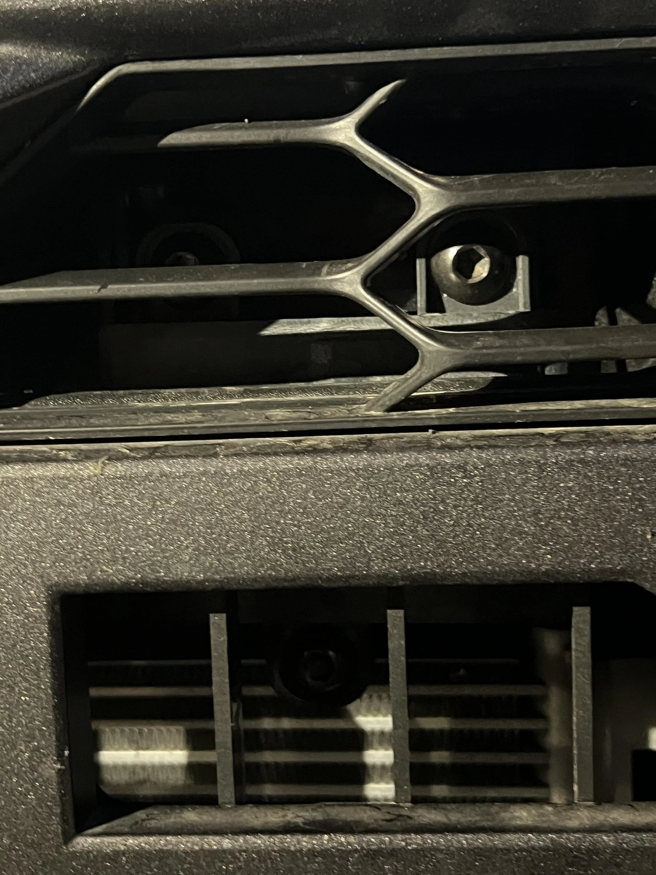

Trying to see what solutions anybody has for bronco raptor, cruise control relocation. I am currently running adaptive desert designs, which is made by dv8. They say the system works with a Bronco Raptor however, after seeing it in person and stalled and coming across issues, they may want to update their product. The issue I have after completing everything is it is saying that the sensor is blocked. I which I can completely see so trying to see what people have done to solve this issue. I included photos. I will try to get better ones during the day.
Any solutions to fix this problem will be very appreciated. Thanks in advance.

I have the same relocation bracket and get the same error even though I have adaptive cruise turned off. I did call the customer service and they said it needed to be aimed up or down more and I haven't had the time to rip off the grill to do it, put it back together, drive it, etc.
Maybe they have a certain angle or degree that works and set it to that.

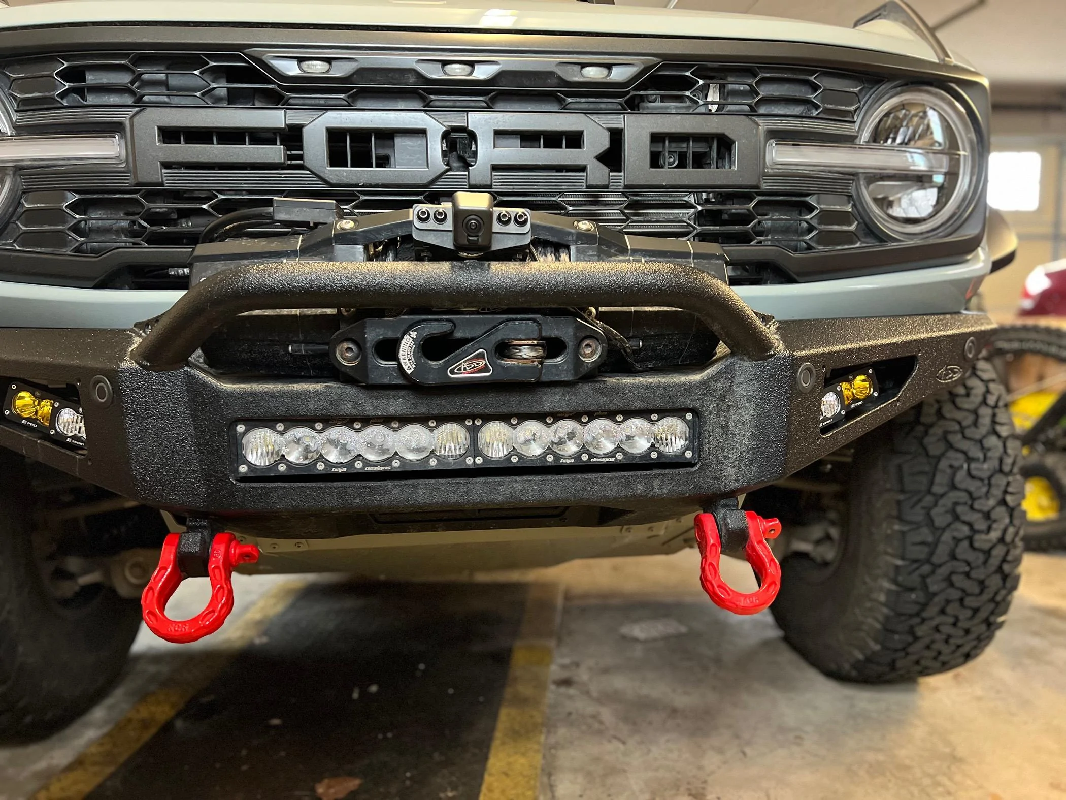

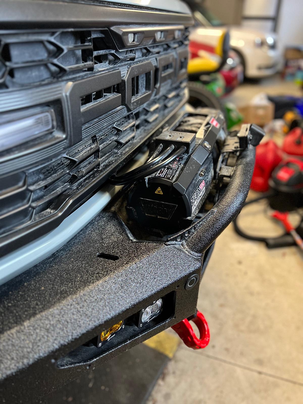

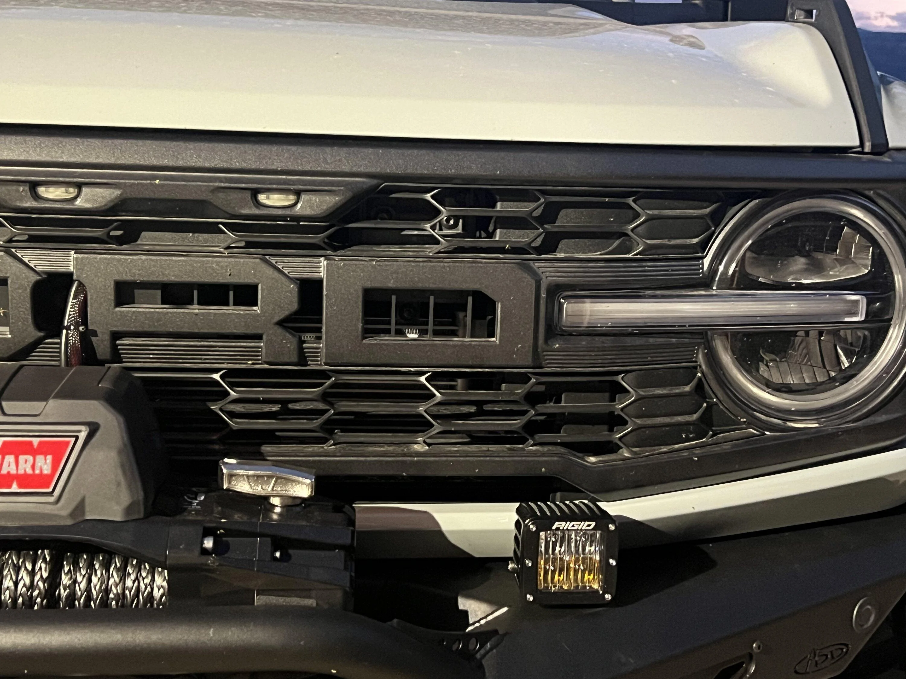

I have the ADD Rock Fighter bumper on my Raptor, Warn Winch, ADD ACC relocation bracket and camera relocation and everything works great for ACC. It was out of line with the initial install but tweaked and now works great (Angle was off a little bit the first time)

Pics of the rig? You know... just for proof you have it.
(And maybe because I want it and would like to see it)
