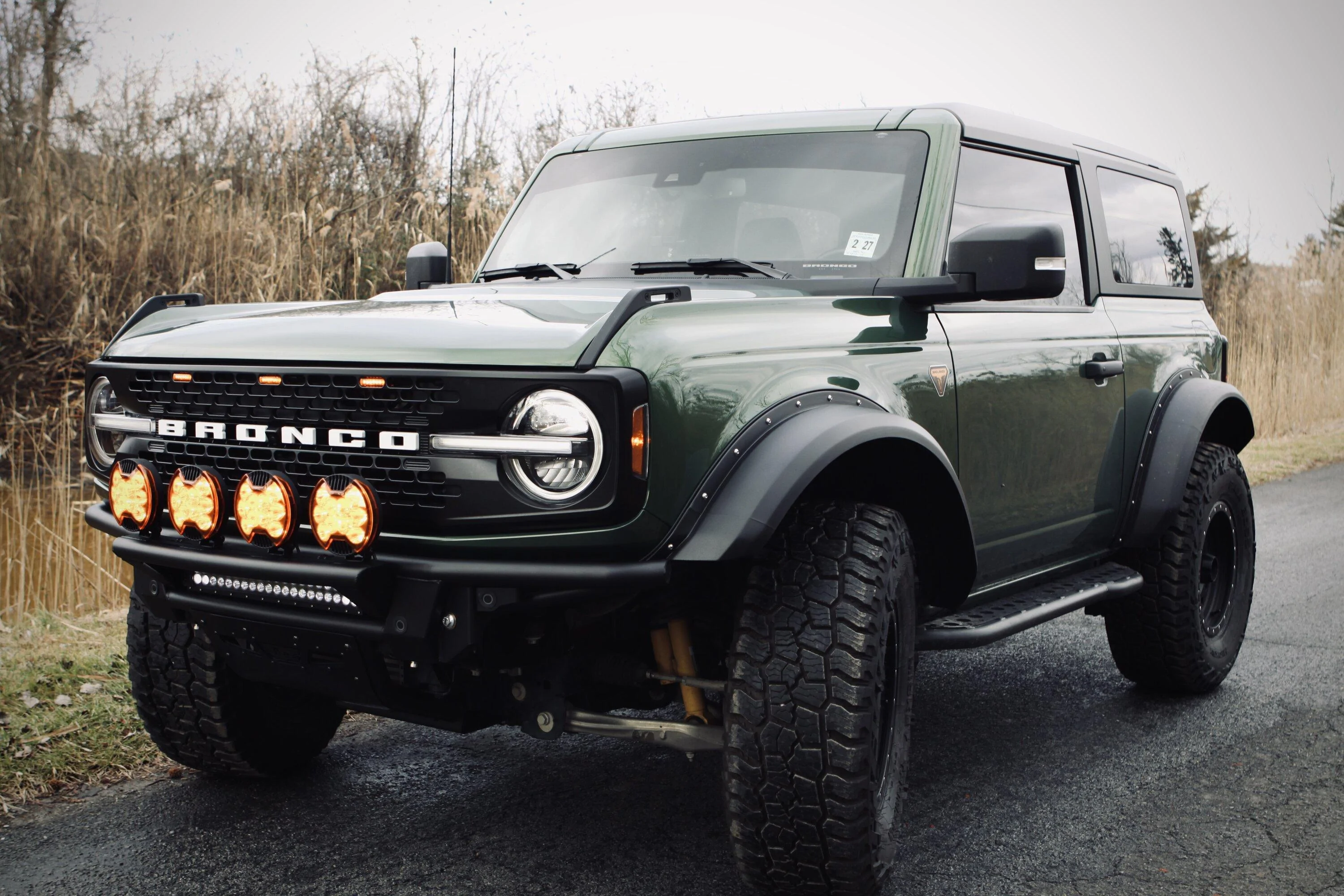

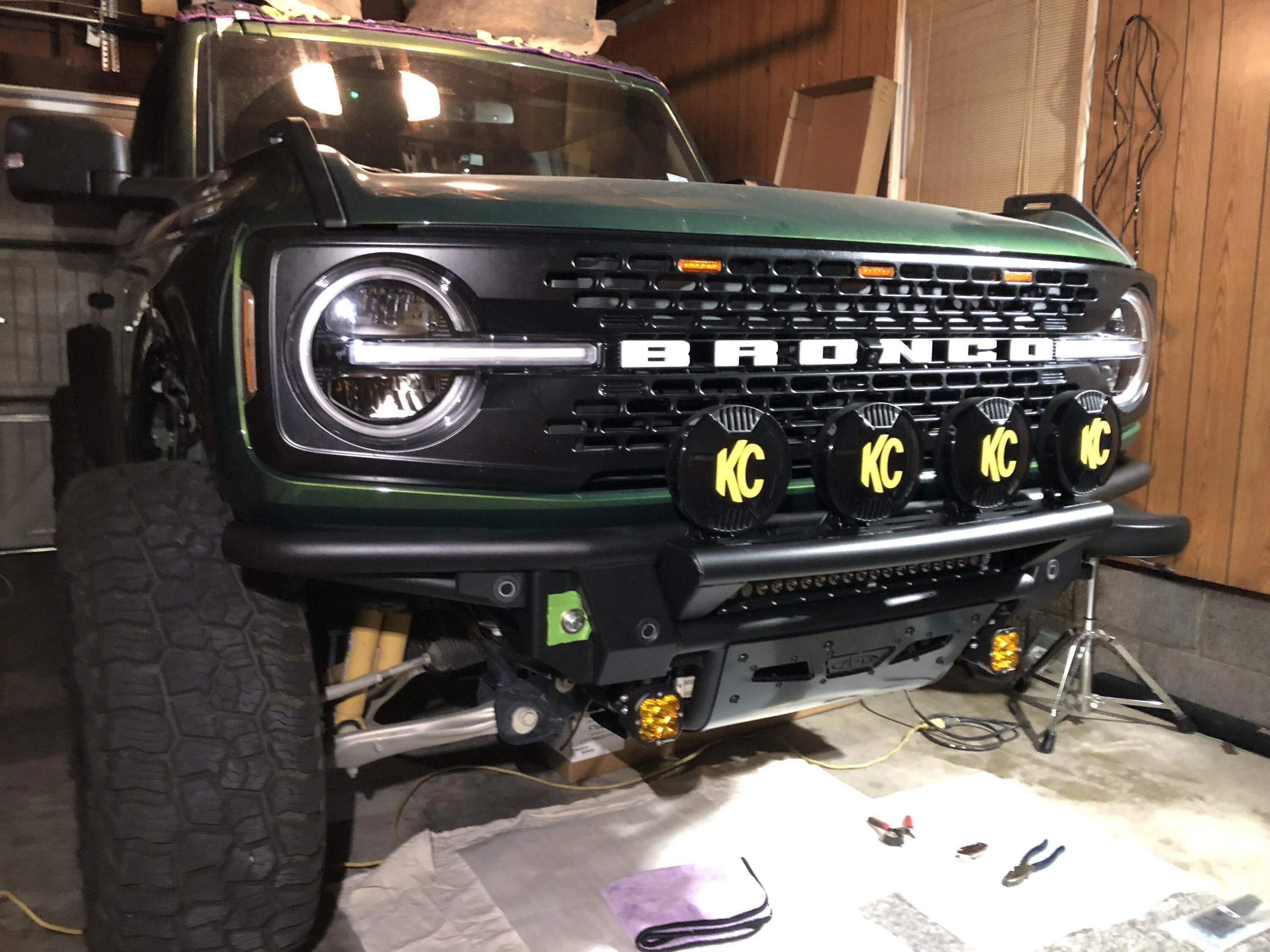

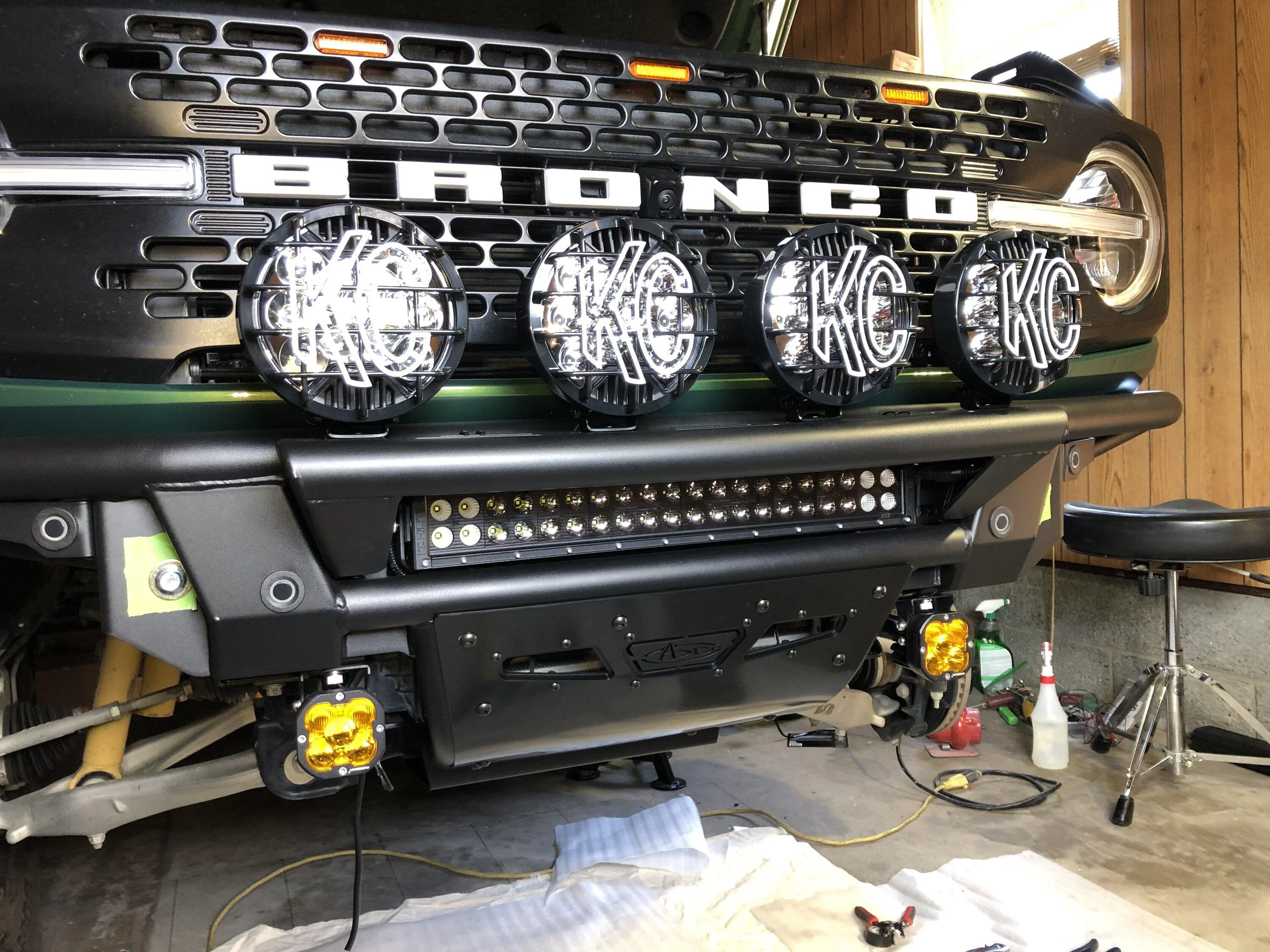

No glamour shots because I’m still deep into this build, but I can check this off my list. ADD pro bumper and lights finished.
Ford Bronco ADD Pro Front Bumper & KC Lites Install. C408F775-540A-44CC-B437-DFBF5411E422
Ford Bronco ADD Pro Front Bumper & KC Lites Install. 1760CDD2-1910-4409-A189-1D950D50FA09
Ford Bronco ADD Pro Front Bumper & KC Lites Install. 1BD5A8FD-E838-4B63-B427-C8850E76670C
I had the Capable bumper which wasn’t covered in the install. As it stands, the harness and sensors are different than the others and didn’t come close to lining up with the new locations. So I just broke the harness down to scratch and rebuilt it. Had to flip sensors FIR/FIL etc… Pain in the ass.

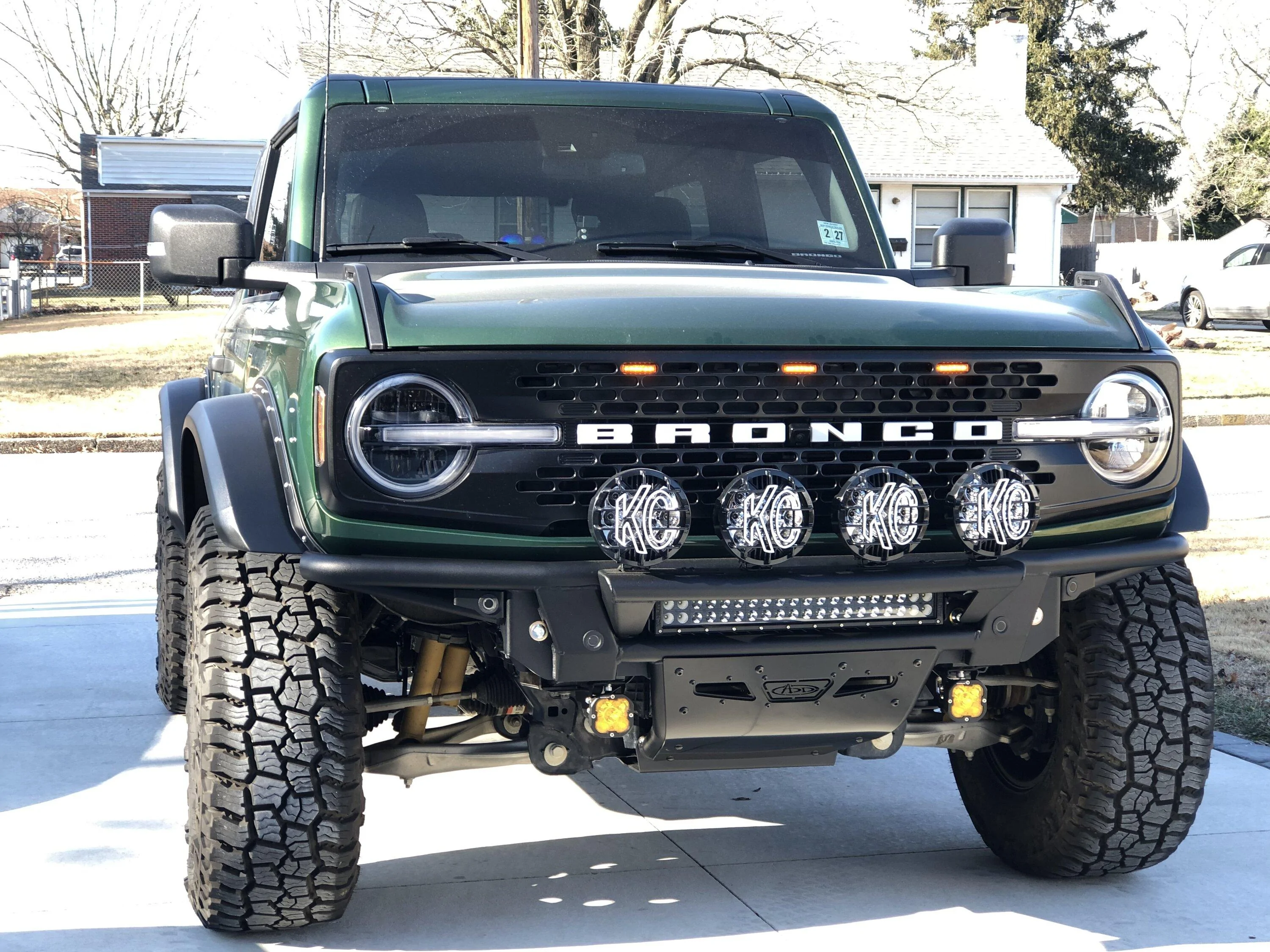

Looks great - love the light setup. What fender flares are those?
NJRoadkill
NJRoadkill
Oct 29, 2021
432
955
South Jersey
www.instagram.com
22 Bronco Badlands 2.3l Manual
Maxlider Bros. —- Which are the Air Design USA set from the Ford Catalog that they prep, drill and tap. it all gets sent disassembled and you could have them color matched or installed as sent.

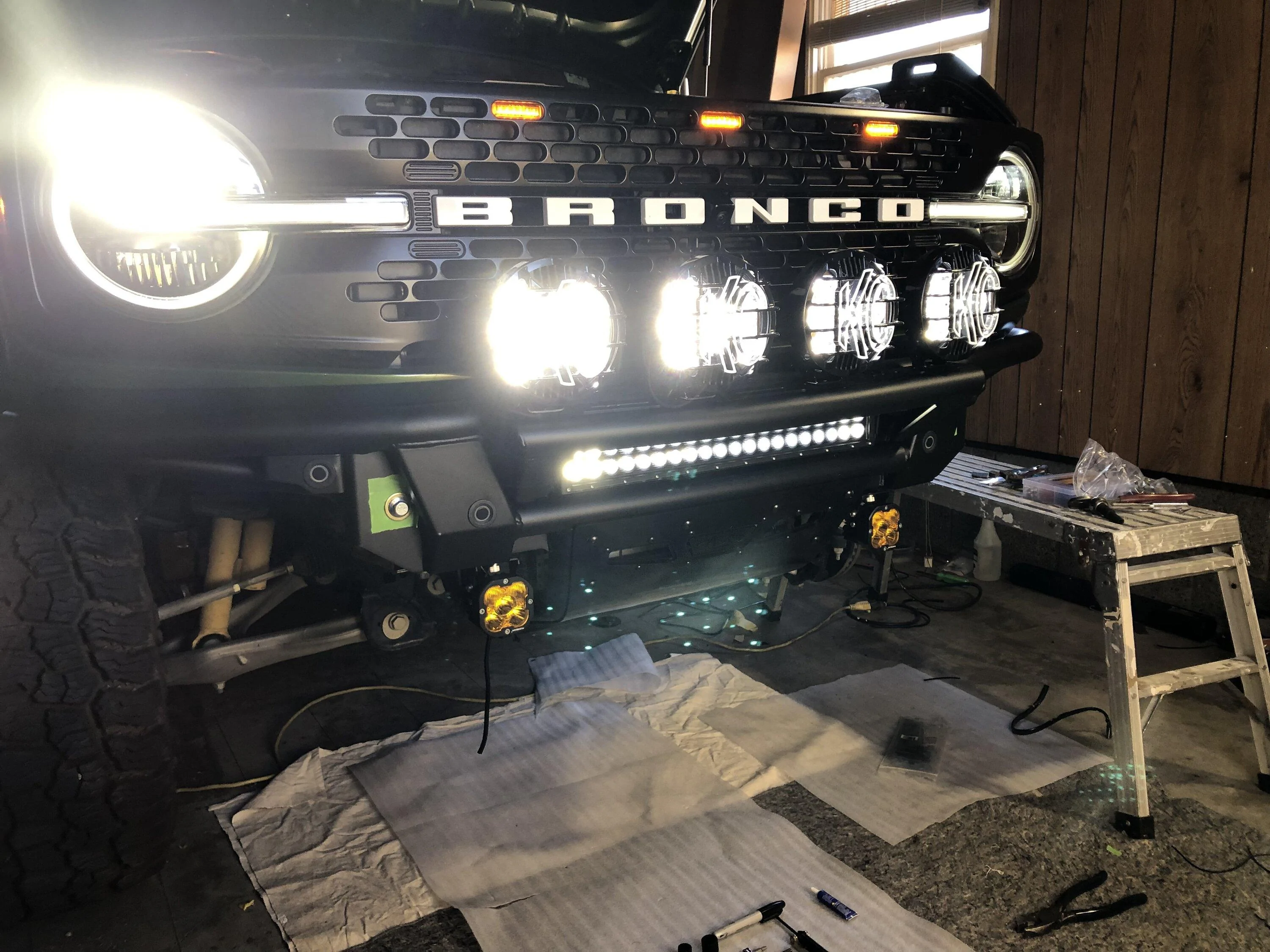

Are those the slim lights? Spot or combo? Can we see the light they throw? You can’t just tease us like this. 😁
NJRoadkill
NJRoadkill
Oct 29, 2021
432
955
South Jersey
www.instagram.com

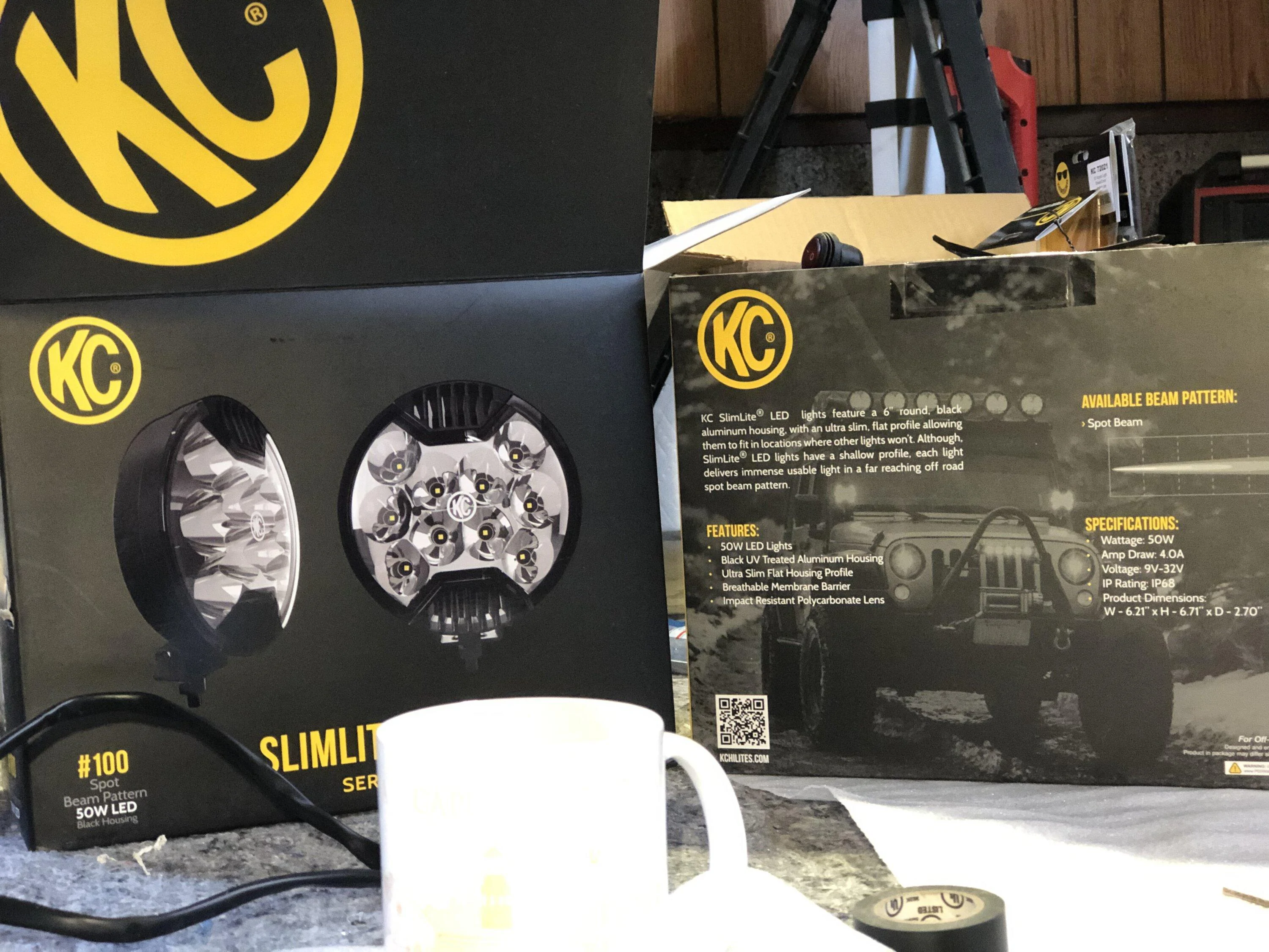

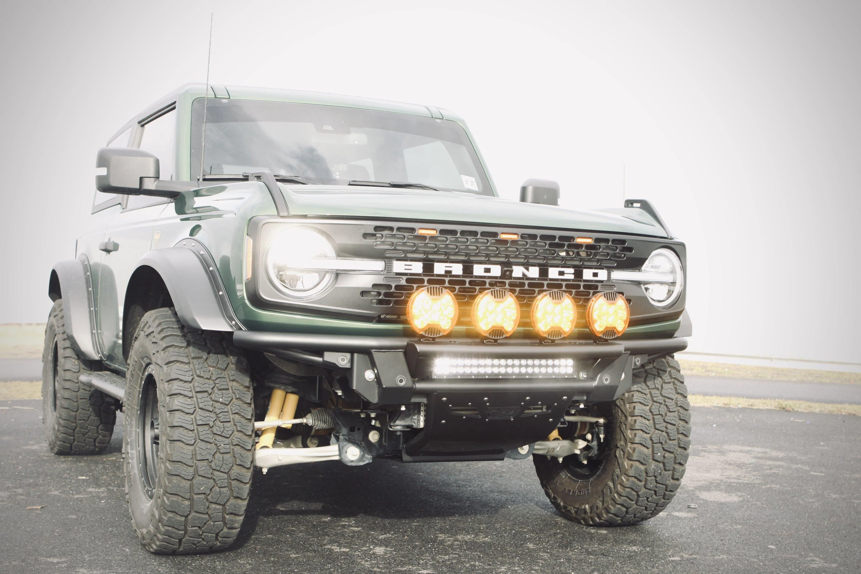

6” SlimLite LED Spots
(2) centers on switch 3
(2) outside on switch 4
20” C Series
(1) switch 2
fogs on factory fog circuit.
😂 lol I just pulled it out of the garage after 3 week of putting this together in freezing temps. , I plan to run to the end of the road tonight to check out their throw. I’ll post a video 🤙🏻

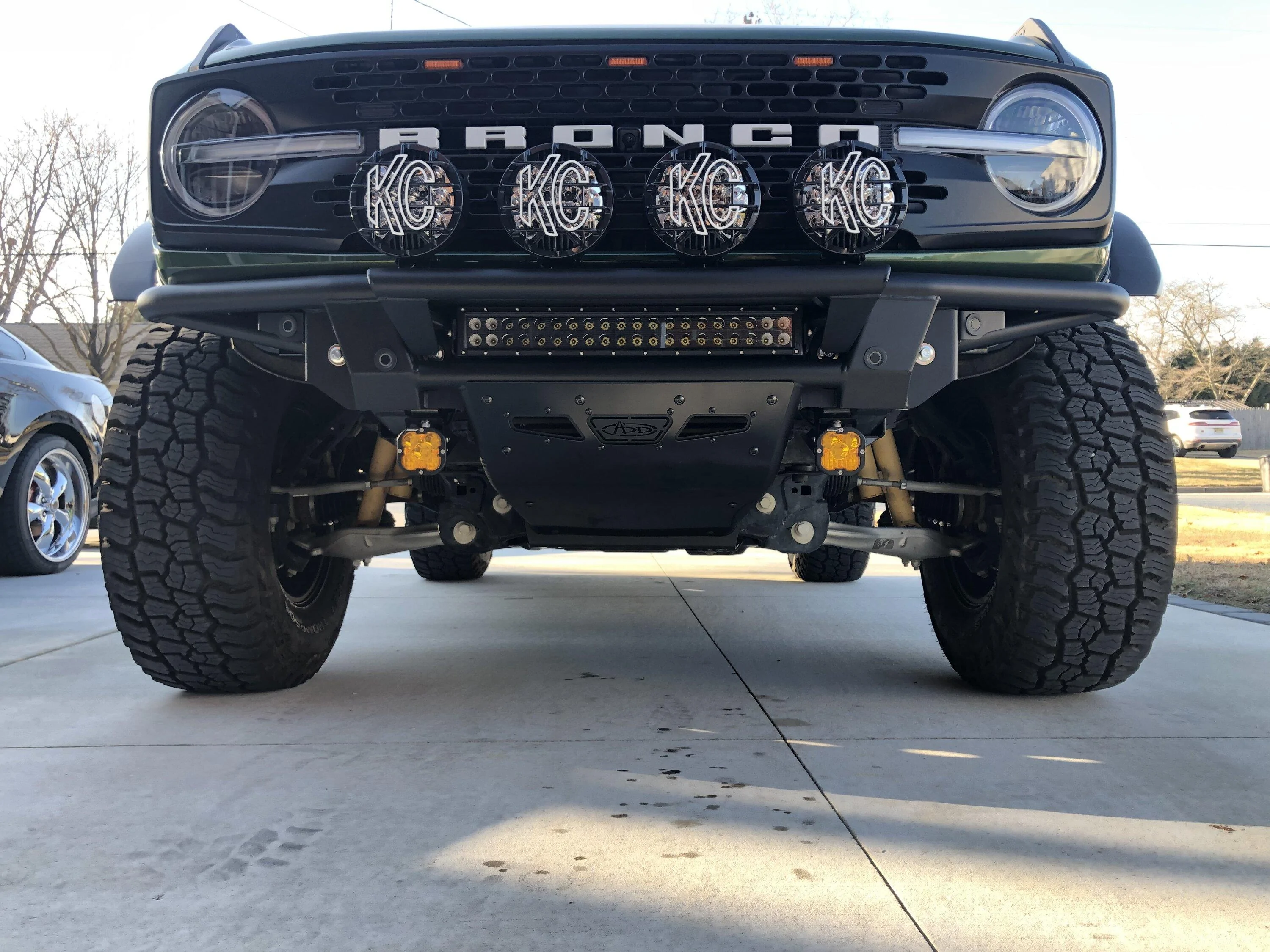

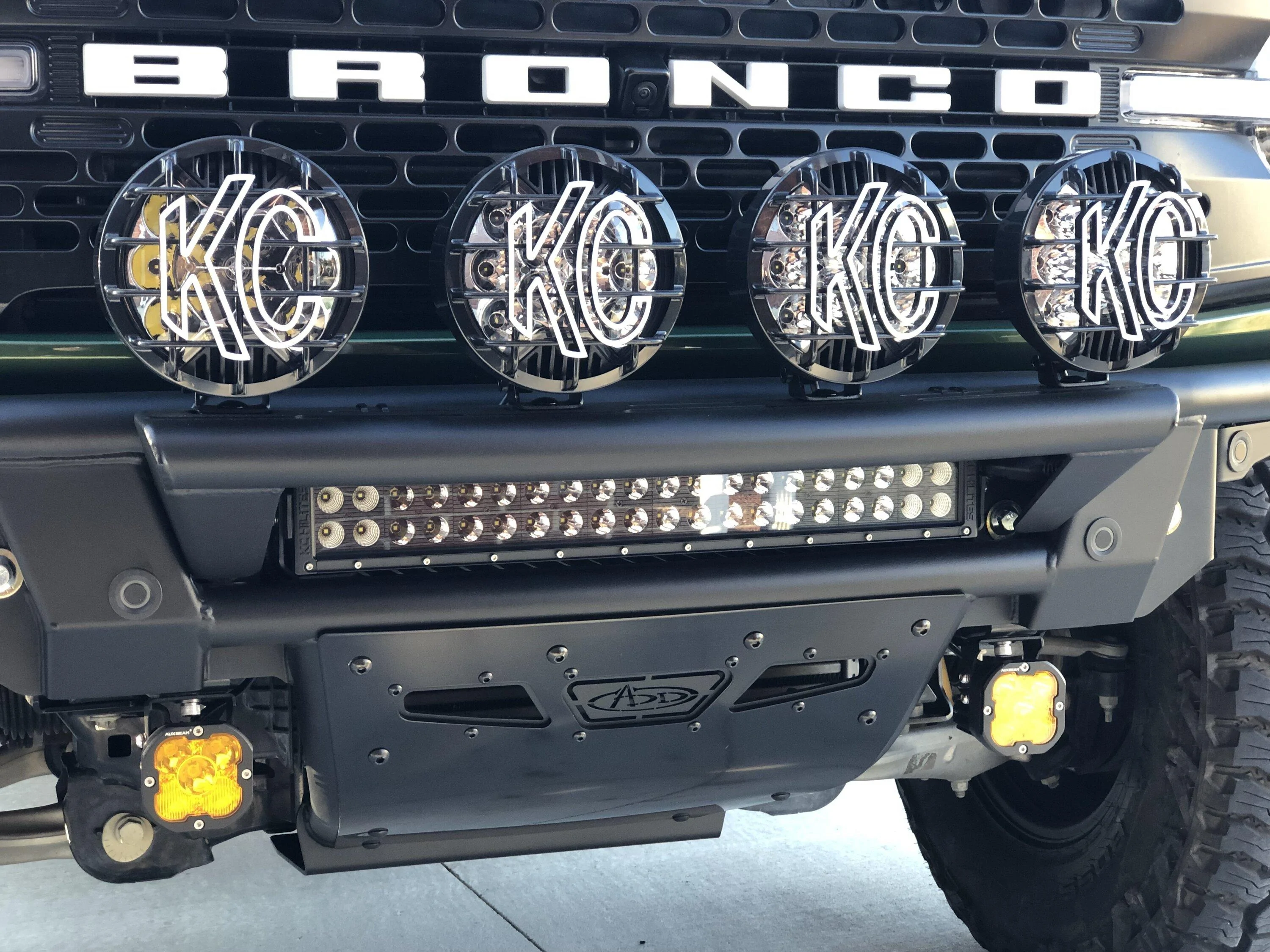

So I love the slim design of the ADD Pro Bumper. But did you eliminate front recovery points? Or does the bumper not provide any?
NJRoadkill
NJRoadkill
Oct 29, 2021
432
955
South Jersey
www.instagram.com
You lose them. None incorporated into bumper.
If you had the plastic bumper, you could retain the hooks and OE intercooler brackets. But it doesn’t look good. I had the Capable bumper so that was moot.
I plan to make a custom set, kinda like the rear set, that will attach to the OE bolts holding the intercooler bracket at the frame.
I had definitely put it into the “CON” column

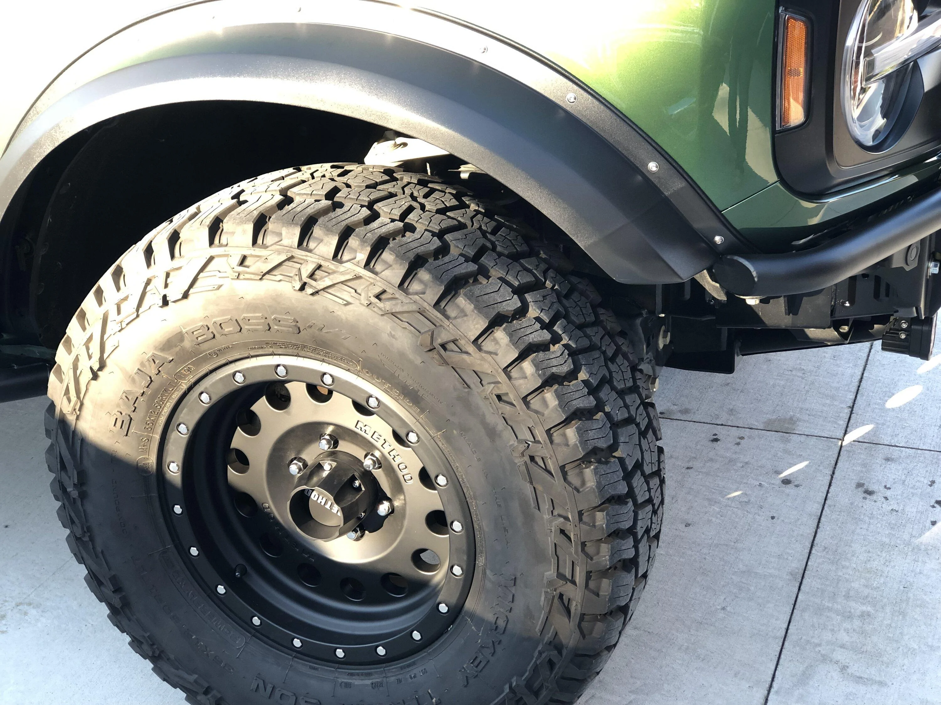

perfect, thank you. COuld tell they are wide but didnt realize that wide. whats your wheel and tire specs? I have 12.5" with 0 offset so stick out quite a bit currently.
Thanks for that. You are the first customer to show up close photos and respond. I had seen the photos that ADD provides, but I kept thinking that maybe they weren't showing them to create a "slimmer" design. I contacted them a while back and no one ever responded.
NJRoadkill
NJRoadkill
Oct 29, 2021
432
955
South Jersey
www.instagram.com
no problem.
If I hadn’t added the amber fogs, I could have bolted up a rear hook to the front easily.
17x8.5 0 offset 4.75” backspacing
Mickey Thompson 35x12.50
Poke before with non-sas flares
Ford Bronco ADD Pro Front Bumper & KC Lites Install. B3AB5084-A128-41F6-B8E4-7A8D7981E8D4
Perfect, that is very helpful. Essentially same setup i have as well. WIll add another to the list...
Amber fog only
Single light bar only
2 Center 6” only
2 Outside 6” only
the added together
