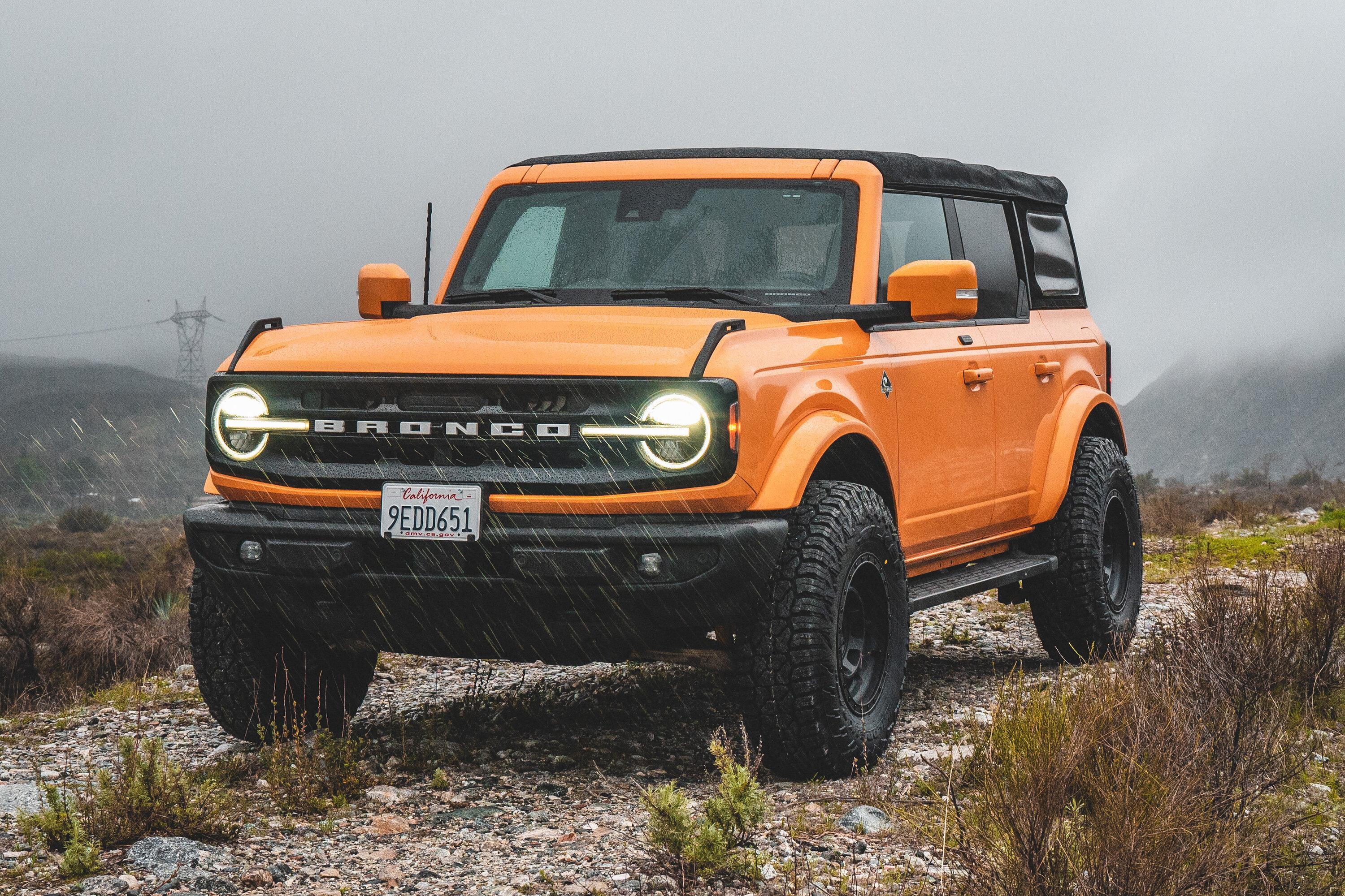

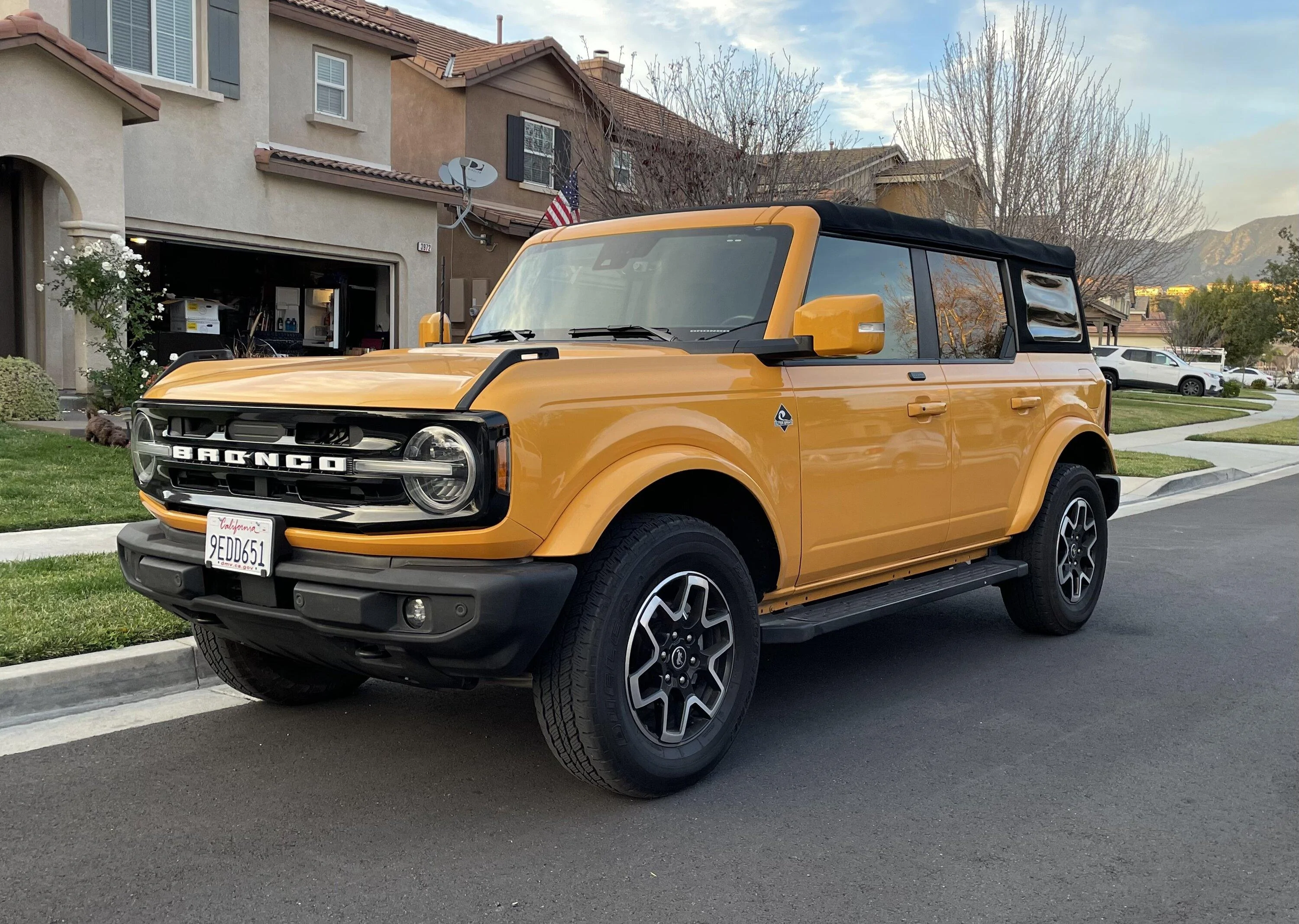

I bought a set of strut take-offs from a suspension shop for a killer deal and the seller originally told me they were from a non-sas Badlands. The part numbers didn’t pop up in the suspension cookbook on this forum but after a google search, eBay (in theory) clarified that they were 2.7 Sasquatch, what a surprise! With only ~170 lb weight difference between 2.3 and 2.7 and future plans to add a winch and upgrade my bumper, I wasn’t too worried about it.

I did order upper control arms but haven't installed them yet, and the ride has been absolutely fine. There was a ride difference when I added the 35" tires (lol) but not a very noticeable change with just the suspension.
